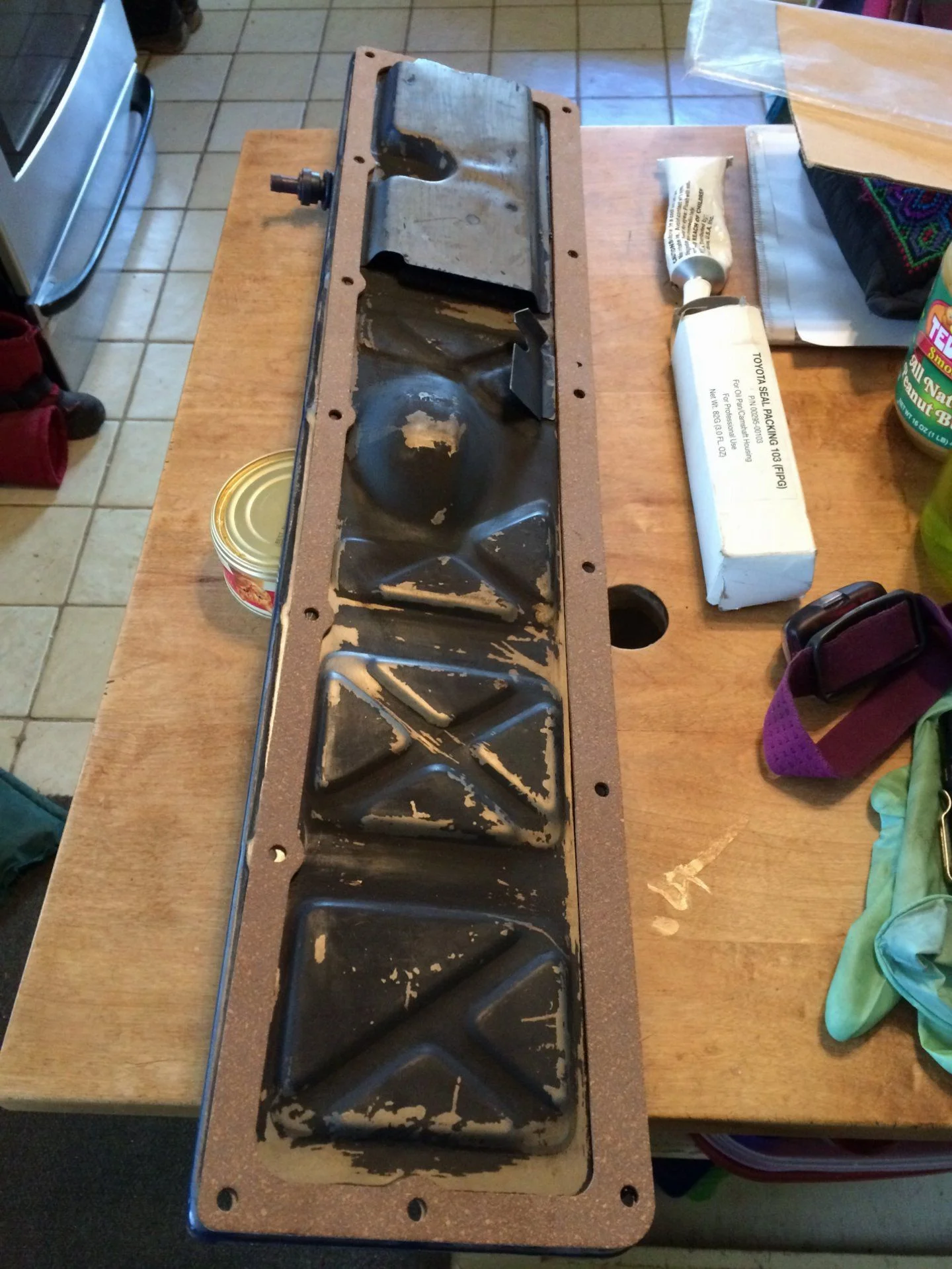

Got the side of the block cleaned up for the gasket and cover.
Then reinstalled the diz which is in no way super simple. Glad I added marks to the housing and have a high powered flashlight to see down inside. Lining up the diz shaft w/ the oil pump slot and making sure the rotor is pointing the right way is most def a feat in patience.
