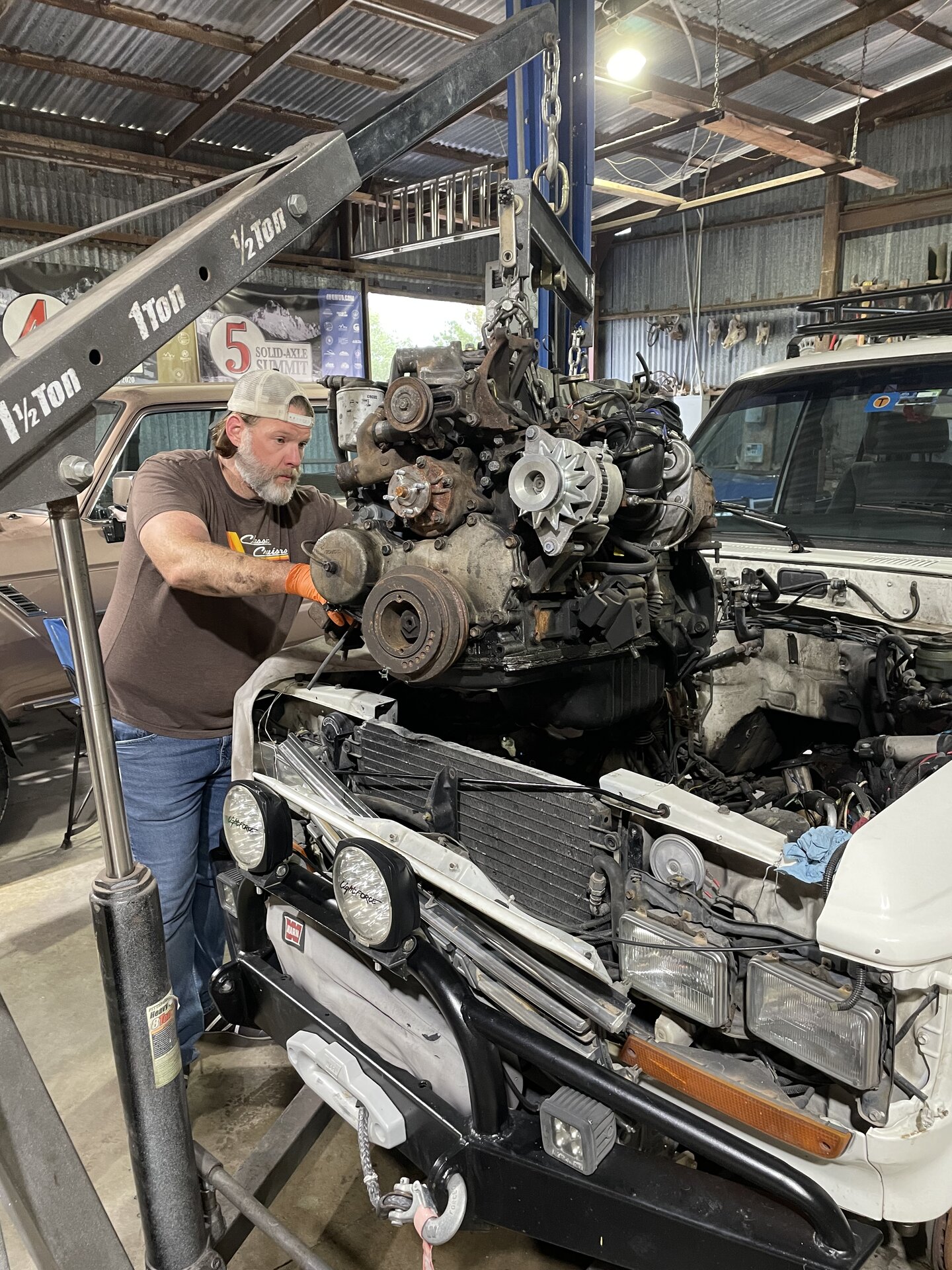

At 400k miles the 12HT left him stranded after moving to DFW. This was where things changed as he went to the wrong shop. He was taken to the cleaners and lost the desire to keep her any longer. I have several other jobs at the moment so will most likely be a while before I get her back on the road. @BigHighBlue helped me pull the motor earlier this week.

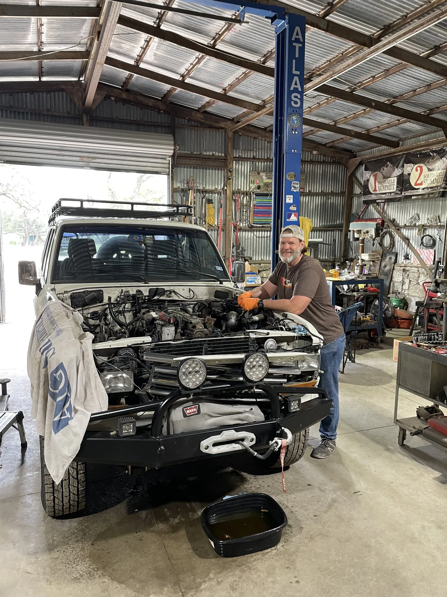

Forgot to add these pics from last week. Ben @BigHighBlue came over for a little R&R. So asked what he wanted to do for these few days and his response was “ want to see the 12HT come out the white truck”. So thought I’d share some pics of him in action. He was a huge help and did most the demo work on his own. And yes, that’s Ben giving the traditional Casey Archer @POTATO LAUNCHER salute when I snapped a pic over my shoulder :).

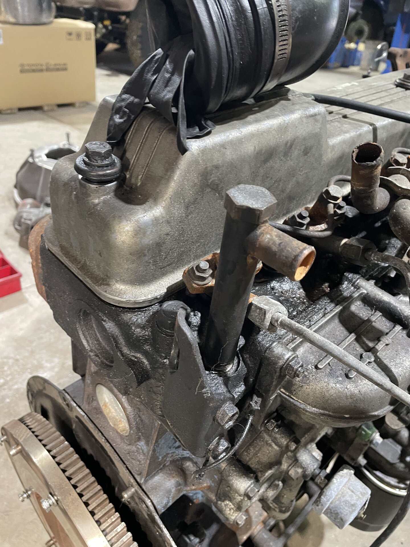

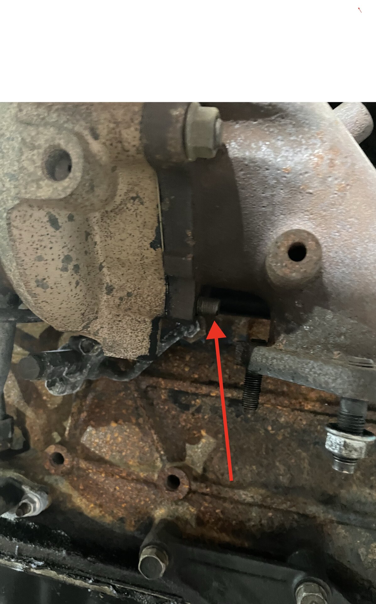

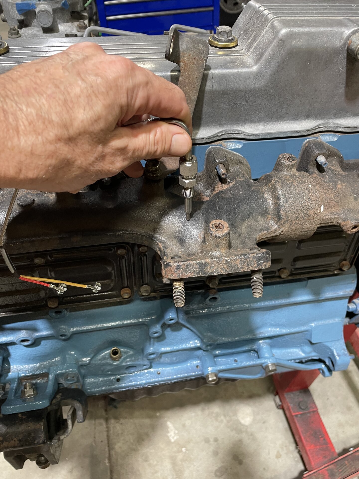

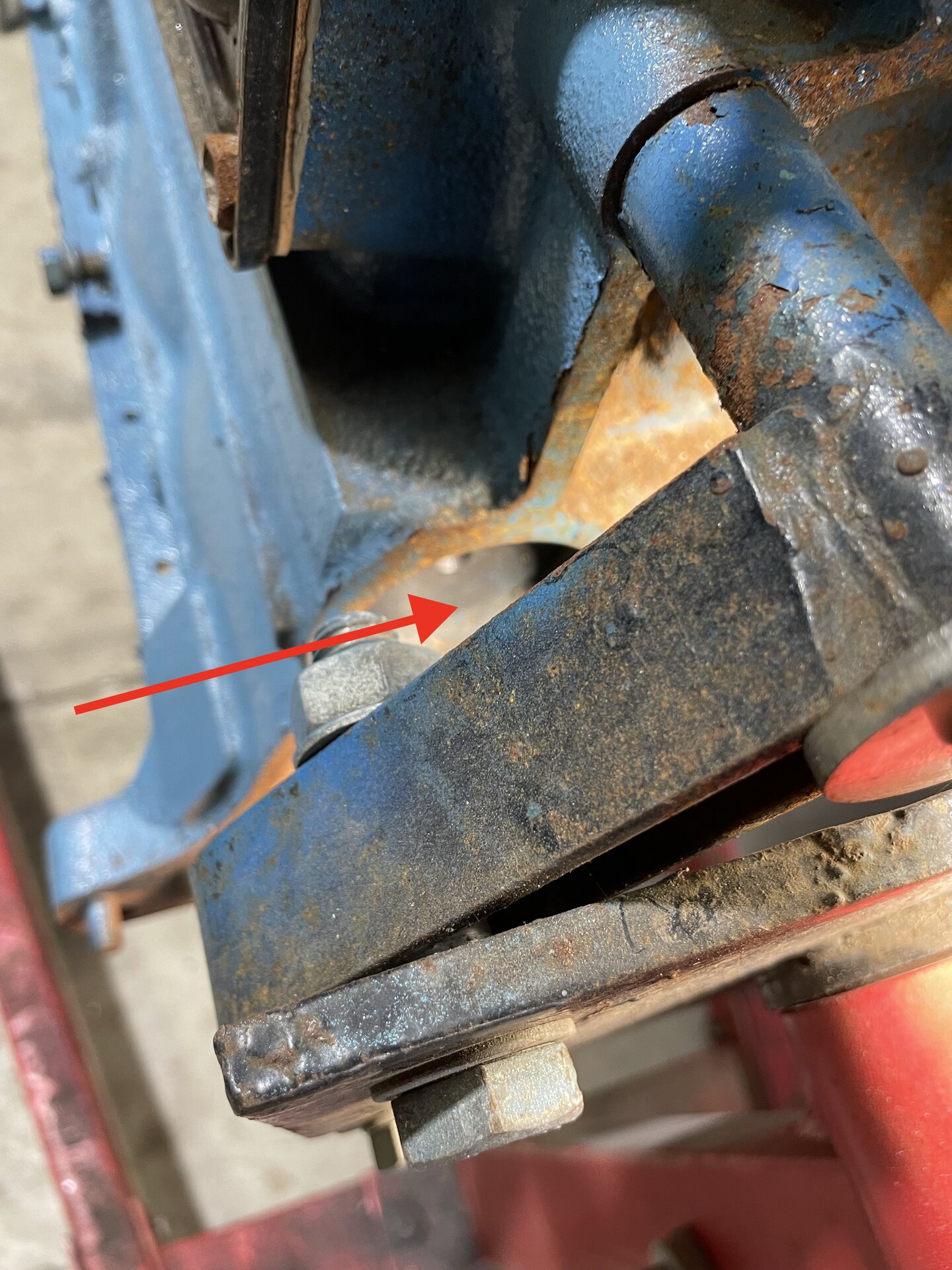

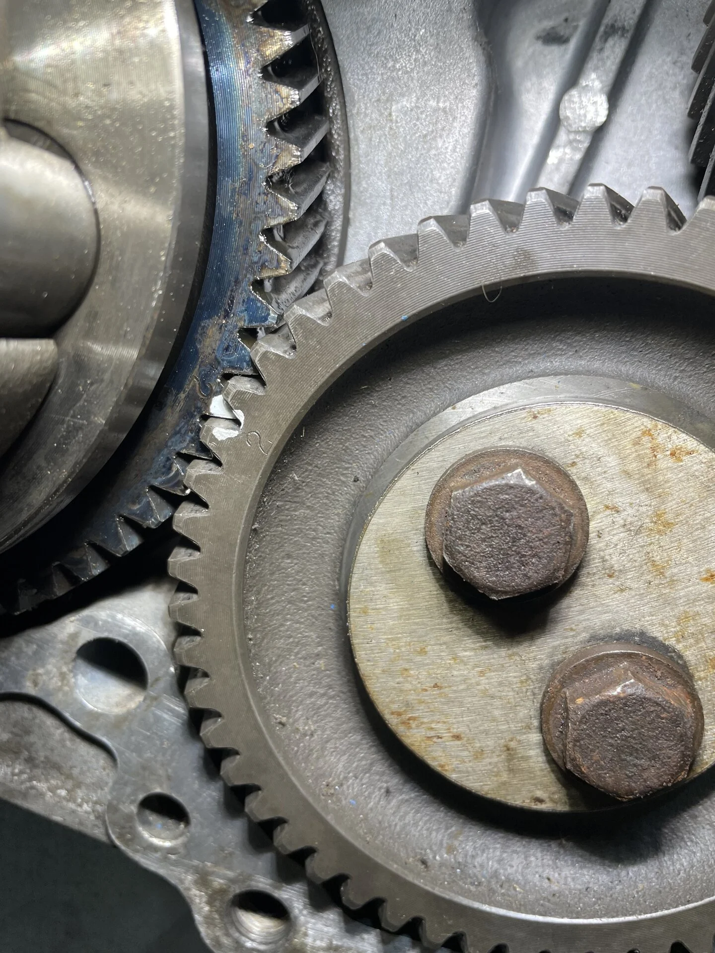

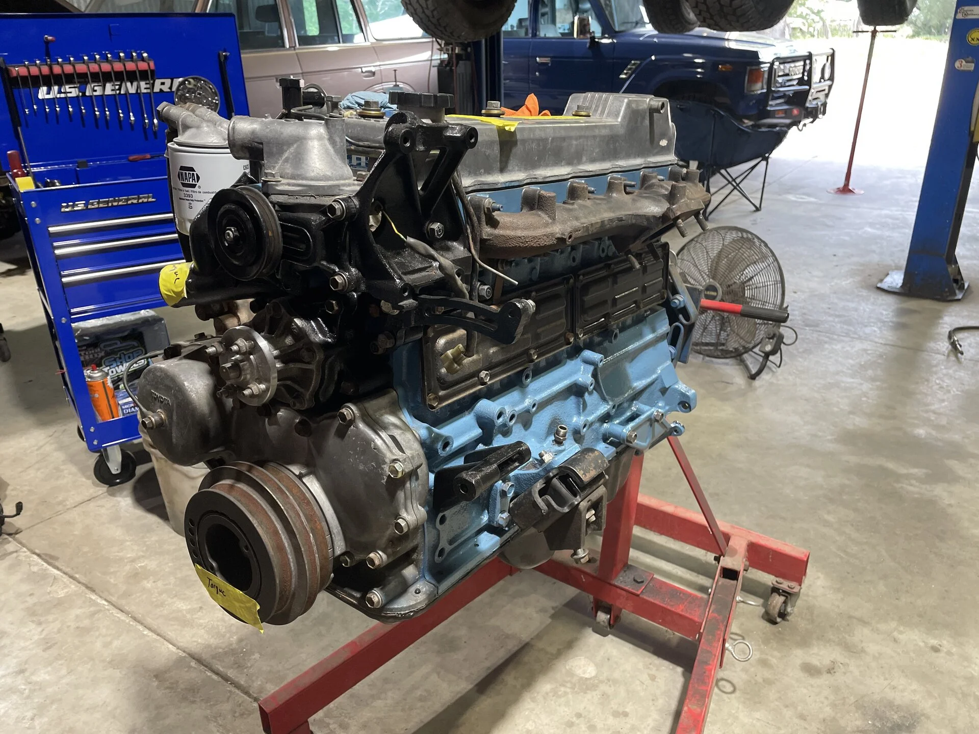

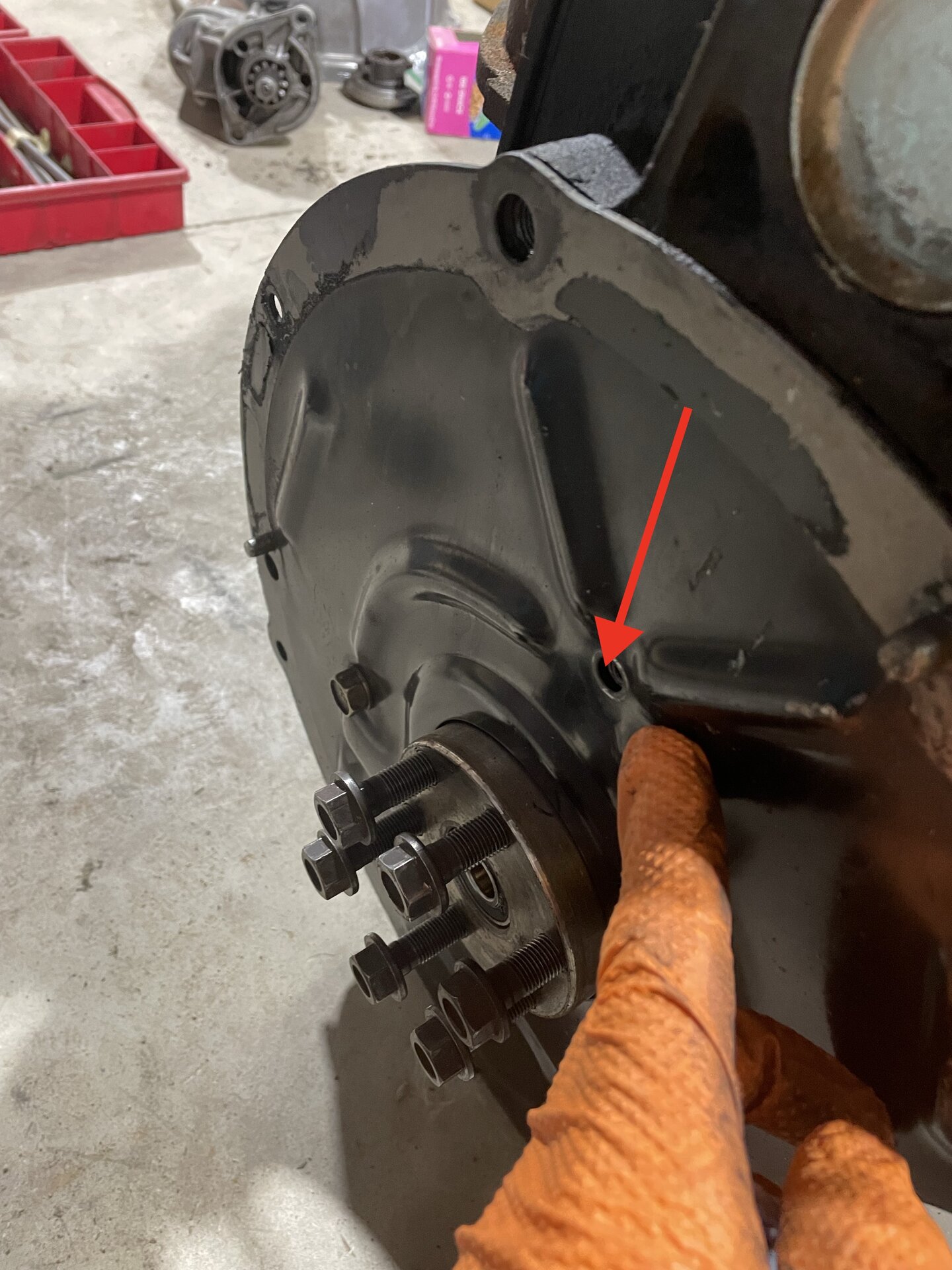

Been working on the new motor going in this truck. Was a long Block (rebuilt) when Ben and I picked it up in DC. Pulled the oil pan due to finding 4 piston oilers in a nut/bolt separater. All checked out but no idea why there’s 4 left over. The rest of the bolt on’s are there in totes so I’ve been cleaning/painting things. Believe this motor came from the NE originally so some items are a bit crusty. Will use the alternator, starter and turbo from the old motor. Was my first time installing an injection pump. Due to the PO turning the motor periodically to keep it lubed I had to get all the gears aligned. Pulled the idler gears (removing #1 gave me the room to slide the pump in) and reset the crank gear and the cam. Then reinstalled the idler gears and meshed the pump timing gear. Basically did everything backwards to the FSM. Just did not want to pull the CAM. Finished installing the injectors today. Bolting up the manifold and turbo I’d be able to fire it up on a pallet. However i discovered the rear of the motor is missing the freeze plug-in the cam. Have one on order thanks to @roma042987 bailing me out with a part #. Hope to install a new EGT probe next but need to verify exact location. The target area is pre-turbo so I need to measure 3x and drill/tap once to ensure there’s no contact with the tip inside the chamber. Doing another post in the diesel section to get feedback.

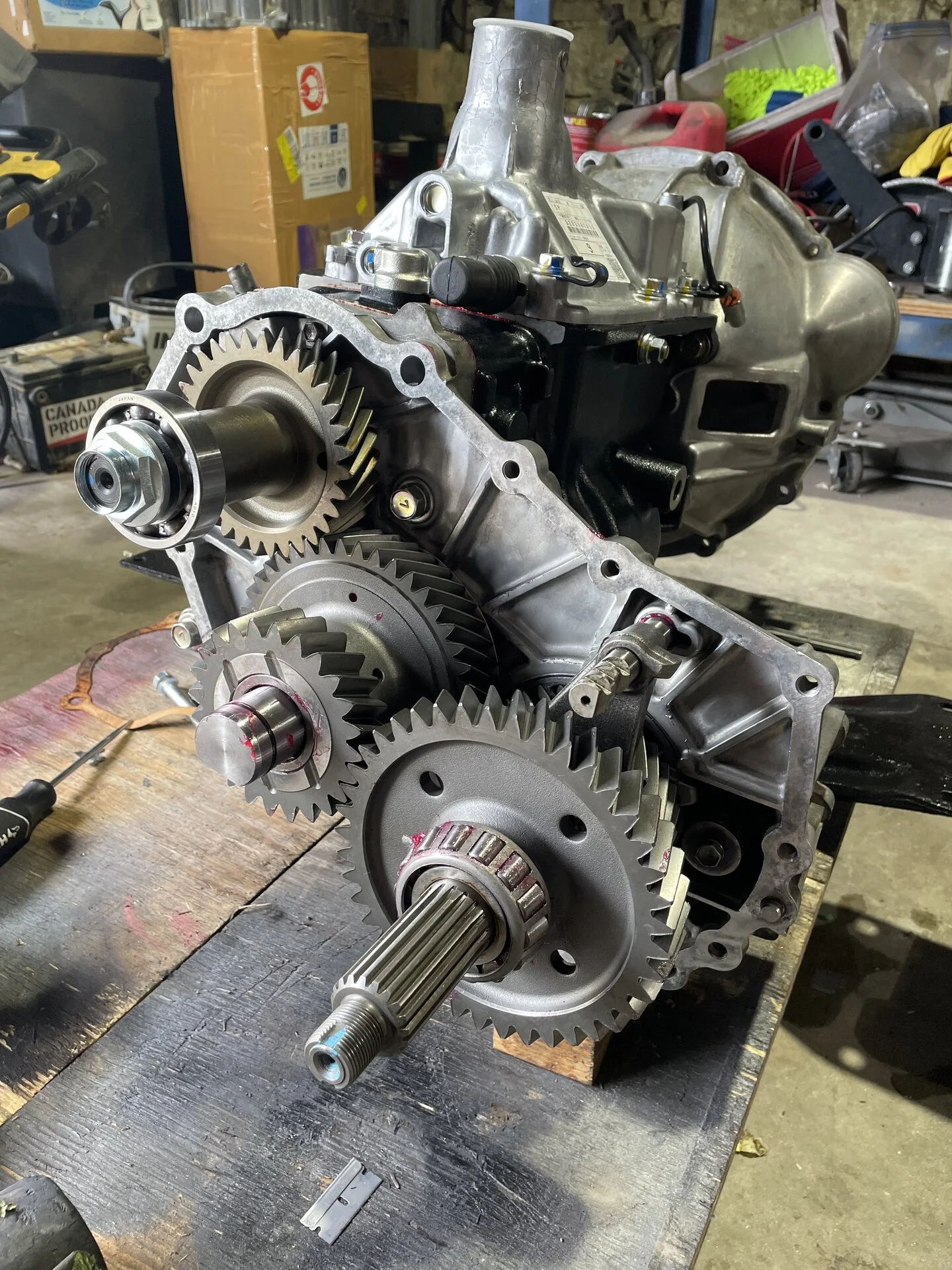

So no progress on this motor as I’ve been building a T-case onto a friends new H55 for his 61. Put it in his post but worth sharing here as well…put new gears in the case which is a whole new experience. George @orangefj45 hooked us up. Have never had a case rebuild feel so good and man everything is smooth. If you’re bored you can check out the other fun stuff we are doing to Mason’s 61 @landsnoozer on his build thread.

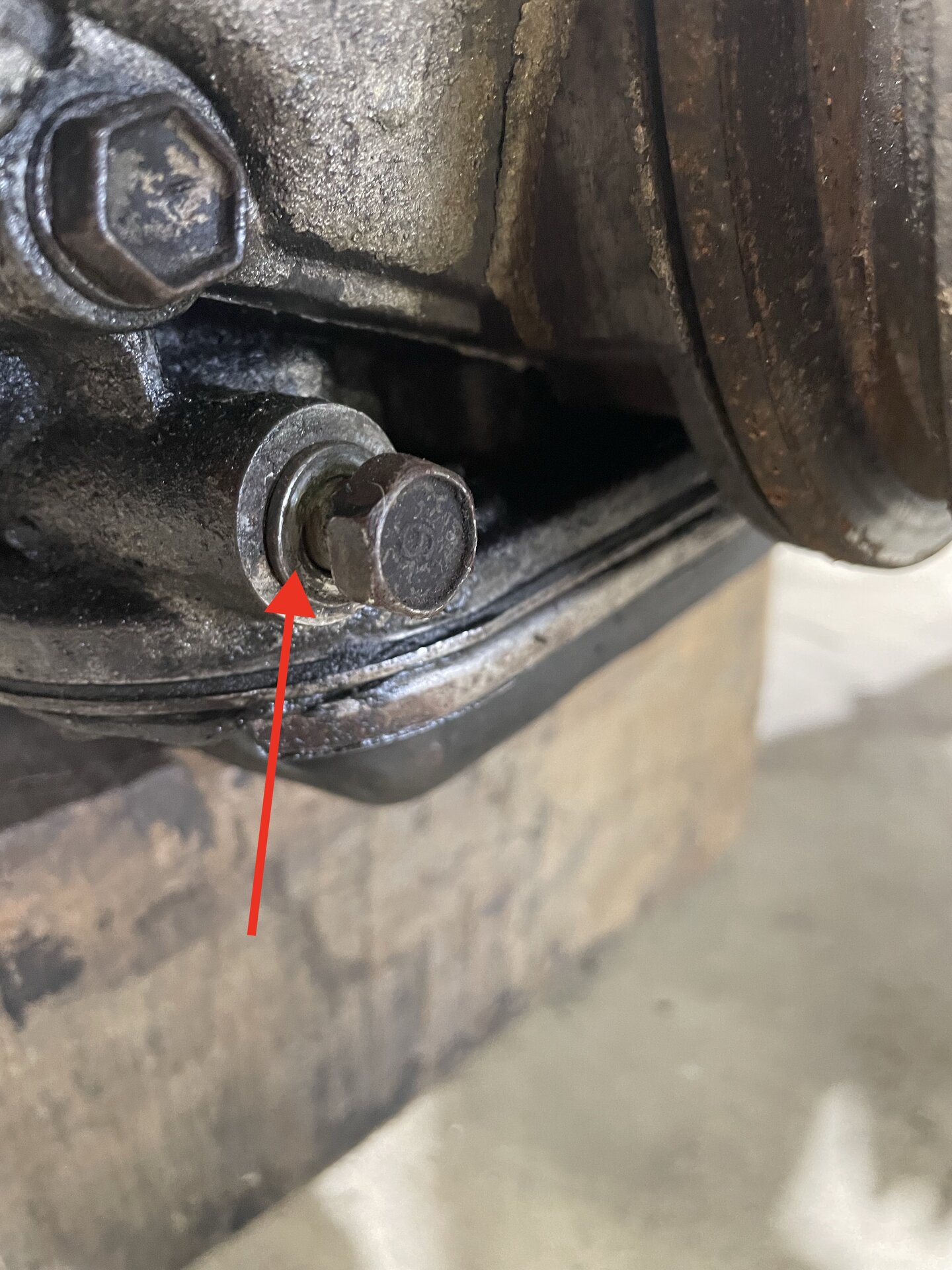

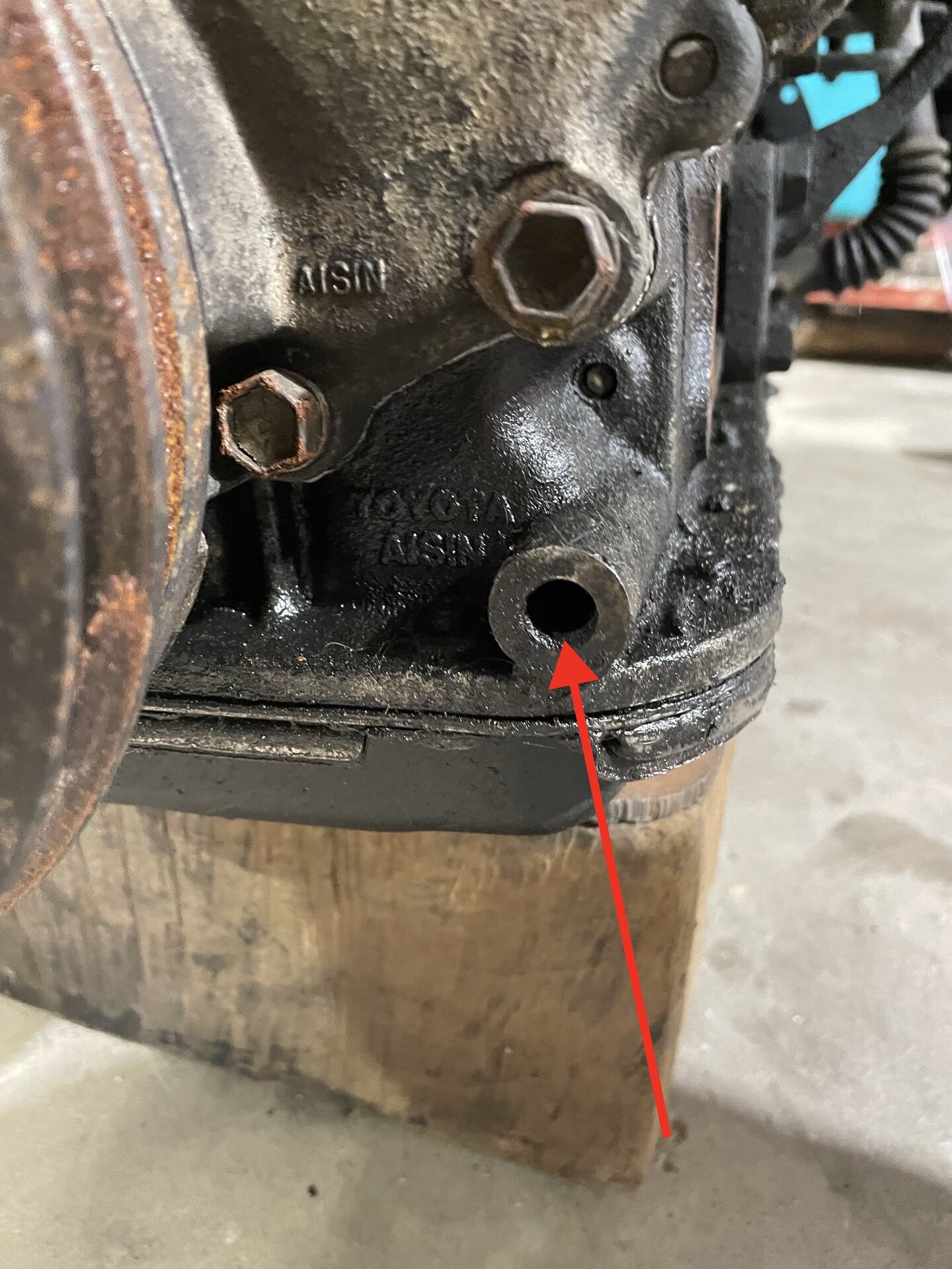

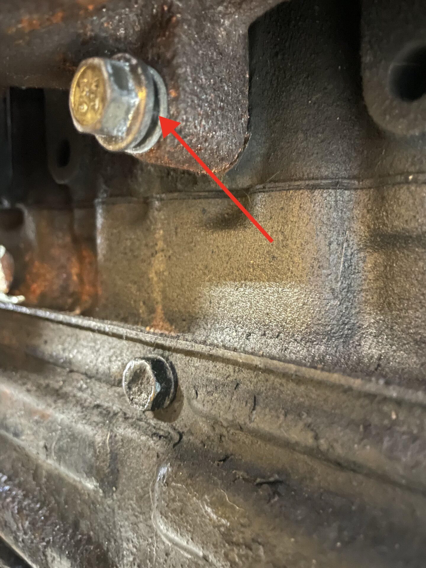

Wanted to also point out some lackluster craftsmanship on the rebuild by Blackdog traders for the previous owner of this 62. I may be over killing this topic but can’t get over it. And providing a shot of the head that has only a few hundred miles since the rebuild. Went back and looked at the receipt on file. They charged quite a bit of $ to “clean and rebuild” this 12HT. Can’t say the head was not rebuilt until I pull it. However it does look to have a newer head gasket. Really hard to tell 100%. You’ll see the many bolts missing or never tightened/torqued down.

New gears. Almost no better feeling than this :).
And pics of bolts missing or not torqued

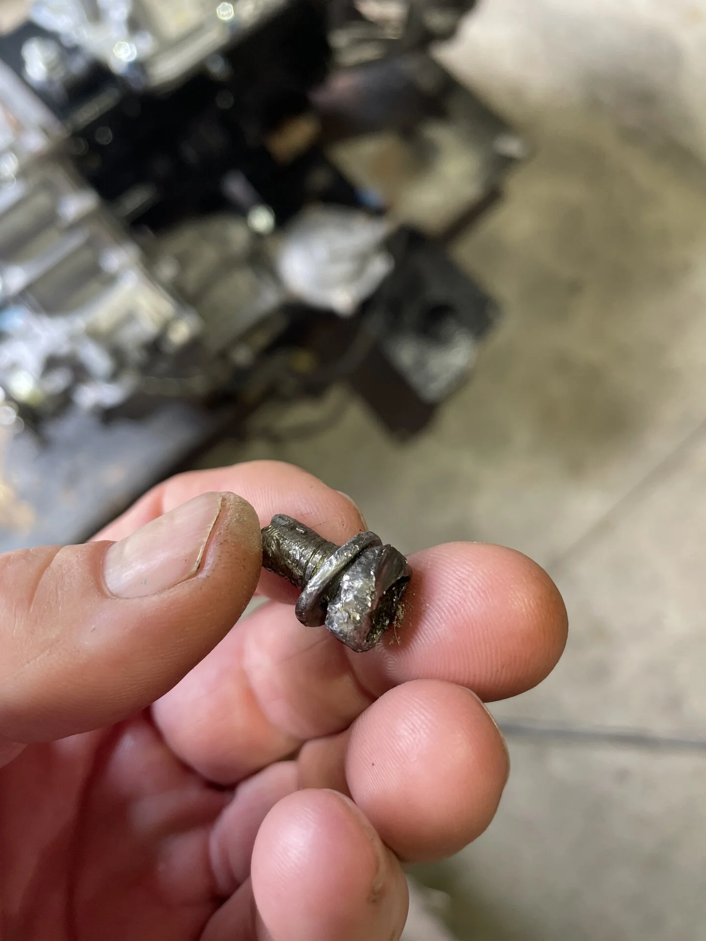

And below is a pressure plate bolt that fell out when I removed the clutch. Funny thing is the pressure plate had all 6 bolts on it. Can’t figure out how this happens

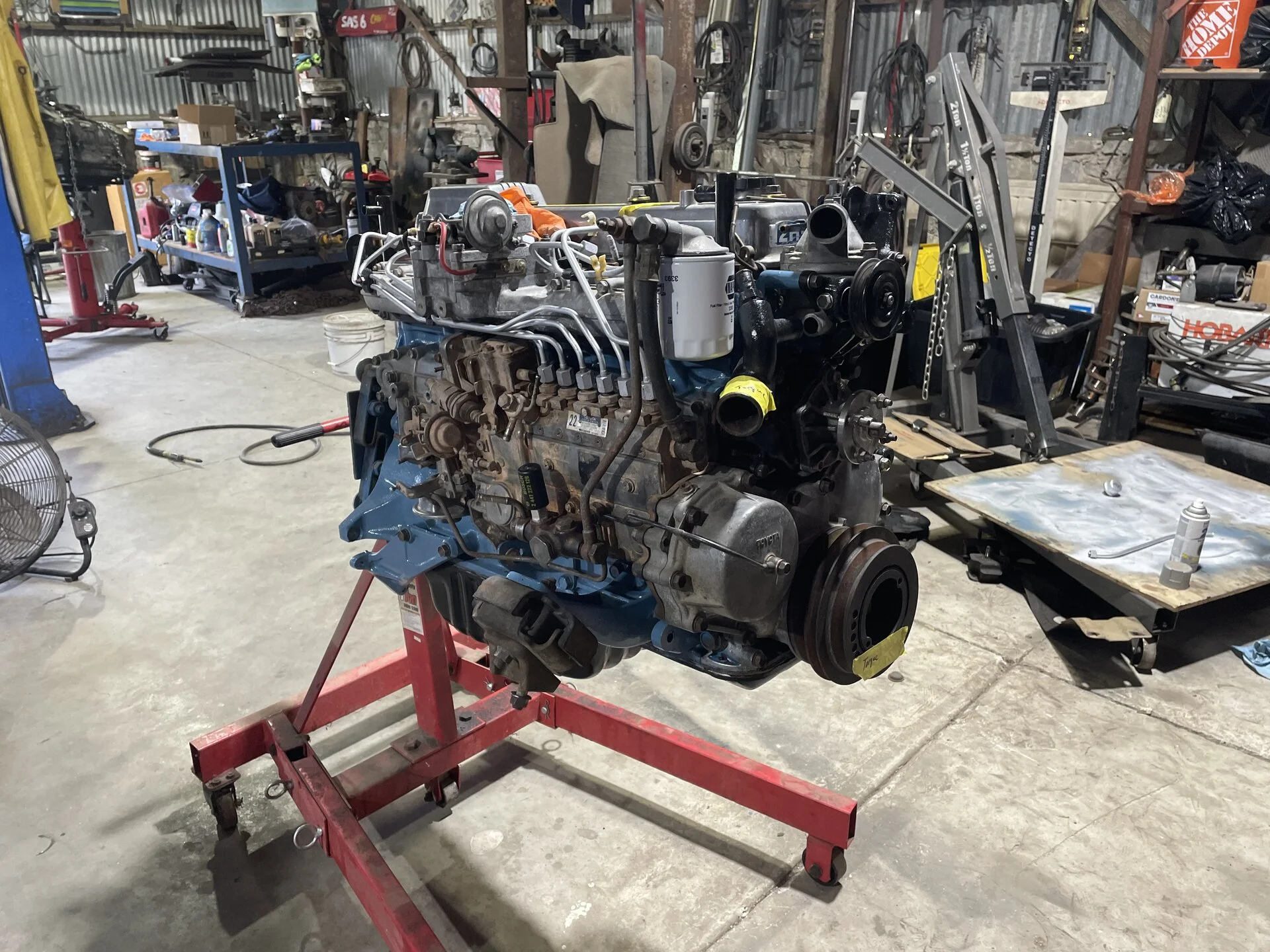

So this thread has been napping for 3+ years. I started my own business 3 years ago (Senior In-Home Care agency). Could not be happier but the first 2.5 years were 70+ hours/7 days a week. Have barely had the time to work on my own rig these last several years. Have this 12HT long block that I worked out a barter deal on with @BigHighBlue. It’s taken me the last 3 years just to assemble and fire it up. Started it last spring and had injector #2 spraying diesel everywhere. And the oil pressure gauge I bought at Napa registered zero. I was concerned and the motor went back to my garage. This weekend I pulled her back out and borrowed my neighbors Matco oil pressure gauge, fixed the #2 injector line (sanded out the pitting on the compression fitting), and she meets expectations. Next weekend my goal is to get the truck into the shop and detail the engine bay best I can. Then get this motor into the truck. I figure at my pace I should be driving the 62 by the new year. Then spend the next 6-12 months fixing some rust in the rain gutter/A-pillar area. Direct result of the PO’s paint guy in Panama. They used the wrong sealant in the rain gutters. This truck spent most its life in the LA area before going to Panama for two years and then to Dallas which is where I picked it up almost 4 years ago. Should be a really nice 61 clone when I’m all done. Here’s a YouTube link to the cold start on the pallet.
