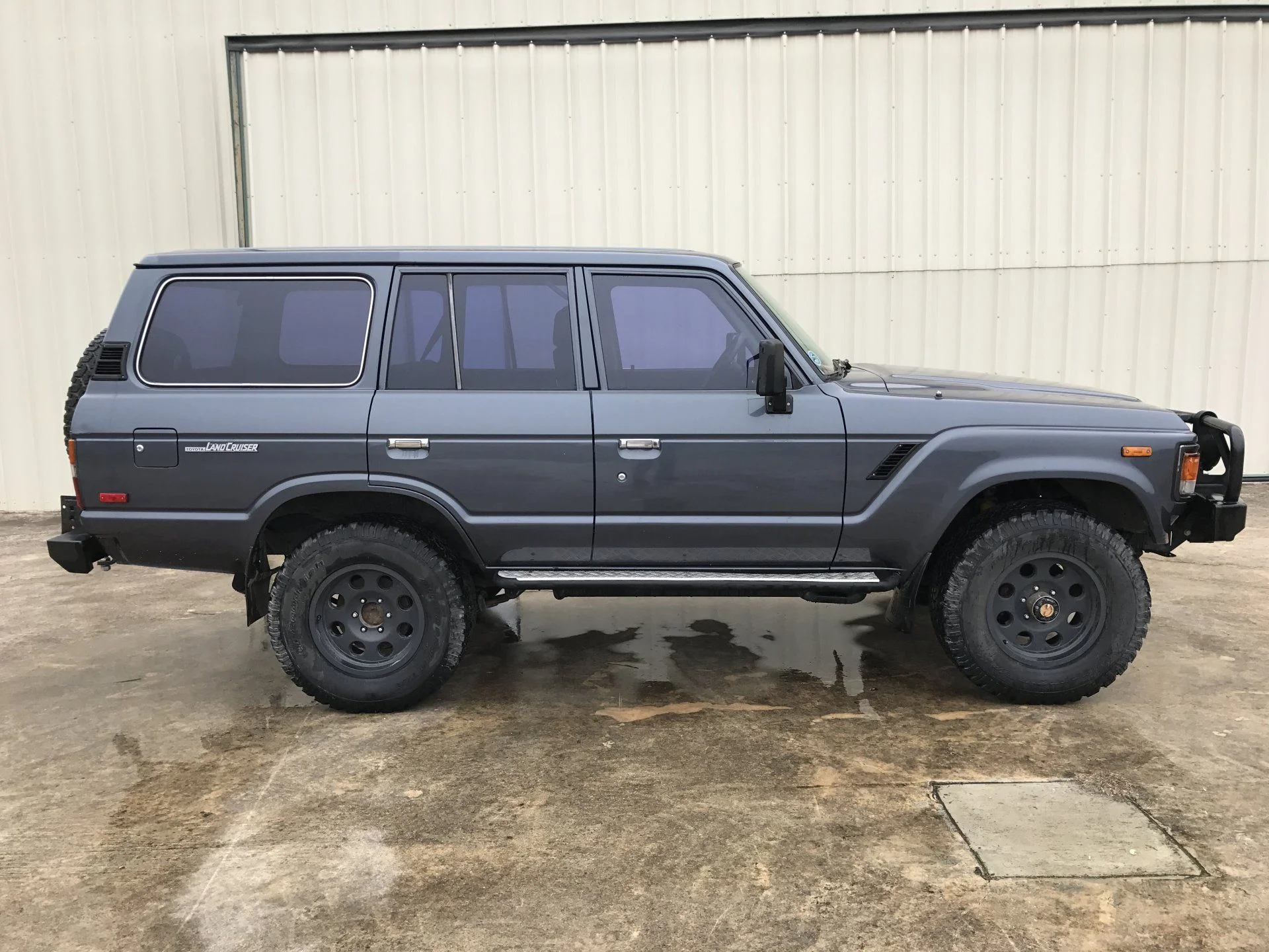

Today we got together with a new guy @davelovesfjs to see his "new to him" FJ60. A pretty sweet find for sure. I'll let him post pics and talk about it in detail. The first item on the agenda was to find out why it won't hold idle below 1350 RPM. A vacuum leak was suspected and confirmed using some brake cleaner, because we didn't have any carb cleaner on hand. A cracked intake manifold was the culprit and a plan was made for a near future fix. Dave's new 60 is the blue/gray shown below. Does anybody recognize this cruiser? We are thinking the previous owner had to be a Mud member, but he passed away earlier last year. There seems to be some of @reevesci fingerprints on this cruiser. Maybe after Dave posts some more pics, Jason might be able to ID this cruiser and provide some background.

I'll second everyone about what a great afternoon it was yeatserday! Great to meet all the guys and good to know there's some quality gents in the area with cruiser know how.

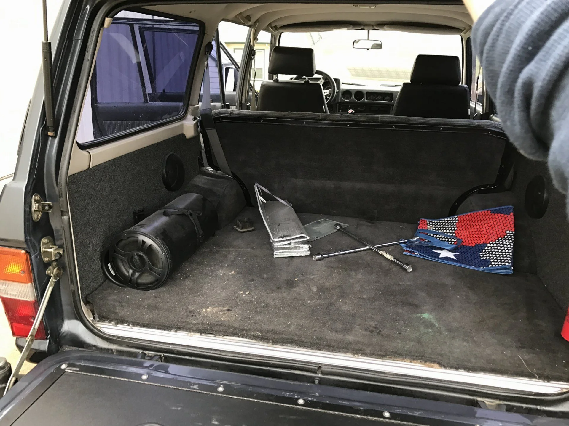

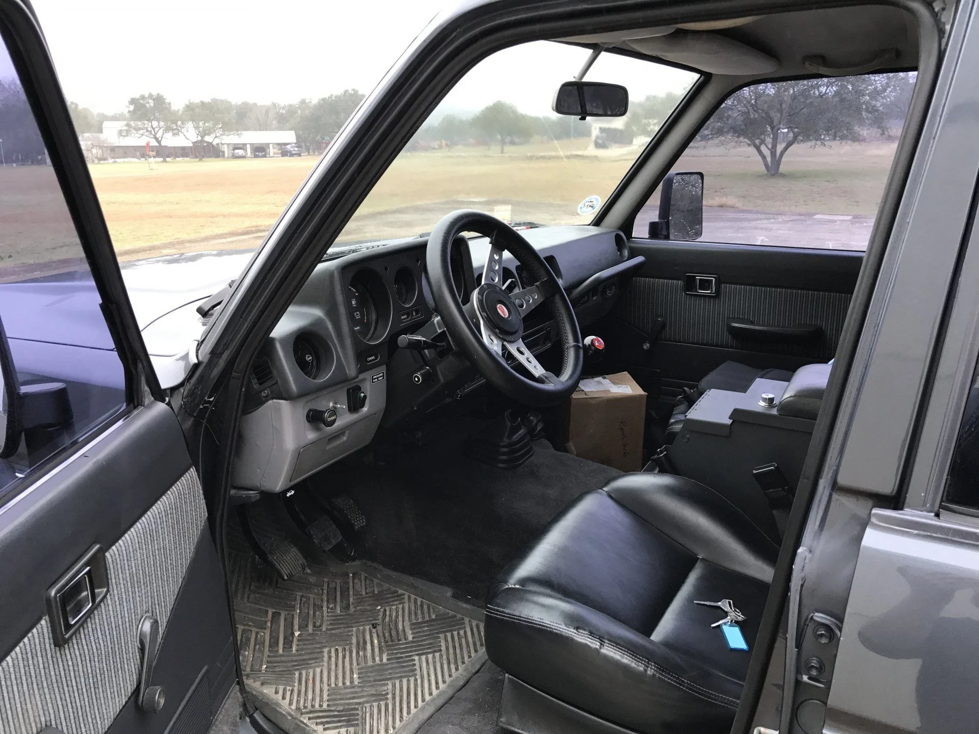

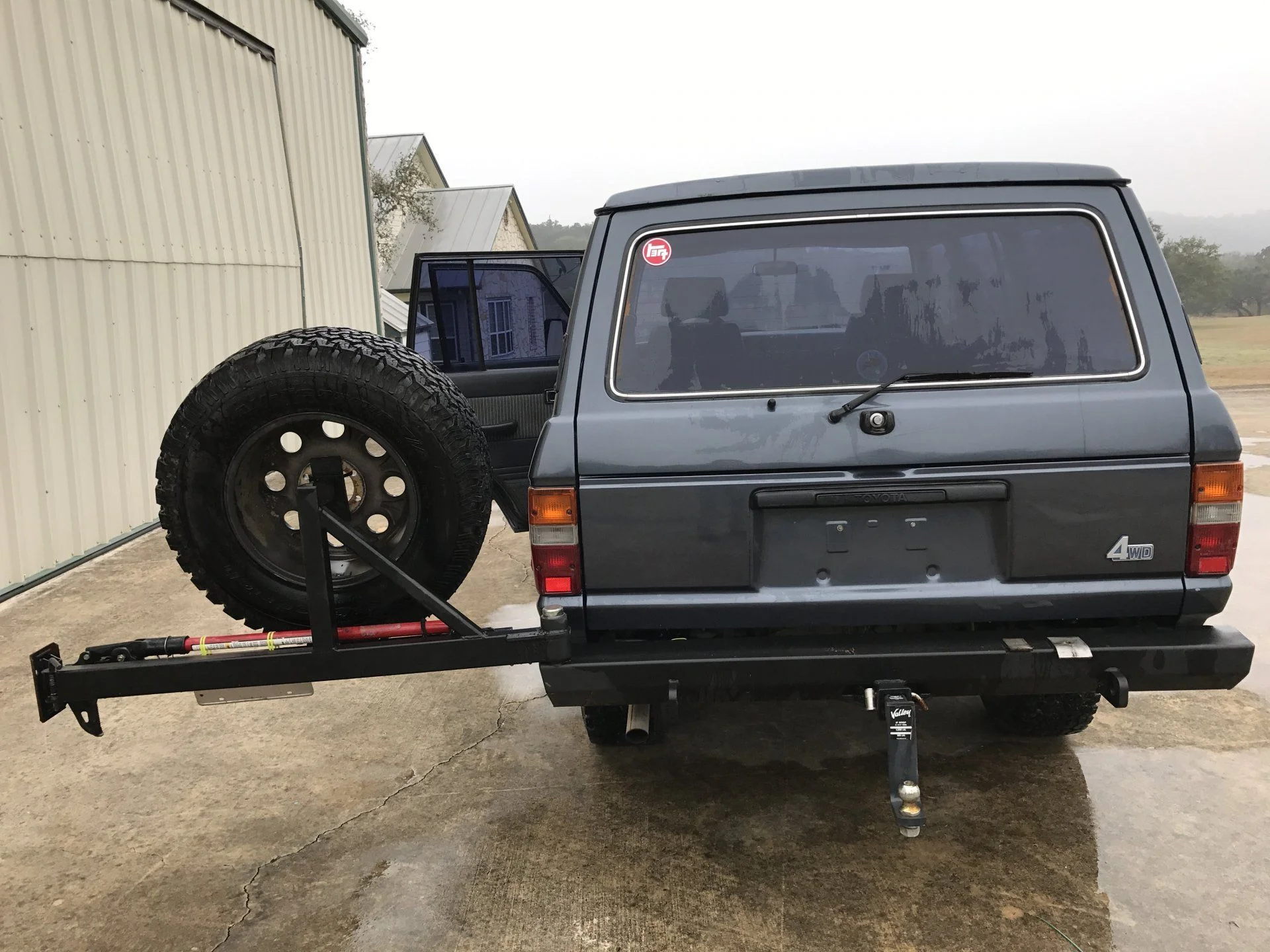

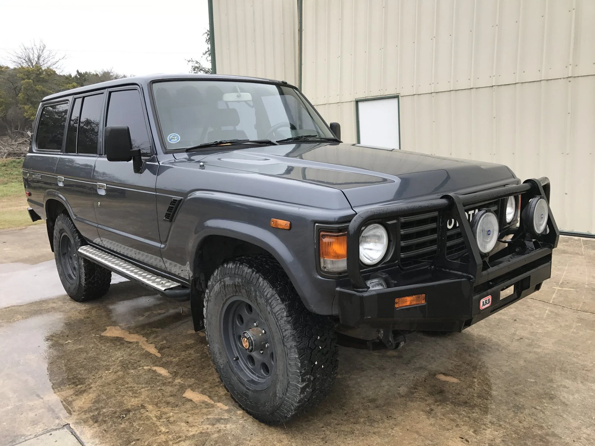

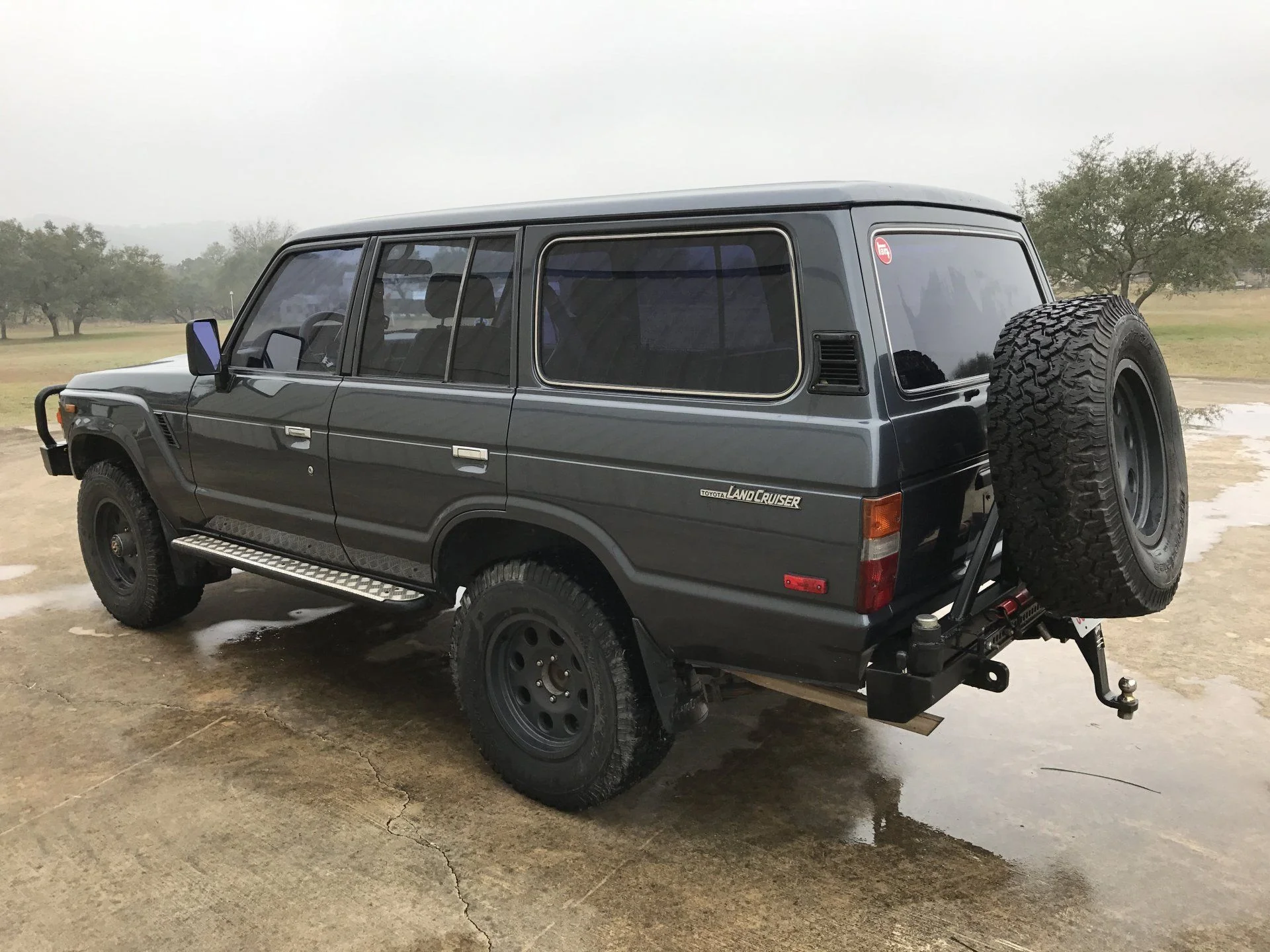

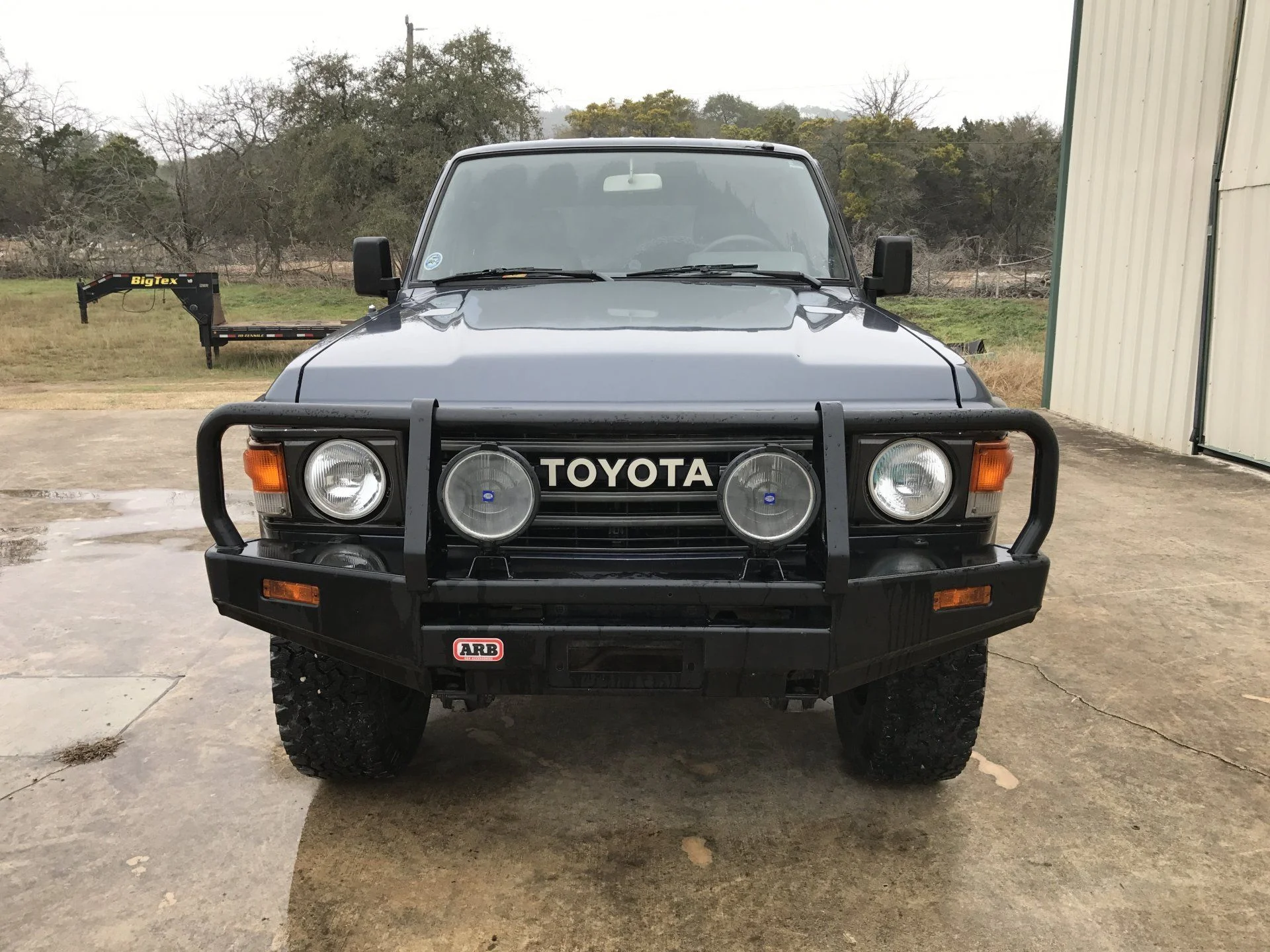

I'm in the midst of some kid chaos, but I wanted to post up a few pics after giving her a good bath today. It's had about a year and a half of dirt just sitting on her. Good start.
Nice looking truck!

There is a large pipe open on the air cleaner lid. It is getting dirty air rammed into the front and then it goes right into the carb. Cap it off ASAP.
Solid point Jim. Get a good look at that carb, you'll be seeing it soon.
