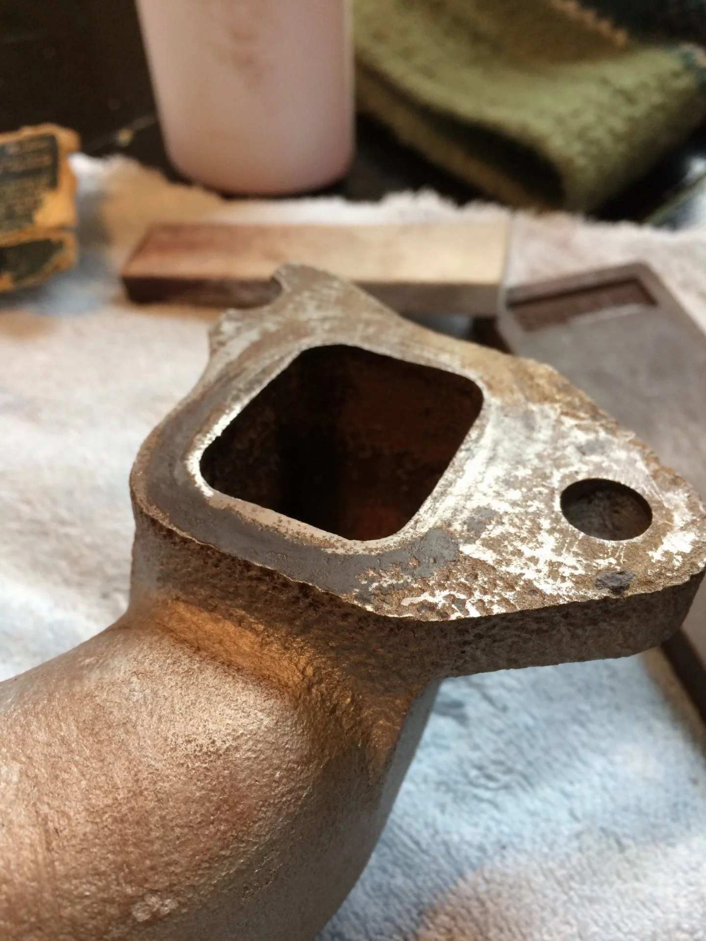

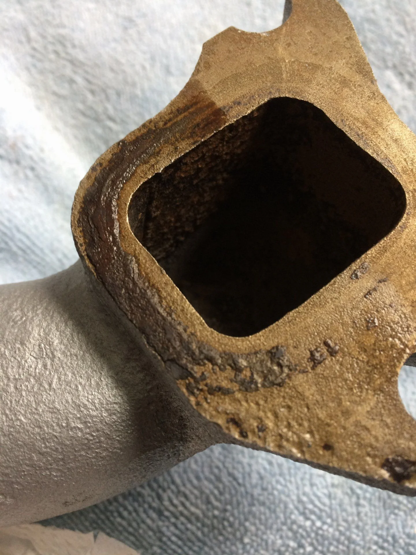

That looks like rust and the machinist won't put his tools to it that way I don't think. So either you or he will have to clean it. If you have Harbor Freight this is a good $3 investment:
Combination Sharpening Stone
If you hear a machinist talking about "stoning" something they are talking about running a stone like this over it to take the burrs off. I wouldn't hesitate to take a cheap stone like this with some kerosene and knock that rust off. Obviously you don't want to damage the surface but scratches don't hurt as it's getting machined anyway.
Ah I do have two of those. (I have an old carbon steel knife I use for killing my birds when it comes necessary). That will be easy. Thanks for the guidance. :)
And at @mwebfj60, I might be a keeper but I've run twice. So far none has managed to keep me long... aside from my 60's.
How clean is clean @Prairie Swamp ?
If you're going to have the assembly surfaced, then it will clean up when they do it. If not, you need to get all that old gasket material off the mating surfaces around the intake openings. I prefer using fresh, single-edge razor or a very light fiber wheel on a die grinder.
The process for surfacing is like putting the whole assembly face-down on a very large belt sander.

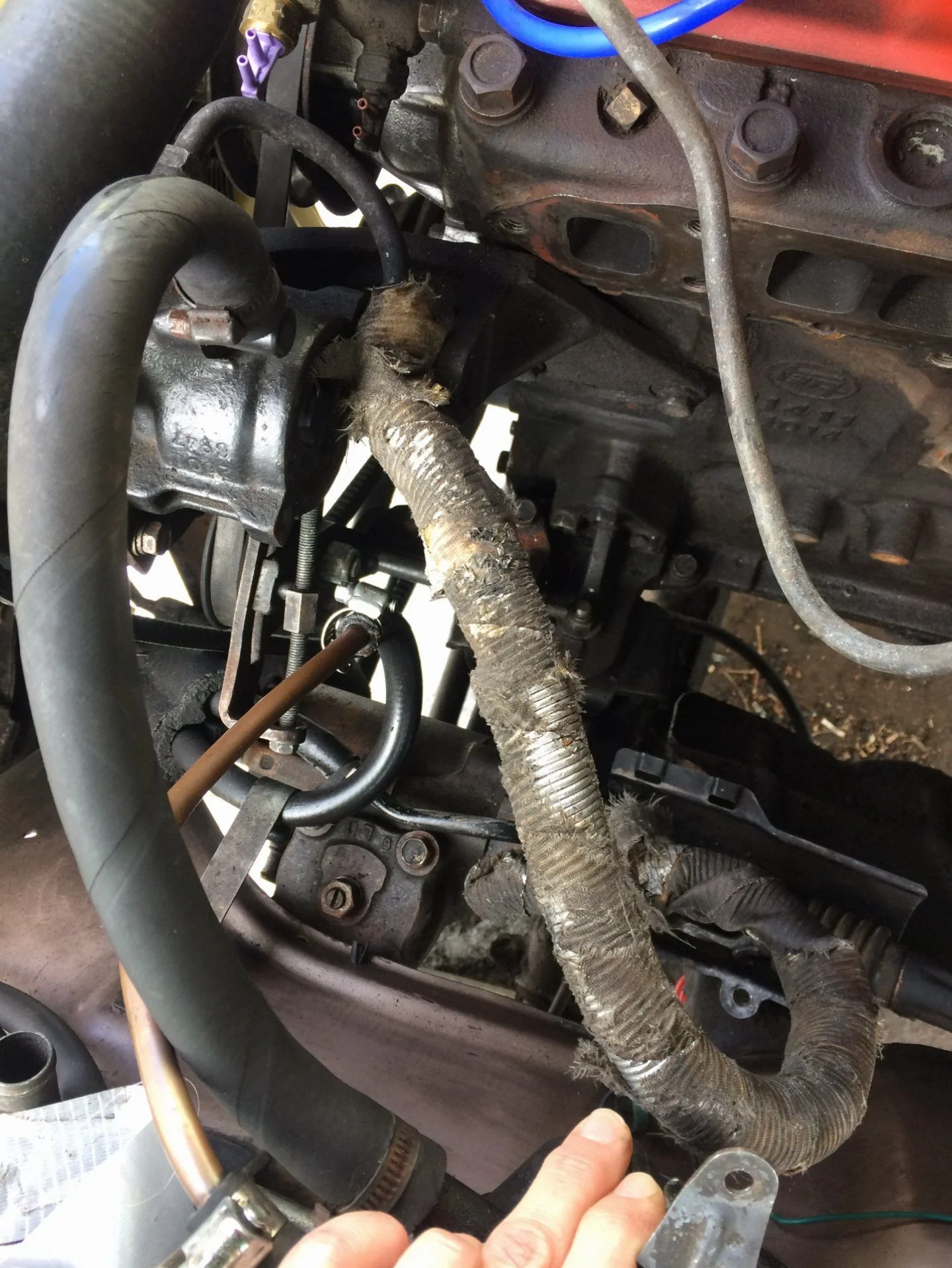

So I picked up a stock power steering pump that was functioning fine when it was pulled. I bought it because my pump is from a Volvo and its reservoir is setup super ugly and hangs off my air horn so I cant get a cold air duct in place as a result. It works and I have no issues with it leaking, its literally just an eye soar and an annoyance.
My question is before I pull it I am truing to figure out the hardline from the pump to the top of the gear box. The one on the Volvo pump comes off the side near the tstat housing and so has a funky C bend in it. I am unsure if I can simply cut it and use a new tapered washer (sorry blanking on the name, I am thinking of plumbing lines I have installed). I have thumbed through the FSM to see if there is a pix of the line and have yet to find one to get an idea of how exactly it should be lined and angled. If anyone has one I'd be grateful for a pix.
Below is the "new"stock pump held over the fugly Volvo one (the section of brass goes to the res) and the hardline in question covered in insulation.

If you have a round file or dremel, slightly 'even out' the holes where the Intake and the Exh meet and do not line up. Will ease installation so you don't get hung up on any studs, or have difficulty inserting bolts.

Ah I see what you mean. I can do that w/ my dremel, thanks for pointing it out. Guy said it was way off and he was at it for a while. Flange bolt facings appear equal. I asked them to spot face them but said they didn't need to. I laid it down and eyeballed them, hoping they are right, I'd rather not have to chop washers.
