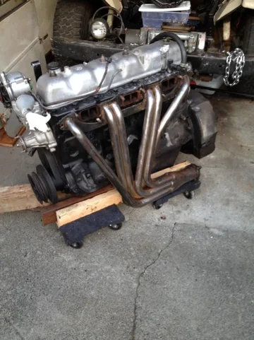

Getting a feel for header fitment on the donor 2F. Not bad...

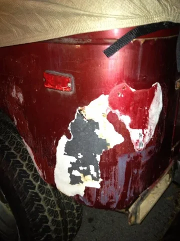

Spread a little Paint Strip Gel on the rear quarter panel to see what was beneath.
Wow, lots of bondo. But, very clean metal. Paint and bondo not adhering to old paint and/or metal. Practically can just use a plastic scraper and chip it all off.
