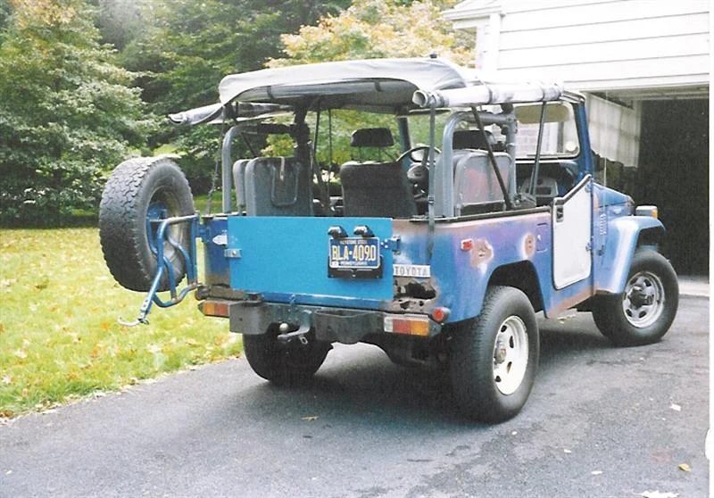

It was in pretty rough shape bodywise, he had body work done, but it was all Bondo and had sucked up all the water like a sponge and made the rust worse. . The fenders were mint though, go figure. He wanted way too much for it, but I had done my homework on the LCML and knew where to look for rust and made sure he saw me uncover every bit. He was also in a pinch because he was moving to Hawaii soon. So I offered a cashiers check for $1500, and it was mine. I think the $1500 was a loan, no less!

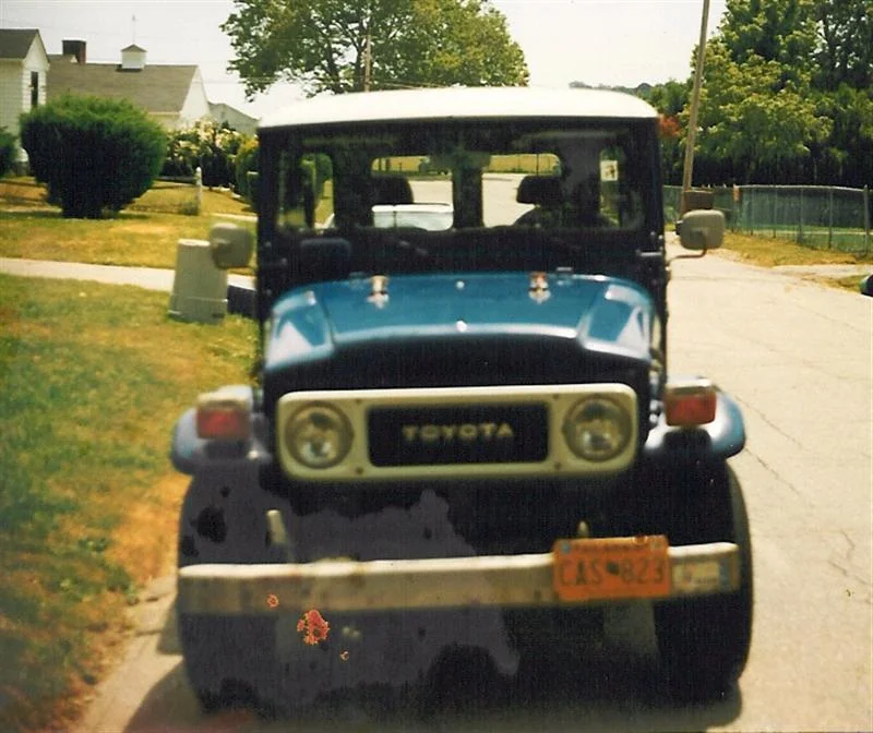

Here is a shot of it the day I bought it:
Another shot a few months later after pulling the top and bashing out the bondo that was caked in the rear quarters.

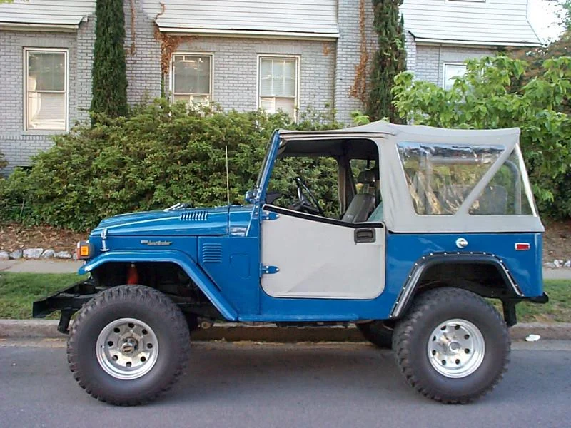

As soon as I got it home I went out and bought the first real tool set of my own, a 200-some piece Craftsman kit, Naval Jelly and a case of Rustoleum. I knocked out all the visible bondo and coated the rust I could see with Naval Jelly or Rustoleum. The engine and drivetrain were in very good shape with only a few minor leaks. The clutch was only a few thousand miles old and the tires (235/75/15's :o)were almost new. I drove it this way for the next 2 1/2 years, driving it from Newport to Philadelphia and later Norfolk to Philadelphia, which are each 5 hrs of hiway travel and it never burped once.

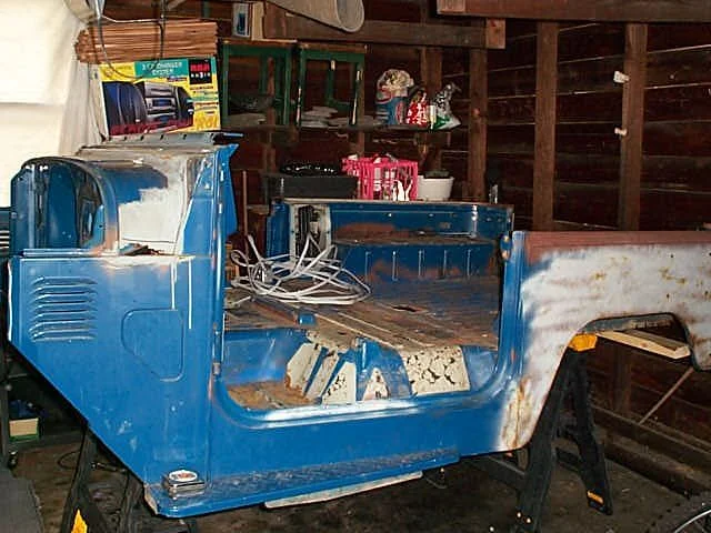

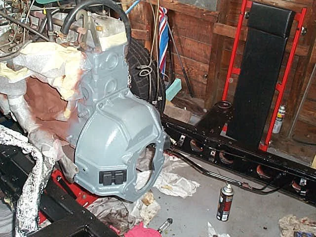

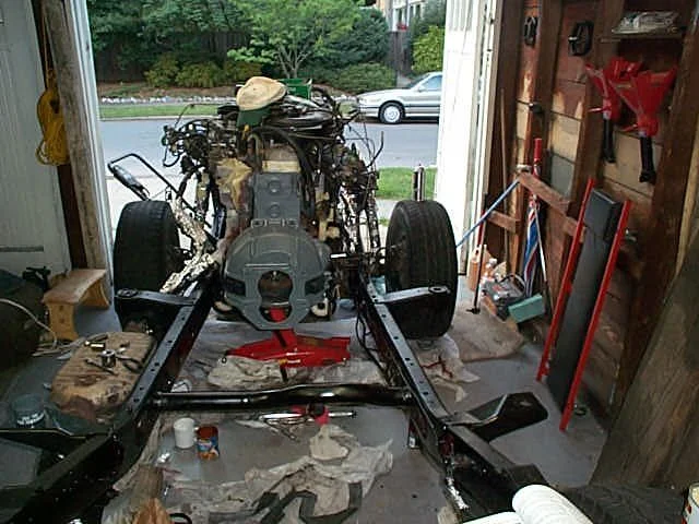

Well, 1999 rolls around and I've finally got a place with a decent garage that will allow me to do you learn about yorself when embarking on a project as involved as a frame-off resto. I am WAY more of a perfectionist than I thought and I HATE the smell of Bondo when it's hit by a sanding disk:mad:

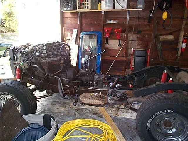

Some picks of the resto process in my small garage. I had planned to document the whole thing, but while degreasing the truck and rolling it back and forth I put my digital camera ontop of one of the tire, and well, you can guess what happened.

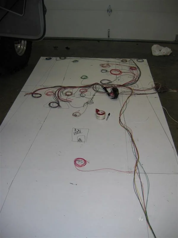

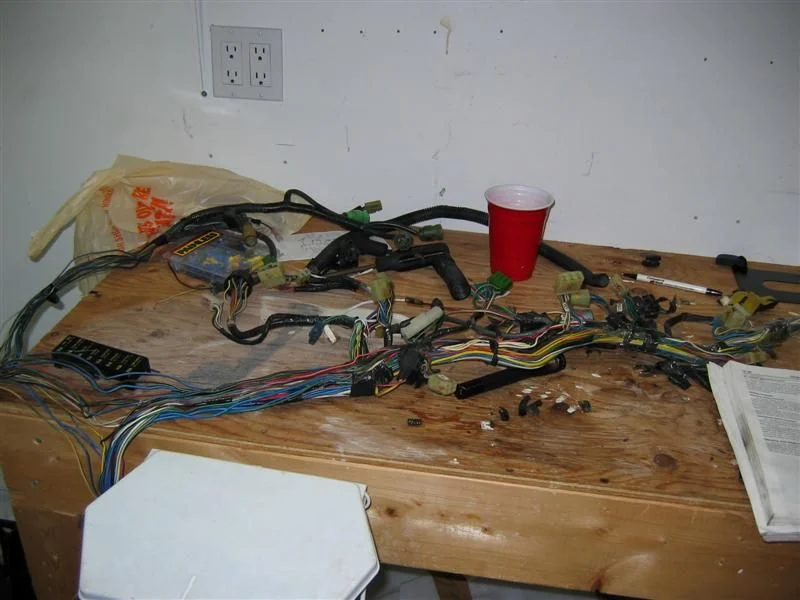

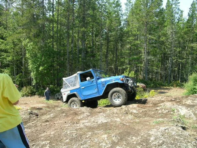

1. The old wiring harness

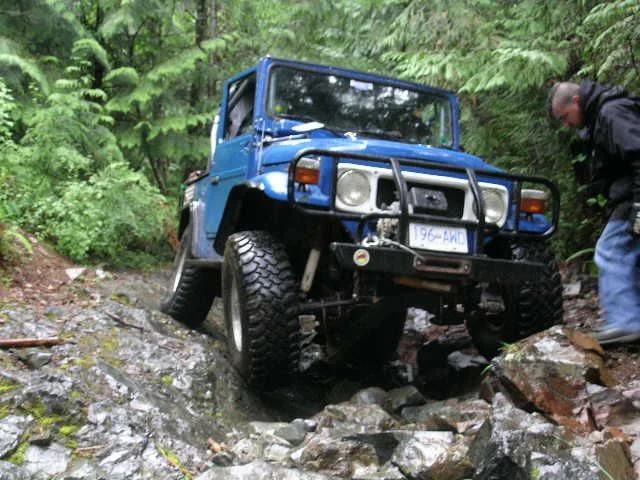

2. The first wheeling trip in BC and the birth of VI Cruisers!:steer:

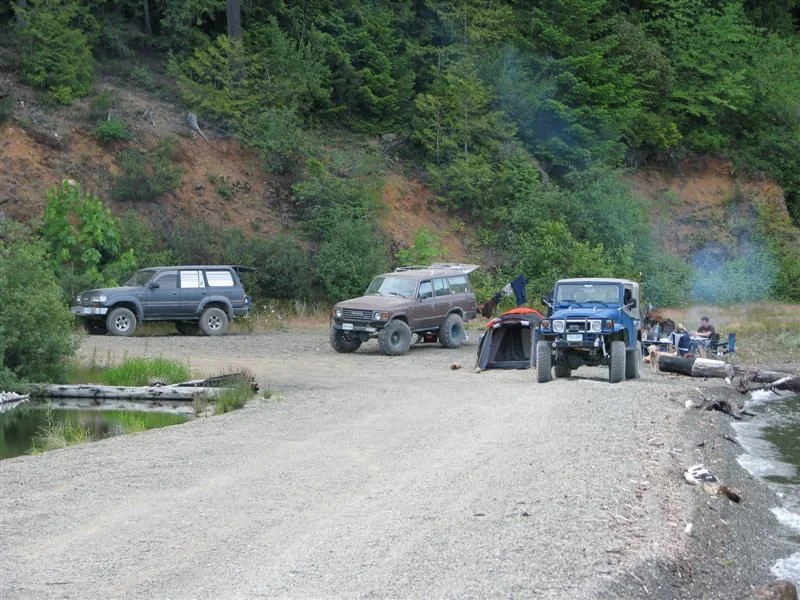

3. After said trip

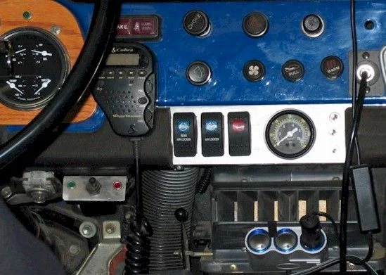

When I went to pick it up in Tacoma, WA, it wouldn't start. I was a little rusty after two years away from wrenching, but I finally figured out it there was no power to the idle cut solenoid. So I rigged a wire across the engine from the battery to the solenoid and was good to go (I stopped in at Wally World and picked up a toggle switch so I could shut off the truck without lifting the hood every time.) It was on that drive I swore to stop chasing failing wires and rewire the whole damn thing. Painless it is not, especially when you are keeping all the emissions wiring as well.

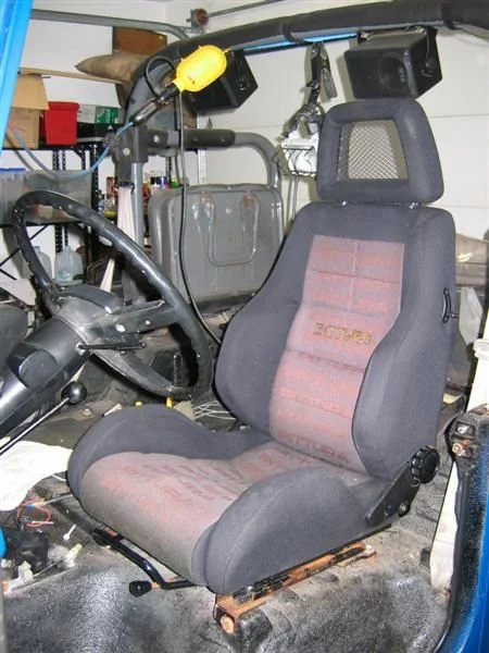

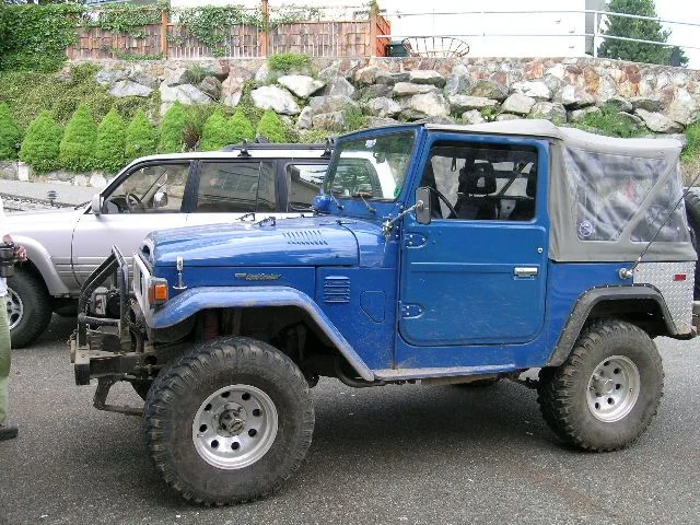

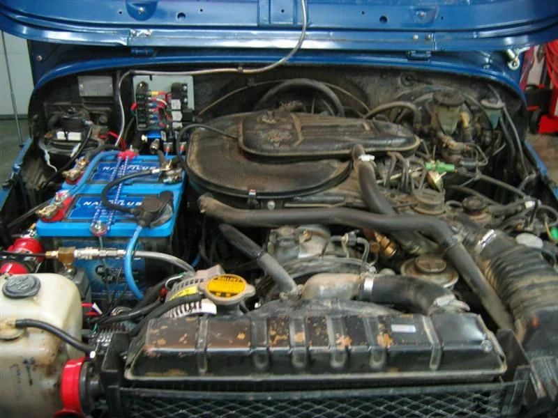

Mods over the next year and a half: comfy seats, new guages, 8274 winch, dual batteries, 4+ rear bumper, MAF front bumper and guard, new hi-output alt and new wiring.

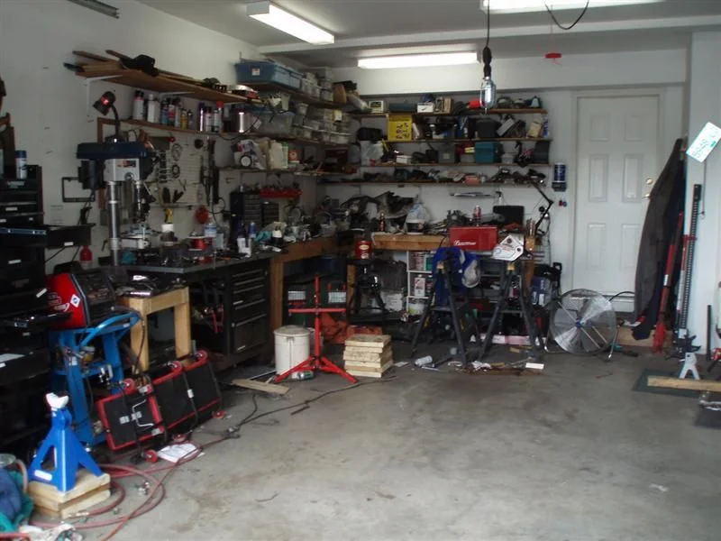

Of course, as the jobs on the truck grew, so did the need for the right tools: A true MIG welder (thanks Steph, it's the best B-day present yet!), air compressor (I can't believe I did my frame off restoration without one) and all the tools that go with it, a drill press.... you get the point and know exactly what I'm talking about... don't you?;)

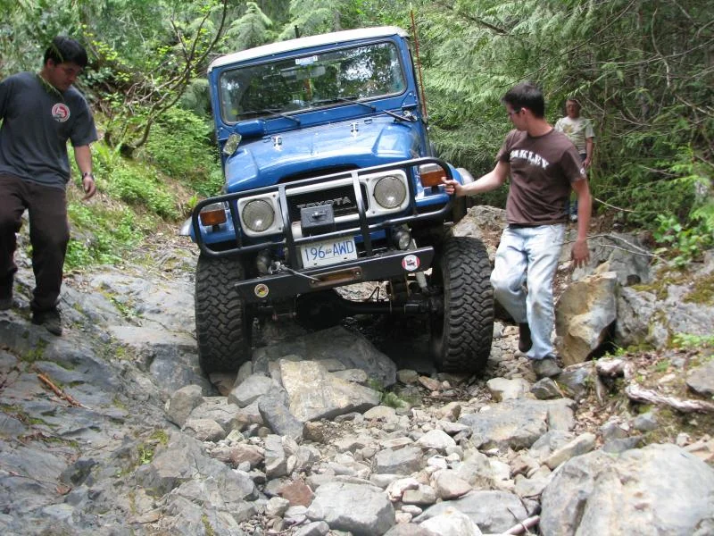

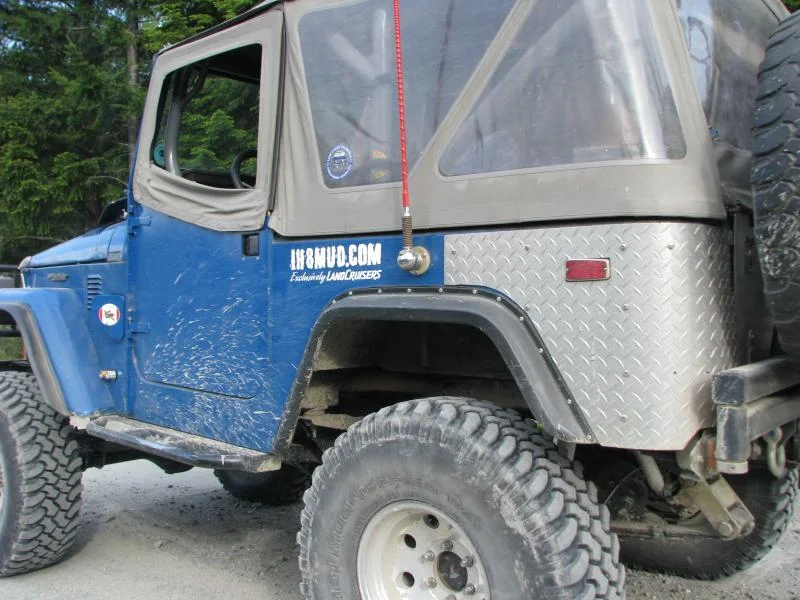

While surfing 'mud one day, I came across a thread about maybe starting a Coastal Cruisers chapter here on the Island. After a bit of discussion and interest shown, CrustyBJ60 took the reigns and set up a meeting at Tim Horton's. It was from this meeting that Vancouver Island Cruisers was born!!

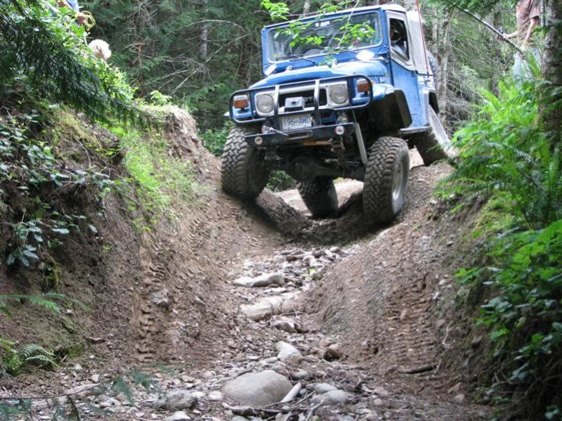

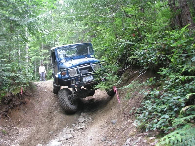

The wheeling came fast and furious after that initial meeting where I met two people that would become very special friends. One of them was Crusty BJ60 (Kirk) who I owe alot of thanks for is hands on help and lending an ear when I was formulating the neverending string of next mods on the Tick. It wouldn't be the truck it is today without his influence and help.

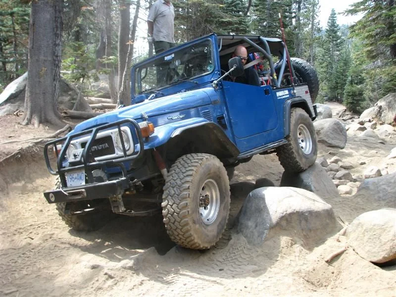

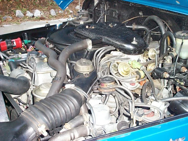

The more we wheeled, the more realized I needed more. Onboard air, 4.11 gears and ARB lockers were next.

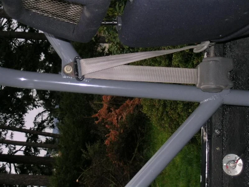

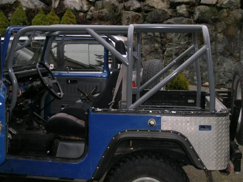

Then came the Metaltech rollcage: My first big fab/welding job that really counted.

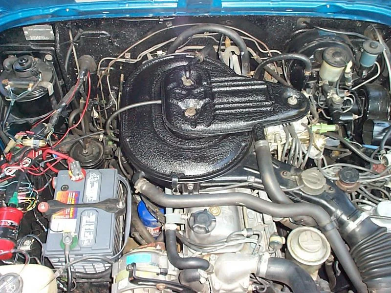

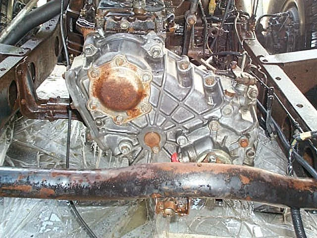

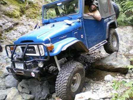

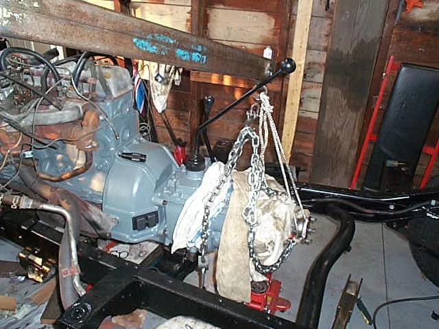

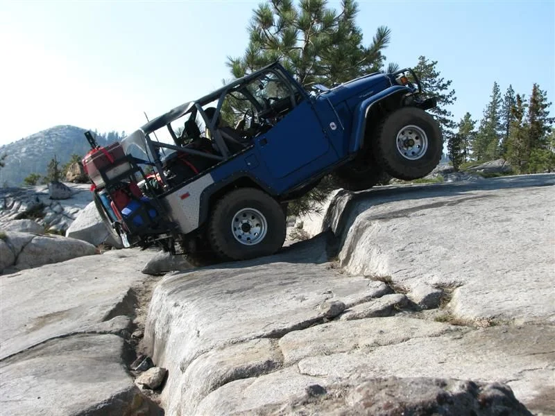

So after getting it to this point, about a year ago, I had planned to make Rubithon '07 with an Aussie four speed guts in my late model case with an Orion bolted on for an 81:1 crawl ratio. However, that was not to be and the tranny and T-case didn't get bolted in until August '07.

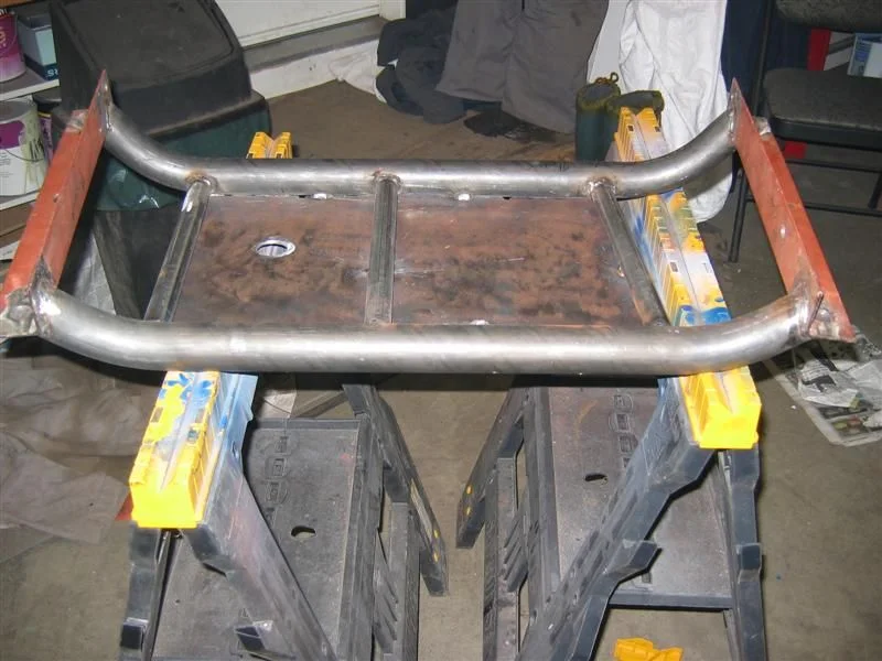

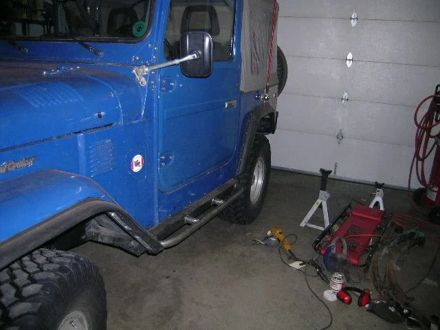

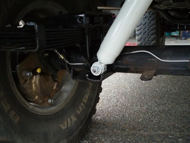

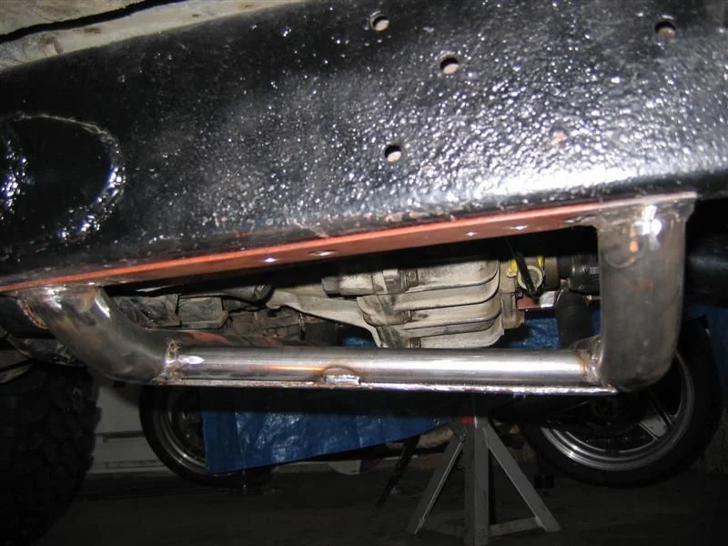

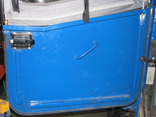

In the meantime, I built some sliders and a variation of Poser's skid plate to protect the vitals underneath as well as some 1/8 plate half doors that work with my soft top door tops.
Mark from Mark's offroad built the tranny and I built the Orion and put it in. My friends Chris and Kirk got me some sweet anodized shifter knobs from Mule offroad for my birthday that look awesome on the shifters (thank's guys, you always know the right gift for me:o)
