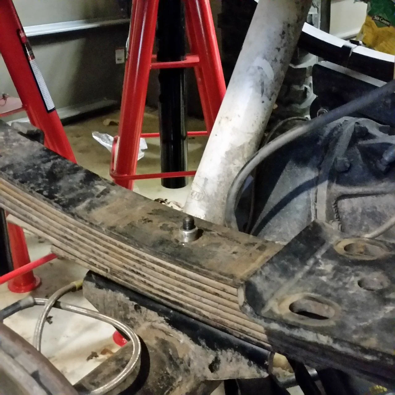

The axle is still going strong, but I will add a public service announcement:
Check your Ubolts after your 1st day or 2 wheeling, then periodically thereafter. Otherwise, you WILL shear a spring center pin. I heard a thumping from the passenger side and asked someone what that sound was. He said "It's your tire rubbing on the leading edge of the rear fender". I said "Thant's not right, the tires never get close to the front of the fender..." Lo and behold, the axle was waaay cockeyed. We secured the axle to a tree with a tow strap and drove the axle back into place. The ubolt nuts were finger tight!:doh:
I think I under torqued mine to begin with. I am using 5/8" ubolts and they should have been torqued to at least 120lbft. I went to 130lbft and will make checking them part of my prerun checklist along with knuckle and hub studs.
Oh, yeah, 10mm hex cap bolts fit perfectly in the RuffStuff spring perches. I had to round over a nylock nut to fit in the ubolt plate as well.
