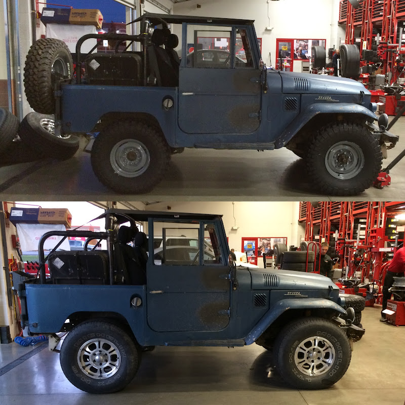

New Shoes
Got these:
https://lh5.googleusercontent.com/-SJ4Lghp4iis/Ug0amvCJ7BI/AAAAAAAAHq0/kTG3iTpCzoY/s800/IMG_3327.jpg
back from the powder coater and switched from Michelin LTX 285/75 16 to BFG KM2 33x10.50 15.
https://lh3.googleusercontent.com/-iFNeiJYDPeU/UoQvGmH87ZI/AAAAAAAAH0M/CgomGgzps1w/s800/NewShoes.jpg
Looks a lot better but they tuck better under the fenders and have much more tread for the trails and the Idaho snow. Unless I get into a quarry or start jumping this rig, I won't NEED the OME lift (though I probably still will). What was immediately noticeable was how much easier these are to steer than the 285s. No power steering and the low speed driving is so much better. The ride is actually better too with the lower unsprung weight.
I cannot recommend the blokes at Discount Tire enough. Switching from alloys back to steel necessitated new lug nuts which they threw in for free. They also mounted the older KM I already had as a spare for no charge. This is only one in a long list of times that DT has really done me right.
