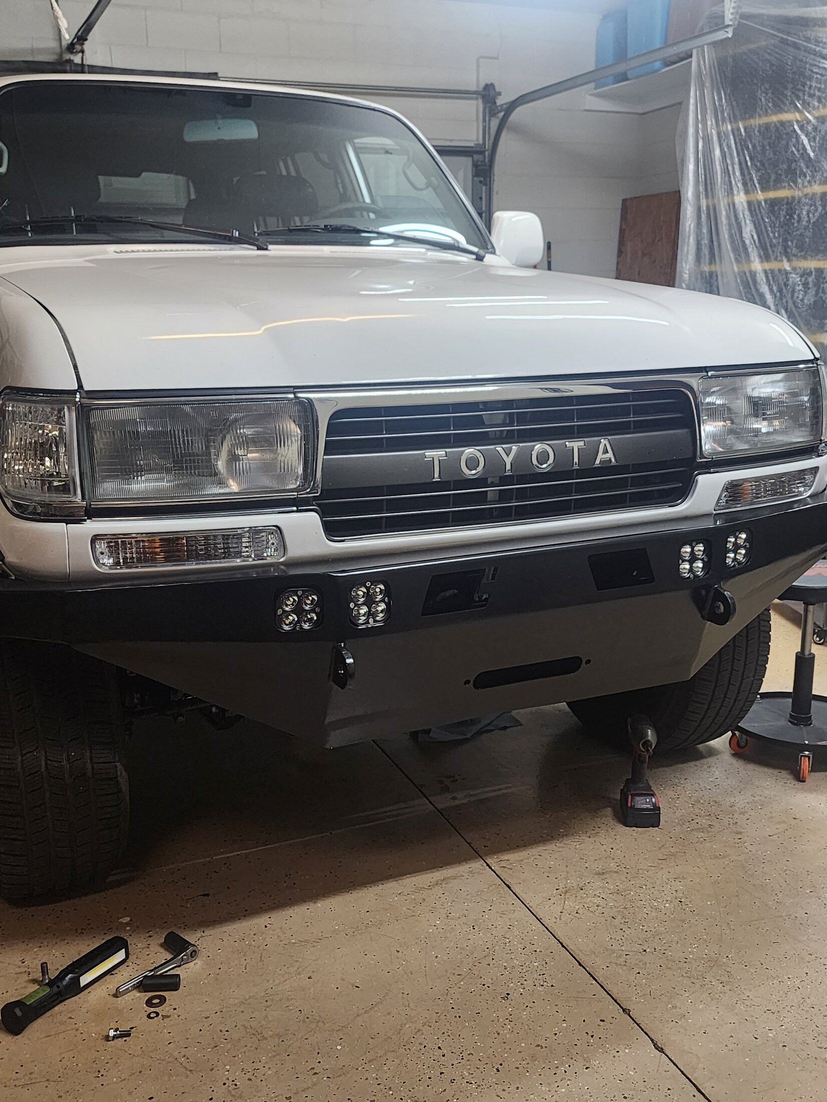

Sunday was bumper day. Finally got this welded up and painted. Been sat in my garage for at least a year. Petty happy with the end result. Now just need to procure a winch.
