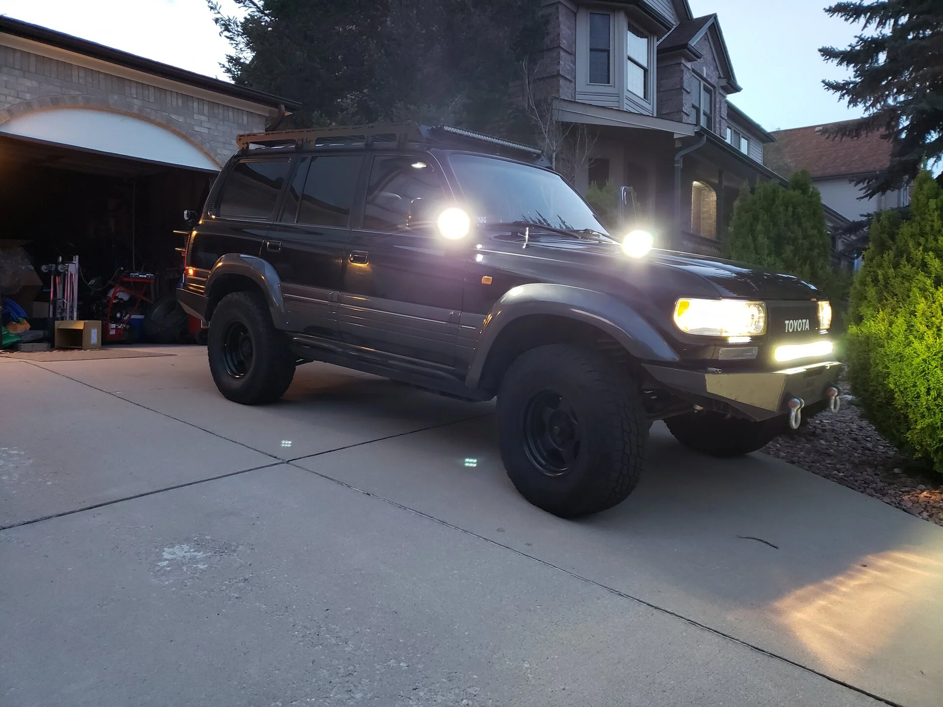

This picture was taken the day it was delivered.

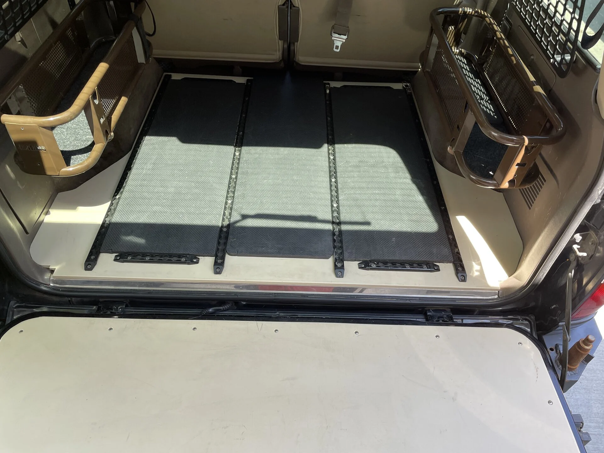

The plastic floor and L-strap system.

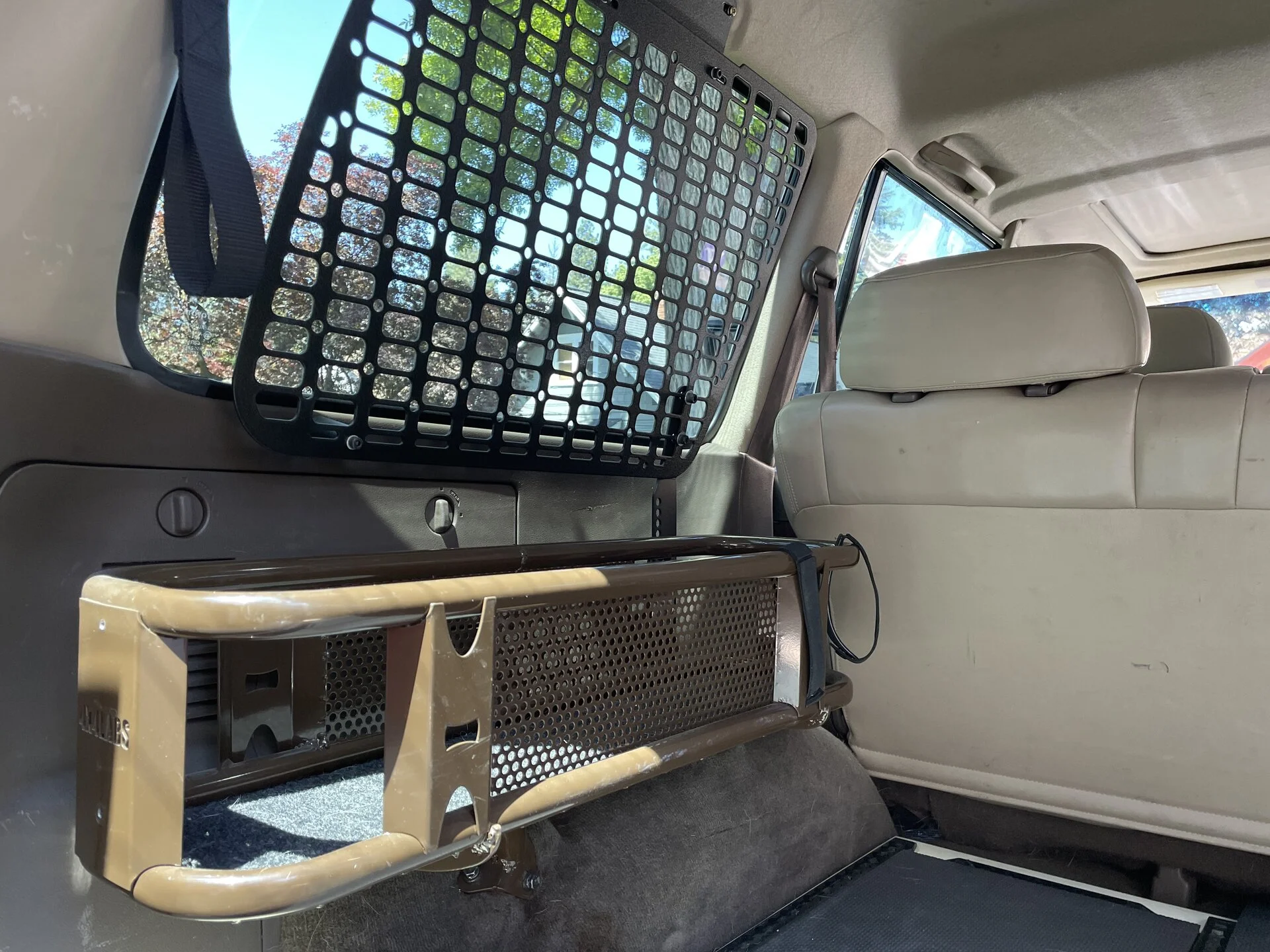

Window MOLLE racks

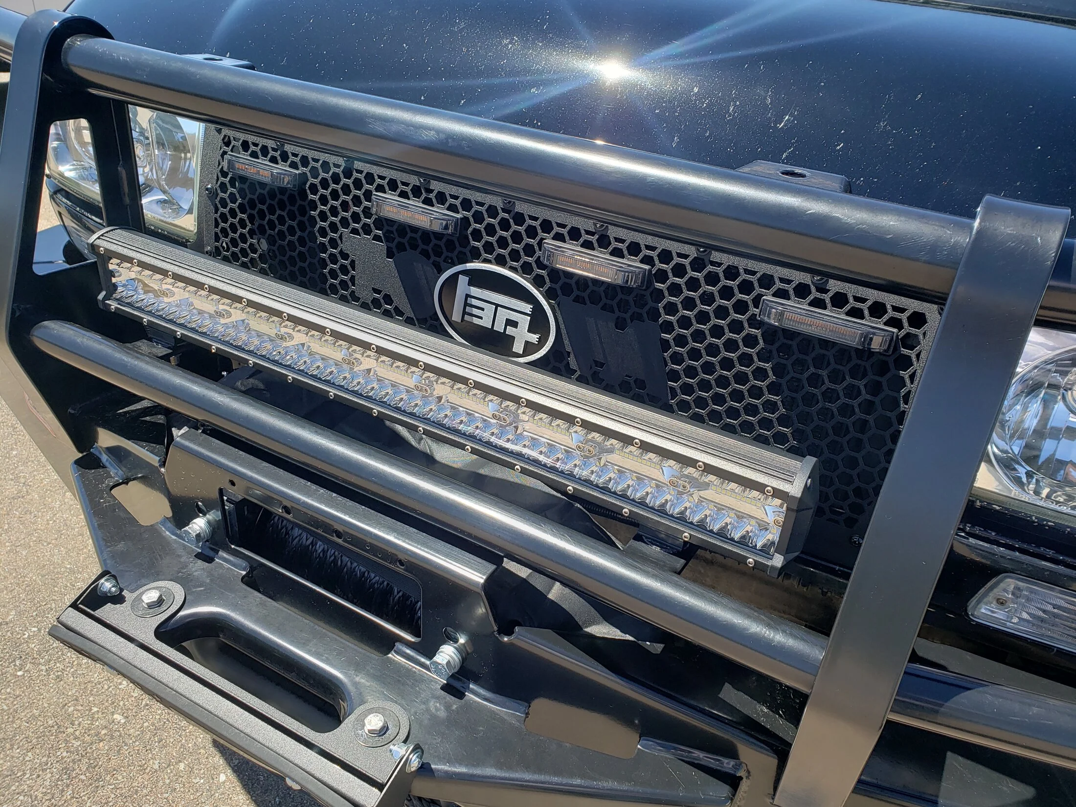

The front end

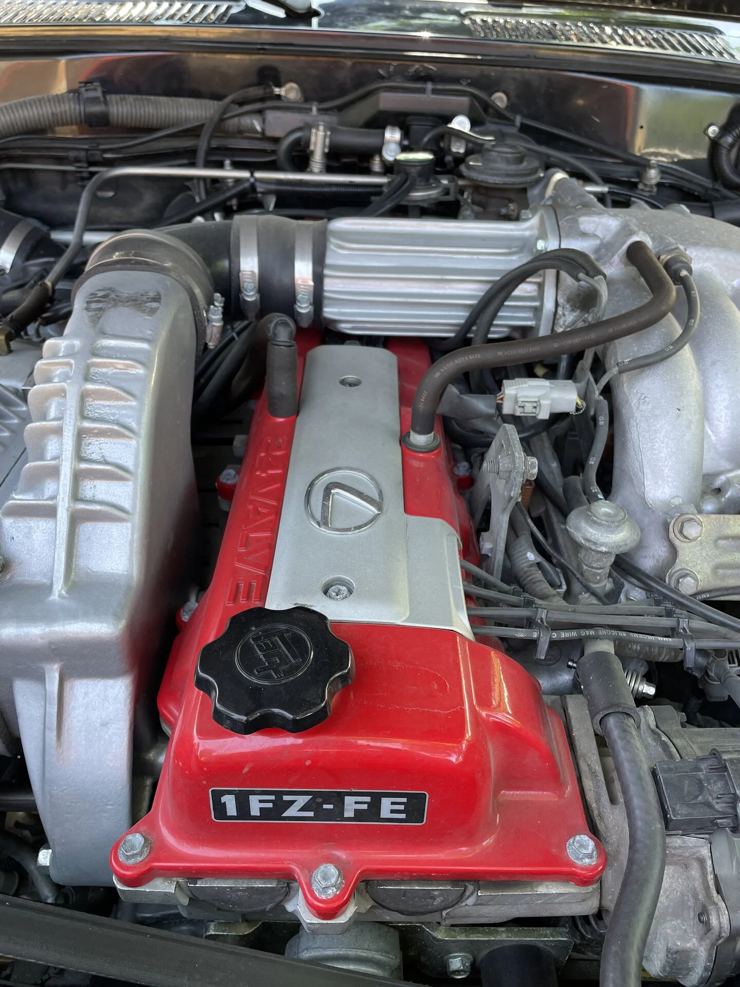

The engine

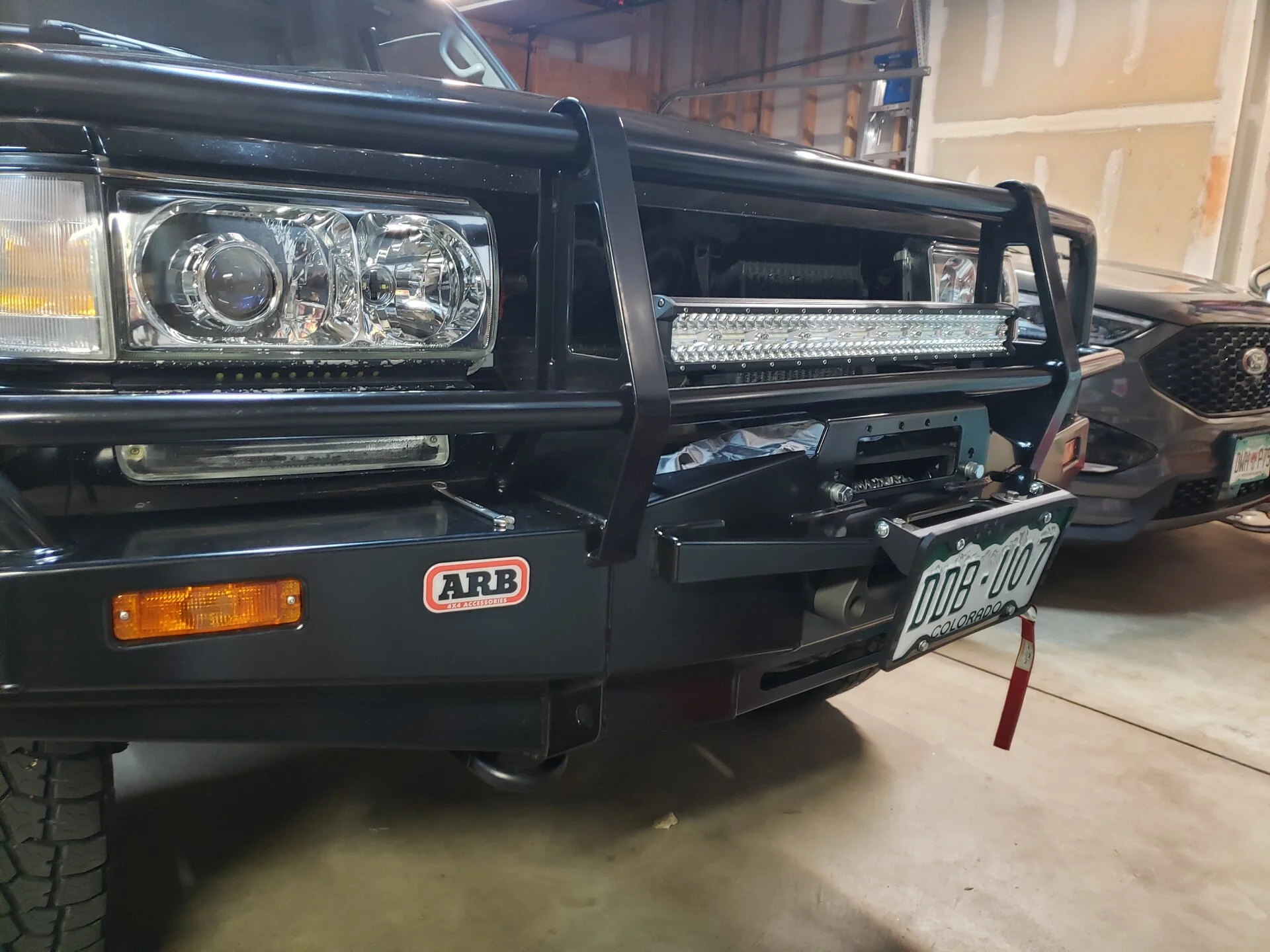

  • Replaced front NWTI bumper with ARB Bull Bar, and added a Warn winch, Slee offset hawse fairlead.
    • This project was a debacle. I tried to install two different winches in the NWTI before coming to the conclusion that the bumper was assembled incorrectly, and ultimately replaced the bumper with an ARB after determining that the NWTI’s welds couldn’t be trusted on the trail.
    • 32” light bar was difficult to fit, so it ended up on top of the bull bar, above the hood line.

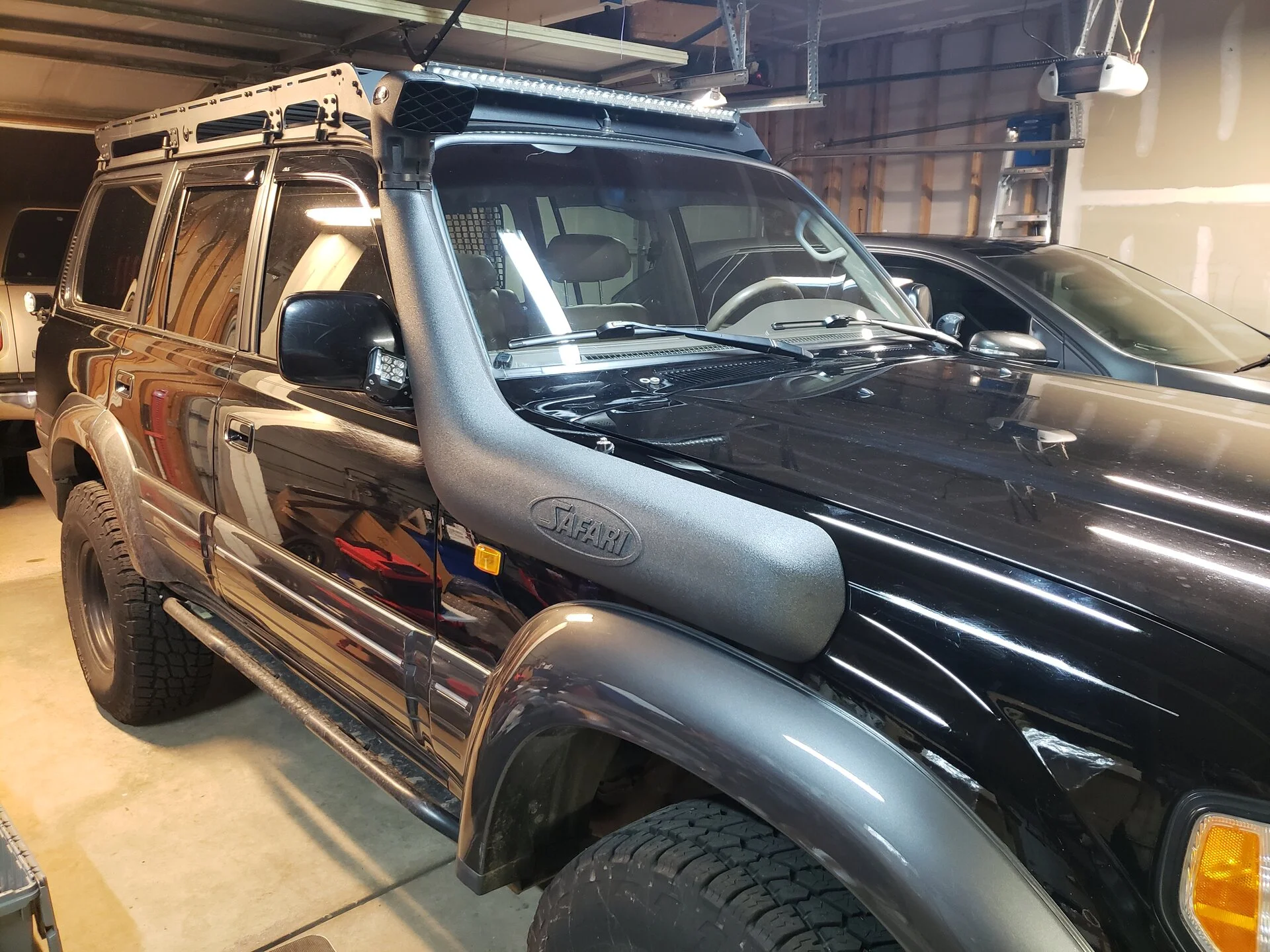

  • Installed a Safari snorkel. What a pain! I got it for Christmas, and took two months to decide whether I could bring myself to take a hole saw to a factory original fender. Shop estimates for installation between $400 and $800 motivated me to do it myself.

  • Replaced front light bar with one that fits inside bumper, where it belongs. Also installed a front flip-up license plate holder.

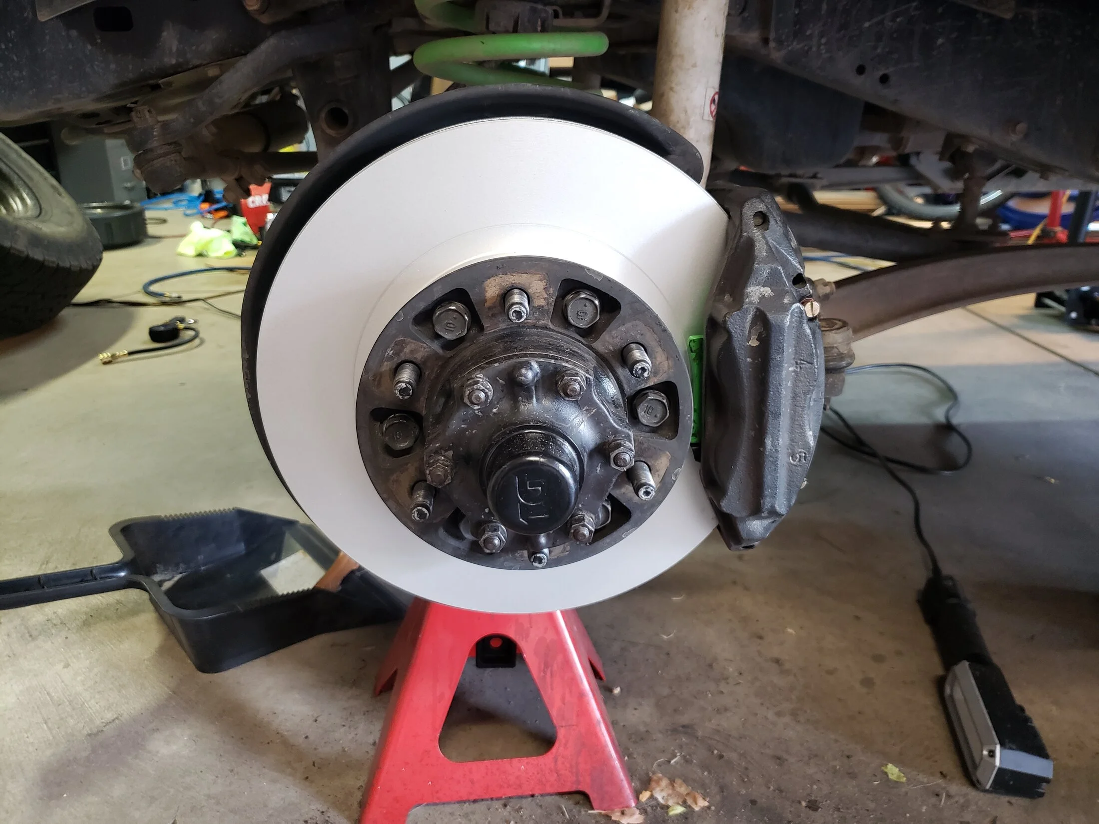

After my last trail ride, I heard the horrible, tell-tale noise of a failed brake pad. Read the incredible story of the best customer service in the business here.
Over the last week, then, I installed F&R EBC Greenstuff brake pads and new rotors. I found the RR caliper was frozen, so I replaced them both, and while the lines were open, I did the rear brake hoses, with the longer center hose from a 1996 T100 (I had already done the front a few months ago). I've only been out to bed them in, so it's too early to say how much I like them but they feel pretty good so far.
I also adjusted the parking brake, which pulled up too high since I bought it. It took me two tries to get it right, but it now holds firm with eight clicks. It'll need a new cable if it ever needs to be adjusted again - it's all the way at the end of the threads.

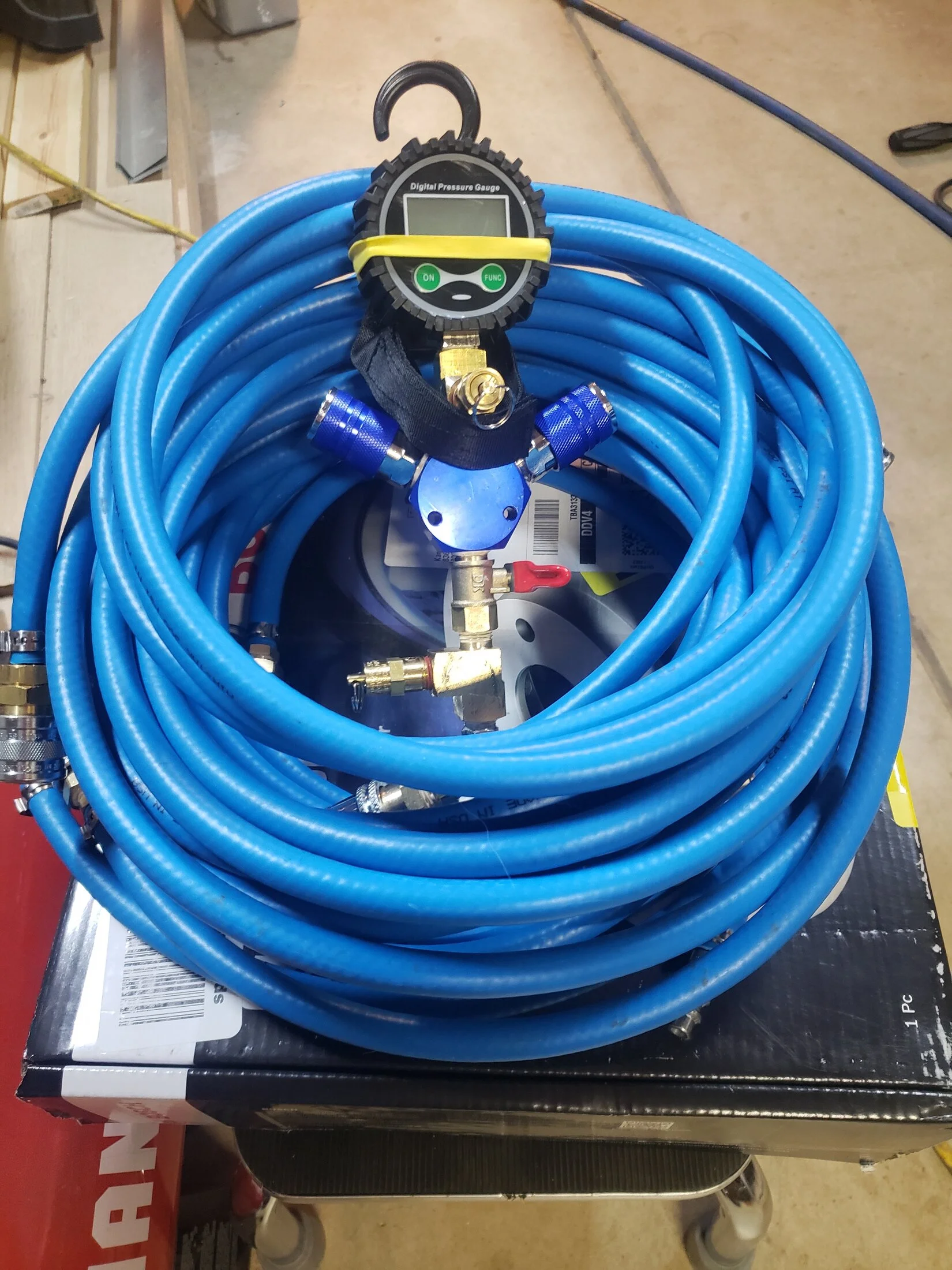

This week I also finalized a four-tire filling system. I can go from 16psi to 34psi in five minutes, not including the setup time (I need to time that yet). This all started because a friend offered me this top-grade air hose that he snagged before it went in the dumpster at a warehouse he was closing down. With the free hose and a bunch of free fittings, I'm only in it for about $125.
I spent the whole day on the trail today, and my new brakes are terrific! I'm going to get Greenstuffs for my pickup, too. I especially like the improved initial bite.
I timed the full tire refill process today. From the moment I put my hand on the hood release to the time I closed the hood: 13:35.
