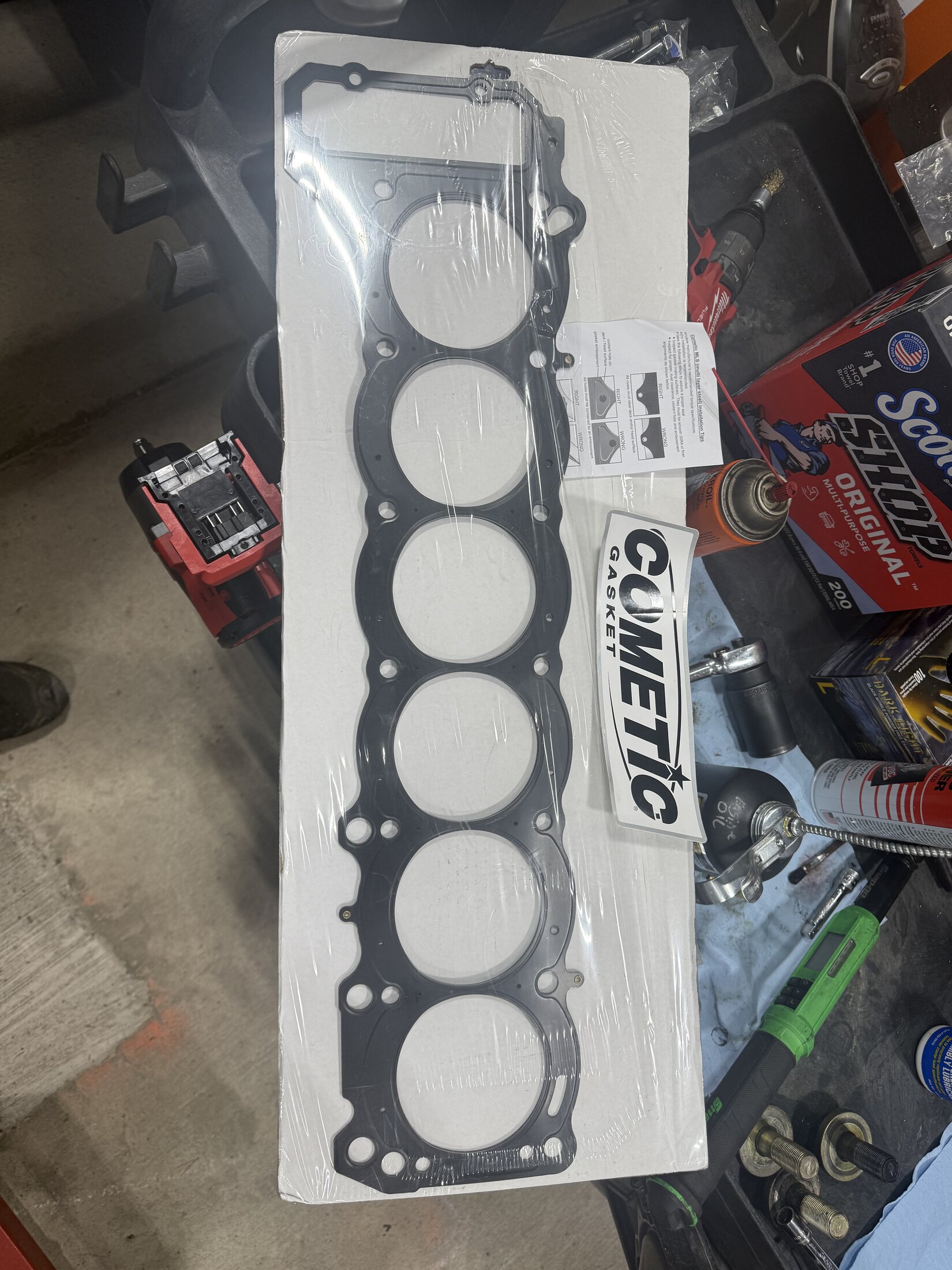

Got a cometic going on this one, it is the new MLX gasket. Let’s see how it holds to 14psi!
