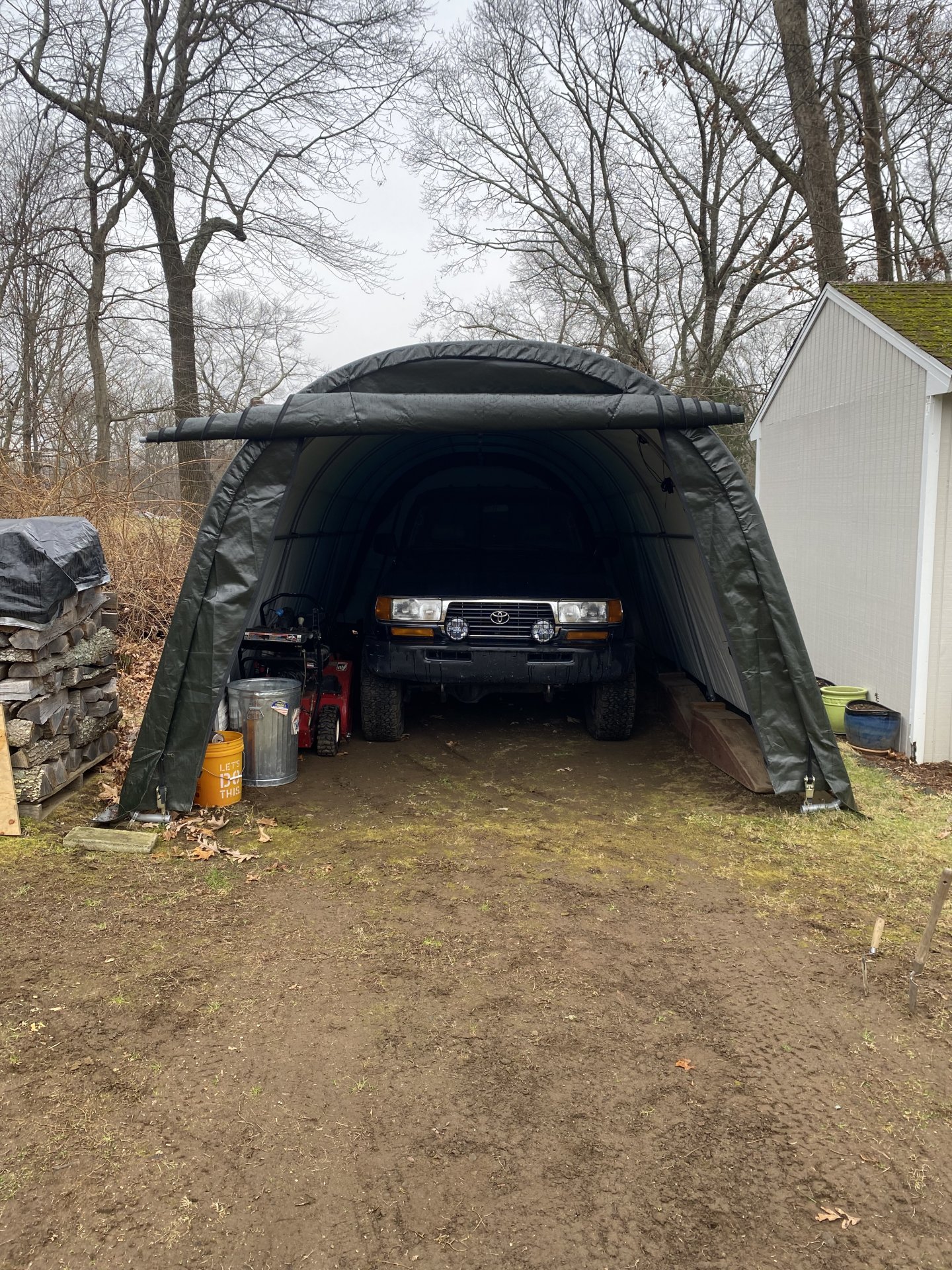

Put away for the winter. Sad… Salt roads might as well be lava.

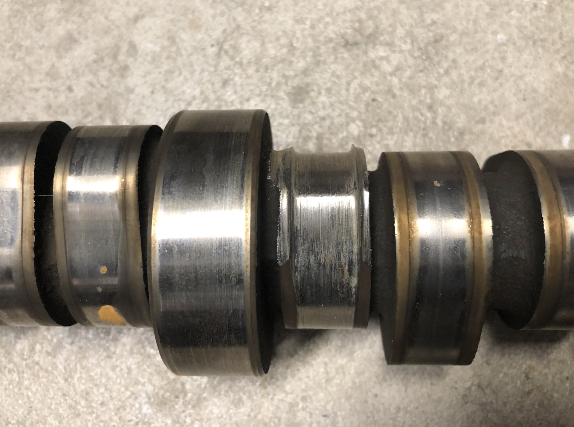

Been helping my buddy fix his 2012 Ram 1500 5.7 hemi, come to find out they have a very common problem where a lifter goes bad and grinds against the camshaft. So put my own rebuild on the back burner to help save him $3k. Funny how after 100k miles many of these (Ram) trucks eat their camshaft, and I just had my cruiser motor rebuilt and the entire head & cams were still all in spec. 300k miles on my motor and ready for another 300k more. I already loved my cruiser but doing this job has made me just absolutely astonished at Toyota engineering and how well they did.
FYI the ground down portion should look similar to the lobe on the left. Most of the lobe had been ground down and it was almost completely circular. Sheesh.
