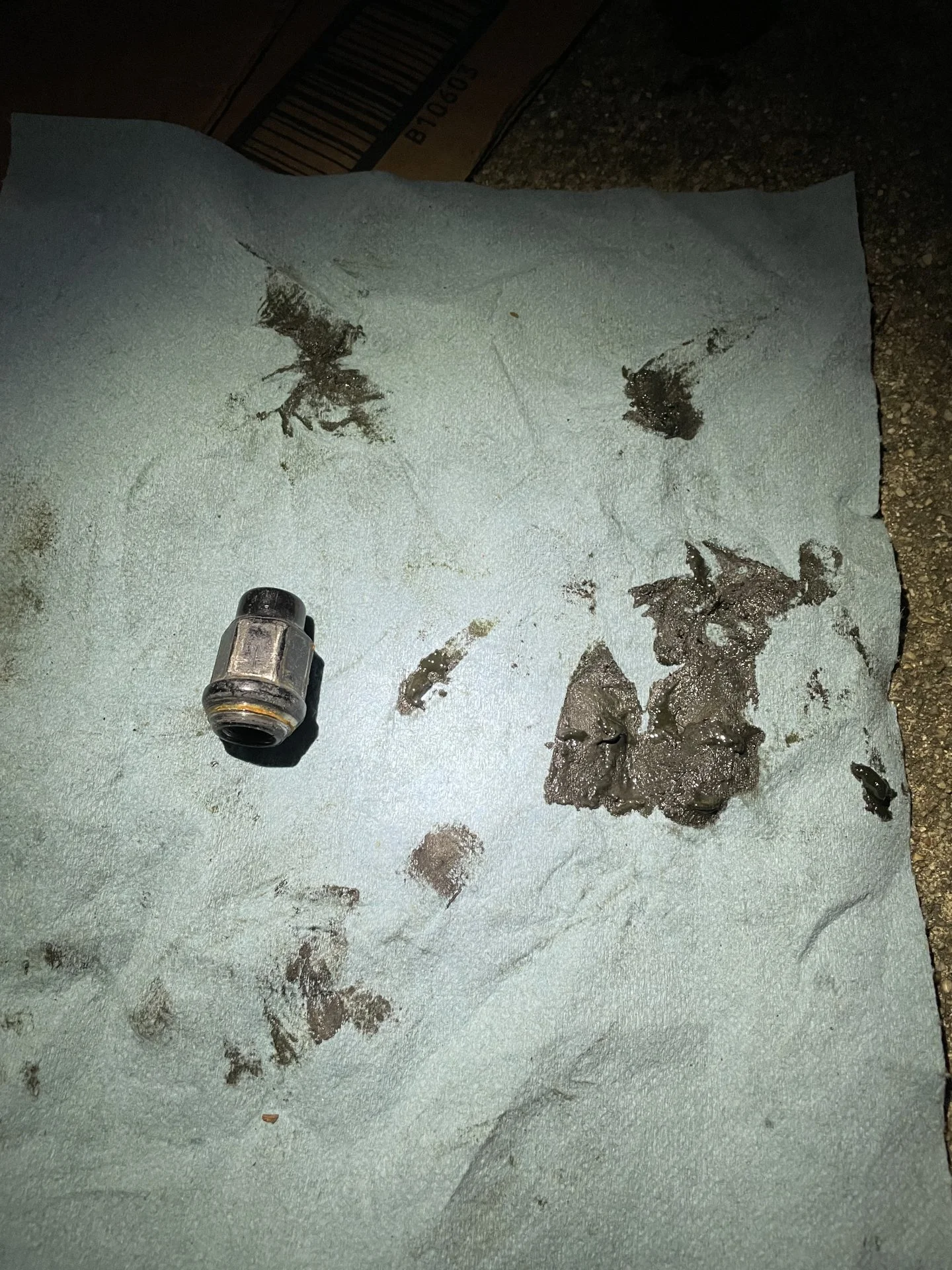

Slightly alarming quantity of metal shavings on the front diff drain plug.

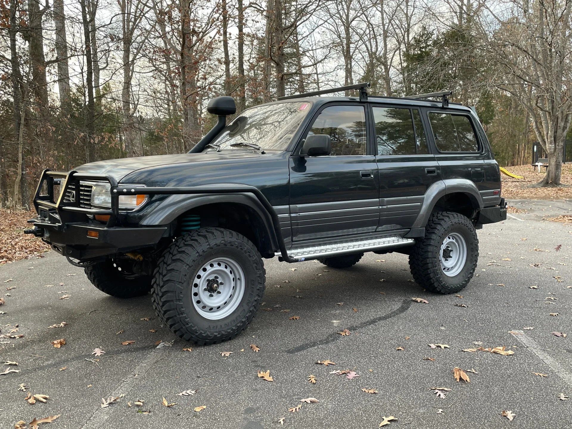

The pretty good looking steelies have the same backspacing as OEM (around 4.25")
Tires are 35x12.5 R17, wondering if I can find steel rims that have a backspacing of ~2.75" (to accomplish the same thing as these spacers)
spacers are the devil...cast them into the pit of fire they came from
yeah, I would like to
I did a little research, but this is my first time really looking at tires / rims / vehicle fitment
It seems that the OEM steel rims are 7.5" wide (some people say that 7.5"rims are a bit too narrow for 35" tires)
The spacers are 1.5"
I would want to try and source 17*8 rims with backspace of 3"?
