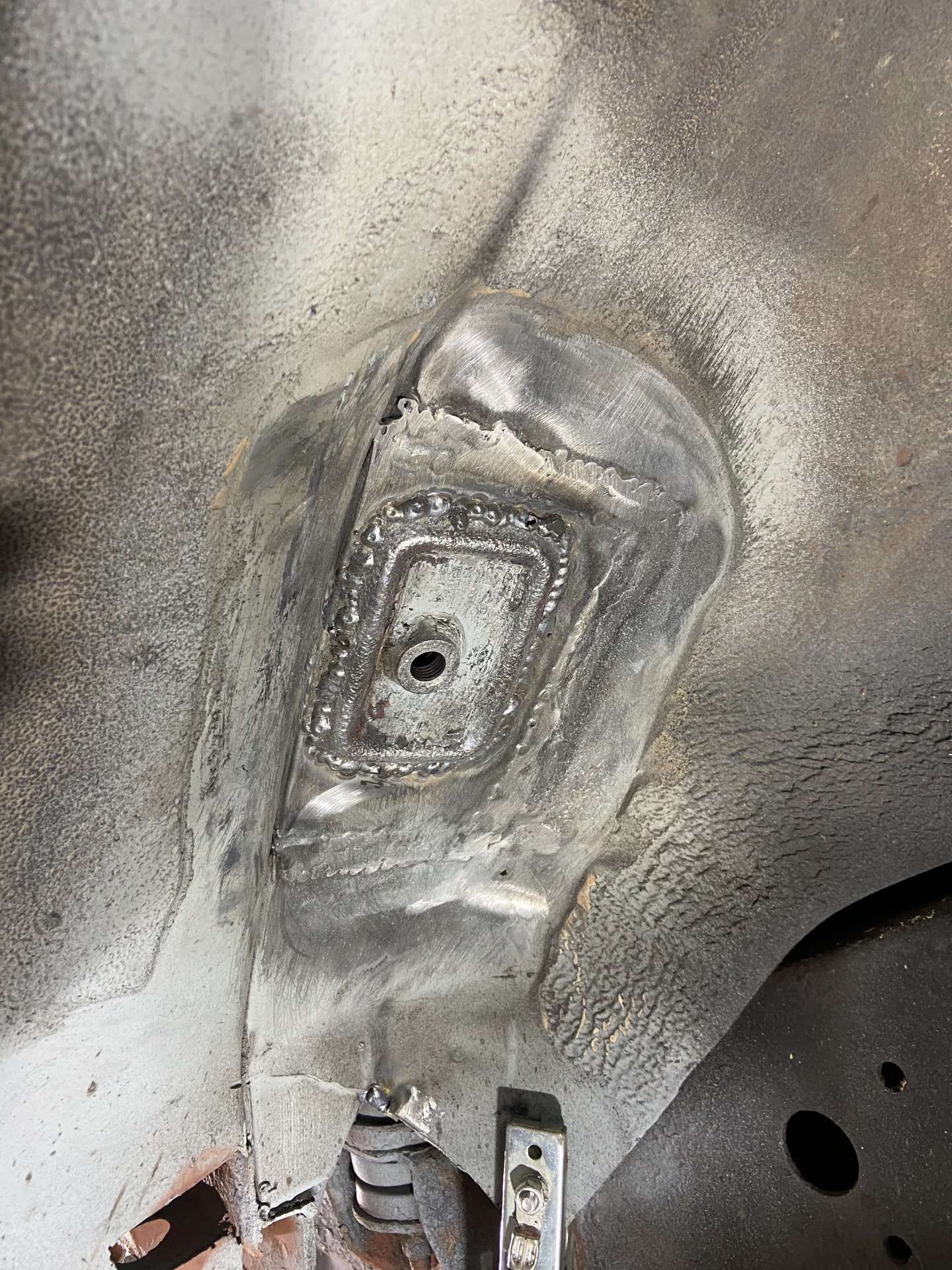

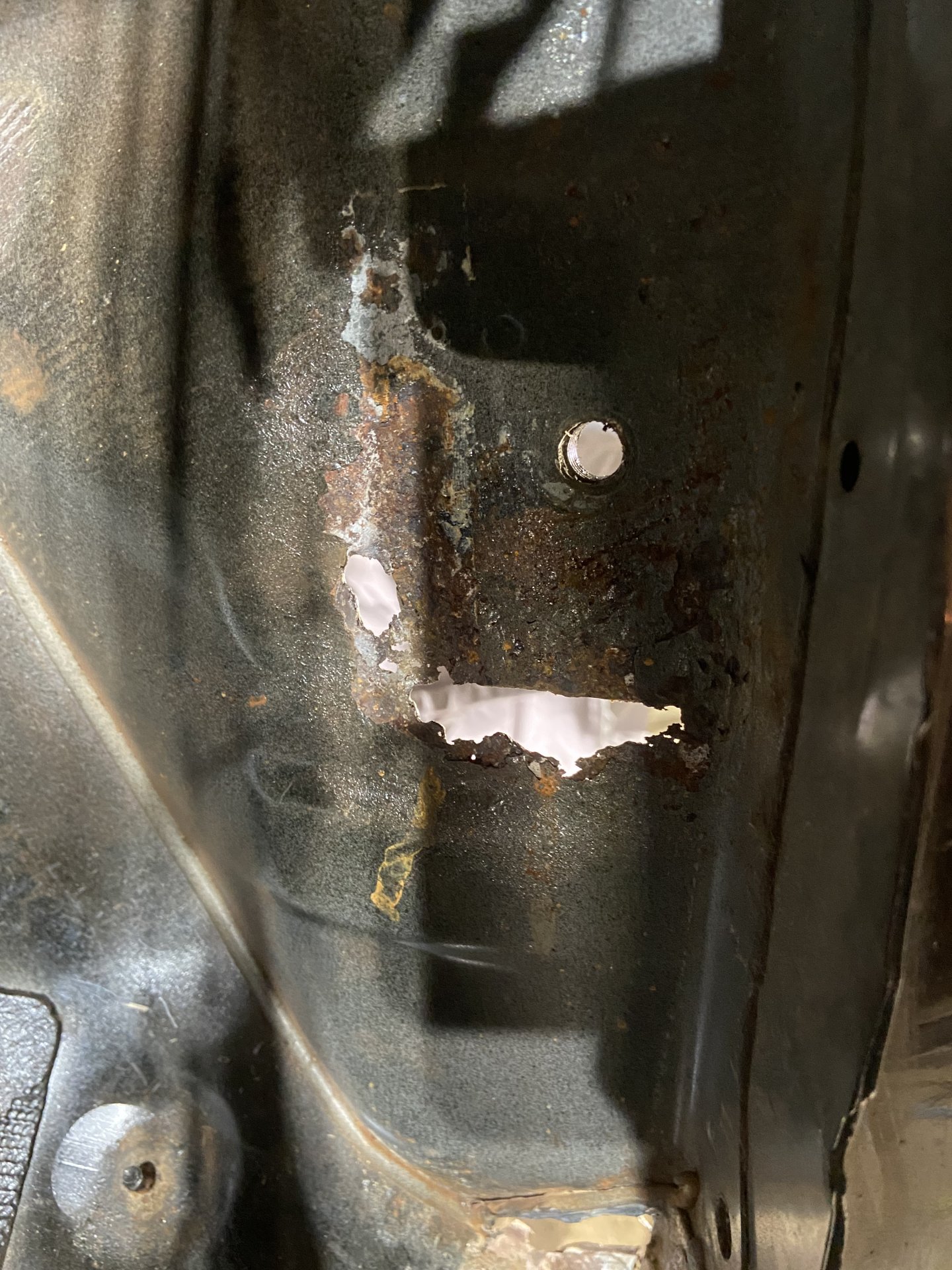

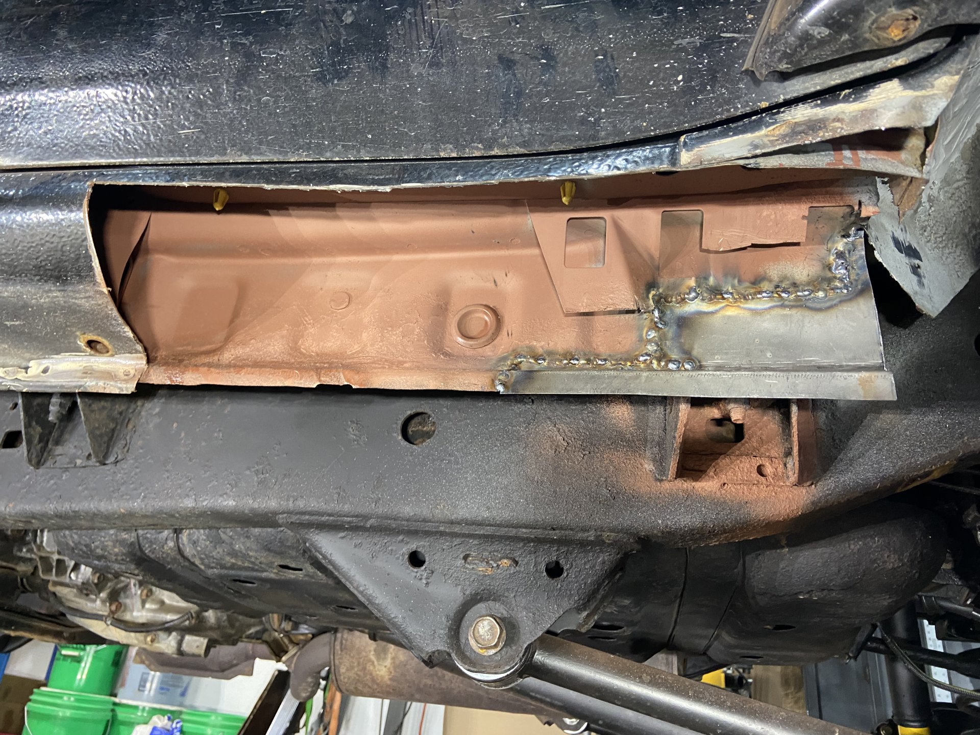

My thanks giving fix a thon is now bleeding into a Christmas and new years fix a thon. Decided to poke at the rust spot on the driver side rocker. Turns out, the rear seatbelt was badly rusted as well, a must check if you have not already. So… I started cutting… And cutting… then Panel beating and bending. I think is was 10ish individual parts that I ended up making and welding back in. I also reproduce half the body mount on the back side and the small structure parts inside the rocker. I think it will turn out pretty nice in the end. I will update when it’s done. I’m sure there are better ways to do this, but it’s what I came up with here. Lots of seam sealer to cover the welds in the wheel well and under the truck. If there is interest I can share more photos as well
A little bondo and some primer. And it looks pretty good. I was not able to keep that factory seam but I bet no one will notice. Waiting in raptor liner to blend it all together. I suppose I should do the other side while I’m at it here. This is good practice for my super rusty ‘60.
