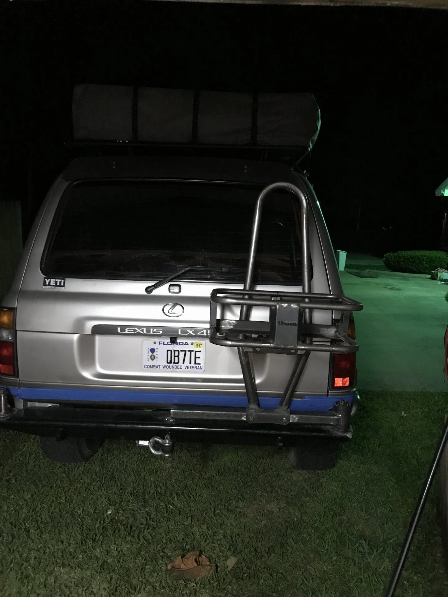

Another better shot from my 3 day trail ride. I was hurting for fuel starting the 3rd day so it prompted me to finish up the dual swing outs on my rear bumper so I'm able to carry extra fuel. I usually carry my extra fuel on my trailer which I didn't bring out

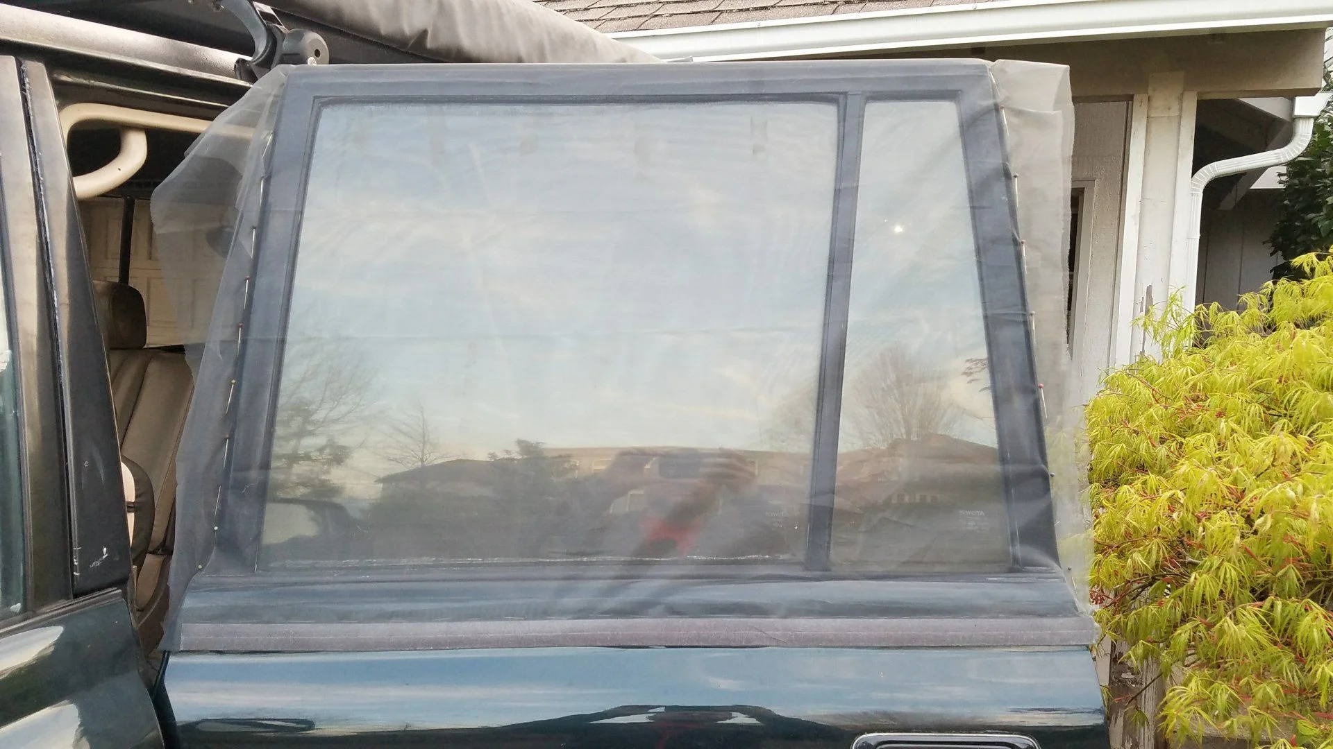

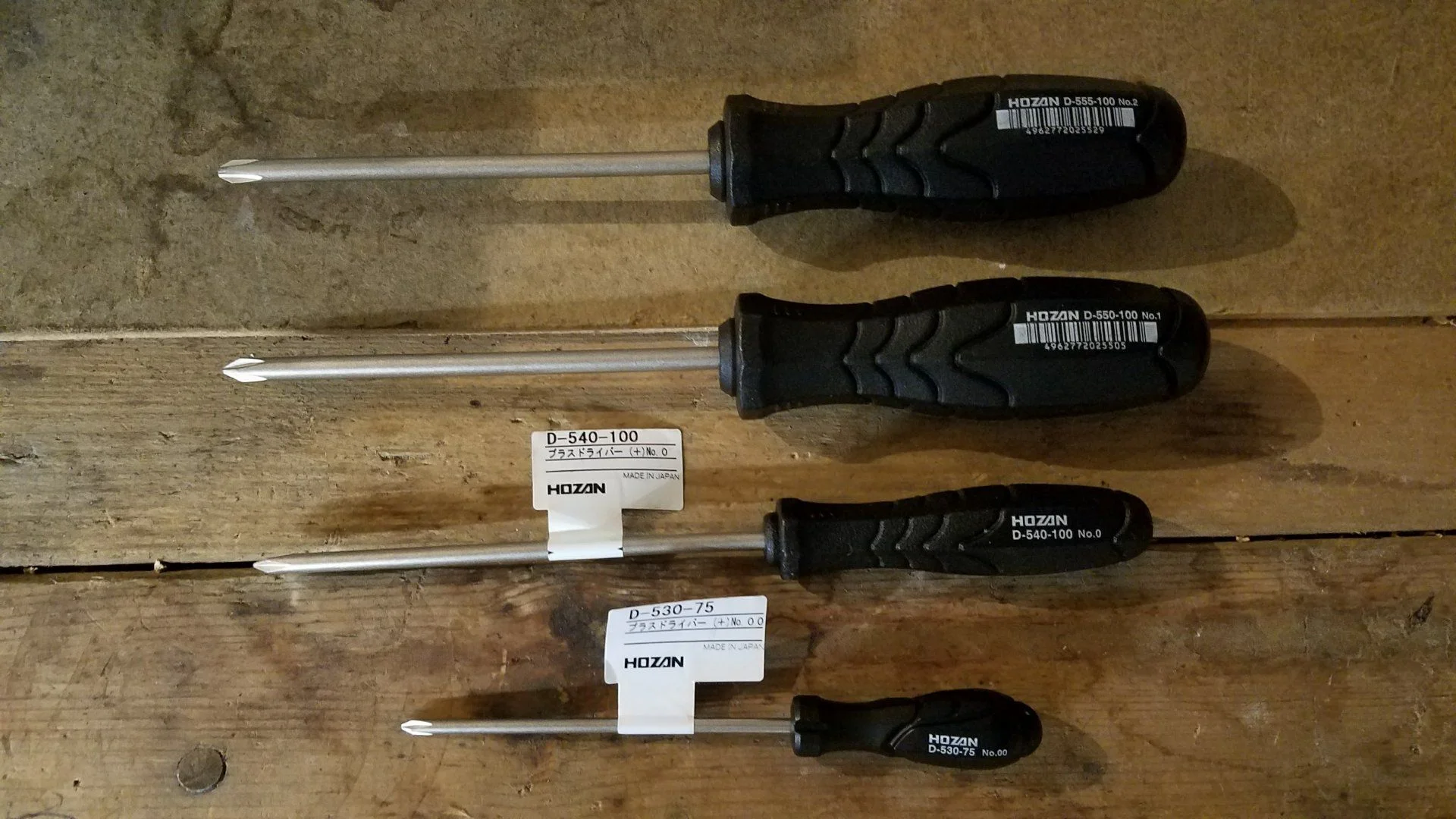

Got suckered into buying more stuff by IH8MUD. JIS screwdrivers, a Baofeng Red UV-5R V2+ (USA Warranty) Dual-Band 136-174/400-480 MHz FM Ham Two-way Radio, Improved Stronger Case, Enhanced Features, and bug screens which I'm making myself.

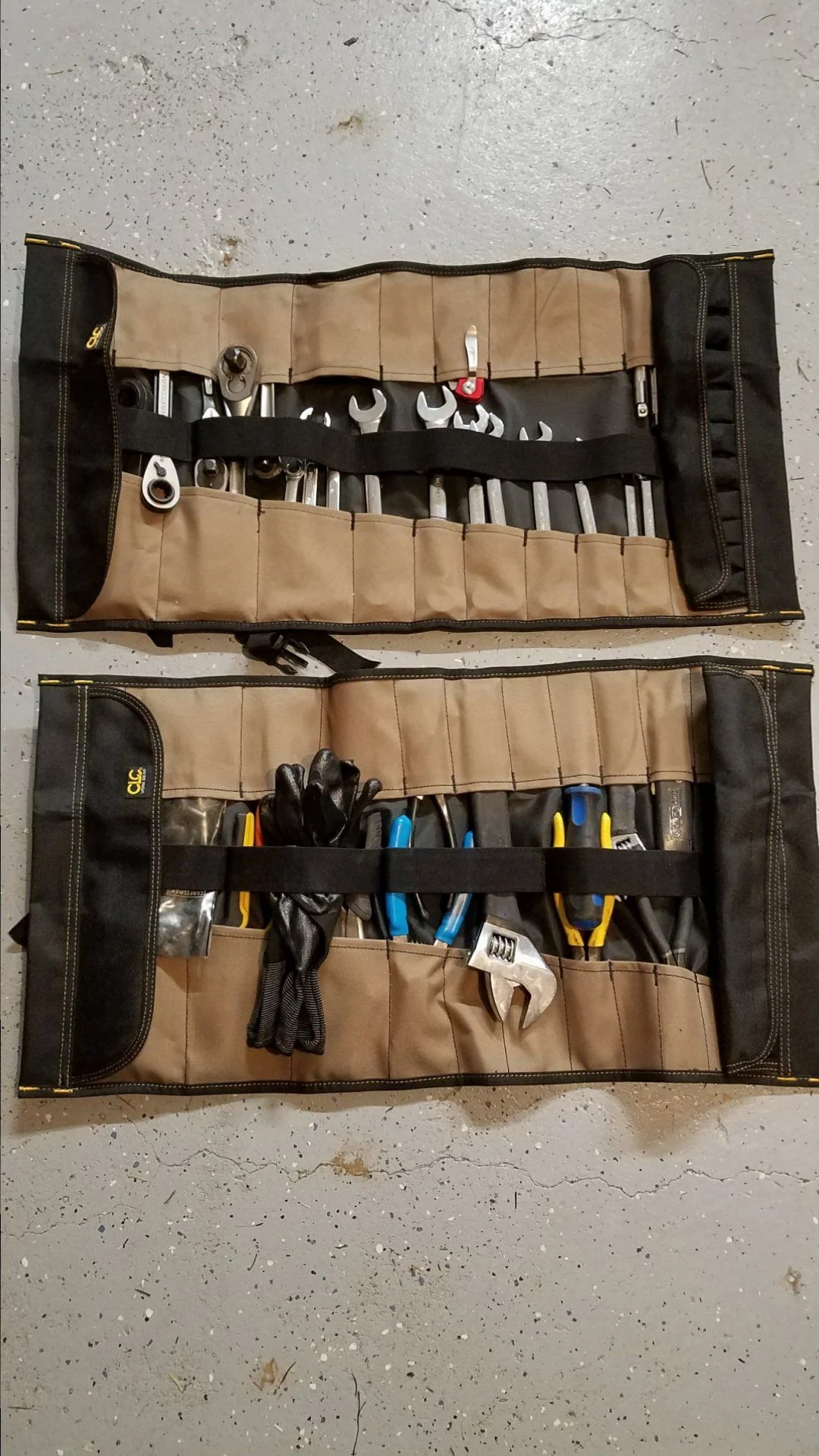

Also bought a couple of tool rolls to keep things in order when I get my KISS drawers next week.

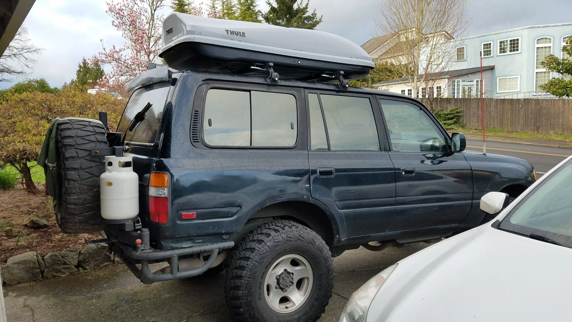

And last but not least, I added some more storage. A dog and kid require space. The wife decided she like the new Yakima box we bought so I found this nib Thule on CL. Now we really look like we're from the PNW!

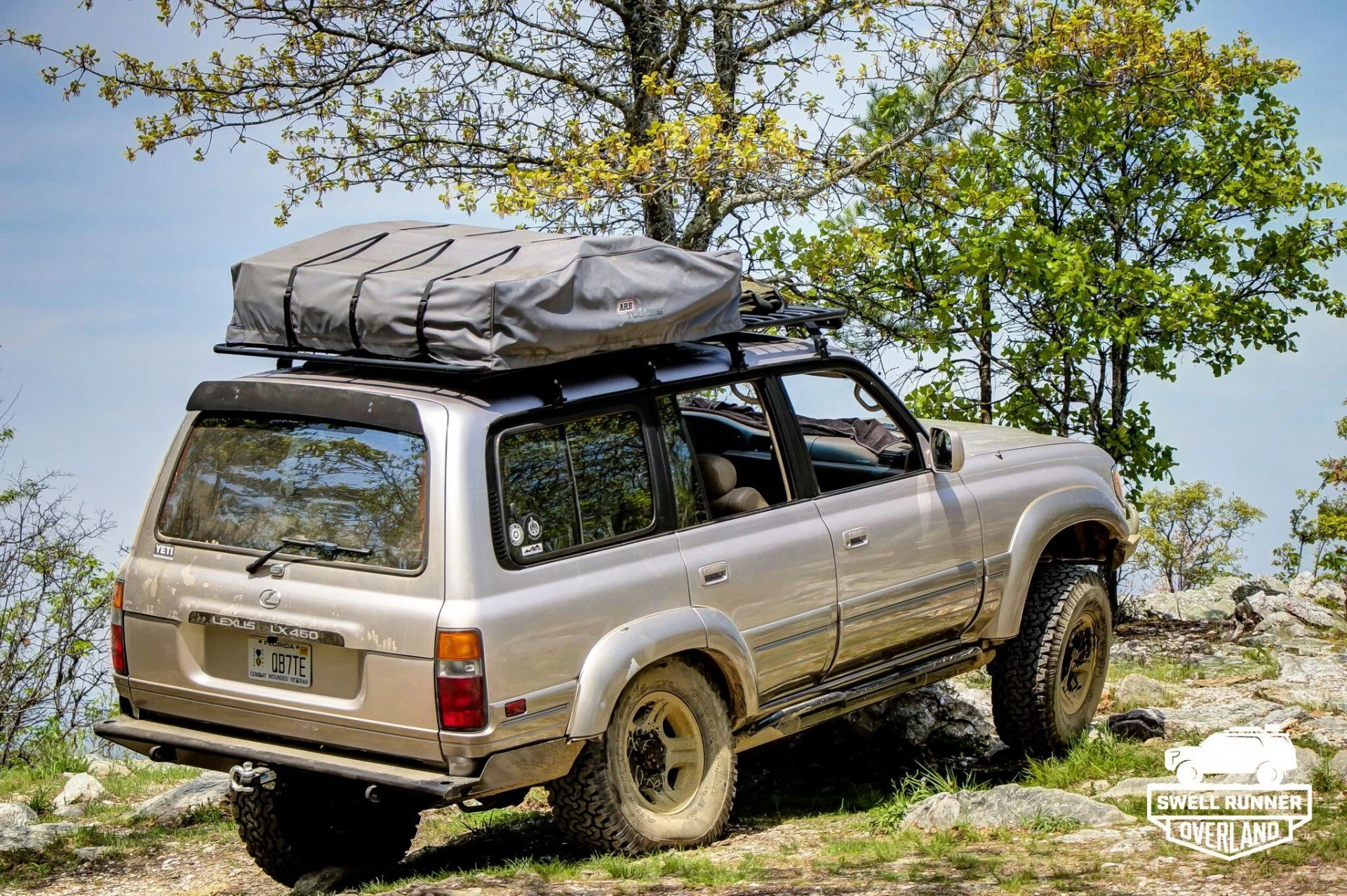

Another better shot from my 3 day trail ride. I was hurting for fuel starting the 3rd day so it prompted me to finish up the dual swing outs on my rear bumper so I'm able to carry extra fuel. I usually carry my extra fuel on my trailer which I didn't bring out View attachment 1444970 View attachment 1444968
I have the twin LX450 - what sliders are you running?
