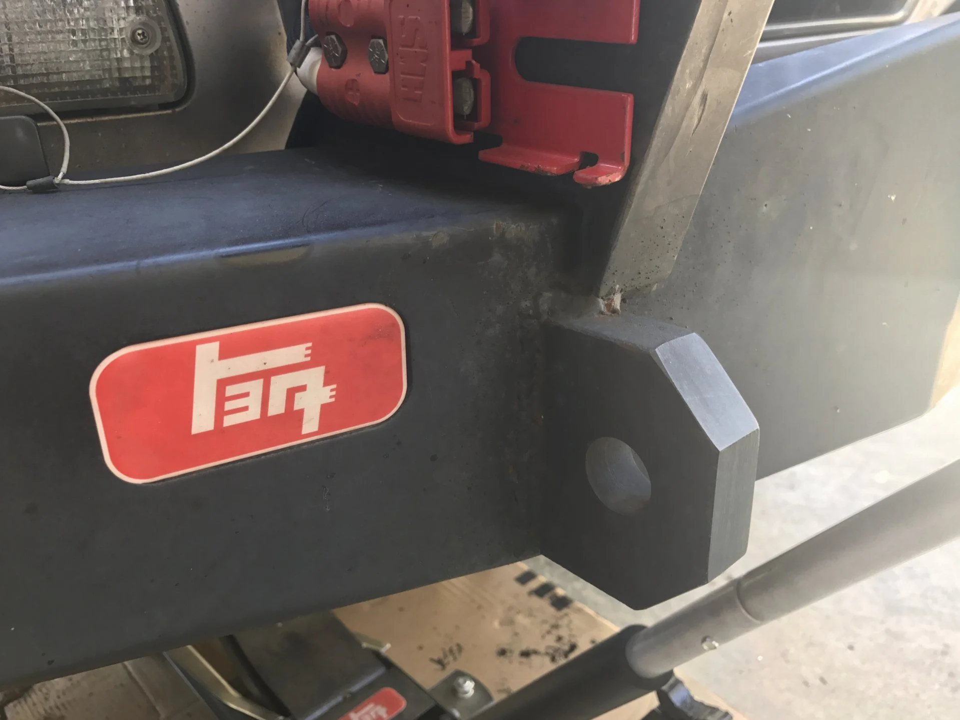

A simple piece of 1/2" (or thicker) plate bolted to the bottom that extended out beyond the frame and had a hole in it for a 3/4" shackle would work great, other than it sticking out and hitting things when wheeling. Find the stock bolt grade and match that with longer hardware for the thicker plate. Everything is in-line, maximizing the strength of the mounting bolts, etc.
I don't have stock bumpers anymore to go out and see if there's an easy option I'd be comfortable with. Maybe @NLXTACY can come up with something.. though if I were a business owner I'd be concerned about the liability aspects of making recovery points without a good engineer to vet things.

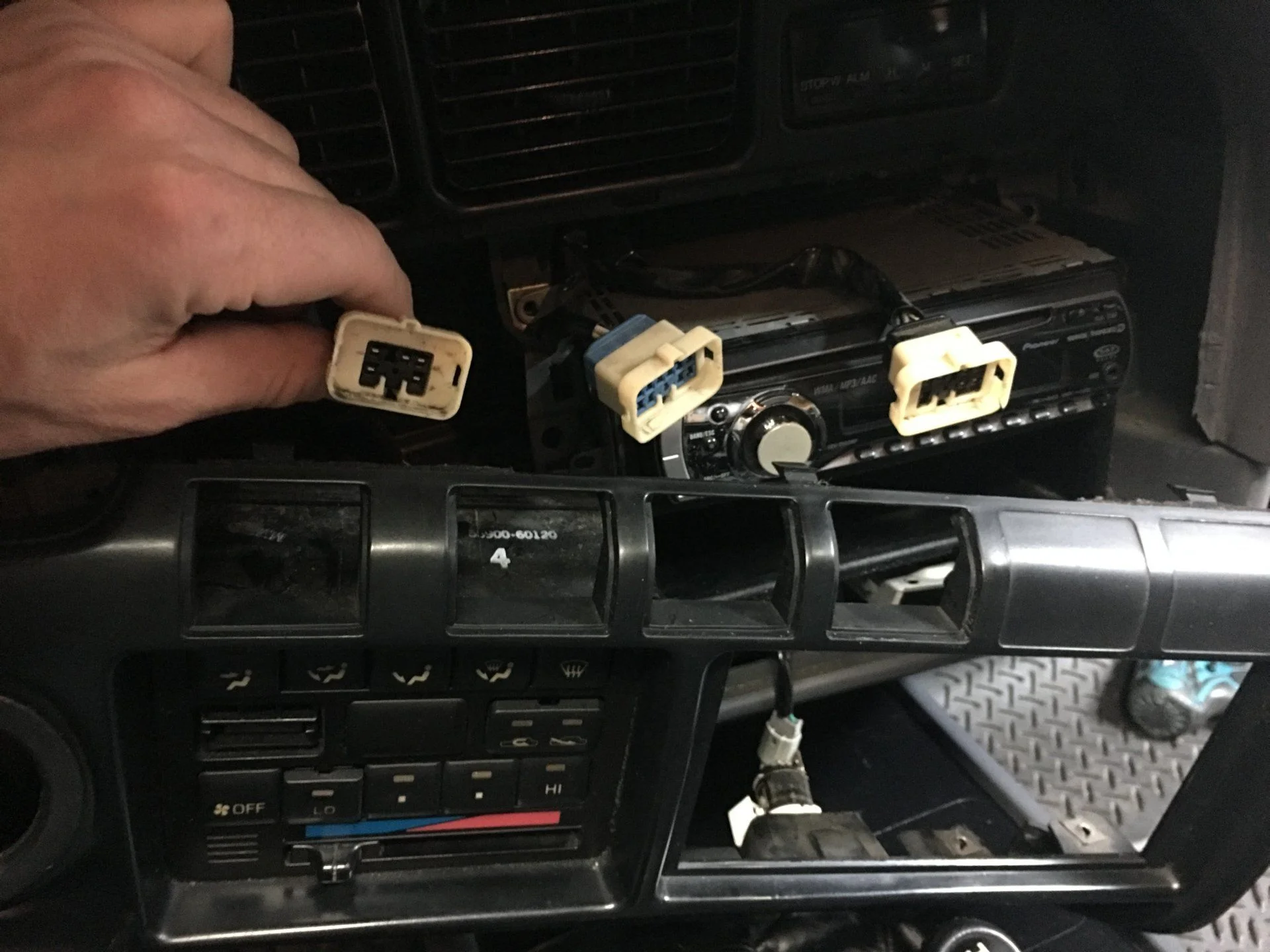

Installed the CDL switch and swapped some good parts for bad parts on the climate control. 24 year old plastic that was in Arizona is a blast to work without cracking apart. JB weld to the rescue.
Total overkill, but I like the Marks4WD 80/100 tow points. Yes, they stick down. I'd rather bash the tow points on rocks than doing it with the bumper or winch shackle mount.

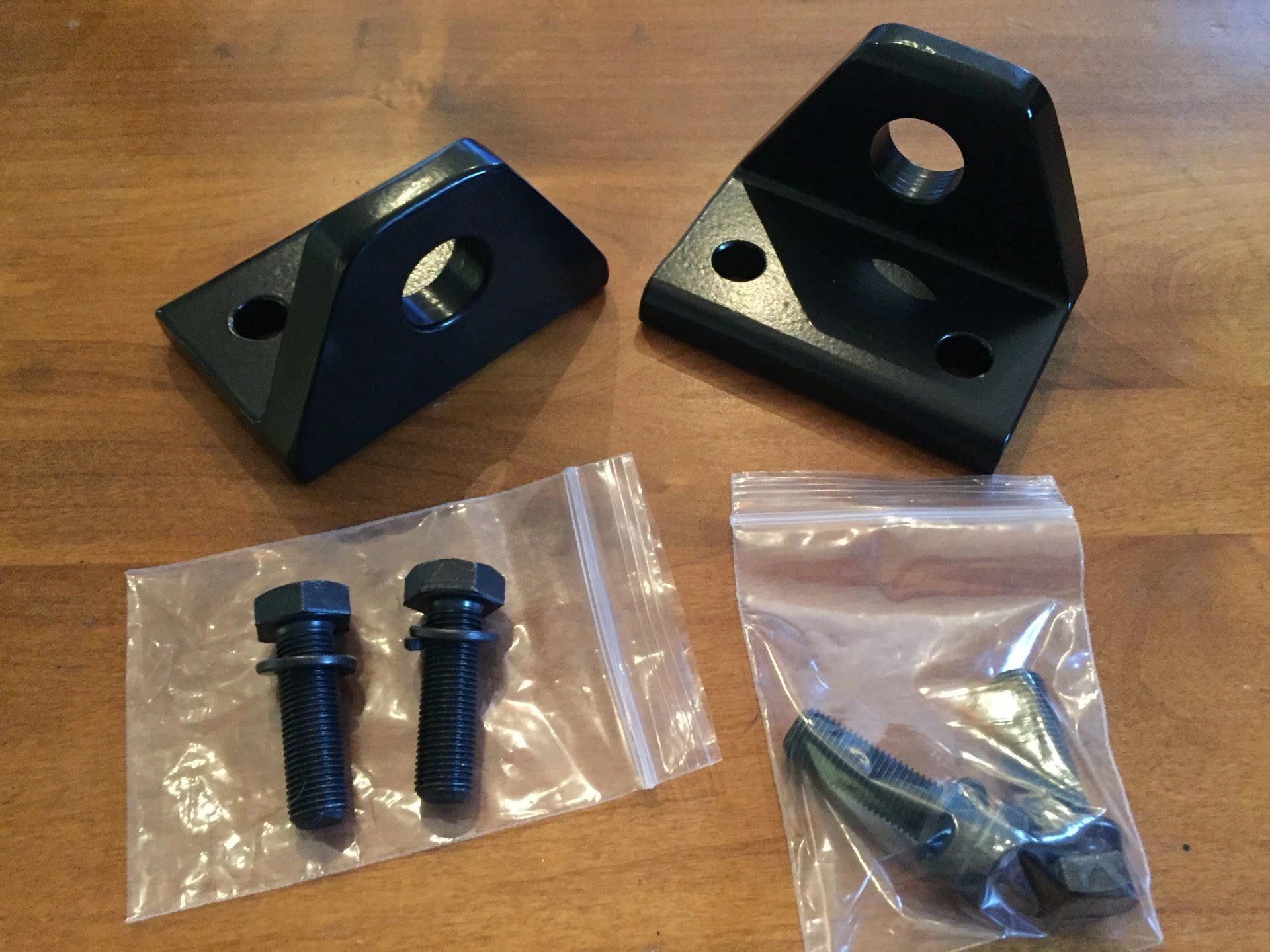

They look pretty good to me, especially with adding another bolt/nut to the system.
The photo is a bit misleading. On an 80, these only use the two stock bolt locations. Those fish-into-the-frame nuts are for other applications that use the same part #.
Captured nut on a stick is kinda cool. Even my stock hoops catch a pretty significant beating off road... those marks tow points would need a delrin skid so I could take a running start at an obstacle :hillbilly:
Guess I should have actually read the page. Thanks for clarification
