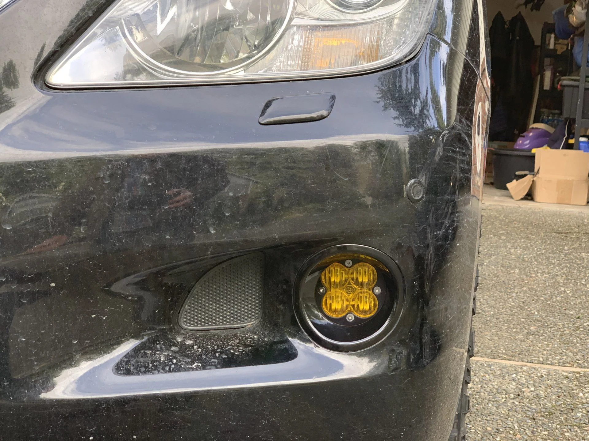

I'm still loving the black fog light surround you did. Got to find the time to do the same thing on mine!

I rattled canned the surrounds but I’m going to wrap them when I get some down time. They look good at a distance but didn’t turn out as good as I had hoped. Still beats the bling though.

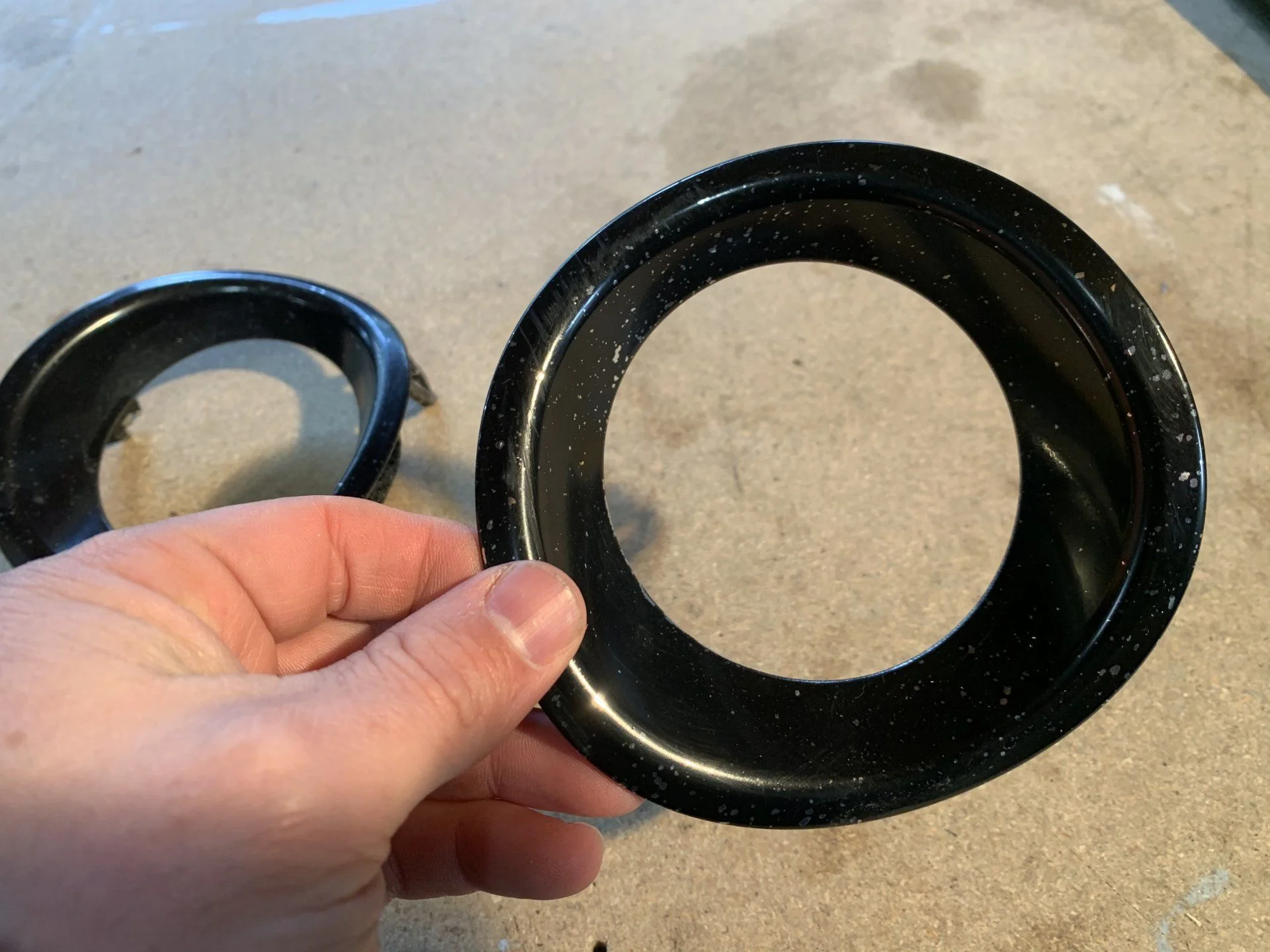

They just pop off. I used a plastic trim tool. Unclear if the paint will hold up over time. I will wrap them if it doesn't.

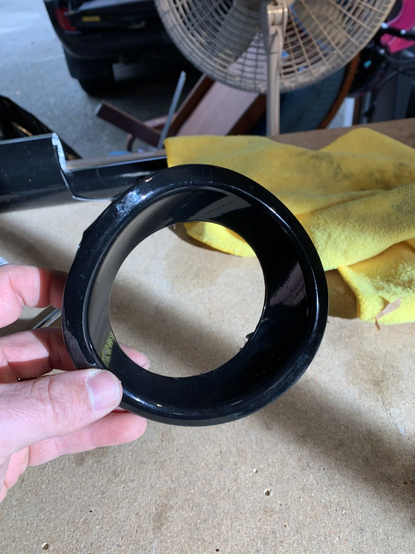

The paint predictably didn’t last. I tried my hand at vinyl and very happy with the results. Took 4 tries before something I was happy with. I was surprised how forgiving vinyl was once heat was applied.

I experimented with the hitch cover yesterday just to practice. The deeply convex or concave shapes are really challenging for my novice hands. Getting the vinyl to wrap is easy with heat but I ended up with a bunch of "micro wrinkles" where the wrap sticks to itself and no amount of stretching or squeegieing will get it out.
More practice required.

What kind of vinyl are you using? If you aren't using it, get wrapping vinyl. It has air channels in the adhesive and is easier to work with than sign vinyl.
A trick when wrapping tricky corners is to preheat and pre-stretch the vinyl. Like if you are doing the mirror, take a piece about 1' x 1' and have someone hold the heat gun moving back and forth on the vinyl and then stretch it both ways to make it about 15" x 15" then let it cool. Place on the mirror housing and wrap as much as you can smoothly then hit it with the heat gun. It will shrink back up and then you can wrap the rest.
