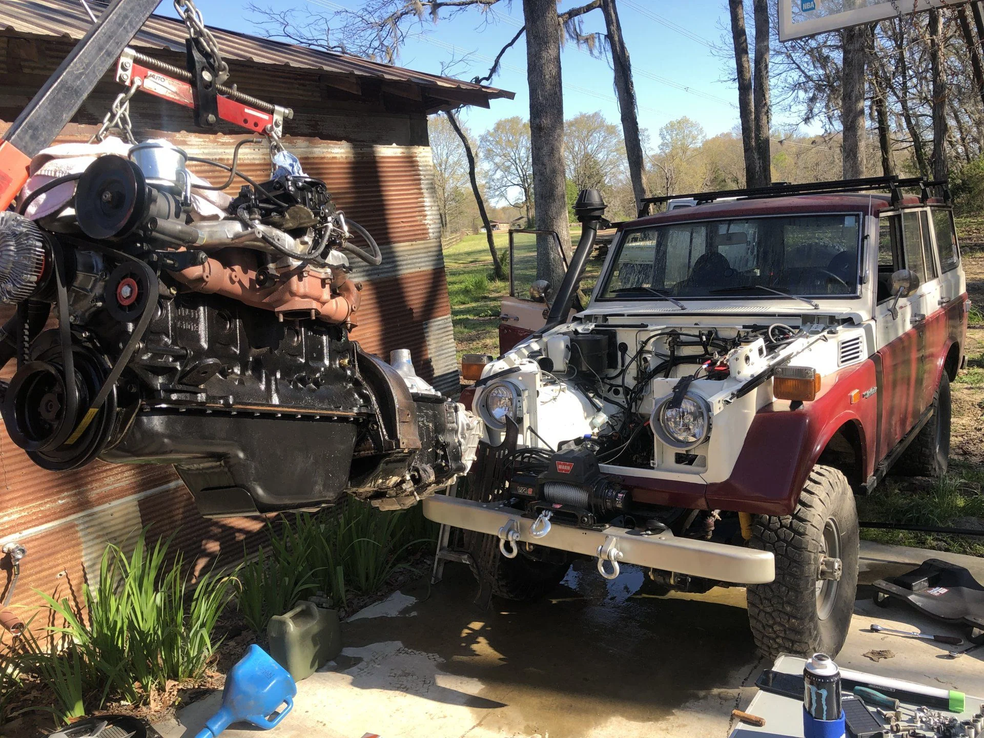

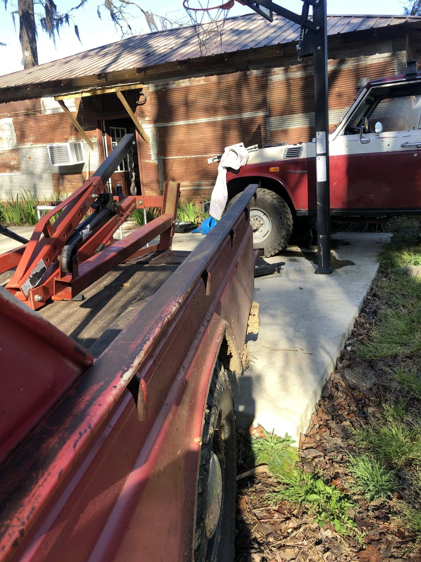

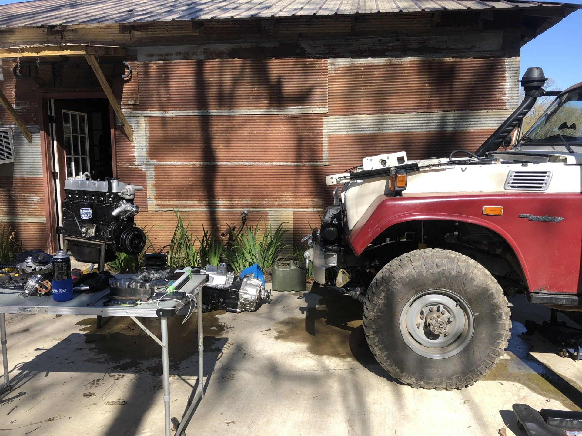

Went and grabbed the hoist and with the help of @USMC22 we had this guy out and in his trailer and gone in a couple of hours.

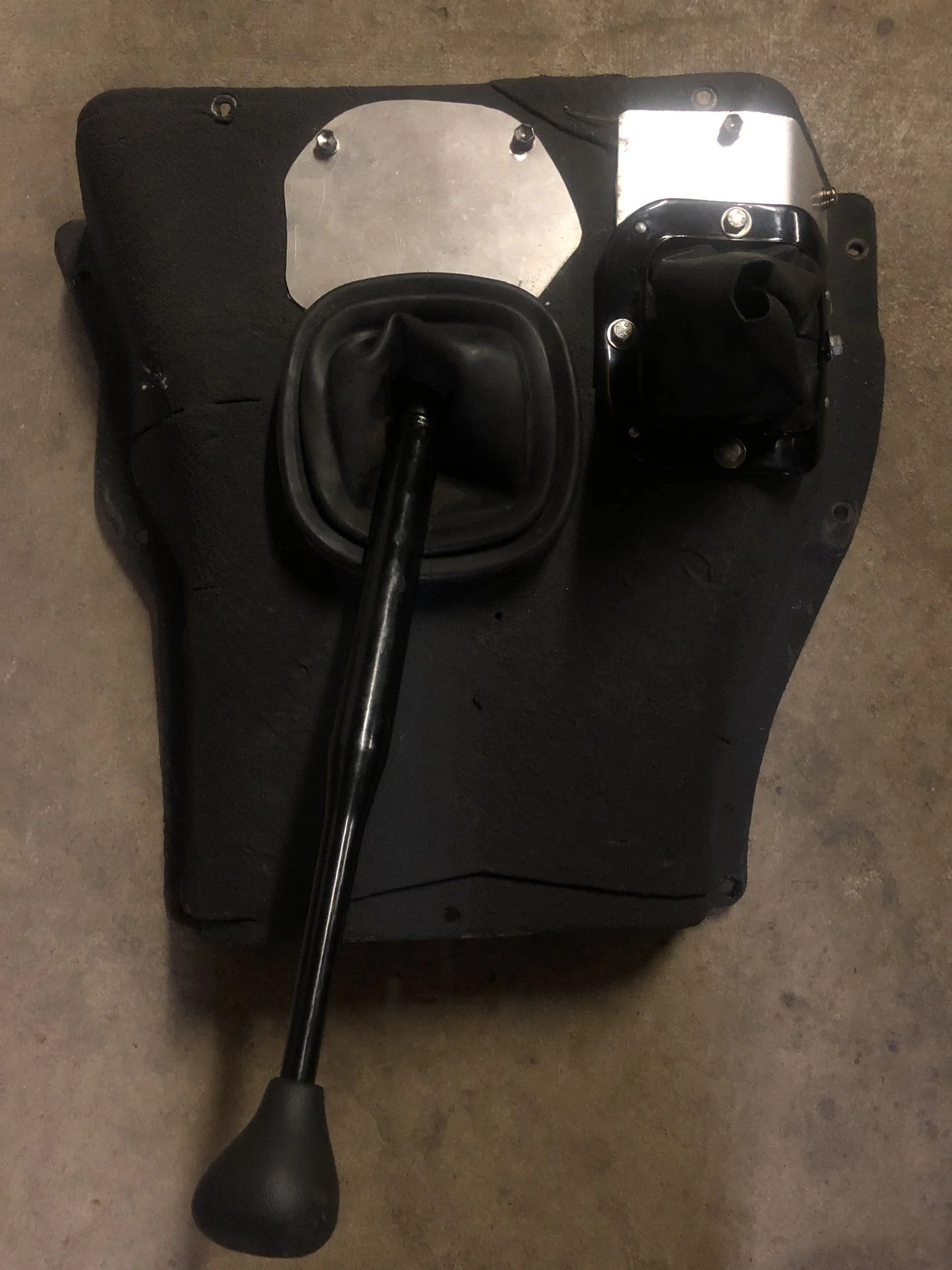

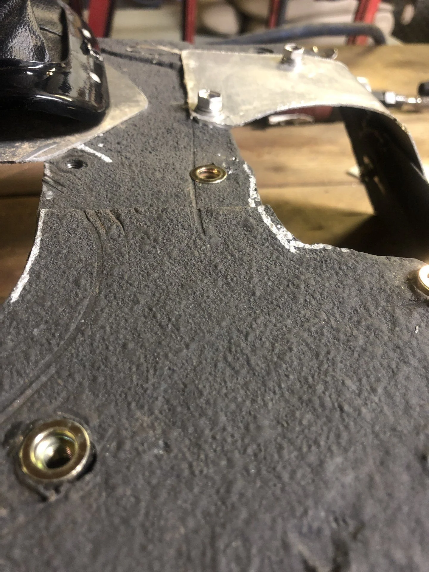

Got the tranny hump holes filled properly.
Just gotta paint it
I wish I still had some Lizard Skin. That stuff is on both sides of the hump and it is so nice and quiet.
I’ll likely put some foam sponge stuff under the shifter area like OEM 60s have when I reinstall.
