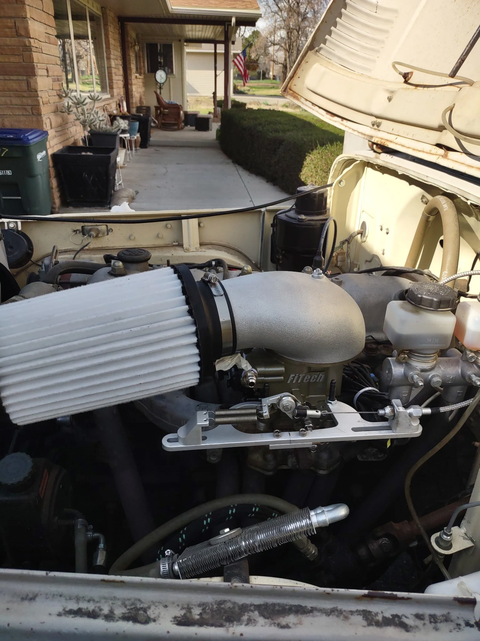

When I did Fitech EFI I bought a cheap amazon holley throttle cable bracket and I think a Lokar cable.
Had to cut bracket in half to shorten to 2bbl bolt spacing.
Its a little tight with the wilwood master but it all clears. EFI body has same bolt footprint as holley 2bbl (its what I had before EFI and its the same adapter).
