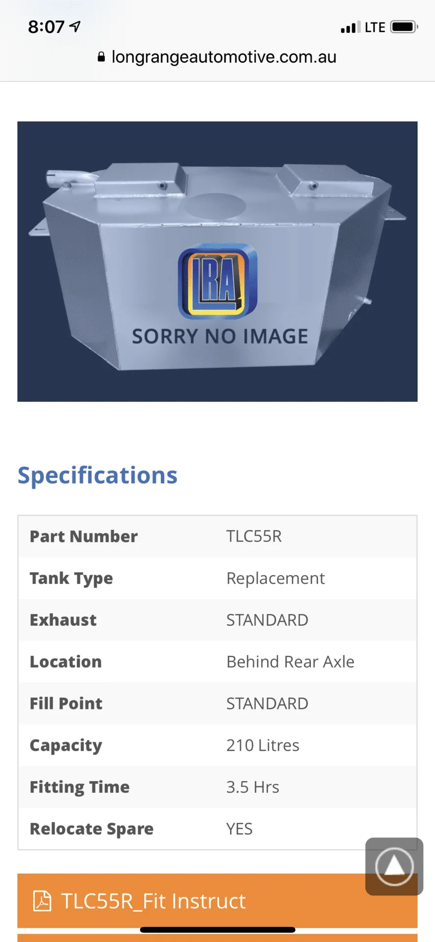

Step 1.....contact @orangefj45 and Cruiser Brothers and get a NEW fuel tank from Long Range Automotive
There is no way to get this fuel system right without getting it really right

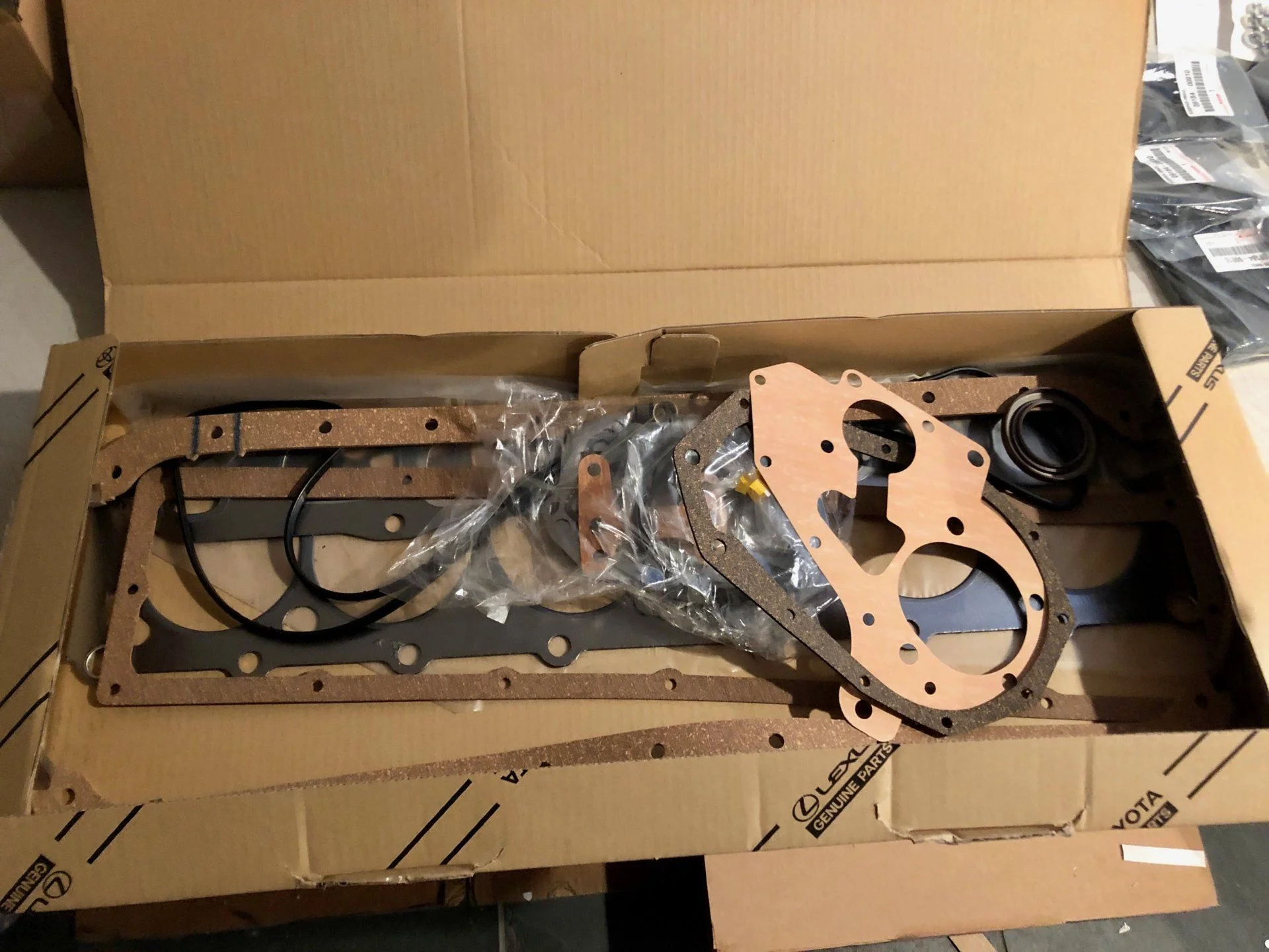

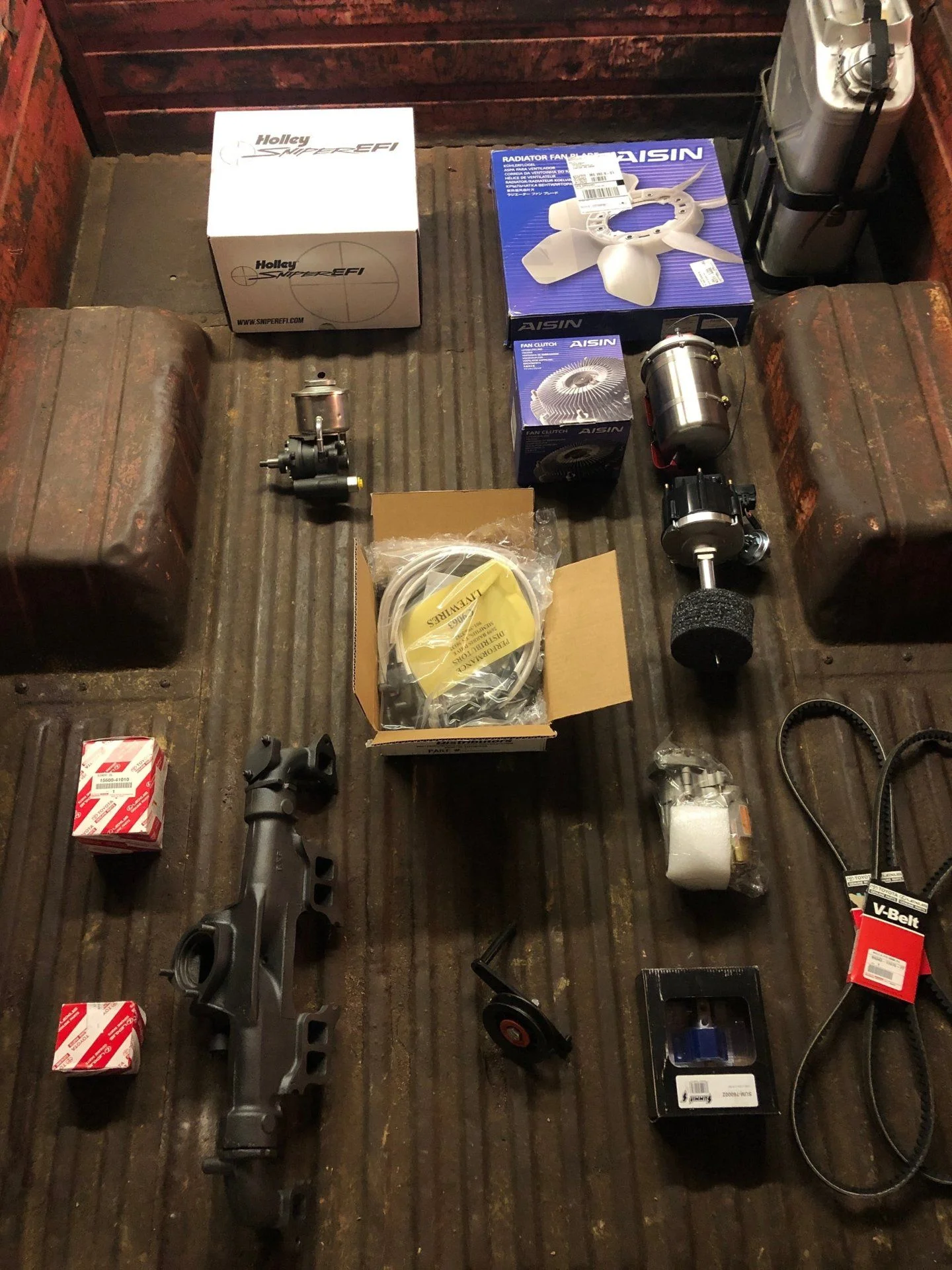

The first phone call I made was to @beno to get the OEM guts on order for the Hot Rod 2F.
I got everything that is still available from Toyota for the 2F.......sadly, this list is getting shorter by the day. If you want a OEM filled 2F, you better get on it and order some parts.

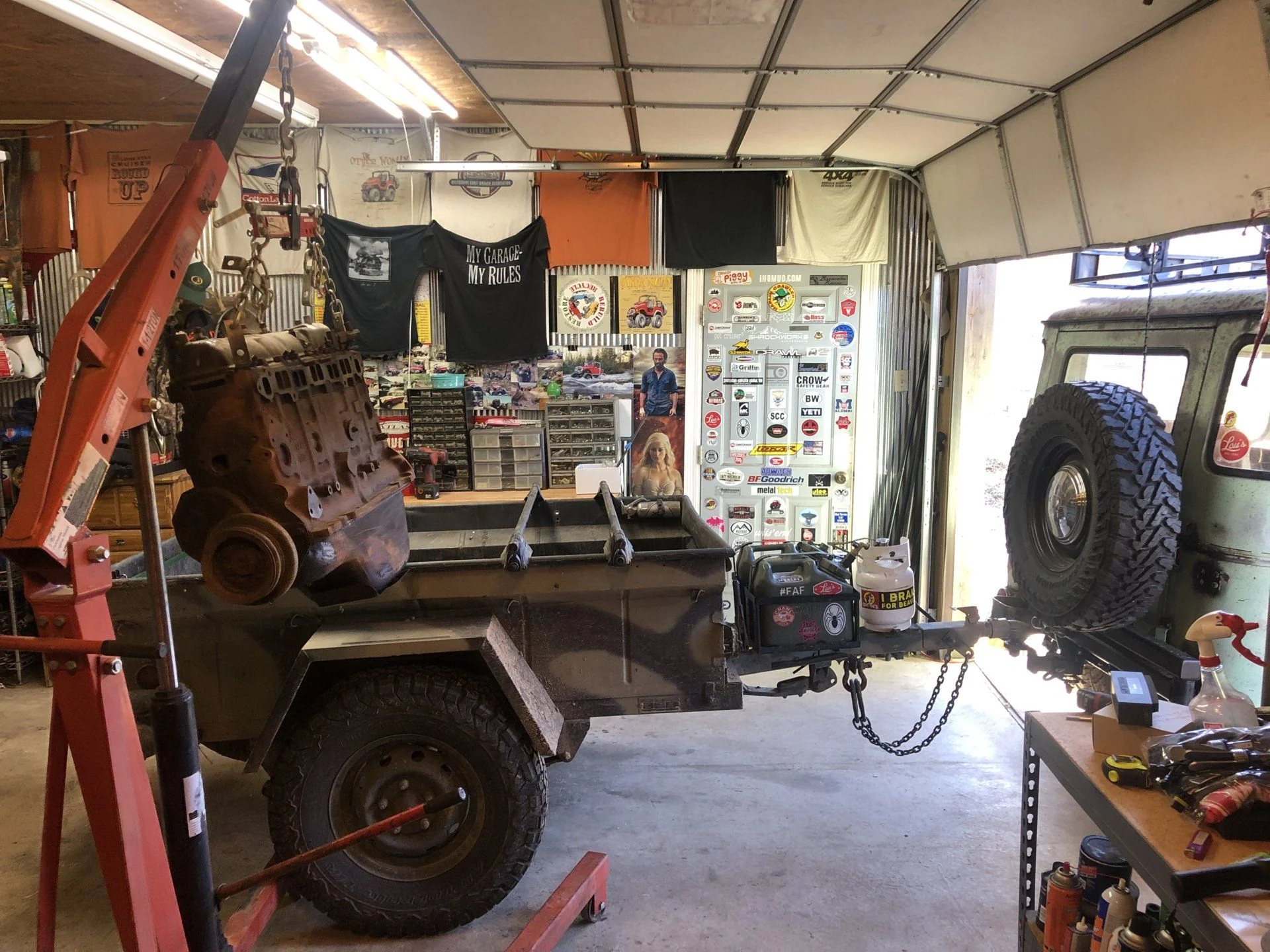

I broke apart the 1981 2F donor and loaded it up and took it to the science lab at Mosley Motors

The sniper looks like a pretty decent setup. Are you going to have it control the timing?
We are going to research it. I am using a DUI for this motor.
I’ve got an AFI on my FJ60 and I’m
A fan but want to try something new.
I’ve got a few “new” things I’m going to try on this setup. I’ve got a pile of parts. Mosley has a pile of parts. I’ve still got parts to buy.
Now is the time to go 3FE exhaust manifold instead of 2F.
What’s the benefit?
The downpipe on the 55 is a pretty cool piece. I don’t know enough about the 3F to know if it’s the same depth and pattern as the 2F....
