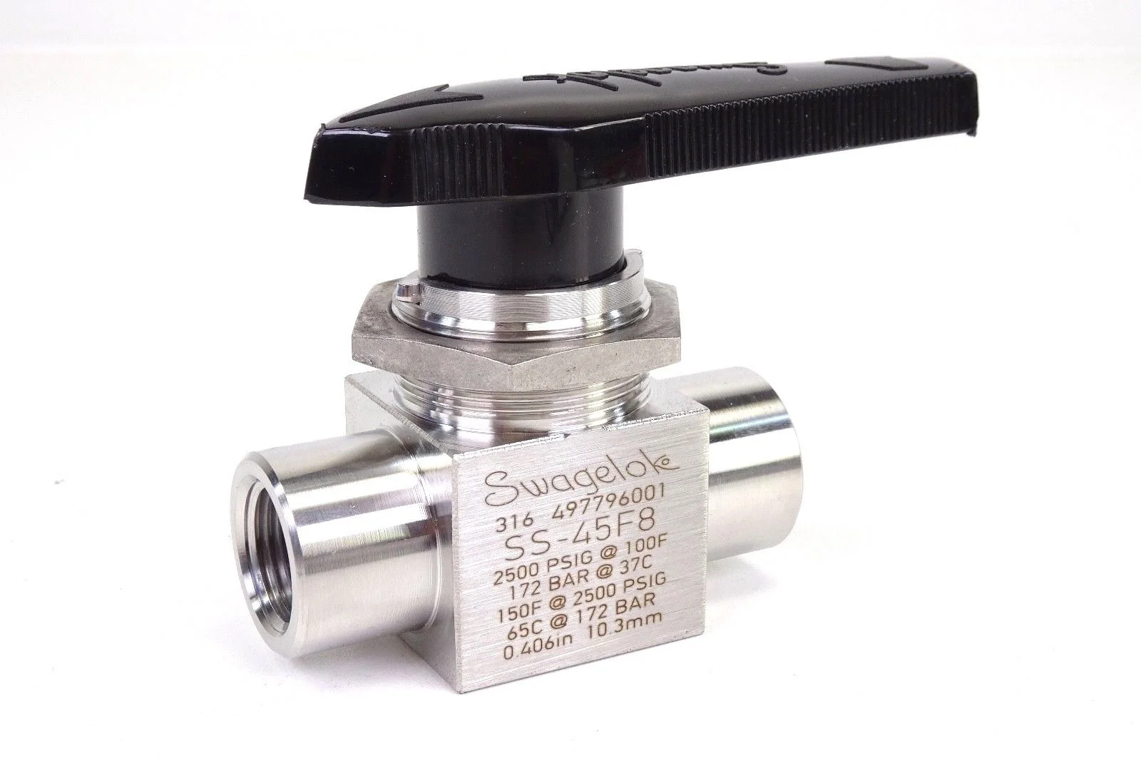

You might want look into mechanical line locks. I have one on my race car. It is basically a ball valve, one that resist brake fluid and can handle high pressure. This way you do not need to worry about the battery draining and then the lock releases. For short trips in and out the truck on the trail you should be fine.

Electric line locks are meant for intermittent use somewhere around 60 seconds. A little panel mount Swagelok ball valve will serve you well when the line lock fails.

At the end of the day I just ran the ball valve in the cab for cost and time constraints, the Warthog is turning out fantastic. Good luck with that new engine I hope it brings you many more smiles than the last one.

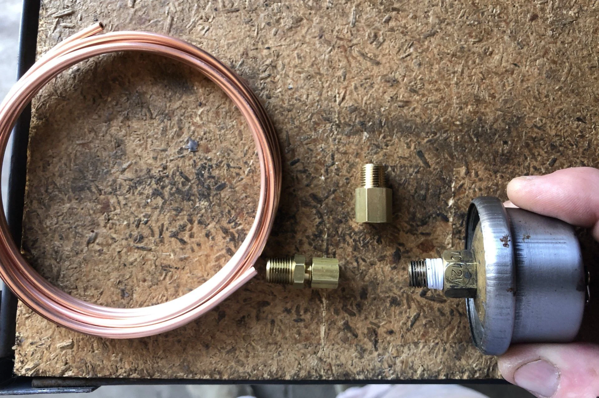

I also put a real oil pressure gauge in. I’m going to make a T at the stock sending unit location so I can run both gauges.

Just make sure you get the copper line with the gauge. They all come with plastic line and it can melt if routed wrong.
I have a lot of money in this motor. This is a bit of a piece of mind for cheap

Couple quick things I learned from the race car scene, never hang a T on the block - instead remote mount it on the body away from vibration, for quicker gauge response run a bigger line to it, ballpark oil pressure should be 10 lbs per 1000rpm...
