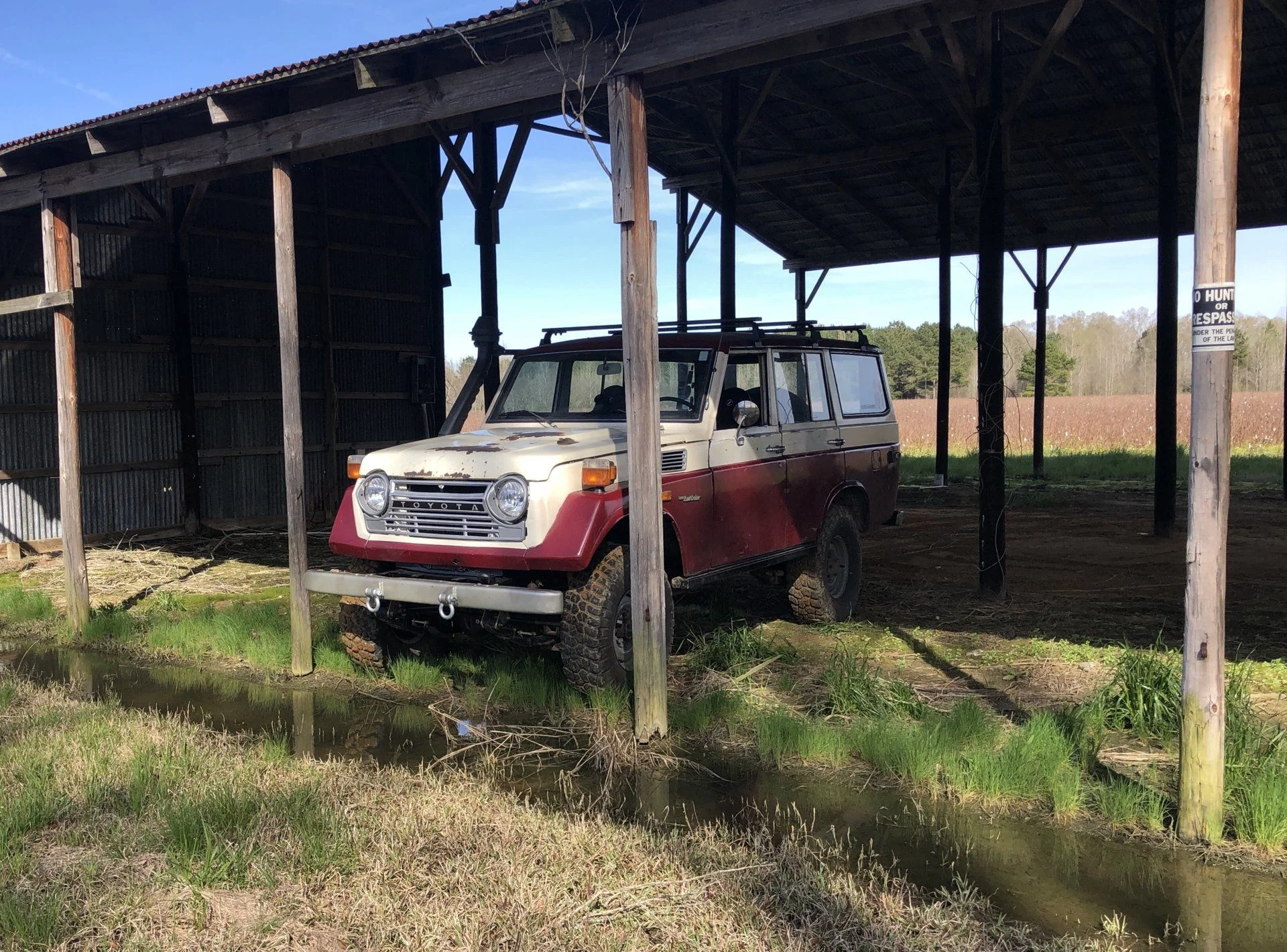

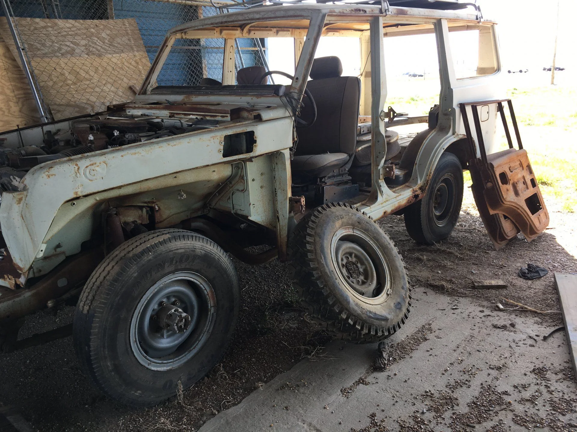

Insane transformation. Almost two years exactly.
Throw some hubcaps on for a photo shoot. Don’t run them...but you’ll be glad to have a set of photos with them installed.

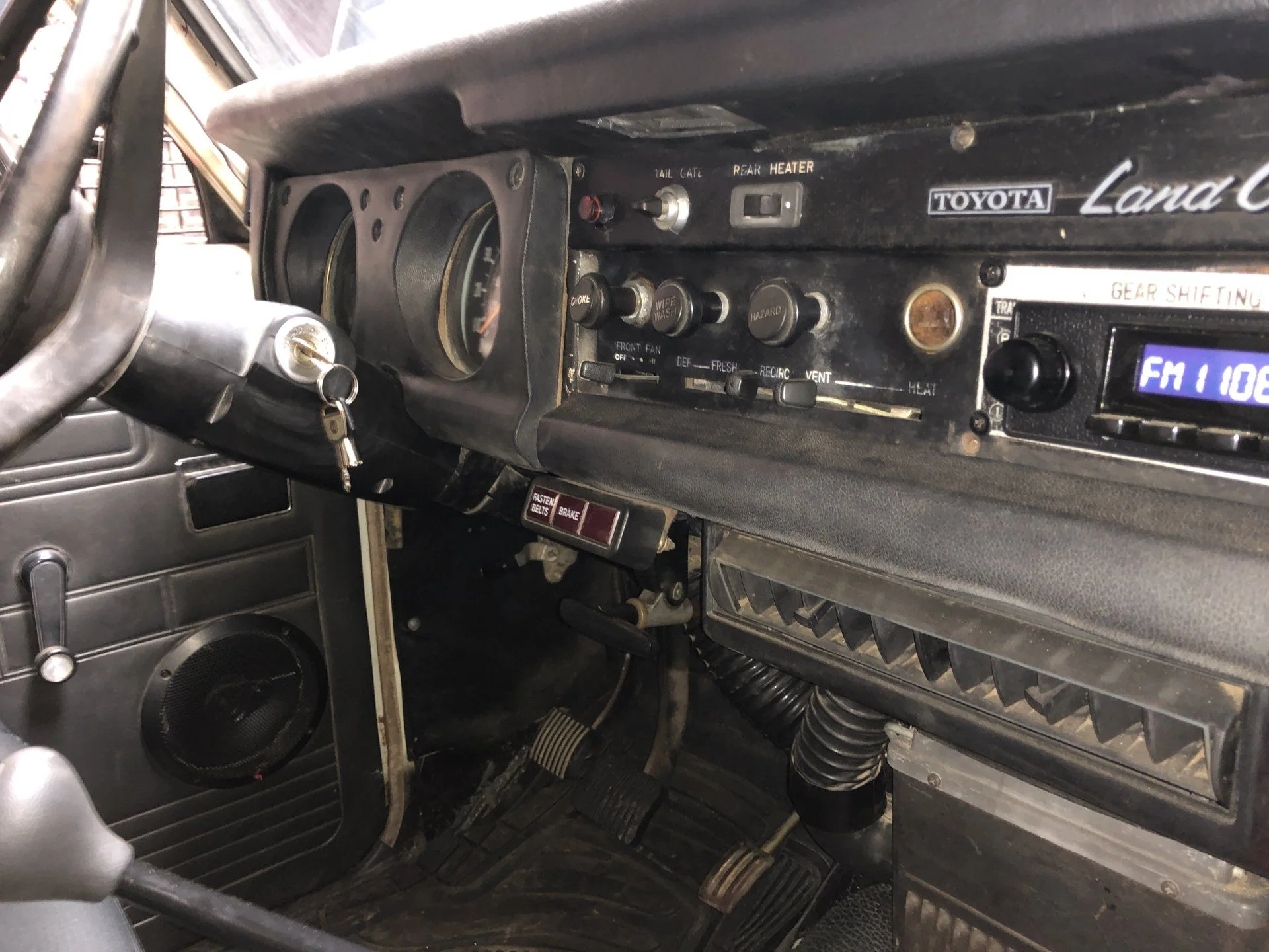

Spent some time on some small stuff this afternoon. The @cruiseroutfit long speedometer cable was plenty to make the odo/speedo come alive.
Starting point is 000470

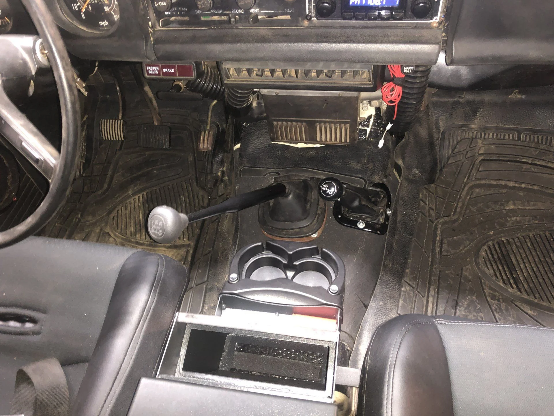

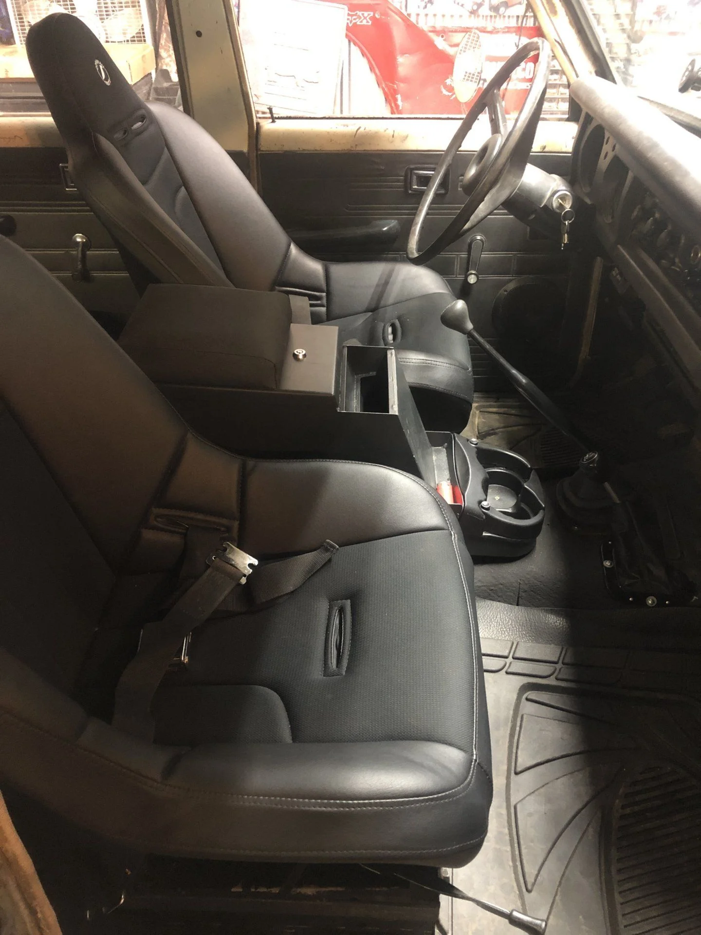

After that I finished off the interior with most of the OEM floor mat (mine was already a mess so cutting it was not a travesty)

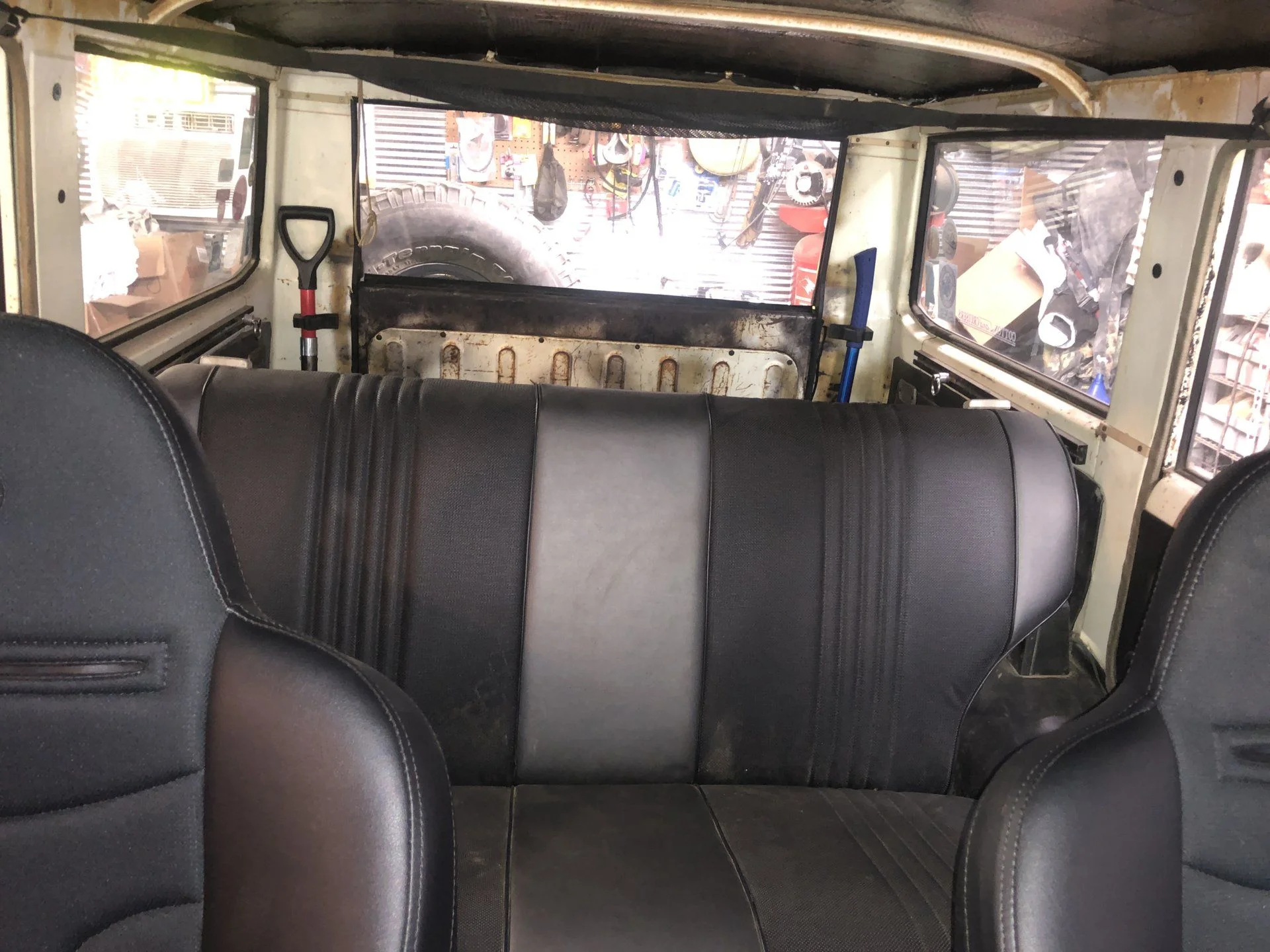

The seats are unbelievably comfortable but a bit difficult to get into. I’ll just learn to deal with it. The interior came together very nicely.
I’m real happy with this.
I miss my 55. A long time ago, first cruiser. Memories, nice, and thanks for the refreshment. Incredible build, meets expectations. I think those seats are telling you that this isn’t a sports car, despite looking like sports car seats. Respond appropriately.
Got any photos of this first Pig??
The problem with the seats is they have high sides. Super comfy but the space between the steering wheel and the seat is limited
That said, the Corbeau seats that match up with my bracket and don’t require gymnastics are $550 each.
I’ll just get an ingress/egress system down and call it even.
I love that pic Nolan. Something about basics, foundations, structure, strength, who knows,
No digital pics of my first pig, pre-digital age. Maybe I have a print I could scan. Green-white-green, had a rack as big as the roof when I first picked it up. Someone at the gas station during its first (and many more!) fill ups asked if it was from Daktari (in Seattle lol).
