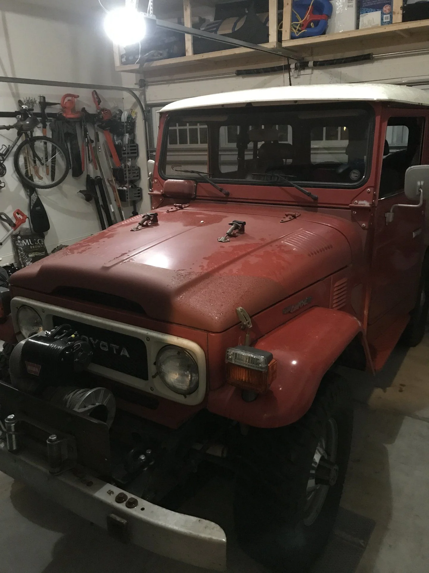

Hello all. I am new to the 40 but have had Cruisers for the last 9 years.
I'm really excited about bringing this survivor back to original specs.
I realize that alot, rather most original parts are no longer available new but I would like to get it back to as original as possible.
With that being said, your comments would be appreciated and help me get this 40 repaired correctly.
It's an early '79 with a Feb. build date with factory Power Steering and a currently inoperative Nippon Denso factory installed Air Conditioning.
As far as I can tell, it was originally sold new in Graham, WA and I am the 5th owner. It had 67,000 on the 5 digit odometer so I am guessing that it had 167,000 miles on it. It certainly doesnt look like 267,000 but I may be wrong. ( I have been many times before.)
I have already removed an aftermarket tape deck, speakers and all associated wires. Three wire tapped wires under the dash were heat shrinked and rewrapped with electrical tape. I was happy to find the original, un-molested radio 12V +/- plug & speaker plug behind the dash. Now I need to find a 1979 radio to install.

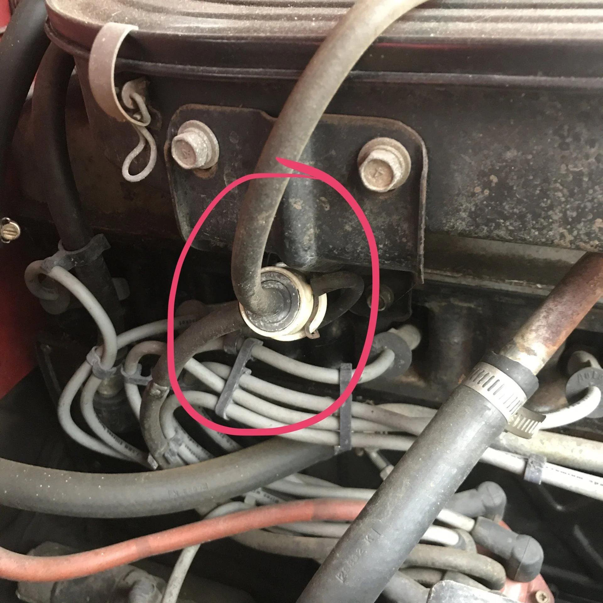

However, I am in need of this vacuum valve for the distributor (pic from another 1979). Does any one know of a suitable replacement? This one is supposedly discontinued.
*Edit - City Racer has these valves for sale on his website. They are they superceeded part number and are blue and black. Not original color but functionality is the same.

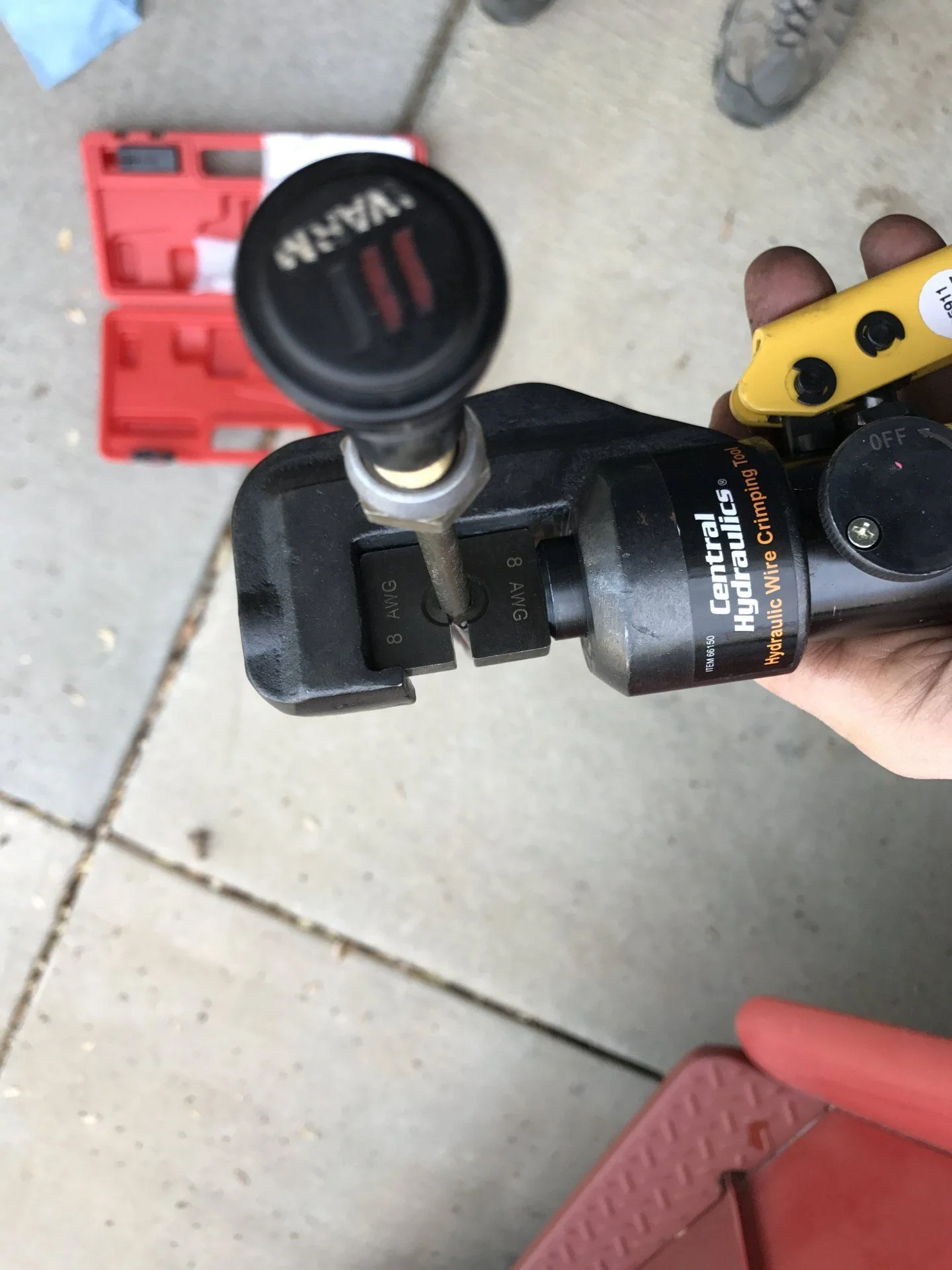

- fixed the heater temp controller today.
I used a hydraulic crimp with 8AWG dies to re- crimp the plunger assembly to the cable housing.

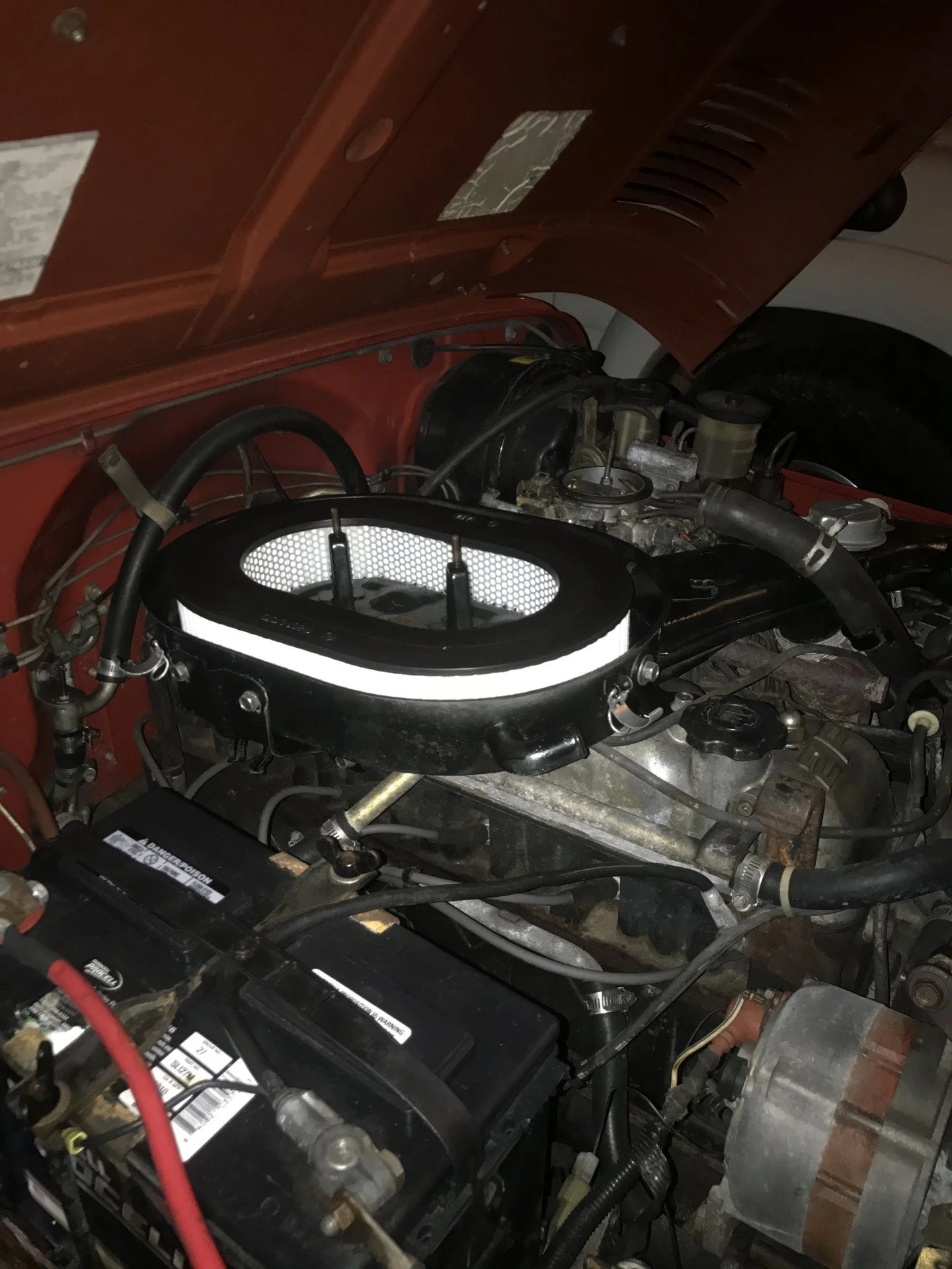

- removed air cleaner assembly, removed rust, primed and painted
