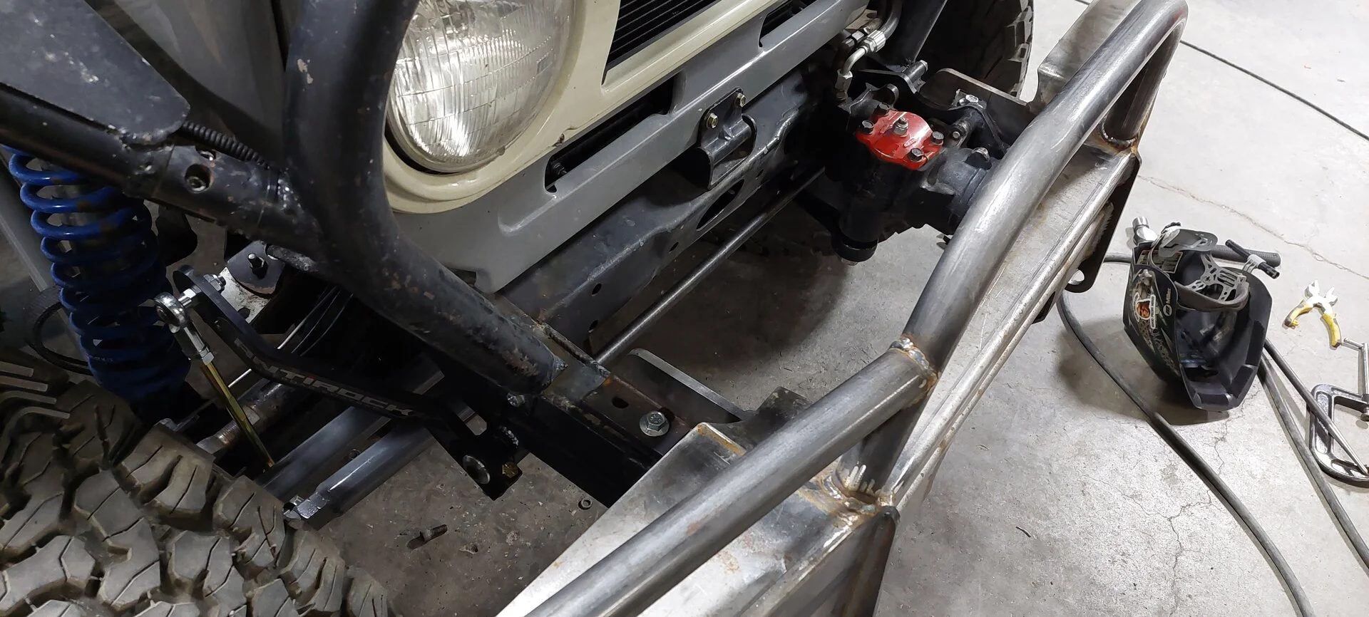

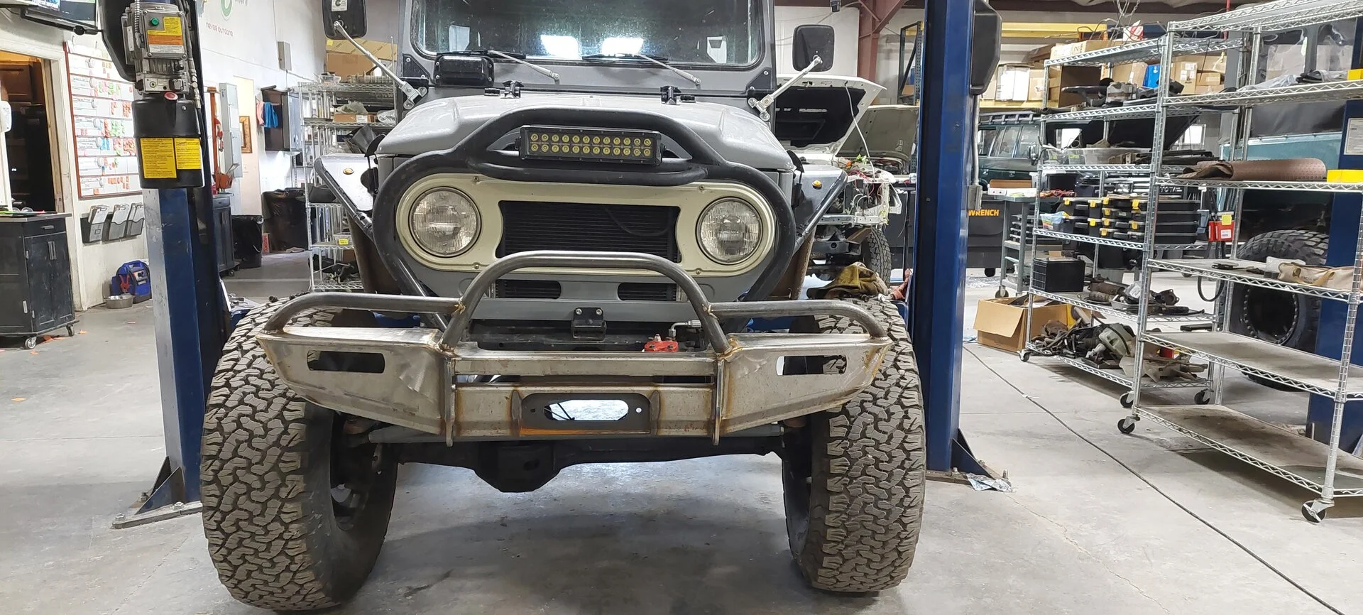

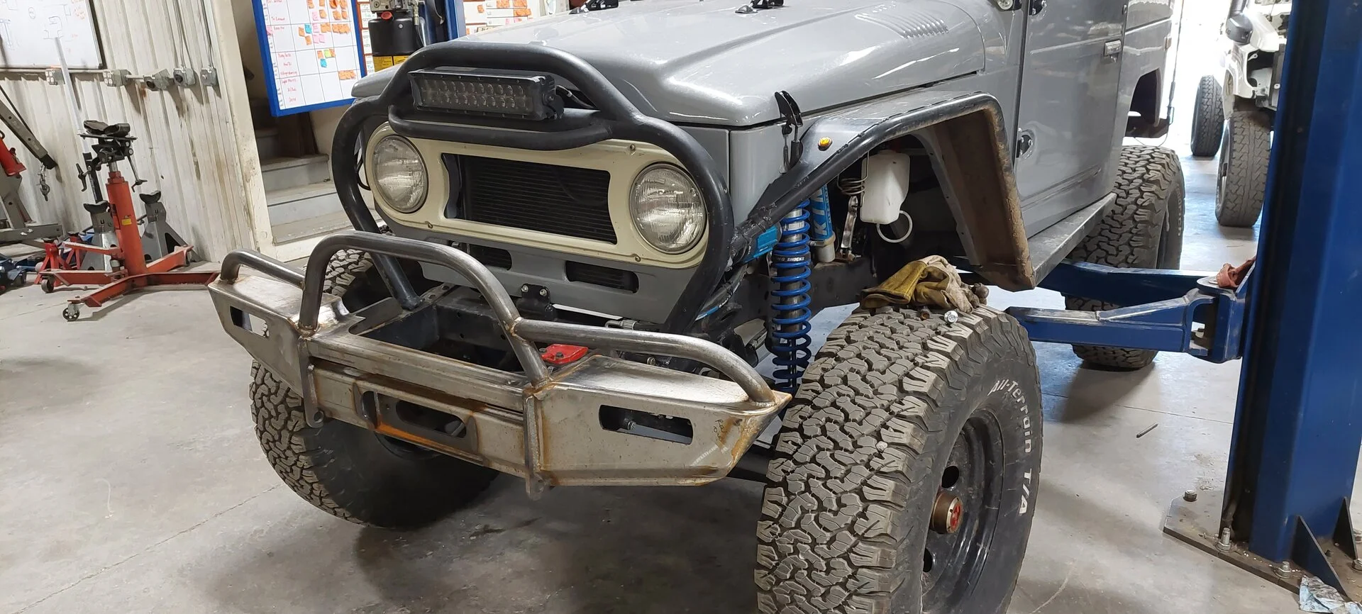

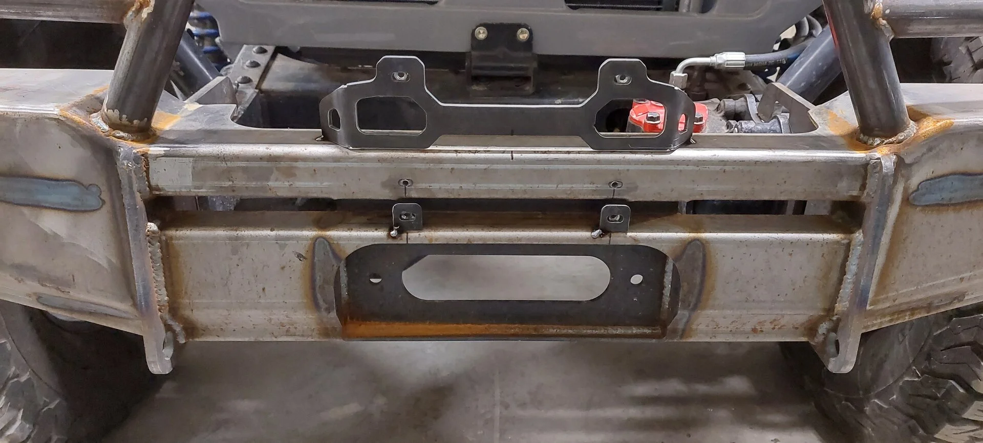

Getting back to work on the 40. New front bumper finally going on.
I will be reworking the fenders and getting rid of the front nose hoop.

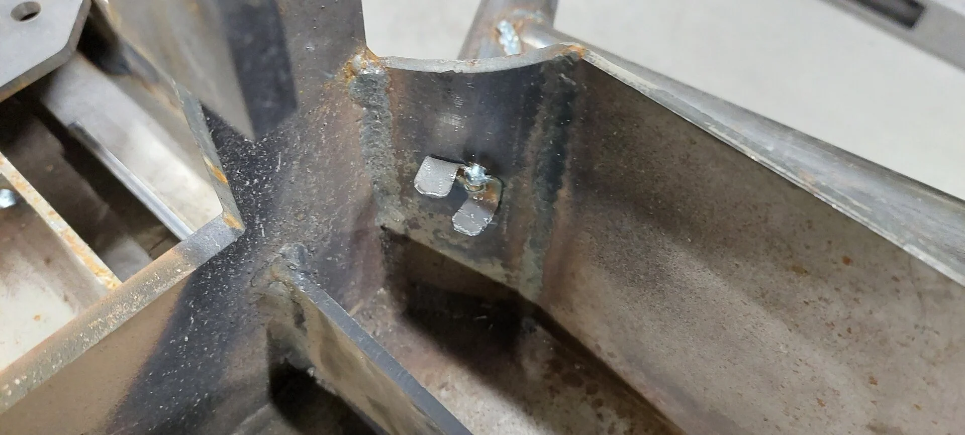

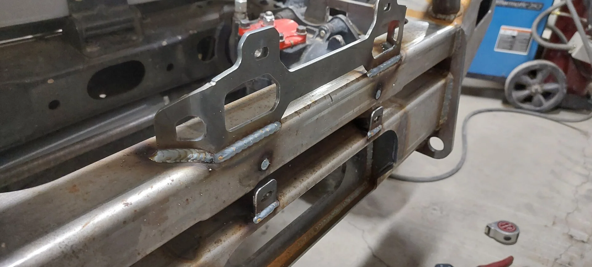

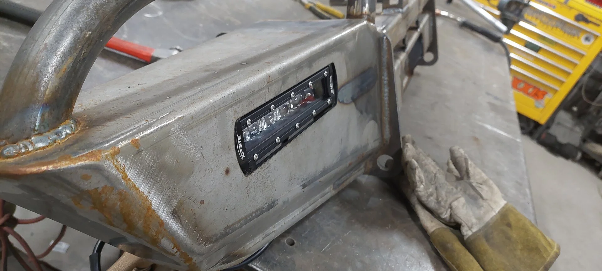

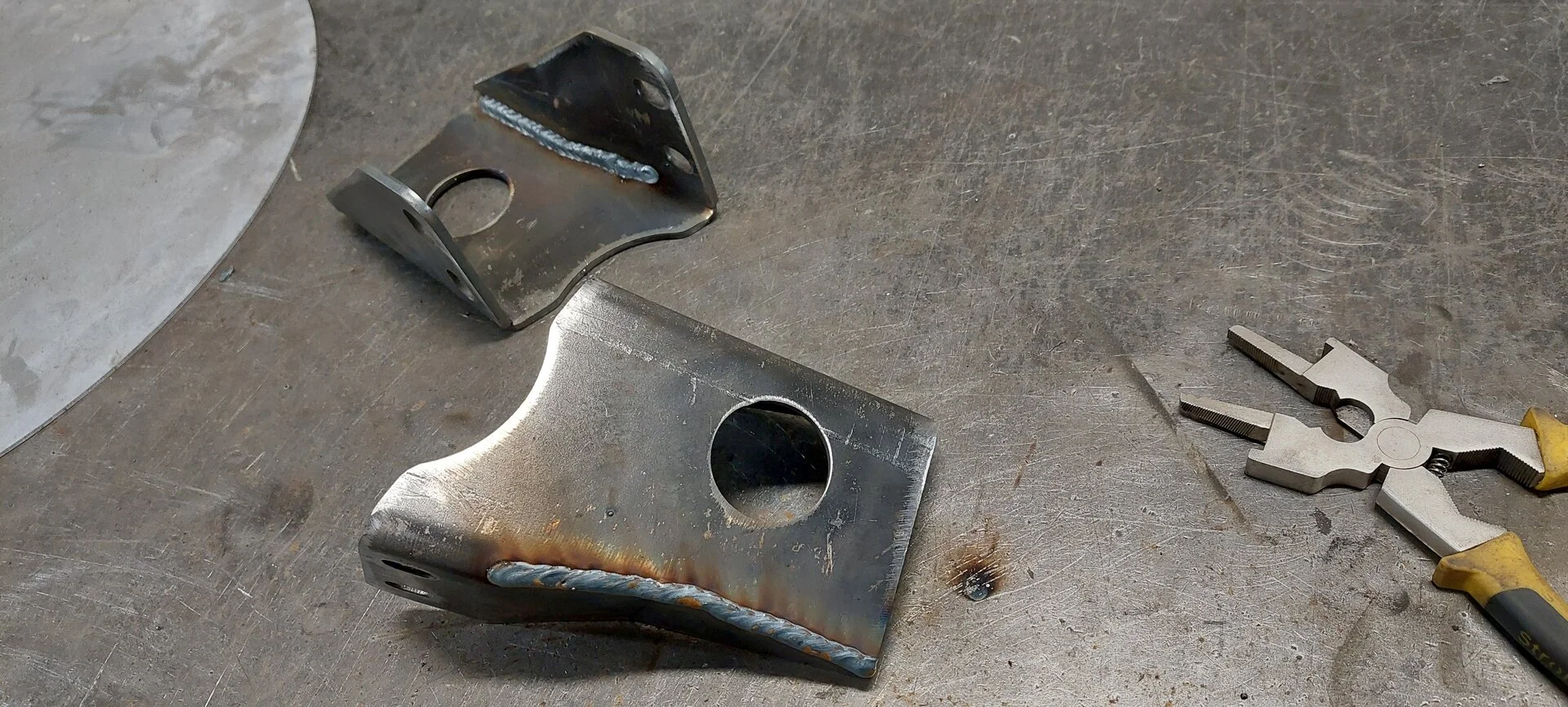

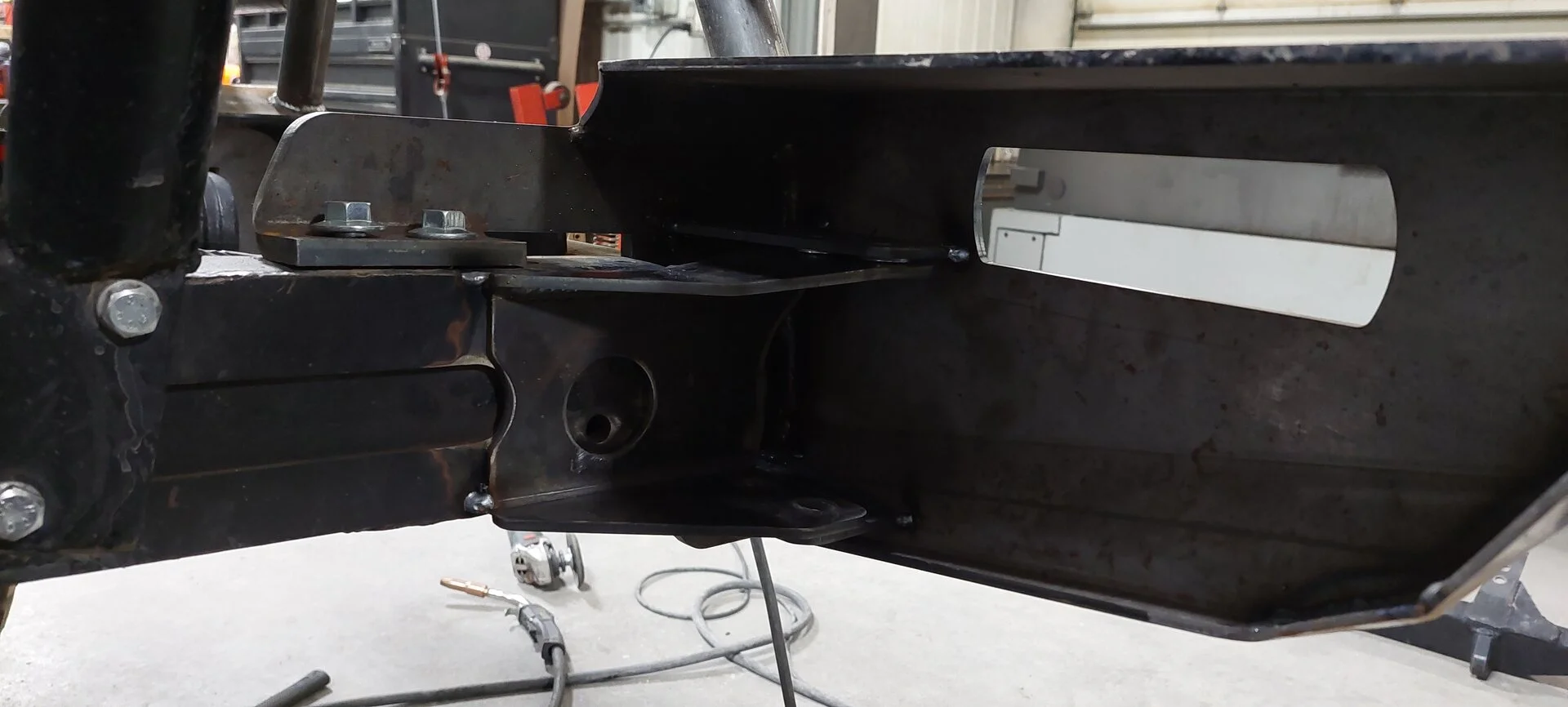

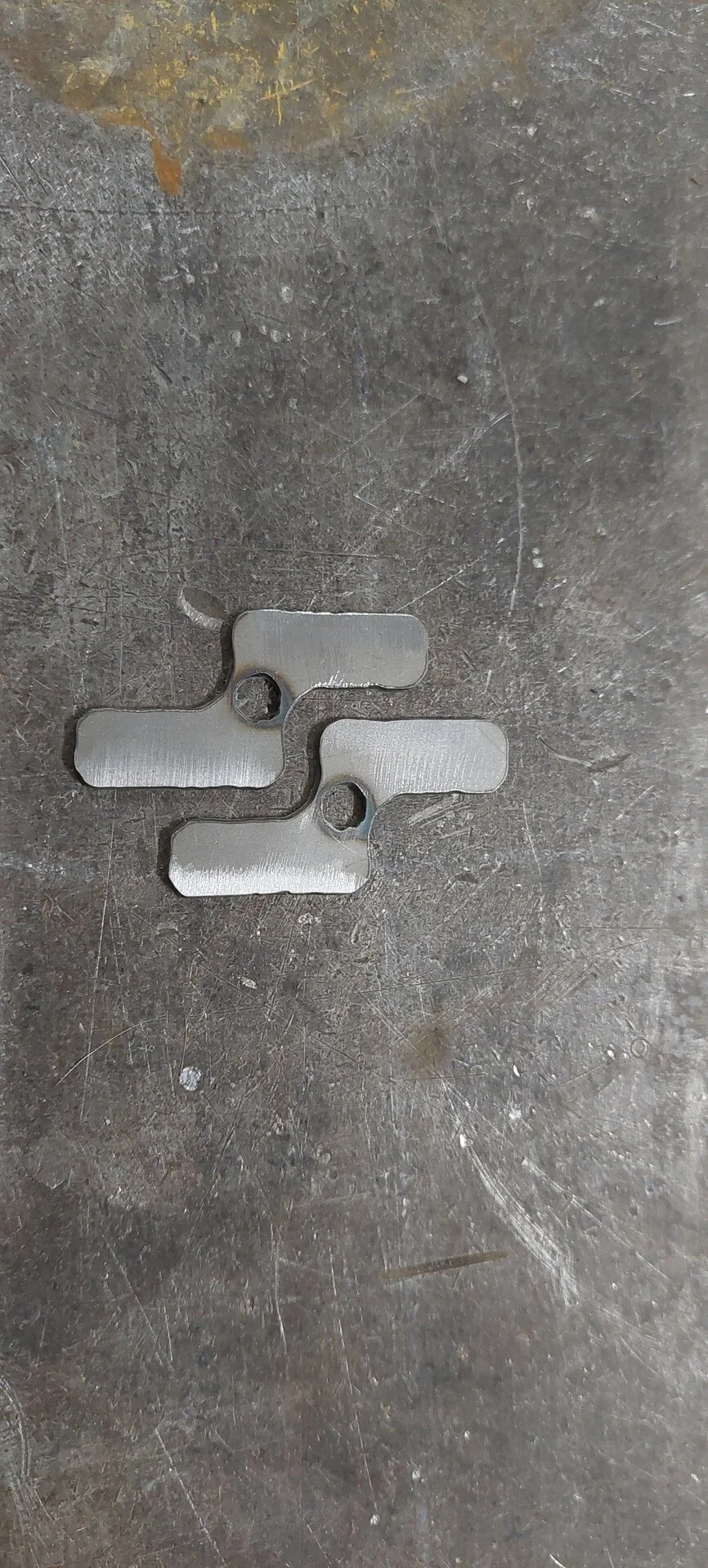

Cut some mounts on on the table that replicate the factory 40 mounts and will weld them on tomorrow. Got some lights ordered for the bumper. They are 4500 lumen (each) 6" bars with an amber DRL to use as a blinker.
Bumper mounts welded in, waiting for lights now.

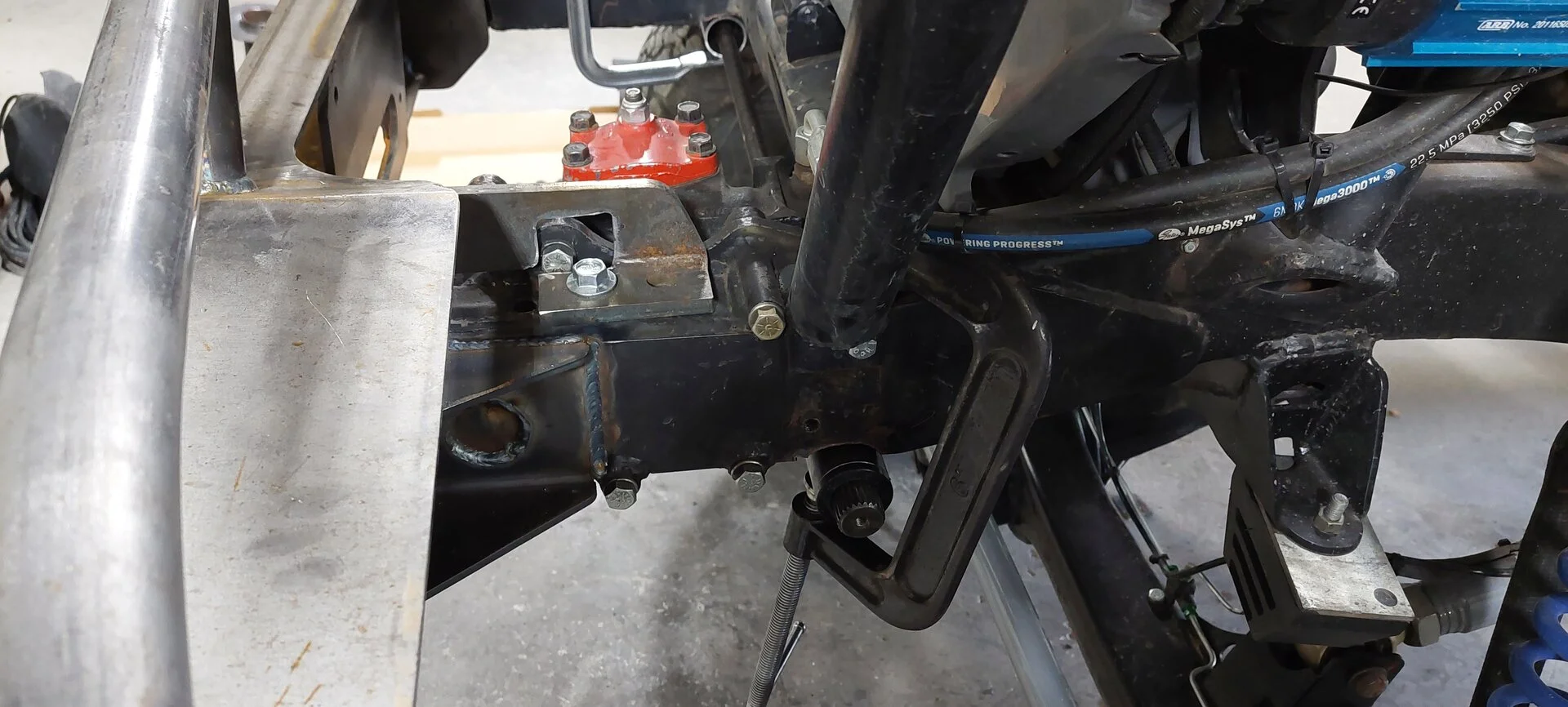

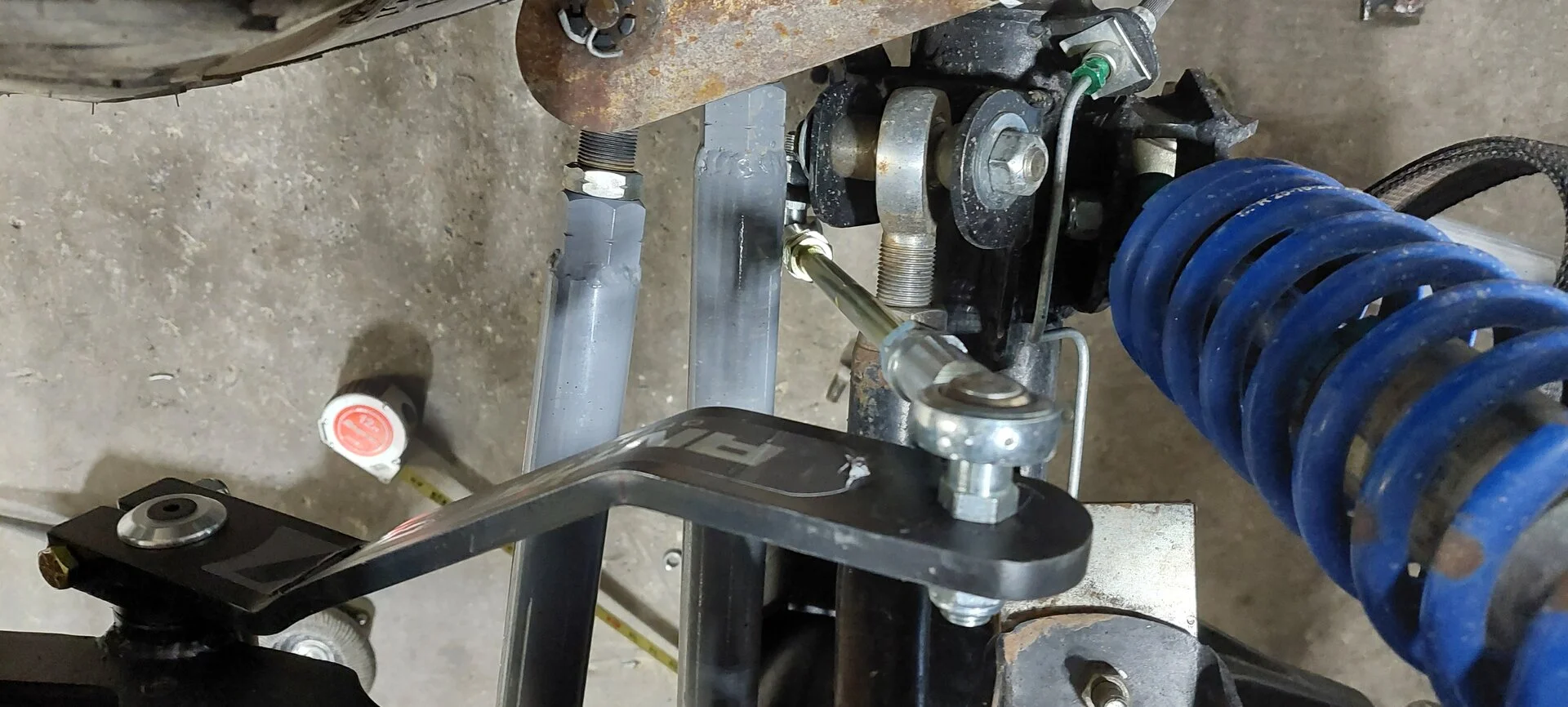

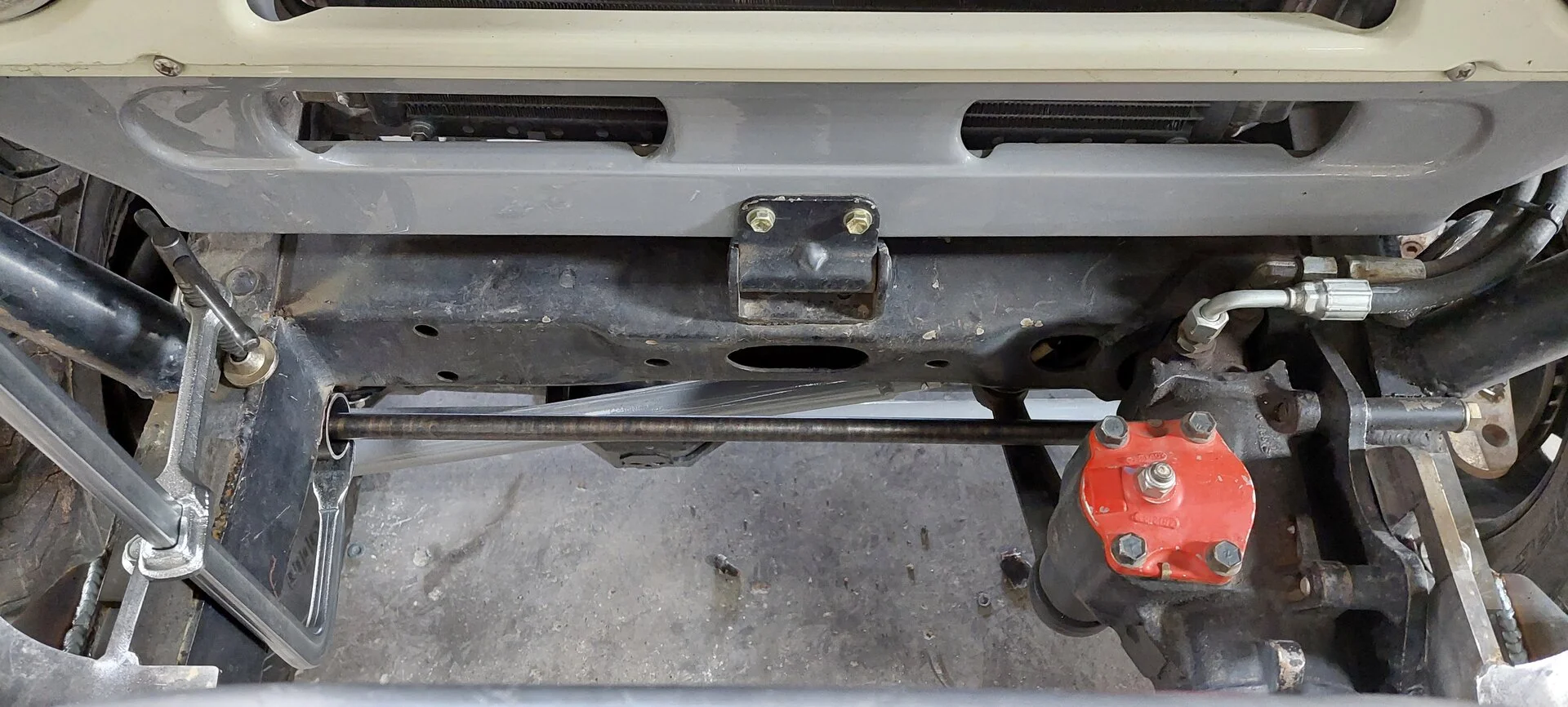

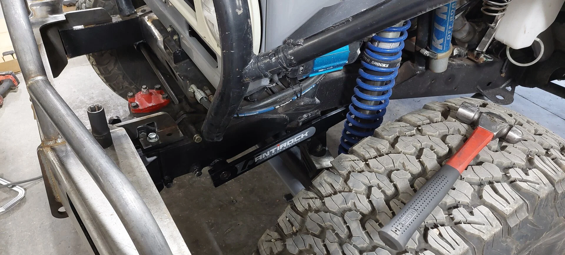

Started on the front sway bar.
Stuffs right in between the pitman and the frame.
Heavily modified the arms. Everything clears. Barely.
ooh, I need a sway-bar too, I like the location. I will have to see if I can sneak one in there too. Which bar did you use? I look forward to a report back on how it feels.

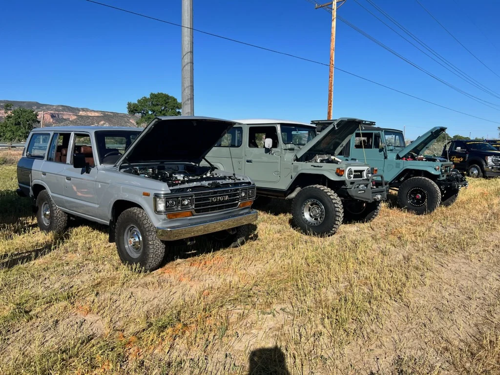

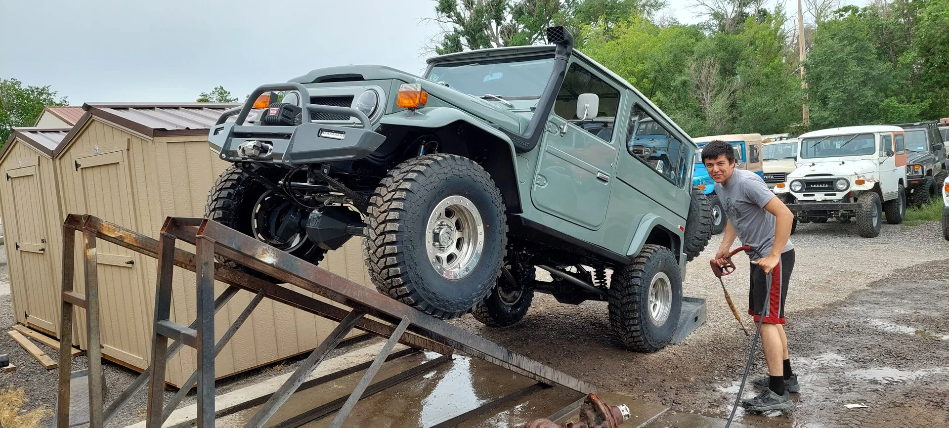

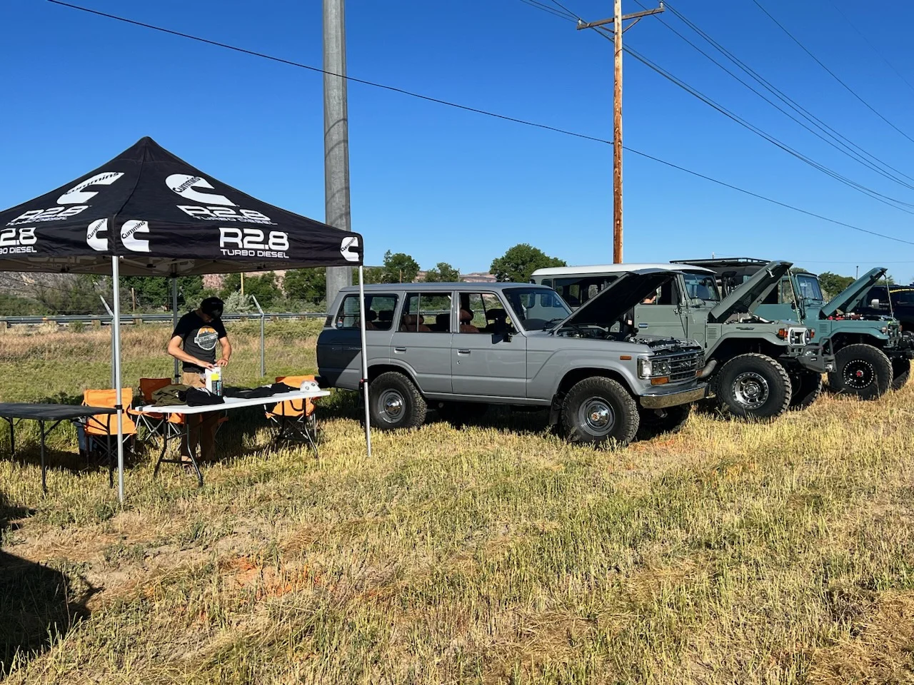

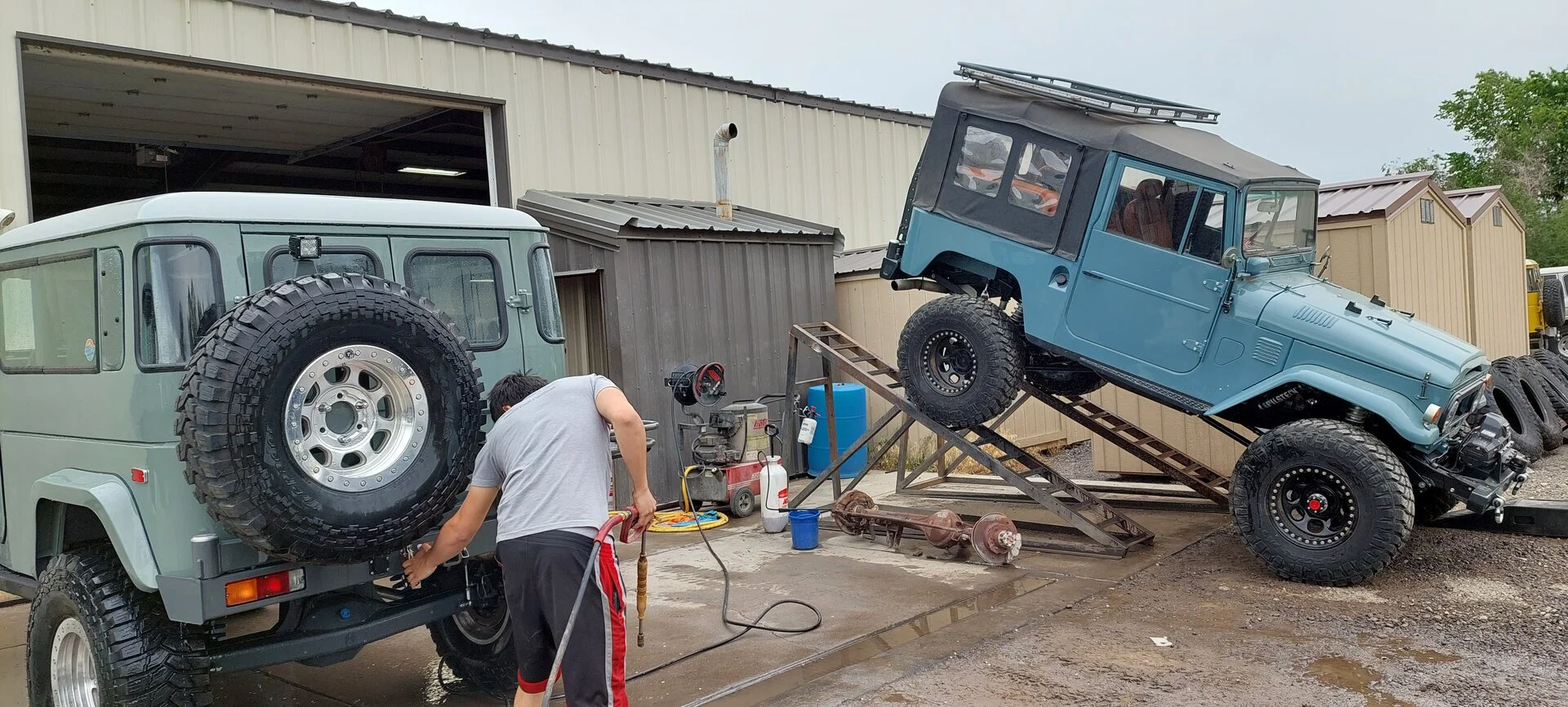

Went to the rocky mountain offroad expo today with some customer builds. Had a good time.
Got to scary ramp a few of the rigs to clean them.

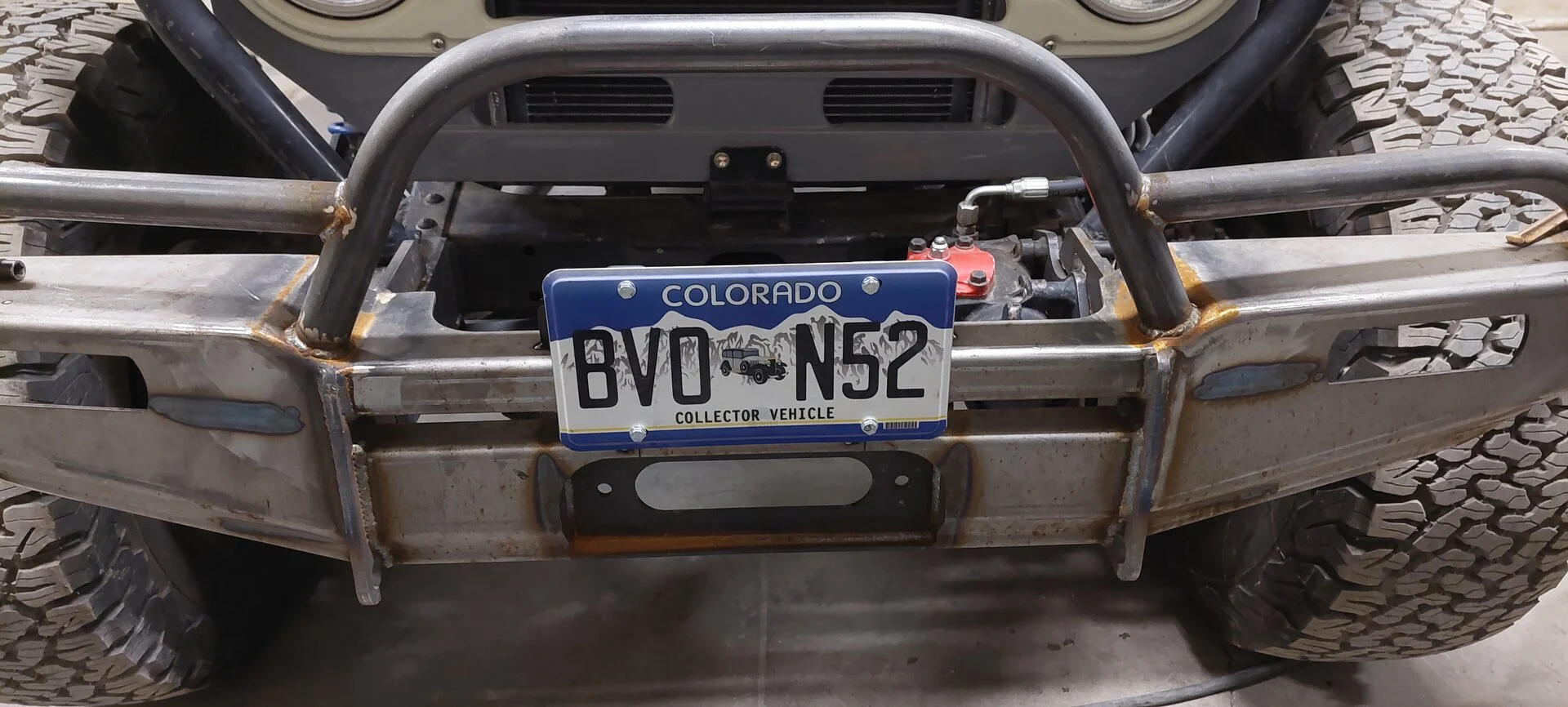

Colorado requires a front license plate, so i made a bracket for the front bumper.
Finished up the bumper.
Lights
And added some wire tabs for the lights.

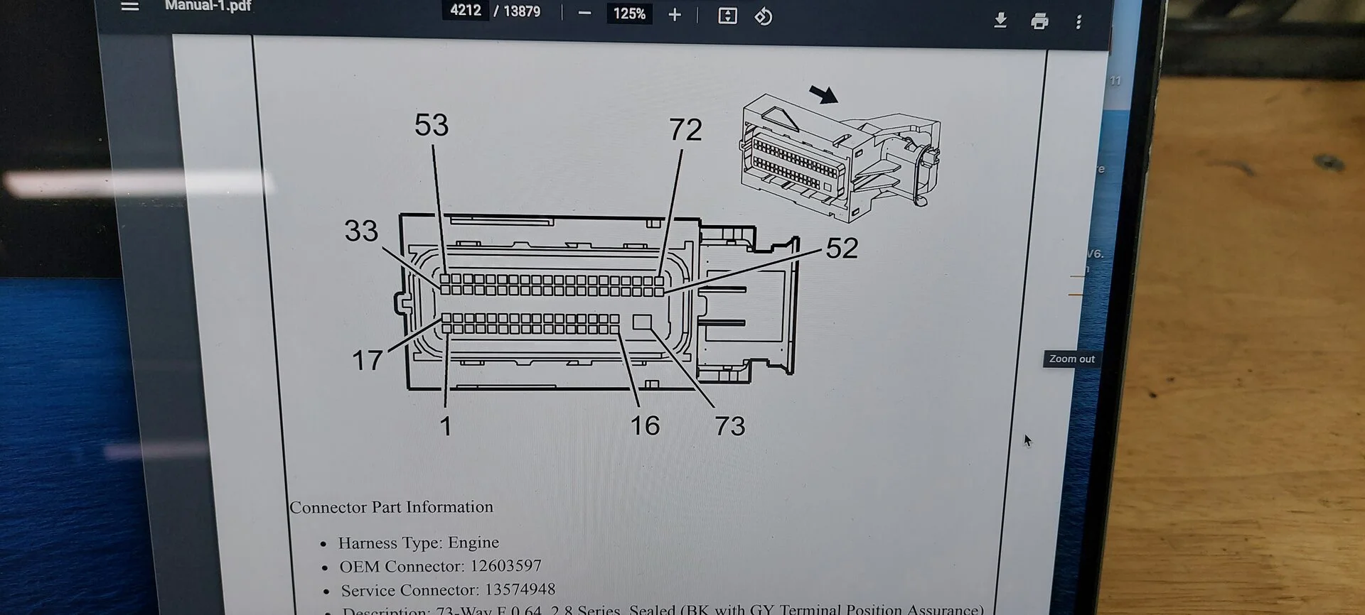

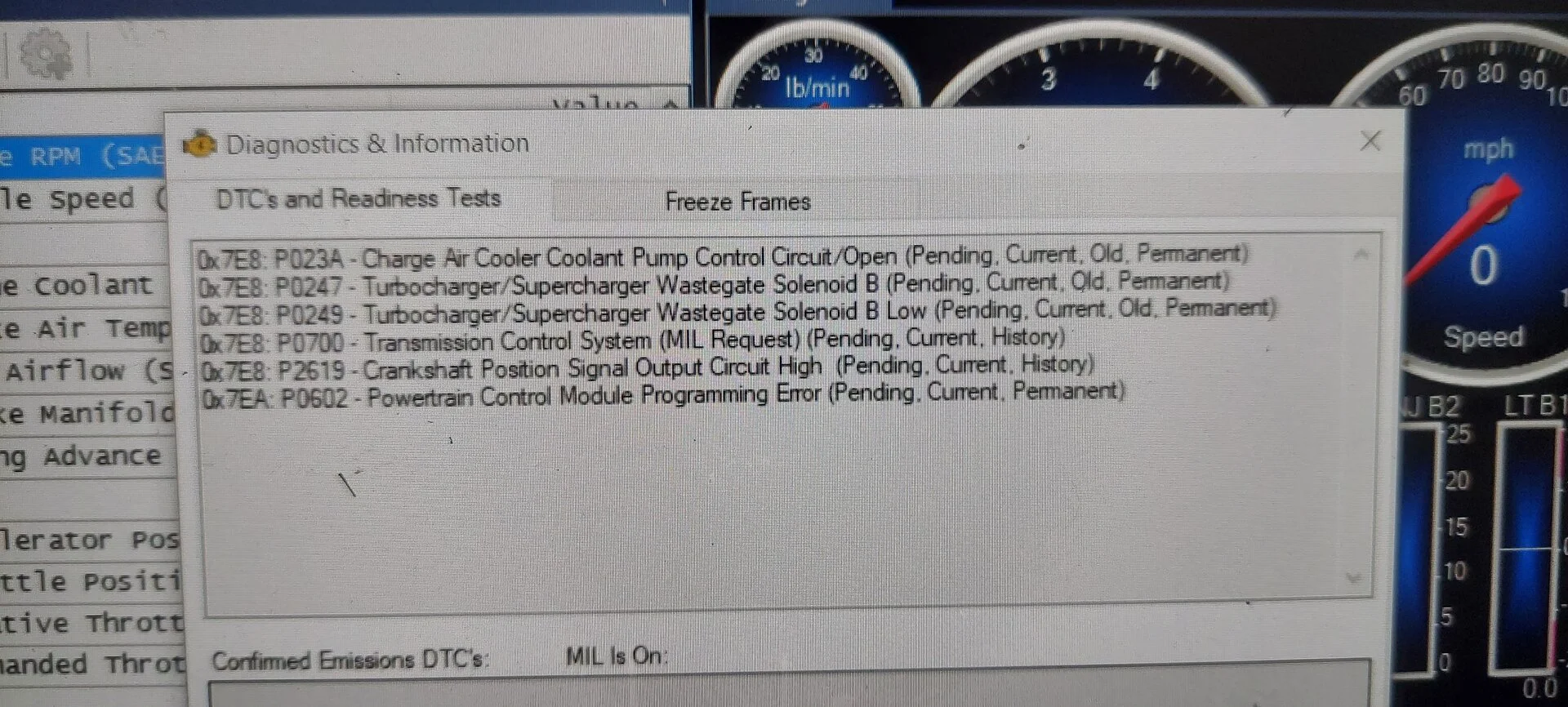

Then started playing with the harness to try and figure out codes. Check for continuity between a lot of the susposed problems.
Sooo much fun :rolleyes:
Managed to do something, and I got some codes to change. So progress, maybe?
DJ what size AntiRock bars did you go with on your rig? I am looking at one for the rear of mine.
I went with an 1" on the rear, and 3/4" up front.
Well, the 8l90 is shifting now. It had a fully corruped TCM tune. Got that reflashed today and all is well. I need to redo my intake to get my maf sensors happy, and it seems like it is slightly restricted by how rich it runs. We do it nice because we do it twice :rofl:
