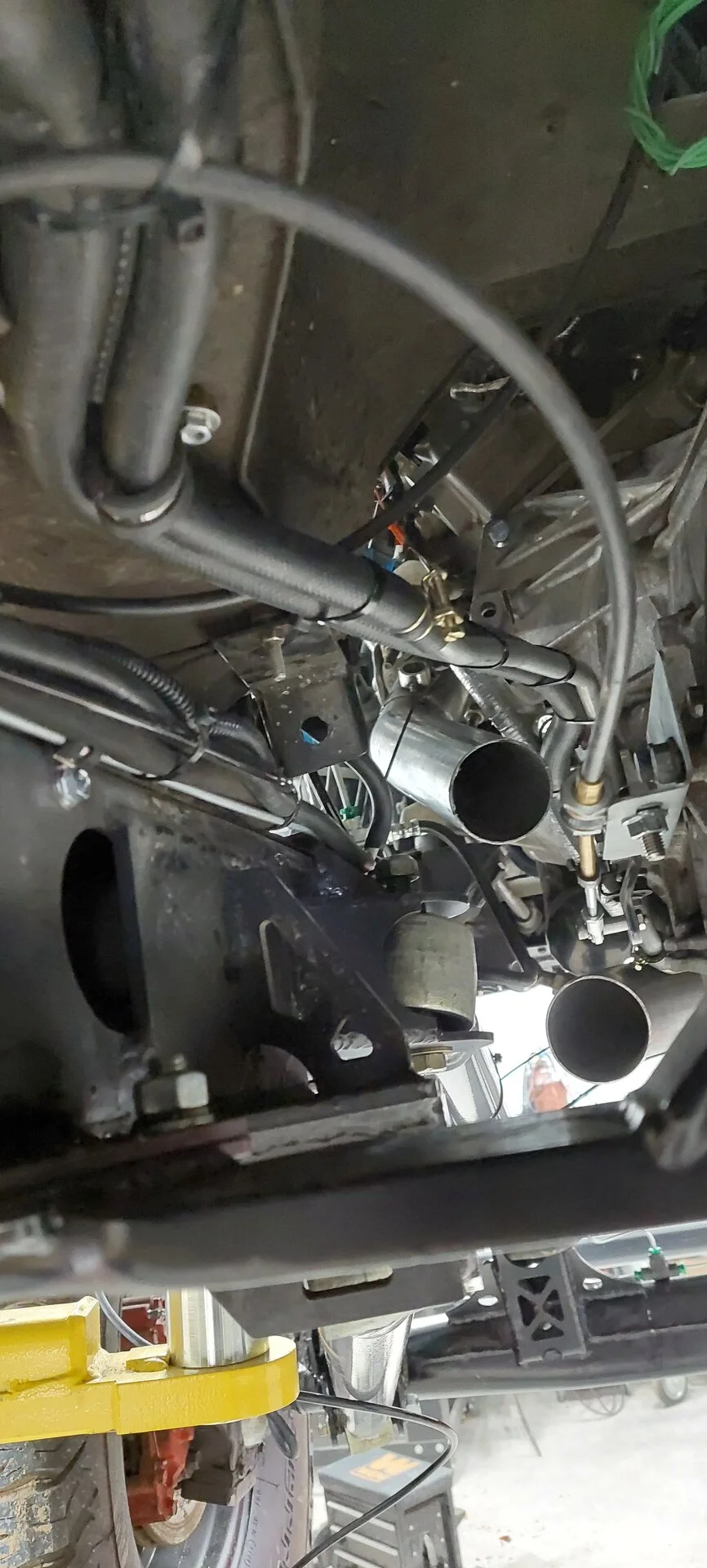

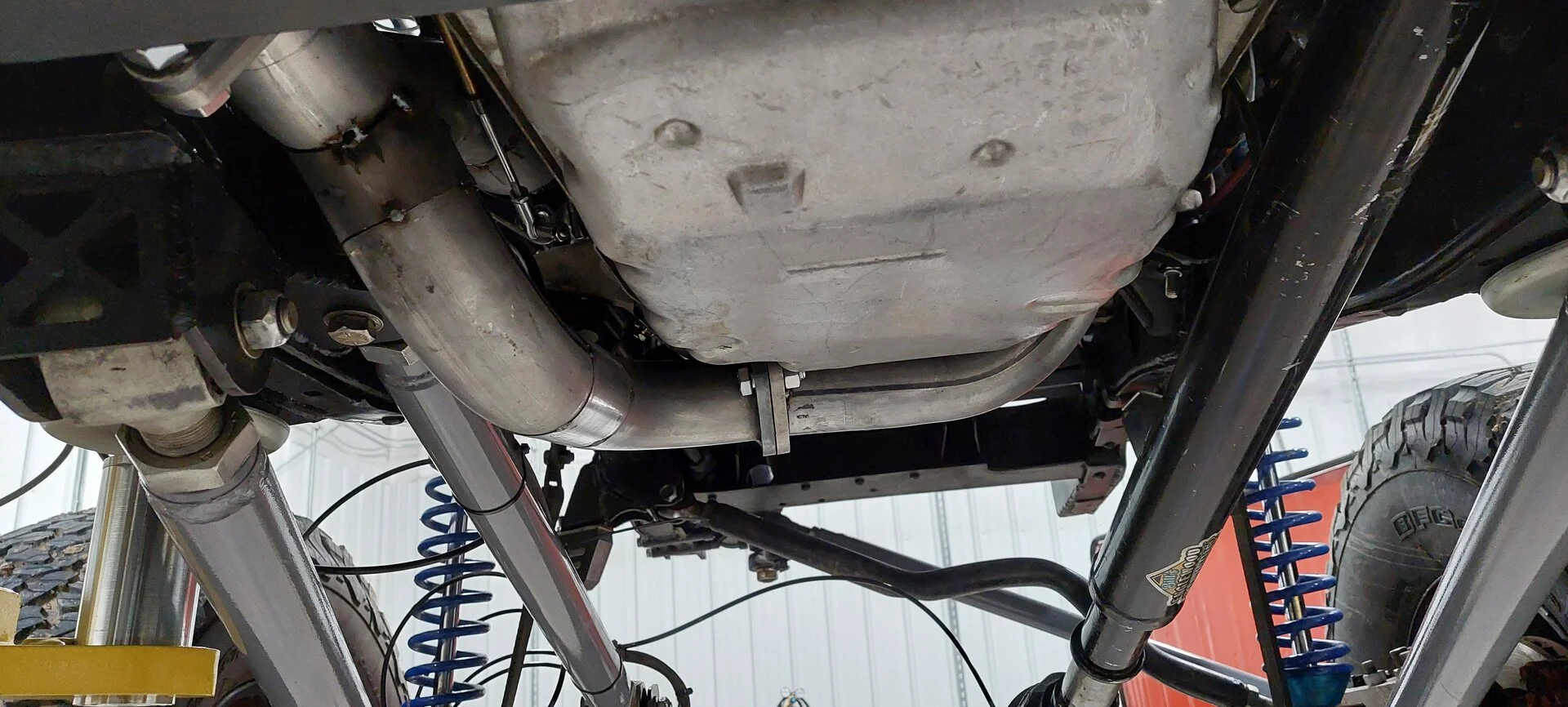

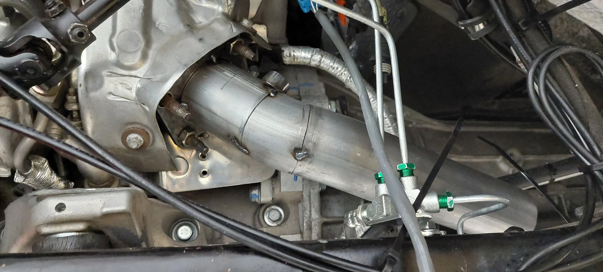

Exhaust time.
P/s turbo bank.
Under the bellhousing.
D/s turbo bank.
A nice walk around the link mounts.

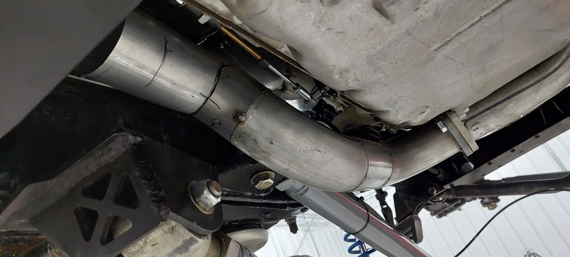

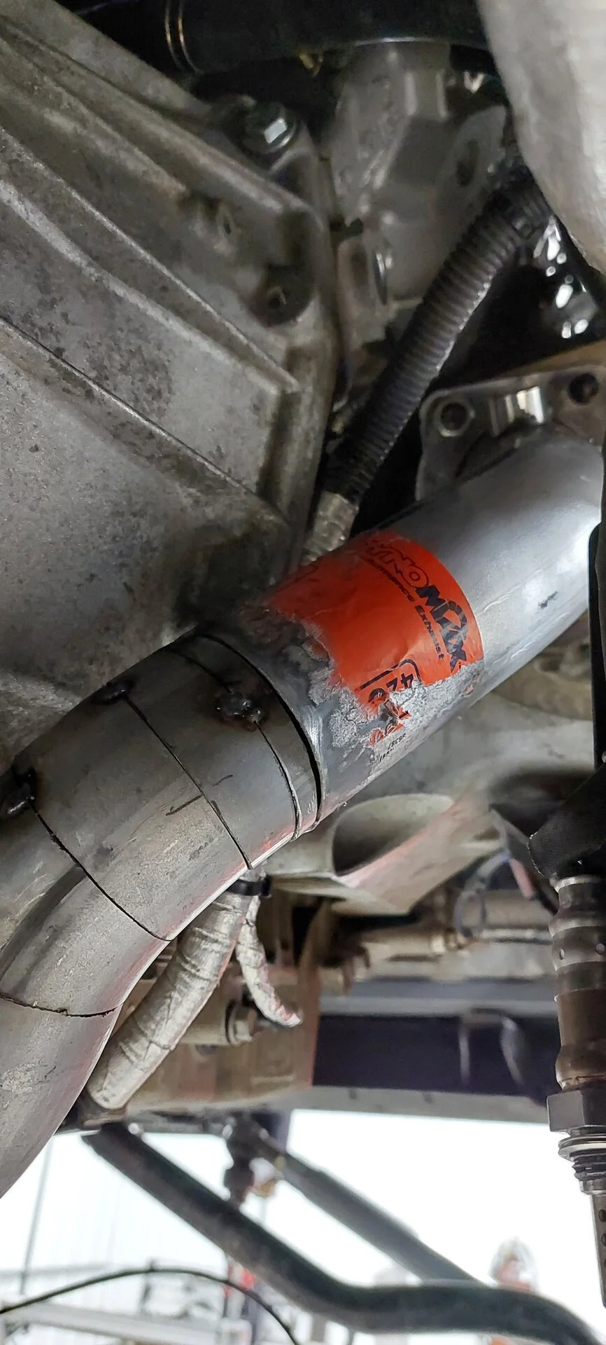

I have a ton of heat wrap to get all the stuff close to the exhaust, and the exhaust.
Y pipe.
Cat back.

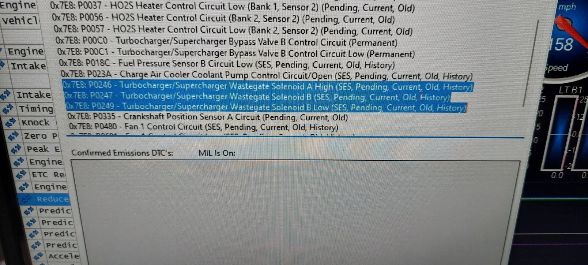

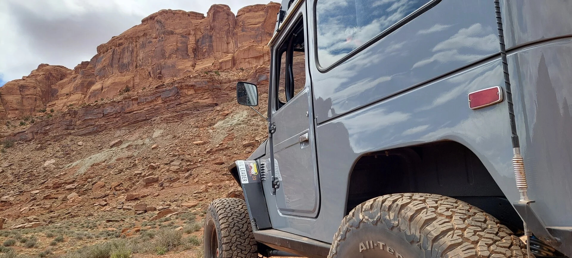

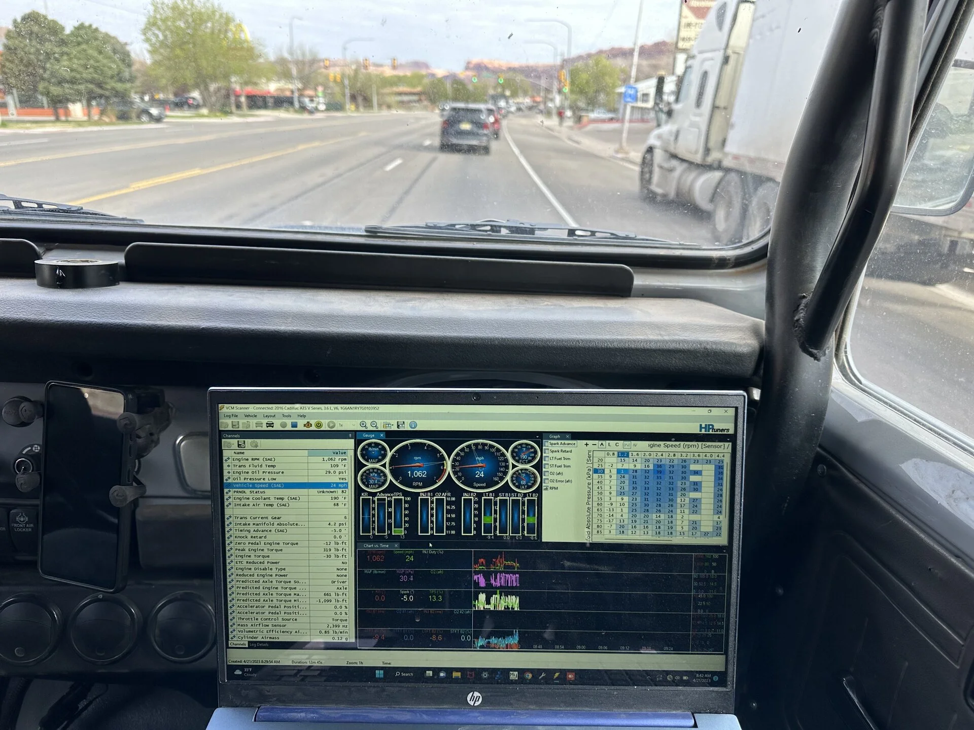

Had a few teething issues in moab, trans didn't want to shift and it seemed like I was in a partial limp mode, stuck in 3rd and rev limiter of 3K.
I was eventually able to trick it into shifting and running normally, but always had to have HP Tuners open, so that's what happened.
Anyways, had a really good cruise moab with the shop, lots of fùckery as usual, so it's always a good time. Almost rolled the cruiser on hells gate, pretty good driver error lol. I'll post that video in a bit.
