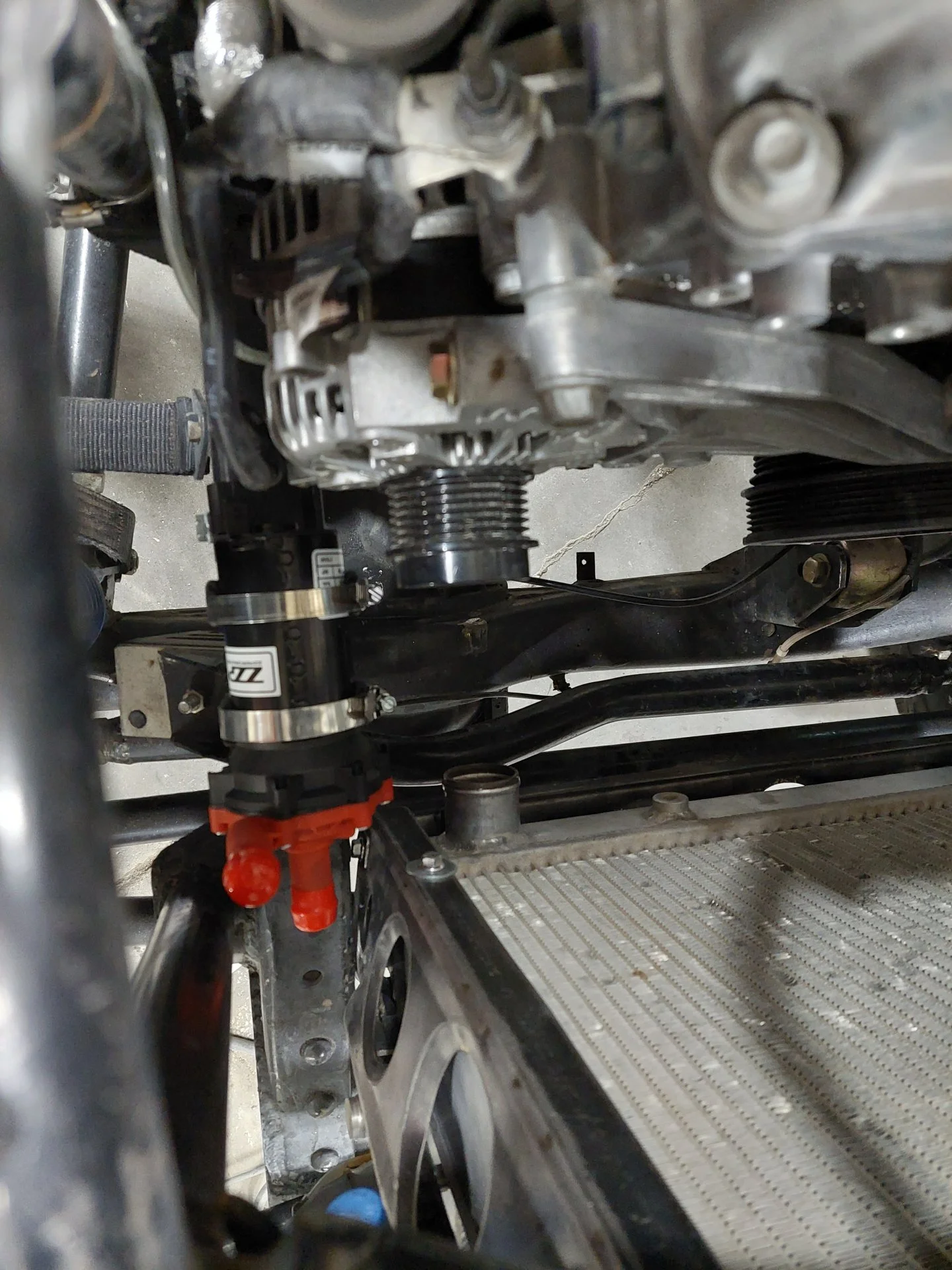

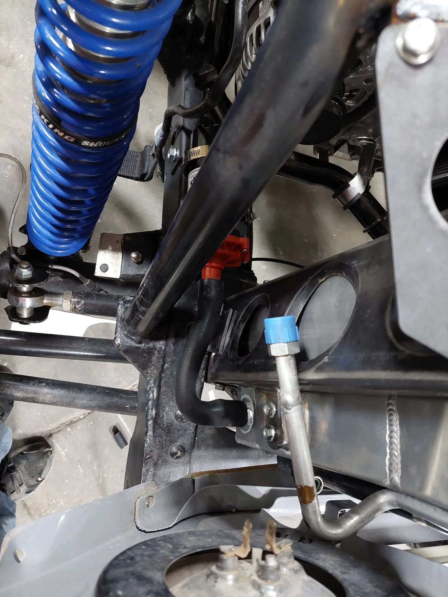

looking great. make sure that reservoir hose is as straight shot as possible
And downhill the whole way too.
Thanks for the great advice. It's the same as the guys here. I'm trying my best to get it all to fit. I'm hoping to get my intake tubes done before I get the resi placed, but I think I can get fall with it, or at least parallel with the pump.

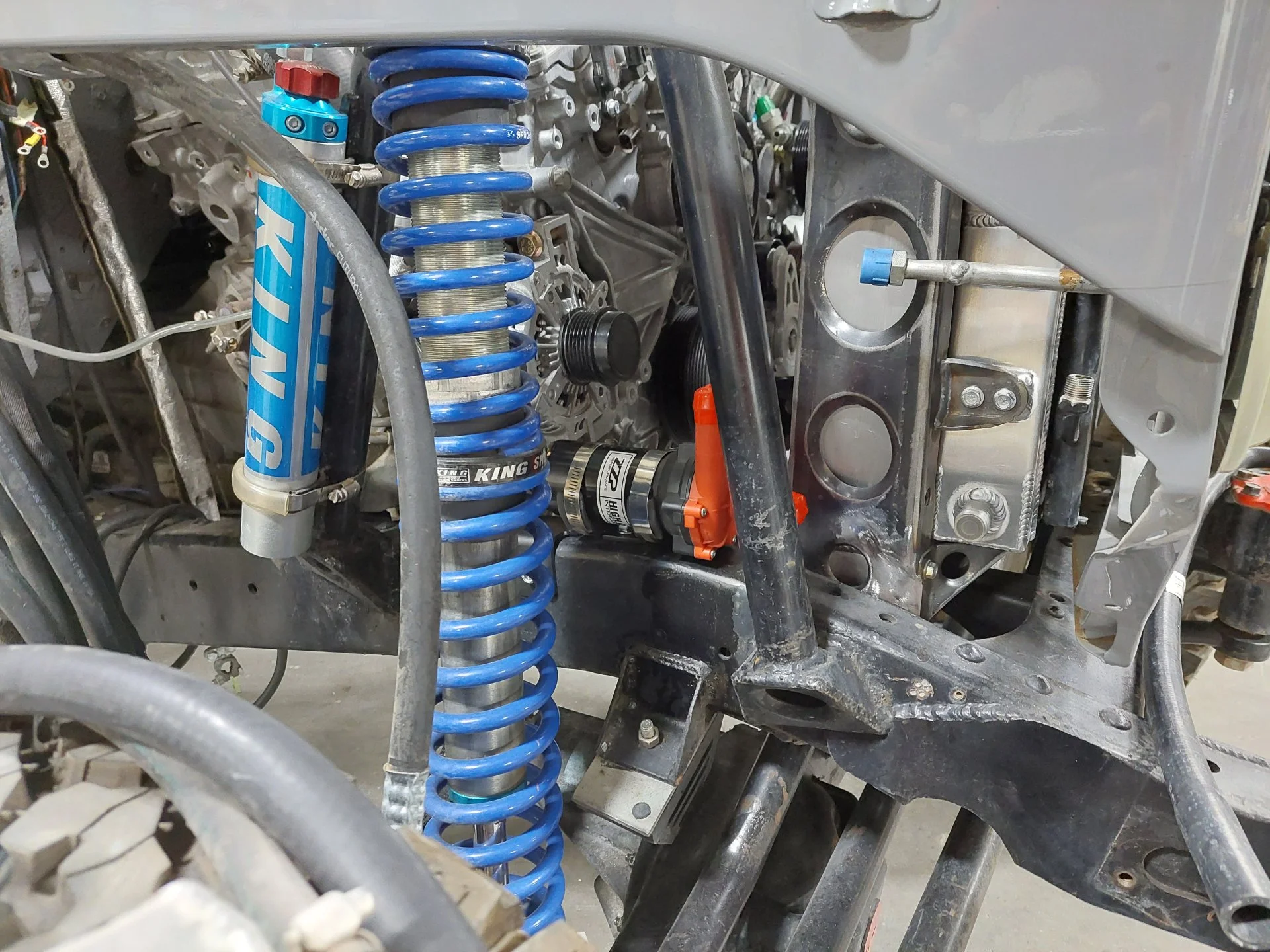

Intercooler pump mounted.
I found a perfect 90° hose that fits great.

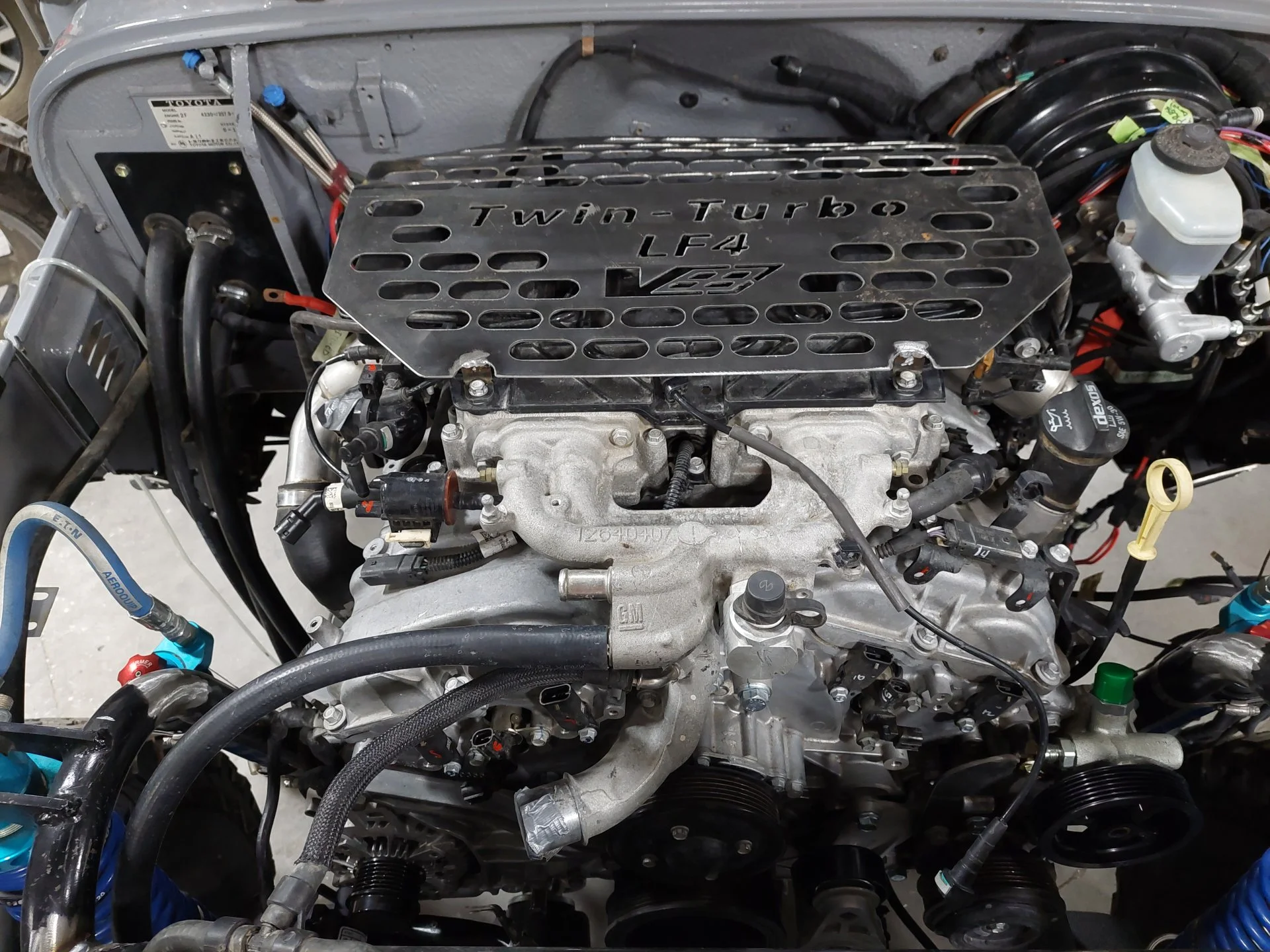

Vanity cover back on. What color should this be? I'm thinking body, black, or king blue.

Body color with a King color anodized plate under the lettering maybe.

I vote body color too. Maybe even do the rad support in body color. Seemed to look good in the EMP 40 engine bay. Keep up the good work DJ!

Thanks guys! I'm going to check with some of the body guys here and see what they think, since they have a knack for that, but I'm leaning to body color with king blue letters. It think that would be pretty sweet looking.

Well, the body guys opinions are in. The general consensus is matted out body color on both the cover and the rad support with King blue accents, intake, etc. I think I'm going to follow that cause it will look really unique, and should be awesome.
Maybe satin instead of flat?

It's not really "flat" matted out, still pretty shiny, but just a little contrast to everything else.
But you are totally right for keeping it clean. Might see about that.

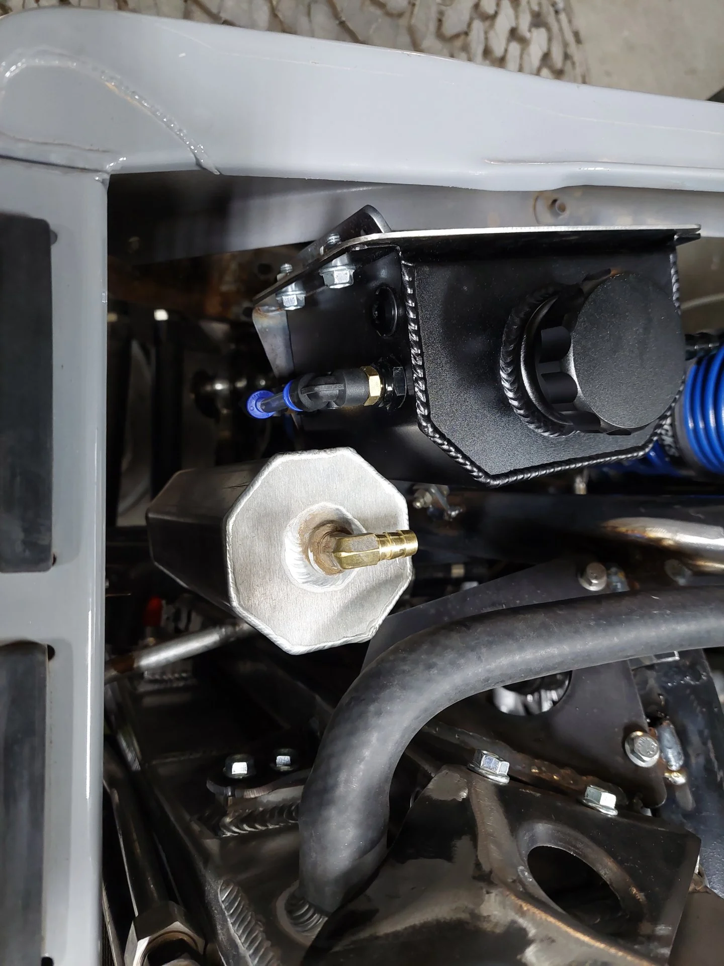

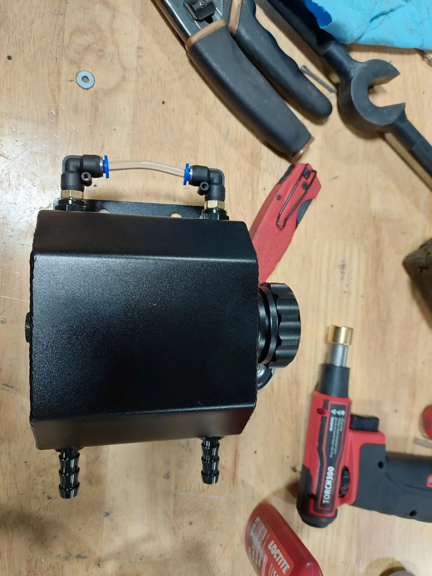

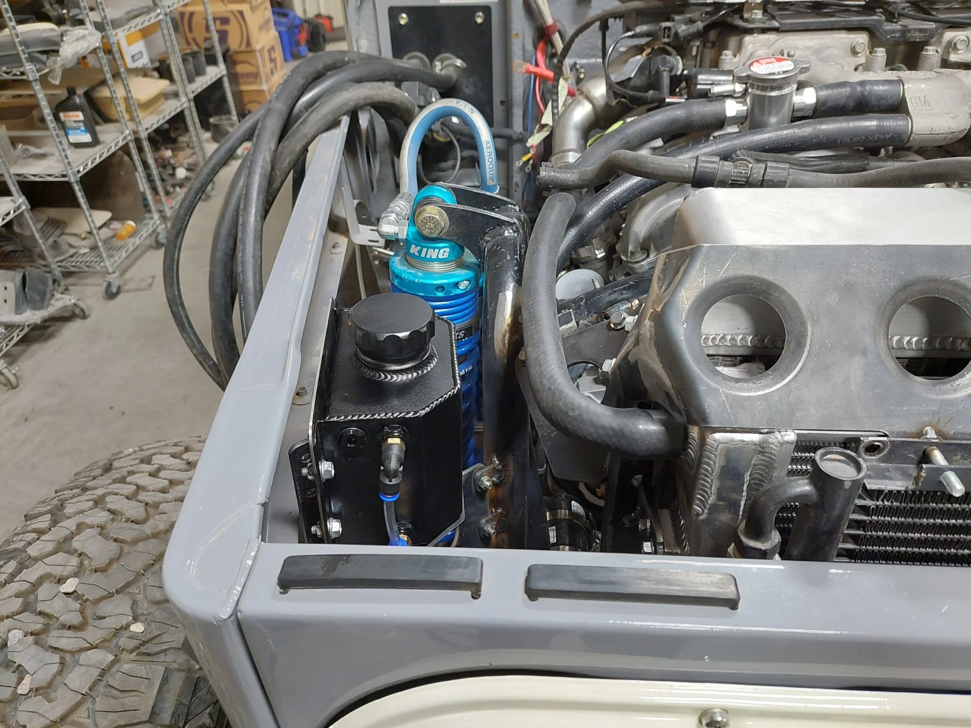

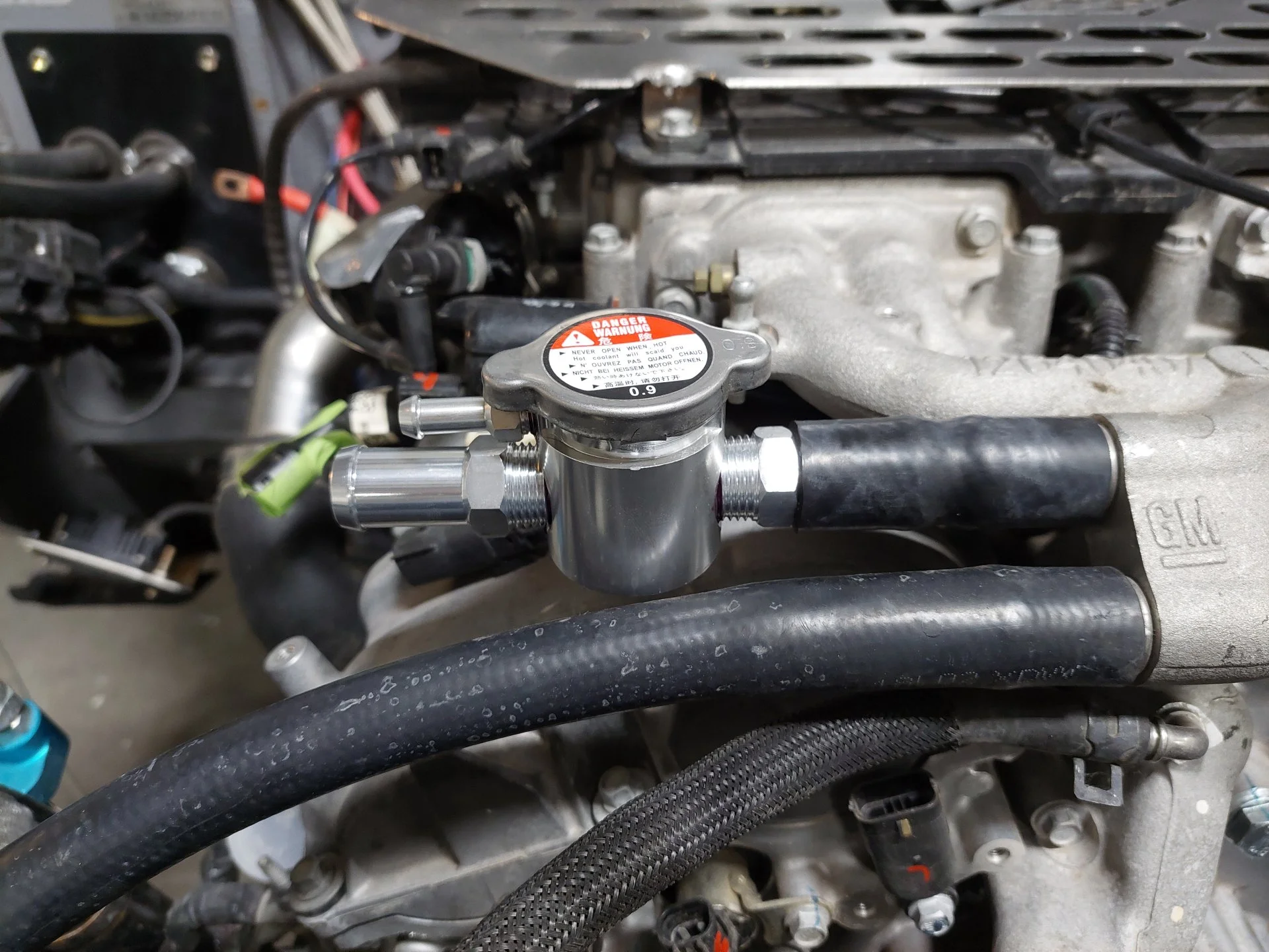

Radiator overflow bottle.
Mounted up.
Intercooler fill neck.
Intercooler overflow bottle.

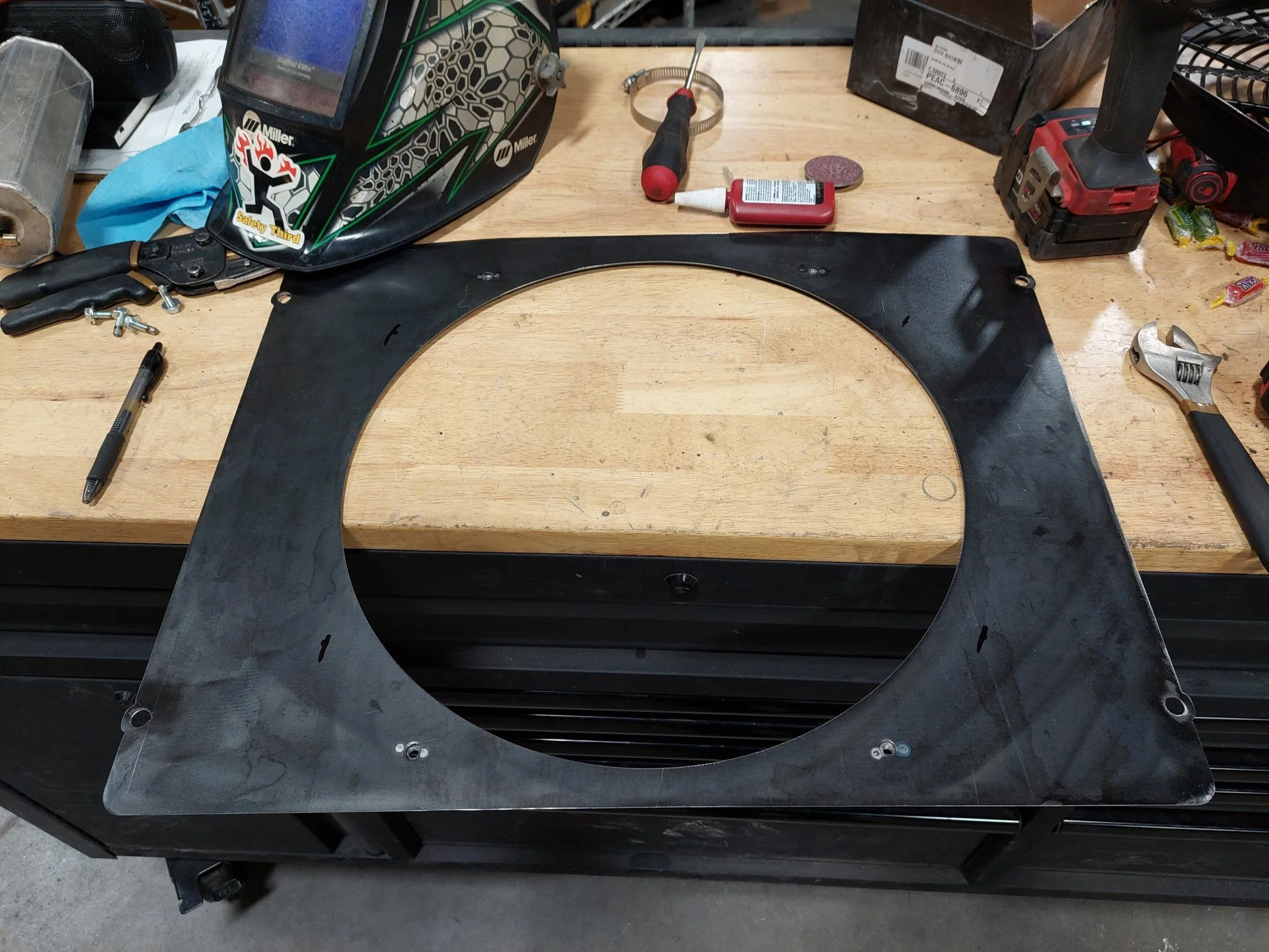

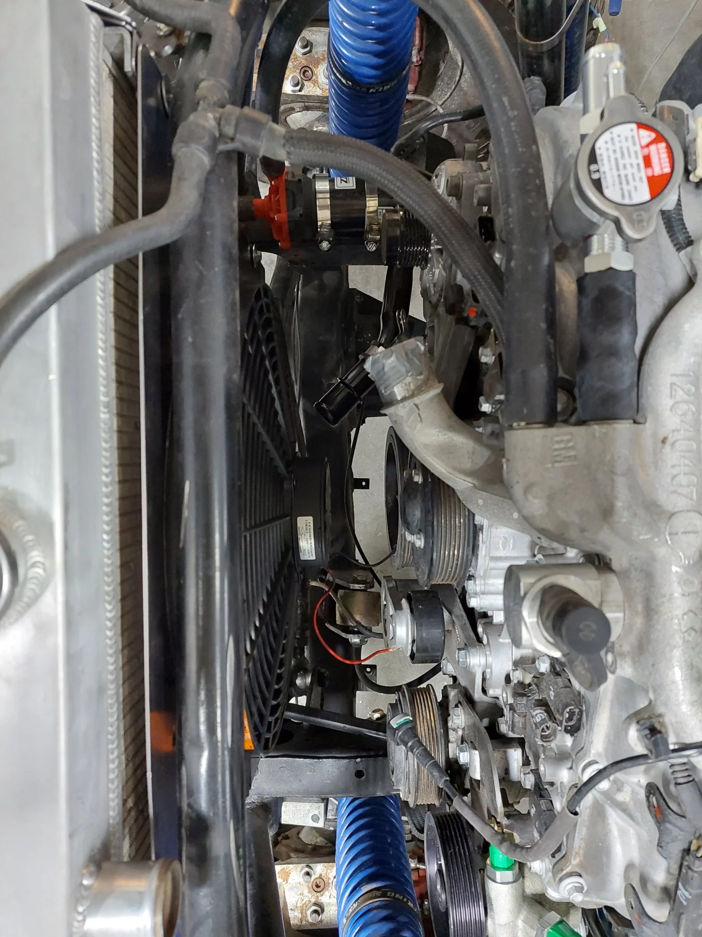

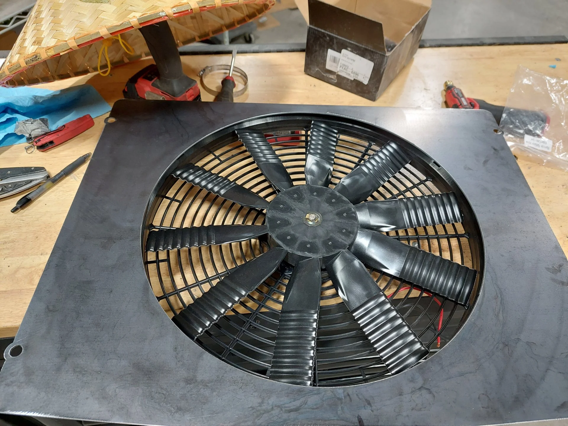

Fan and fan shroud
Fits very nicely.

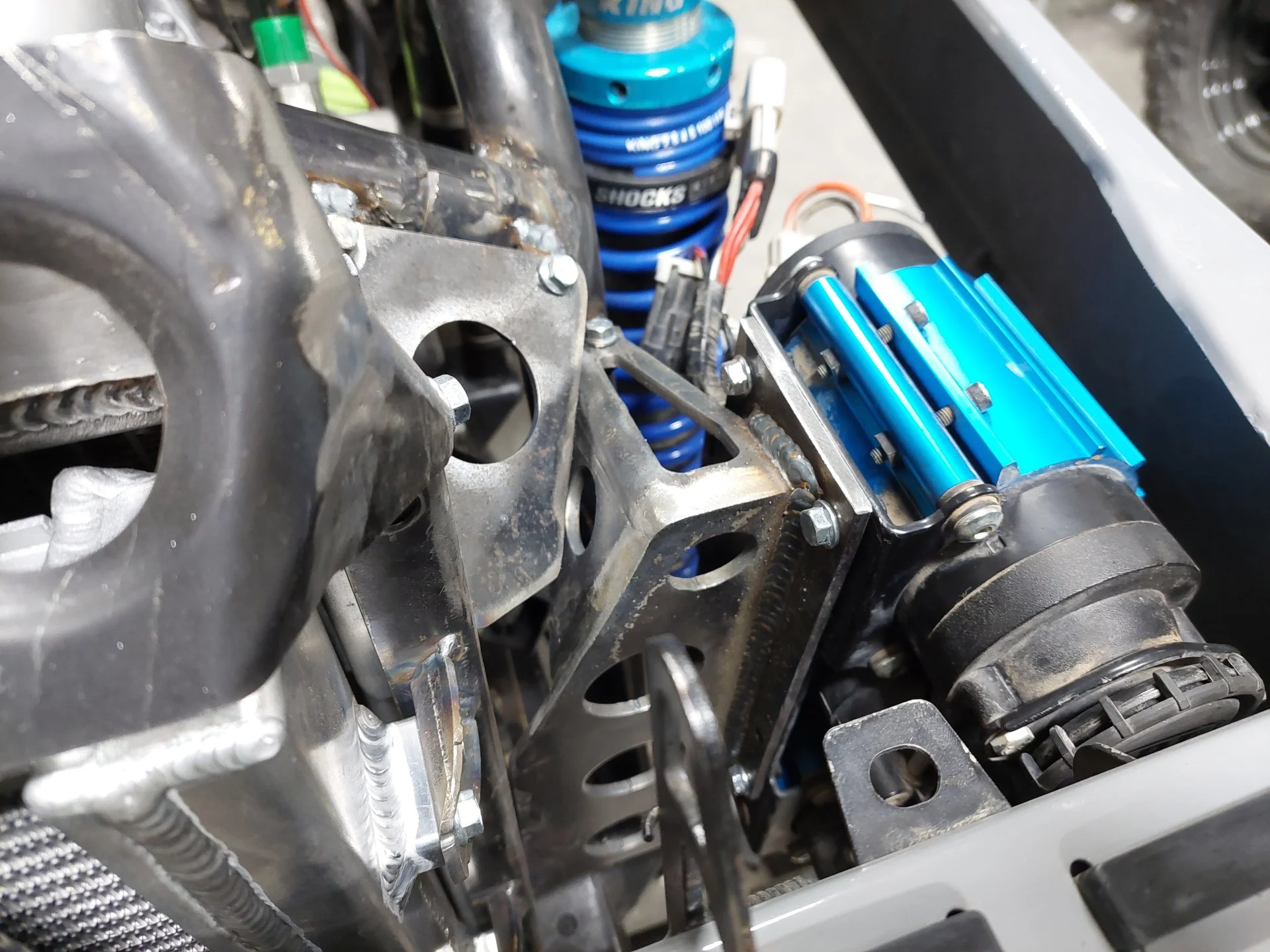

Arb compressor mount.
Back in.
Tucks into the dead space nicely.
Overflow bottles plumbed.
Still a ton of stuff to do.

Looking good! Mechanical fan not an option? Electric fan cooling is hit or miss.
