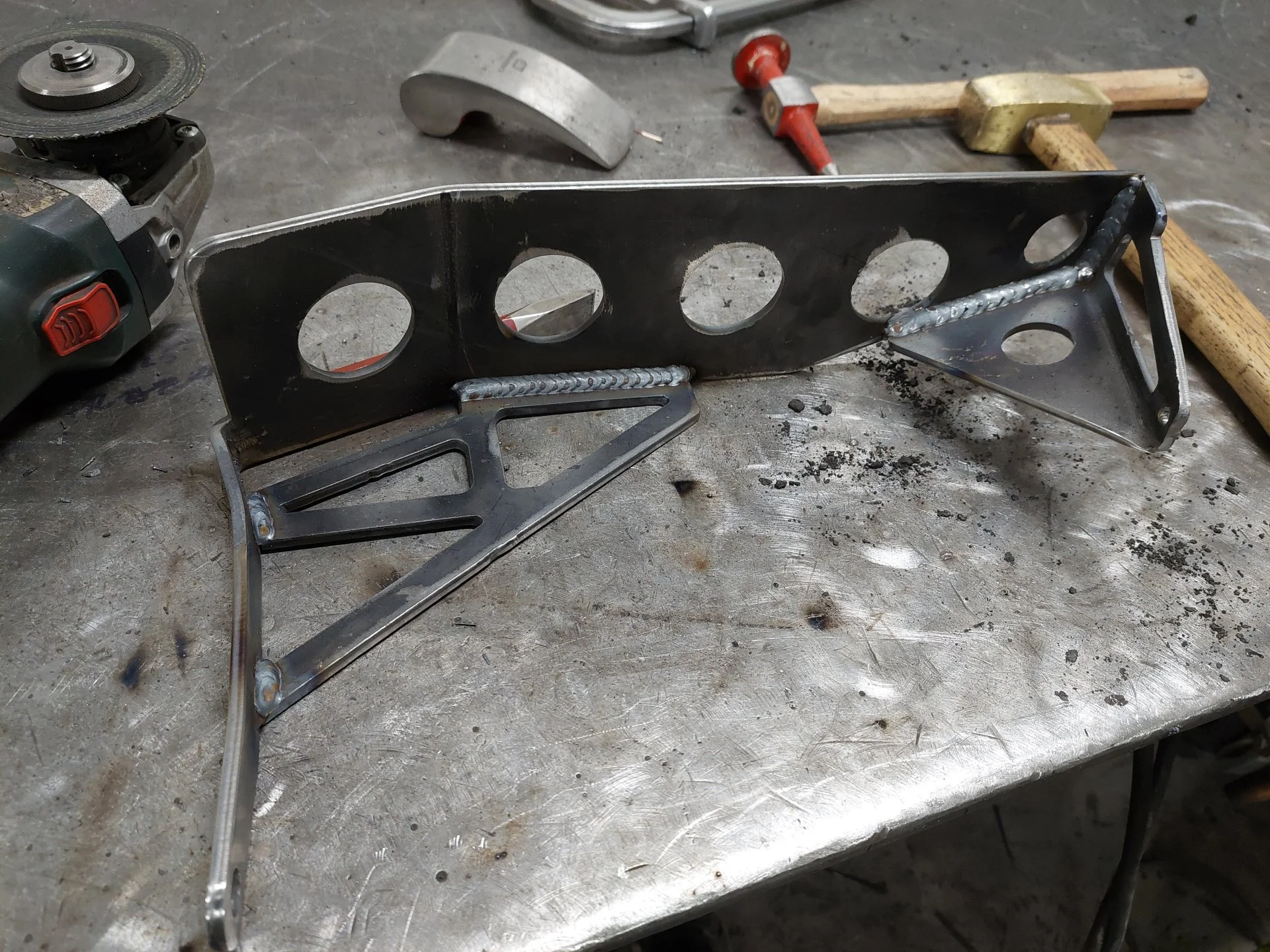

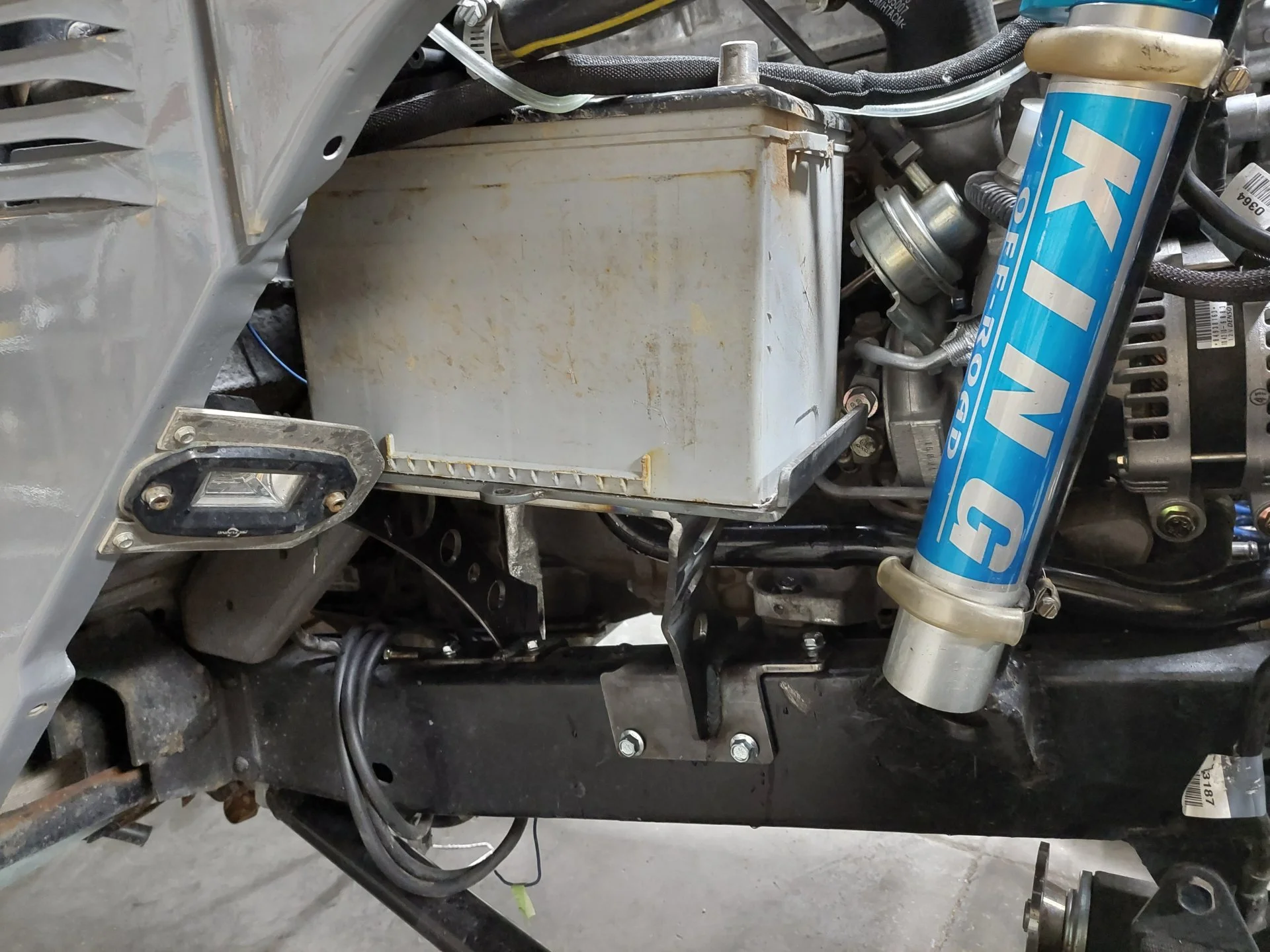

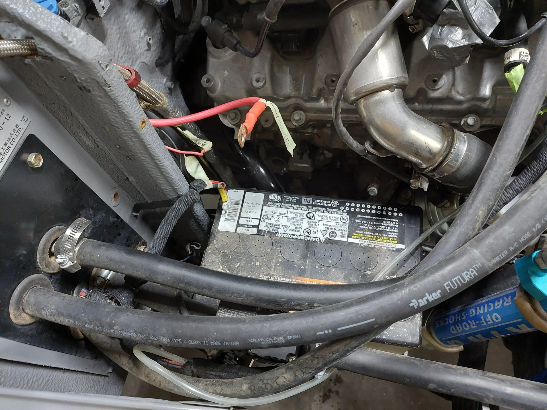

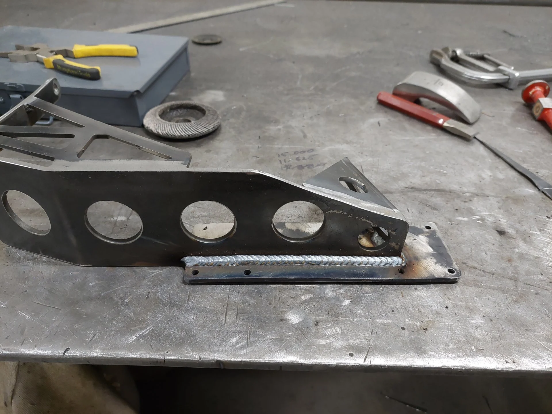

Battery tray.
Made a few little personal touches. You'll never see it unless you pull the battery.

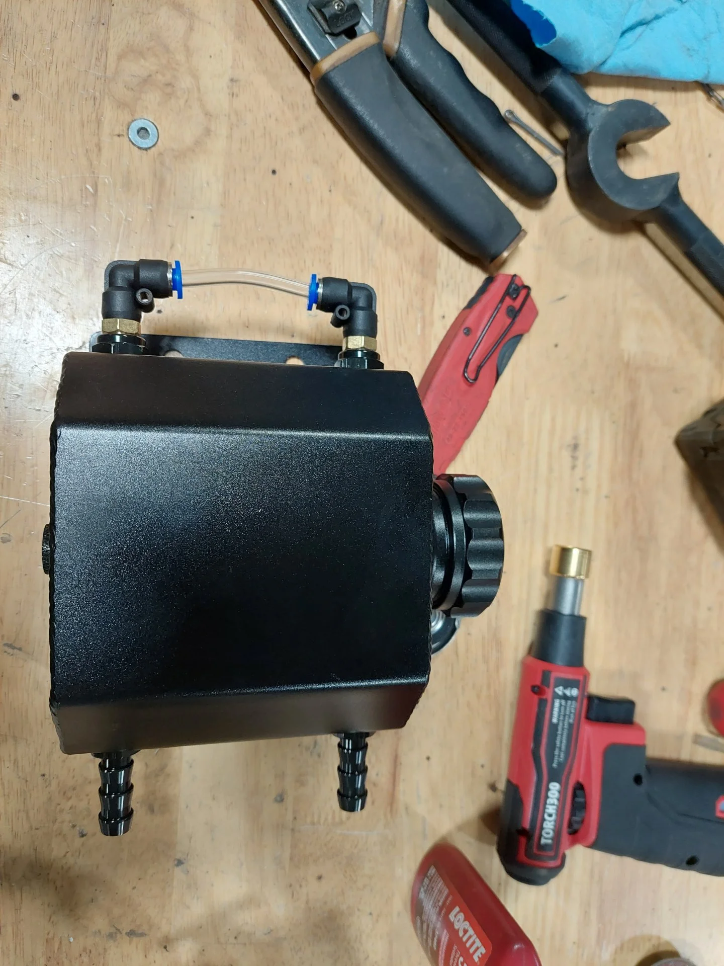

Intercooler fill neck.
Intercooler overflow bottle.

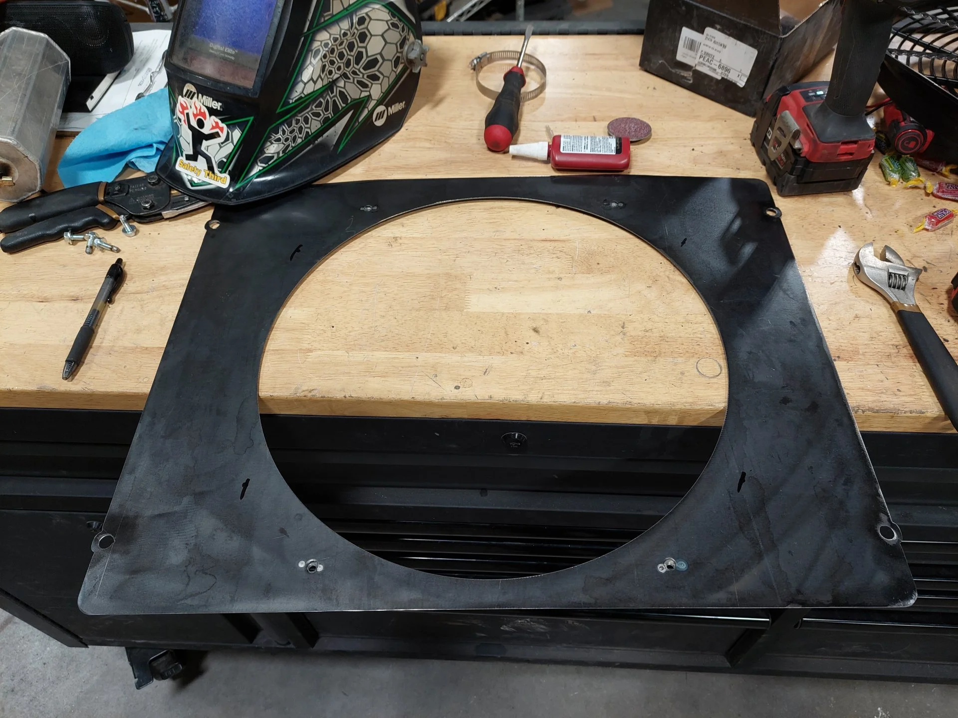

Fan and fan shroud
Fits very nicely.

What did you use to bolt battery tray to frame? Nutserts or other? Nice work. Must be nice to have access to CNC and breaks for thicker stuff!!
All factory holes, 4 M8 that were already there, and 2 rivet holes that I stuck M10s in.

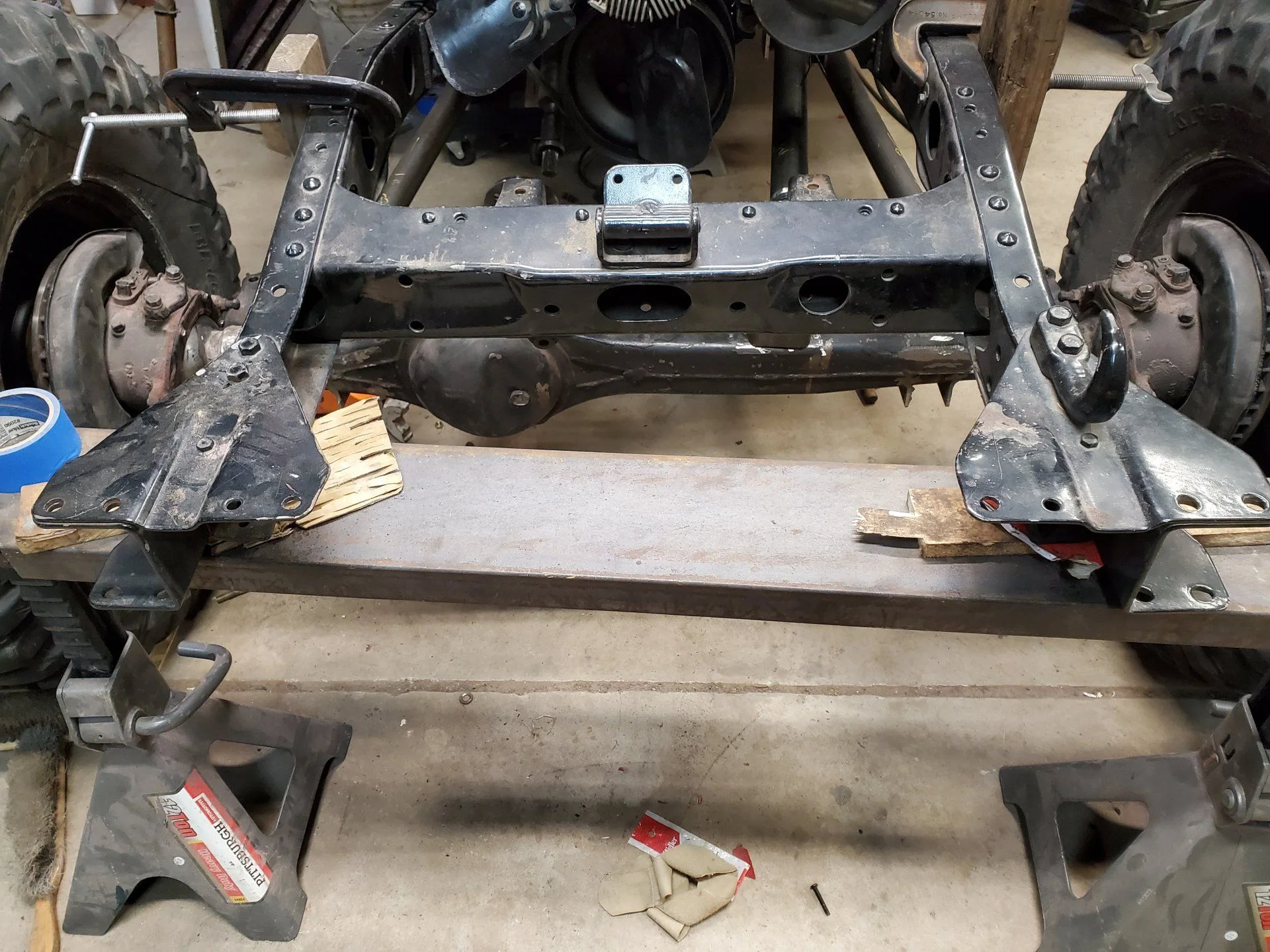

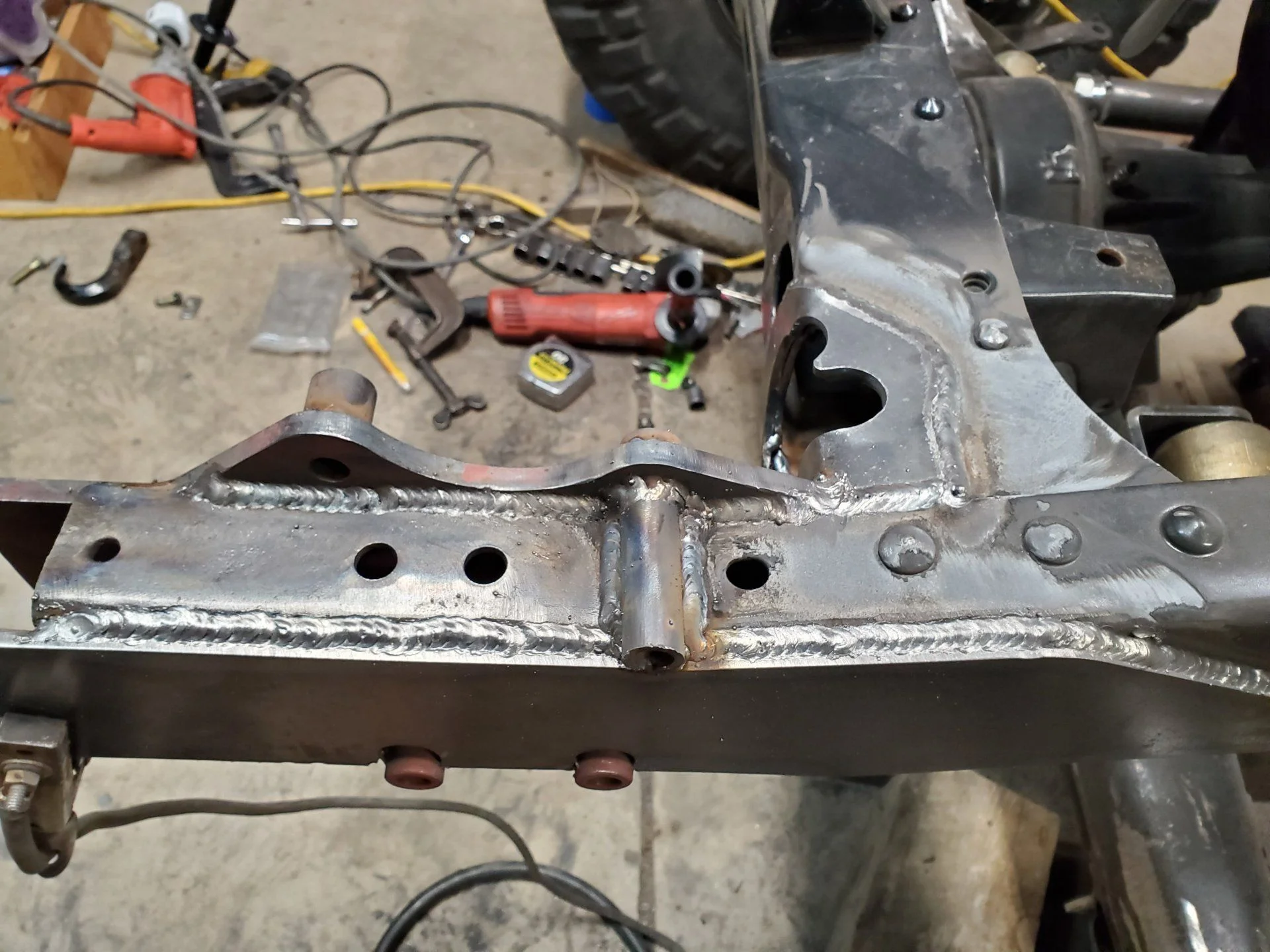

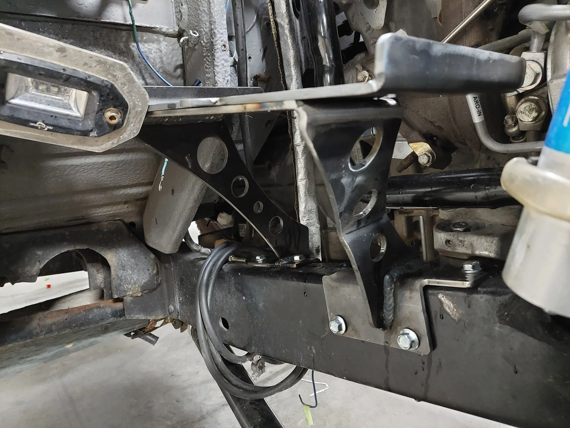

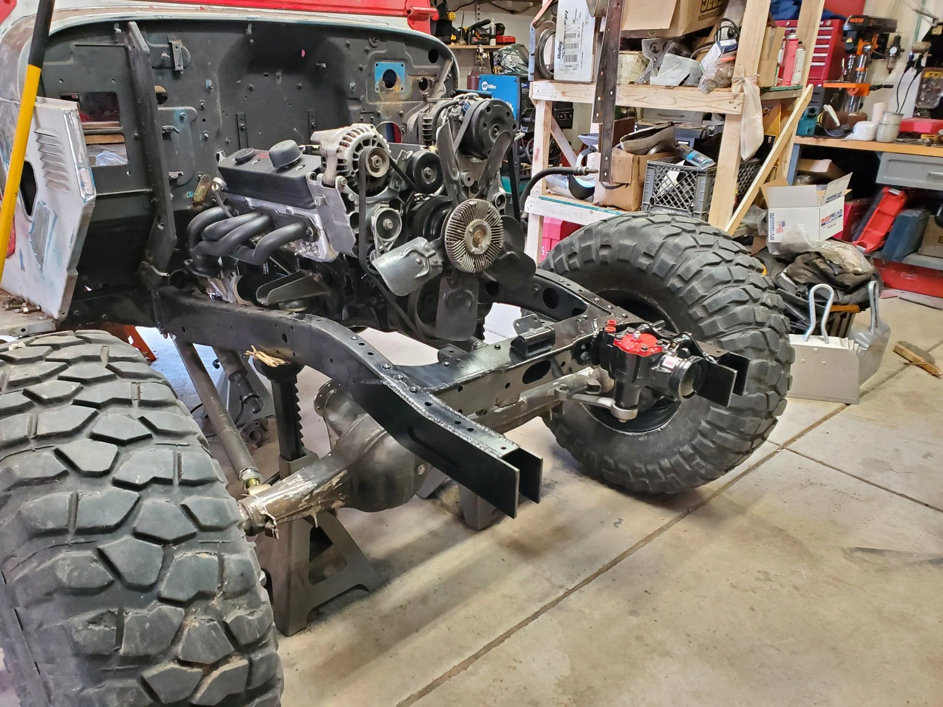

I got the saginaw conversion completed today. I am using the 4x4 labs kit. It went together great, and was a pretty easy install. The steering box is a heep J20 box, rebuilt by Redhead Steering Gears.
Here is how the frame started today.
Brackets stripped and everything lightly tacked.
Fully welded.
The kit was pretty easy to install. I like that it locates the box without much work.
Do you remember the part number of the RedHead steering gear box you put in ?
Did you get the link geometry worked out? I want to see this thing go up the wall.
Working on it with alex, have to swap sides anyways to clear my oil filter, and I'm linking the rear while I'm in there.

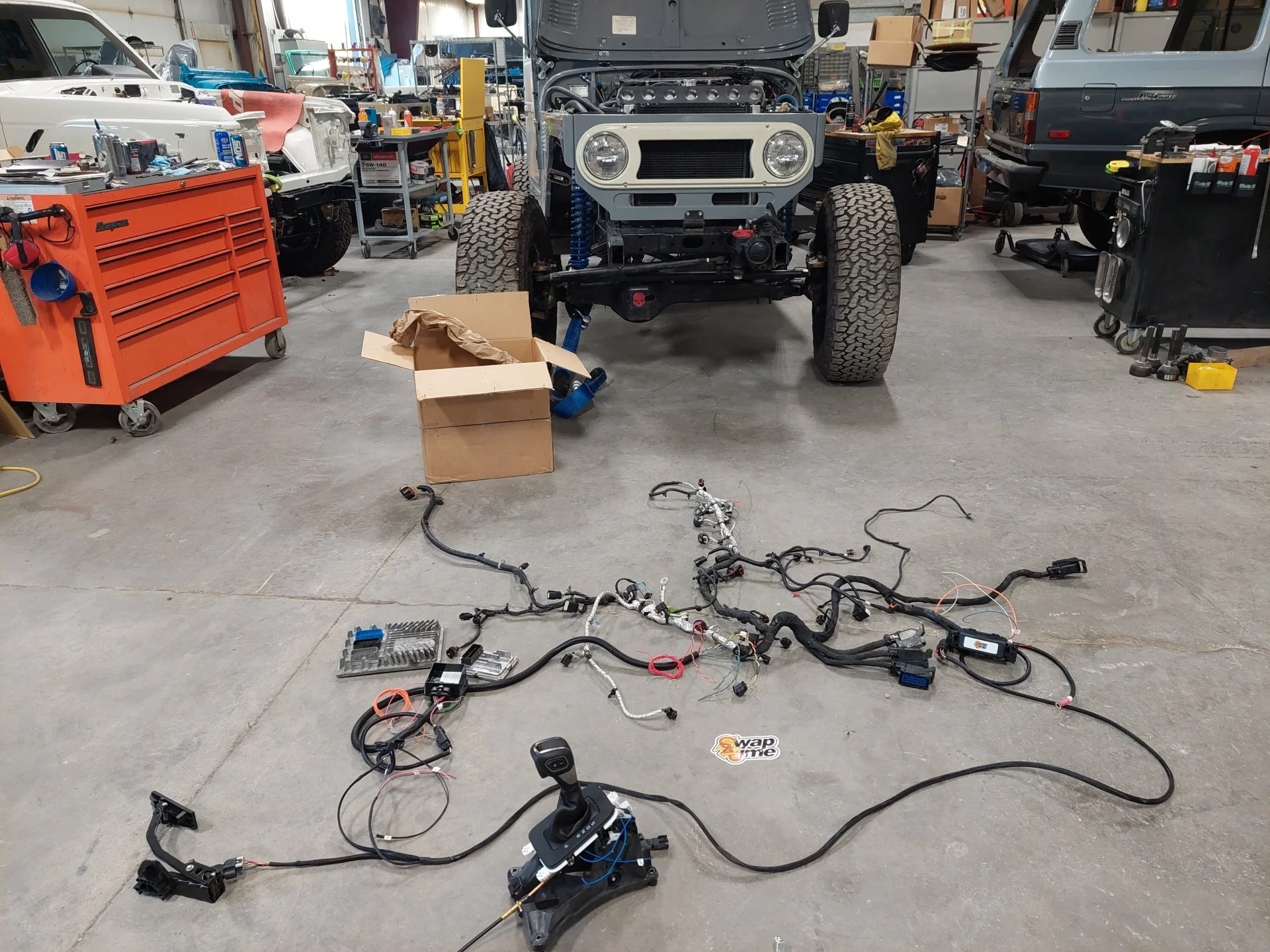

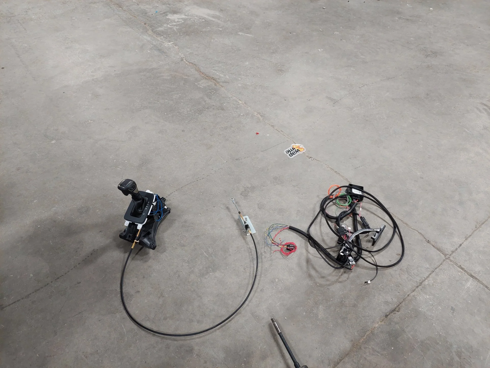

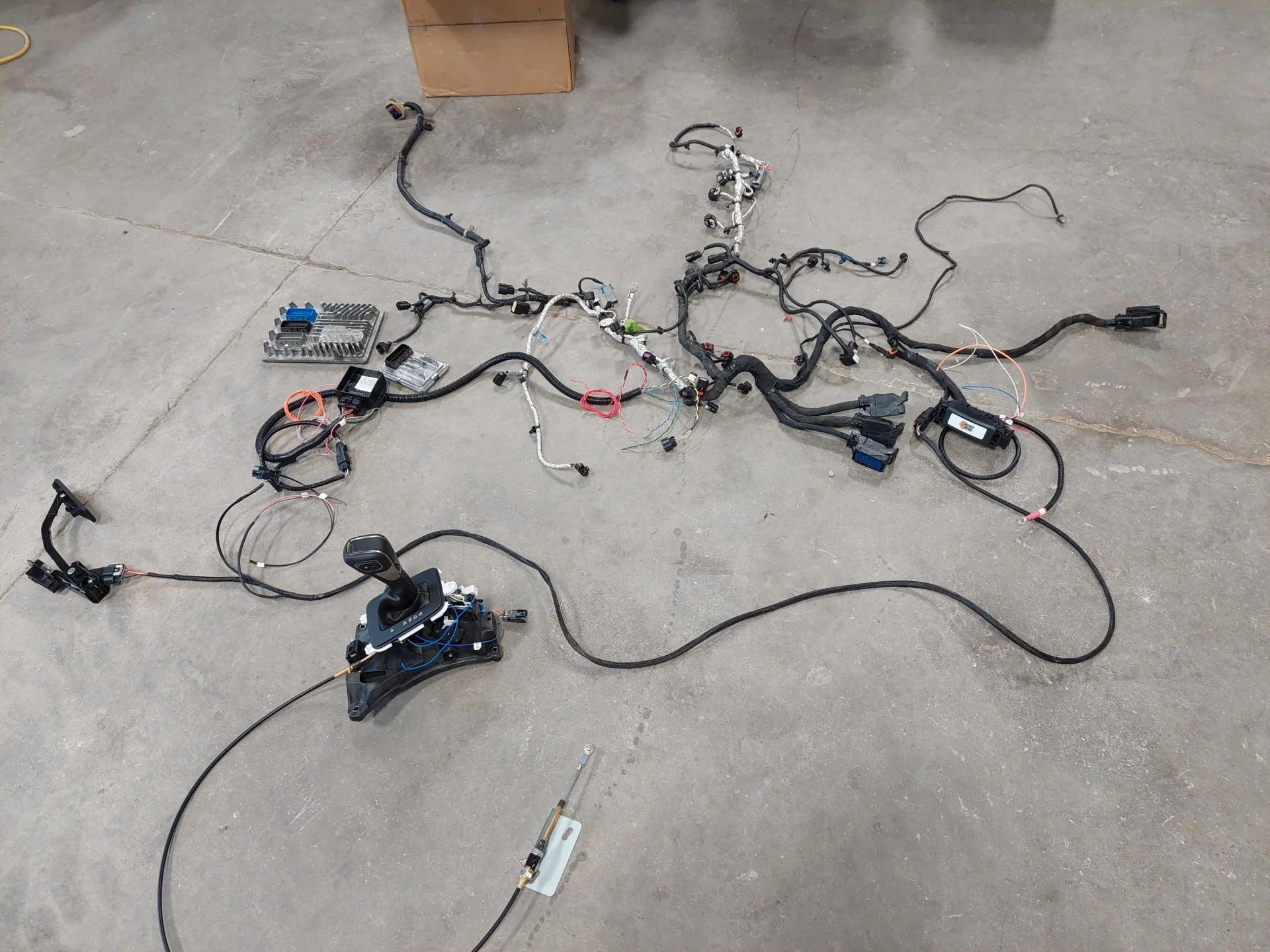

Harness arrived!
Lots of spaghetti to stuff back on.
The shifter is pretty sweet! It should look good in a 40.
One side on. I am really glad I numbered all of the plugs.
Not much left to go back on.
More plugs.

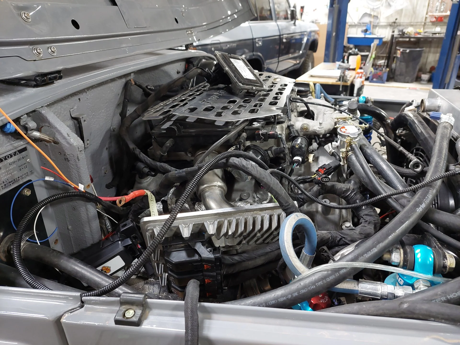

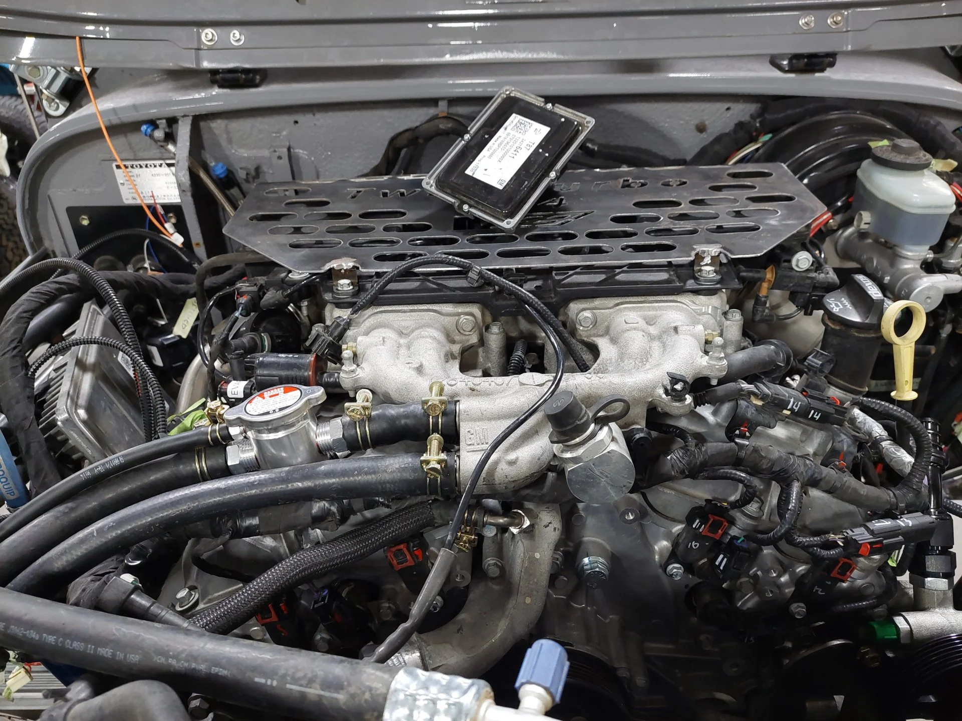

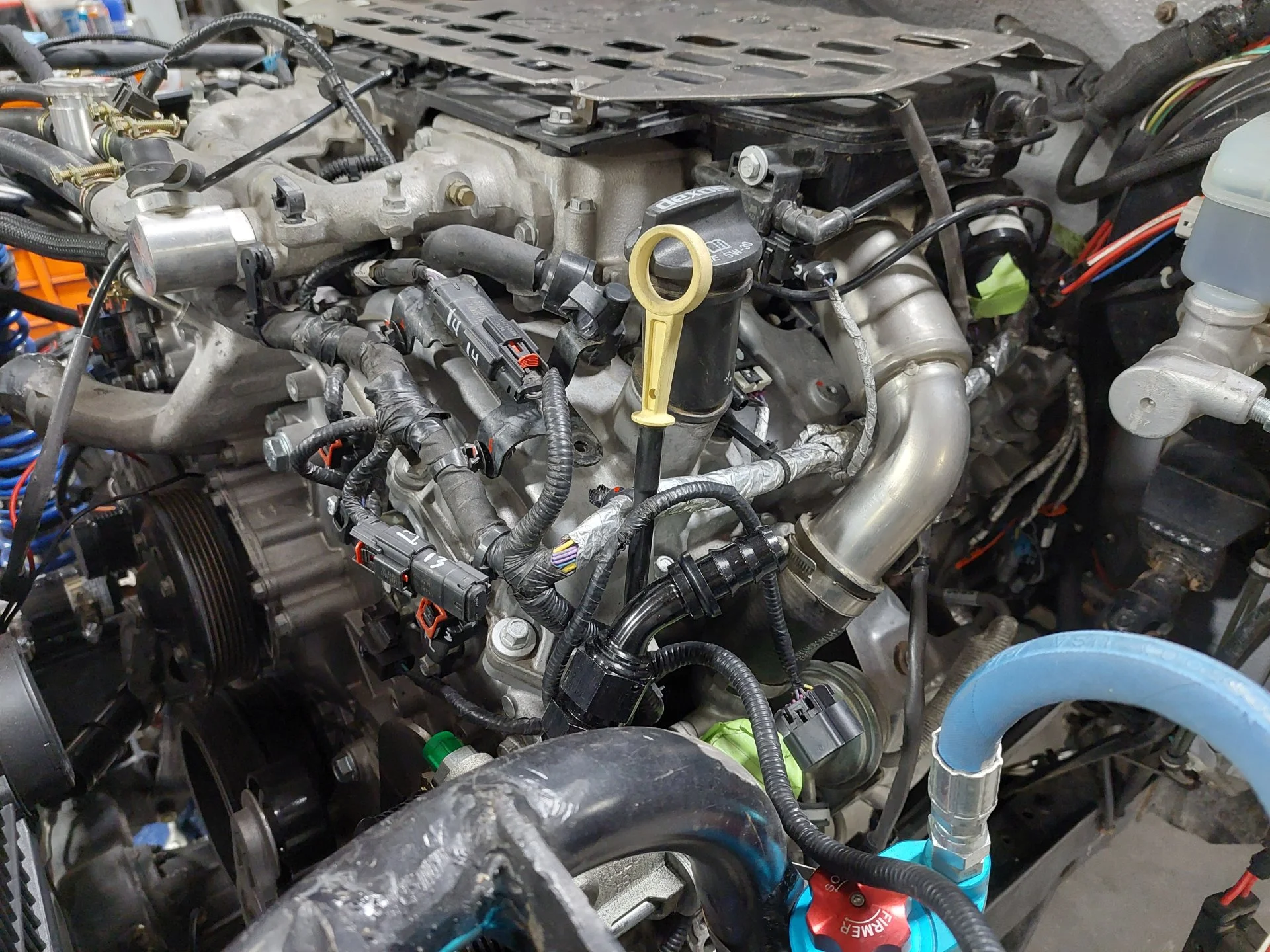

Dug this out to start logging data and tuning.
ECM in roughly final location.

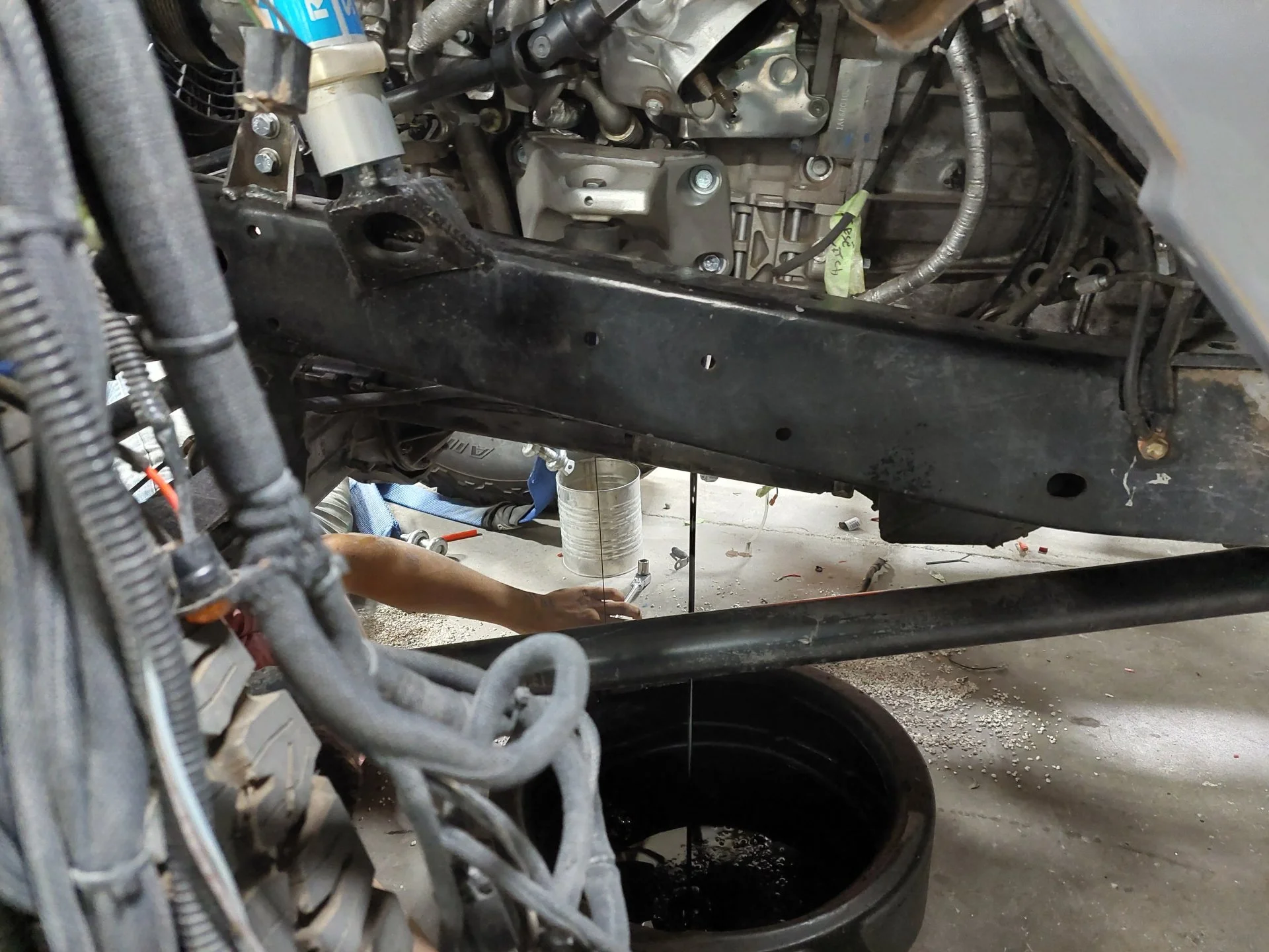

A quick oil change.
And then this happened.
No MAP, MAF, or O2s, but it ran! Need to get the trans lines made so it doesn't spit oil out, but it runs!
