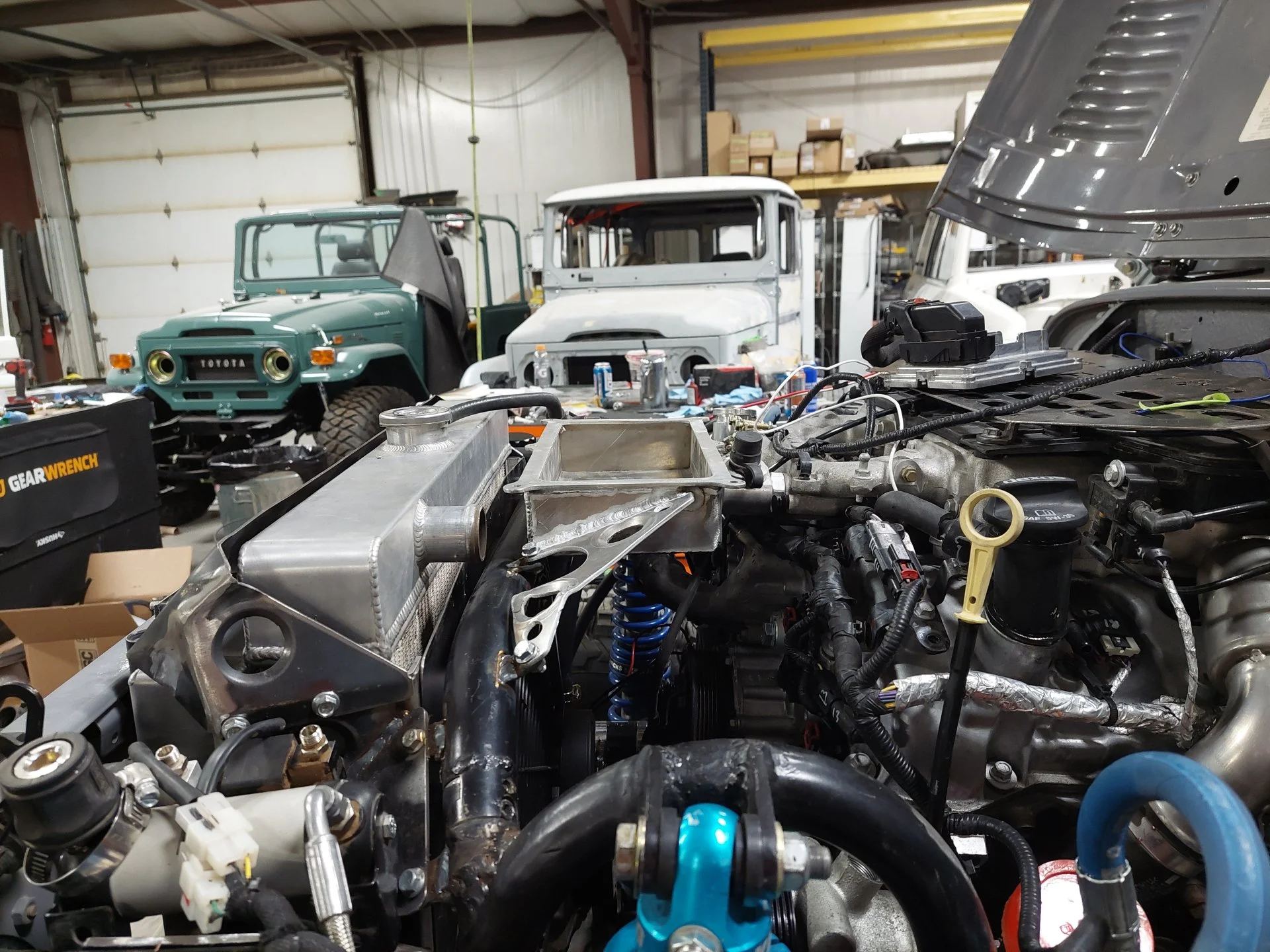

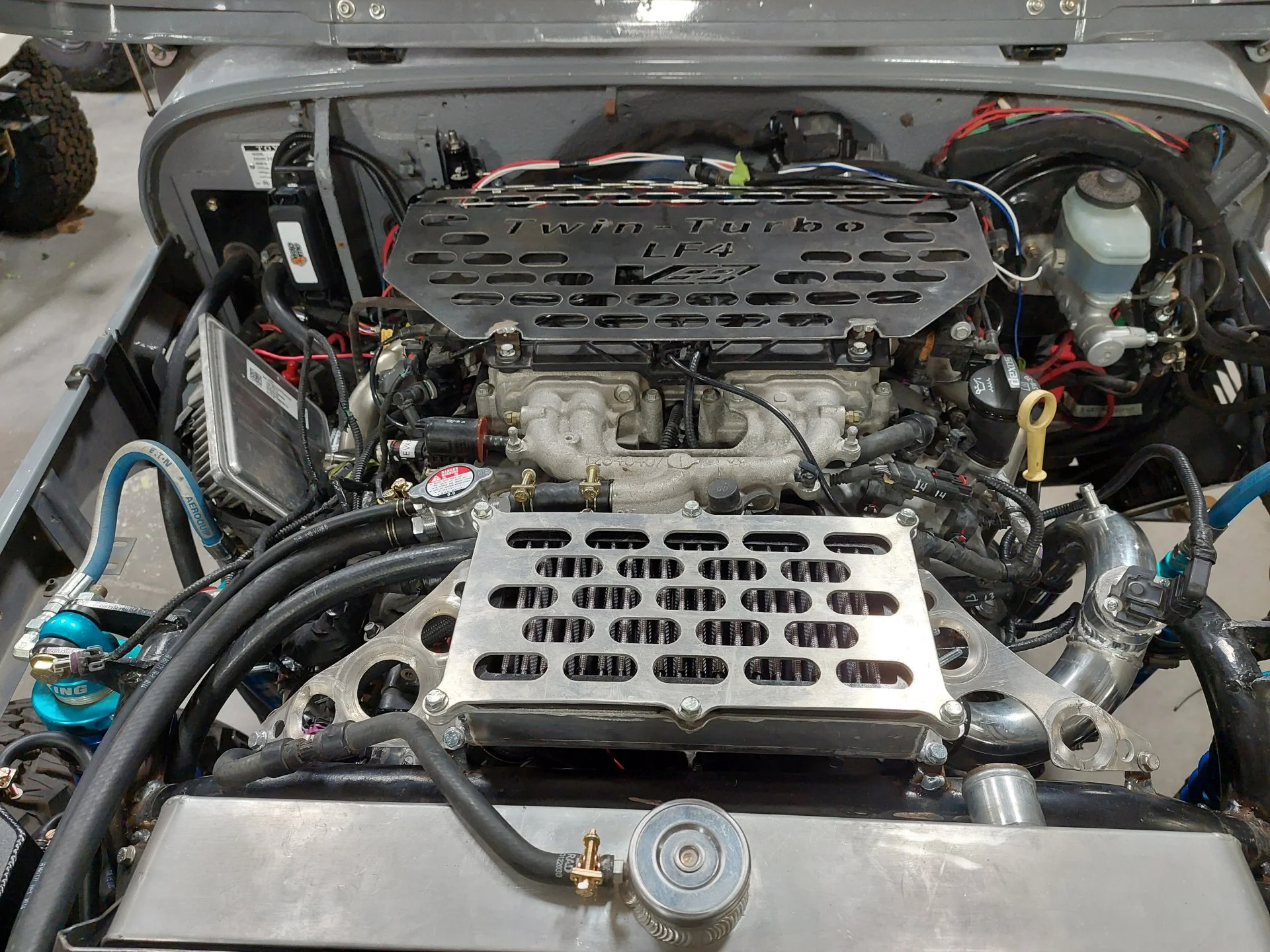

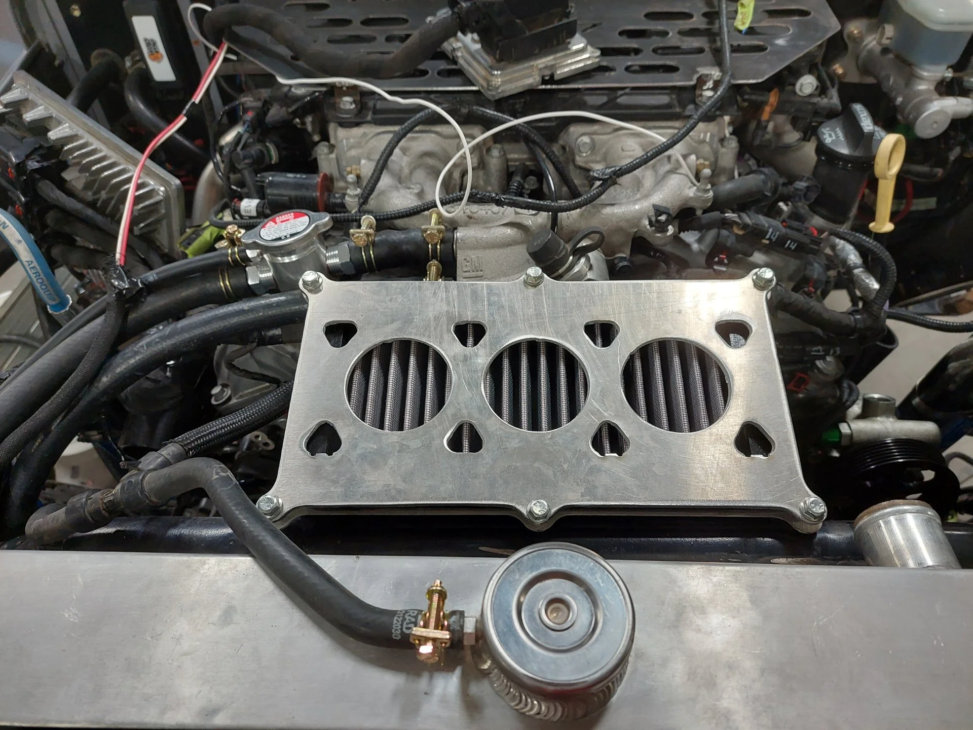

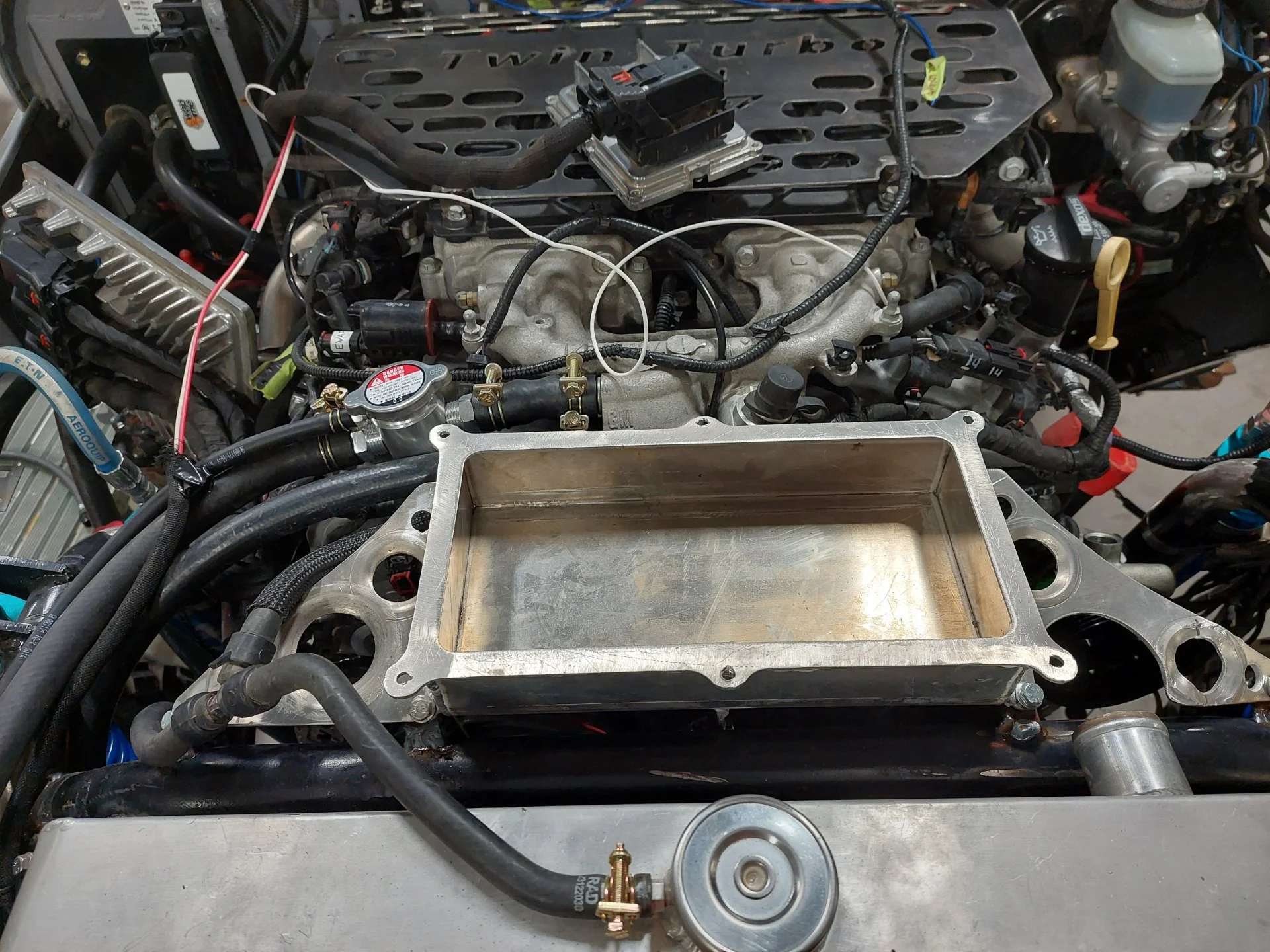

Start on the air box. I love aluminum.

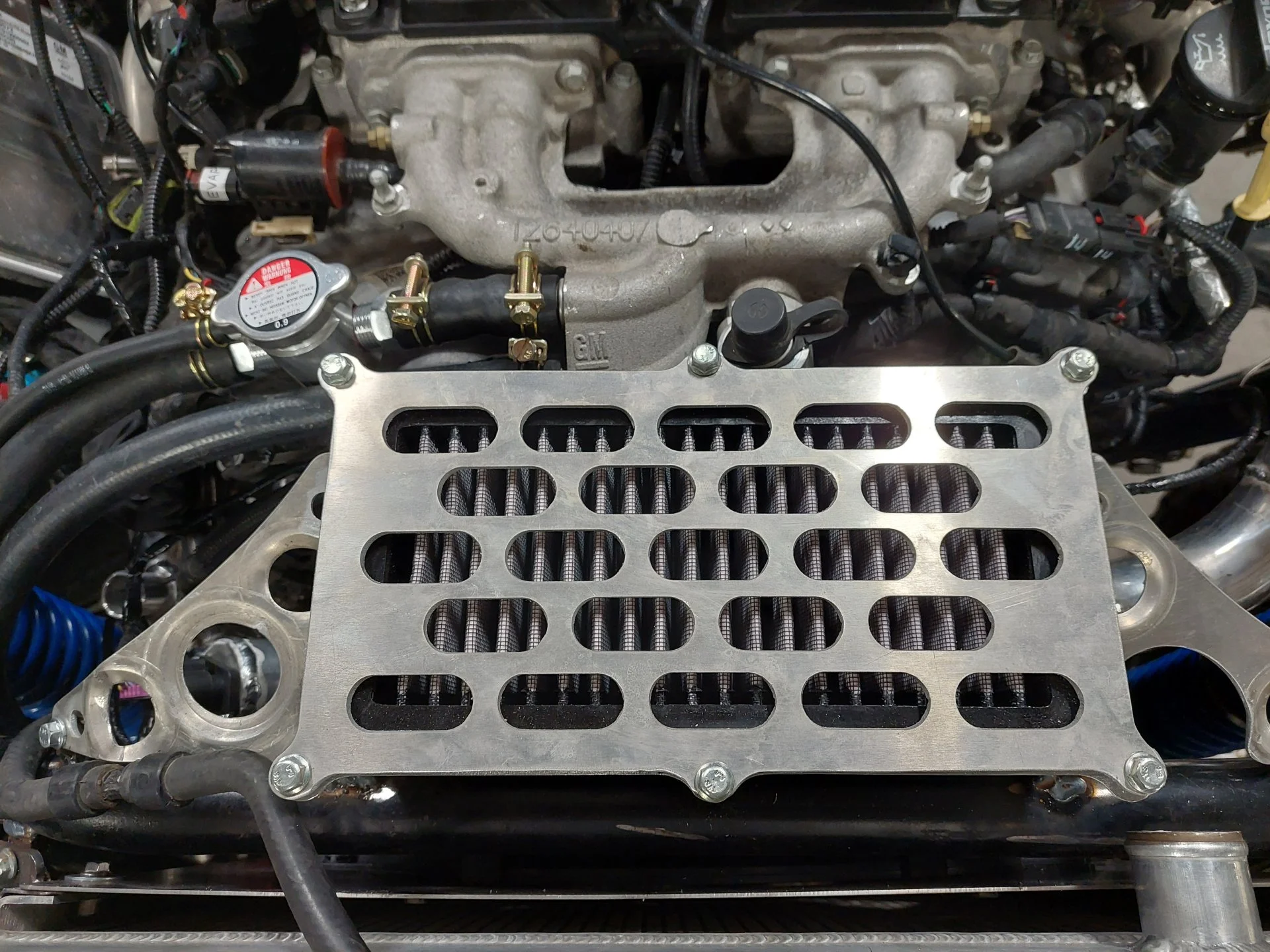

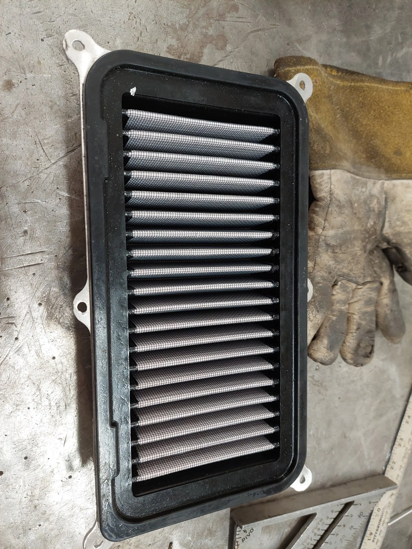

Air filter fits great. It's an AEM Dryflow, like I always run. Should theoretically flow about 2x the necessary volume for this engine.
Inital test fit of the box.
Mounts cut out and dimple died.
Tucks in nicely.
I'm not sure if I like the lid.

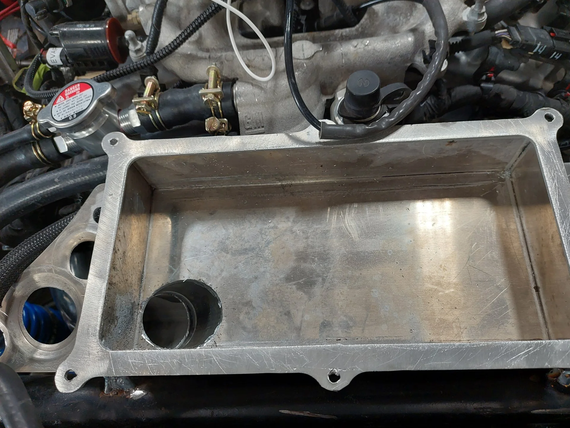

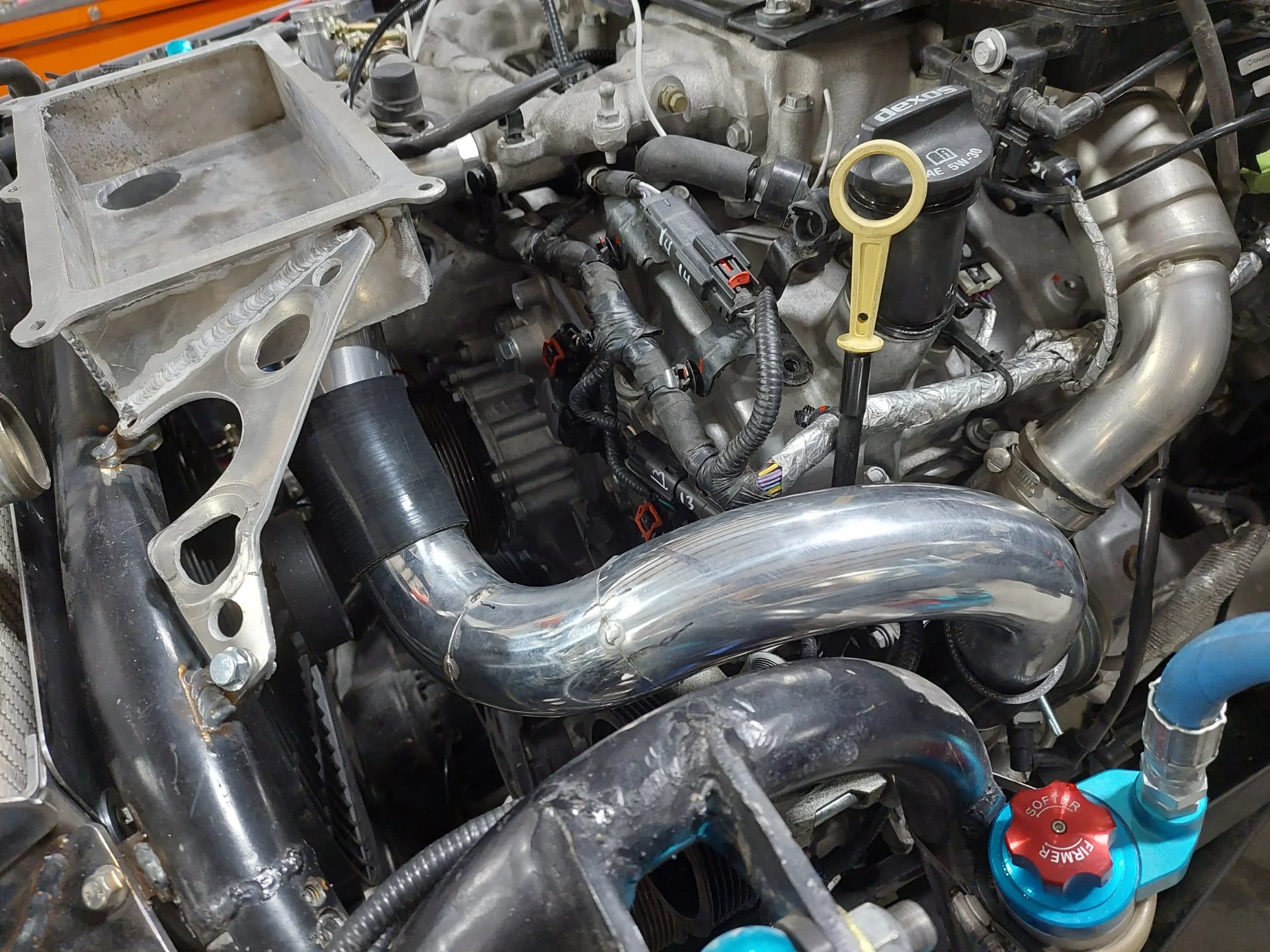

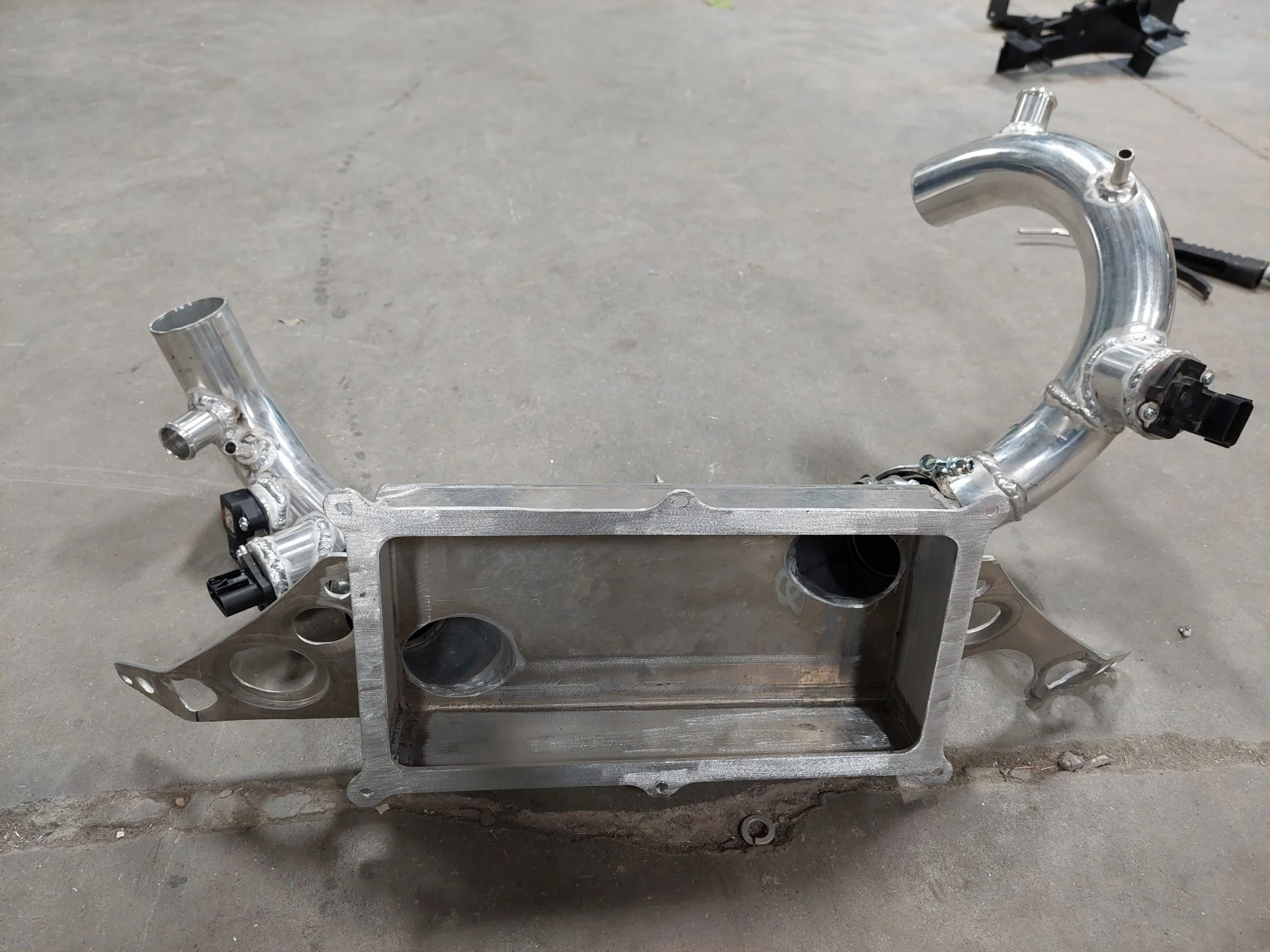

First intake tube mocked in.
First hole cut.
Driver side tube

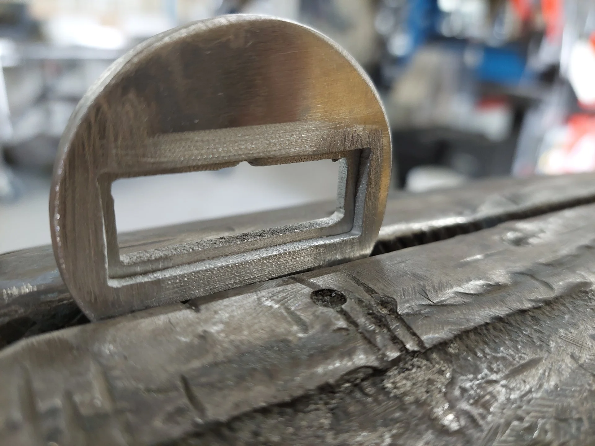

MAF Bungs.
Done! Lots of bungs that had to be welded.

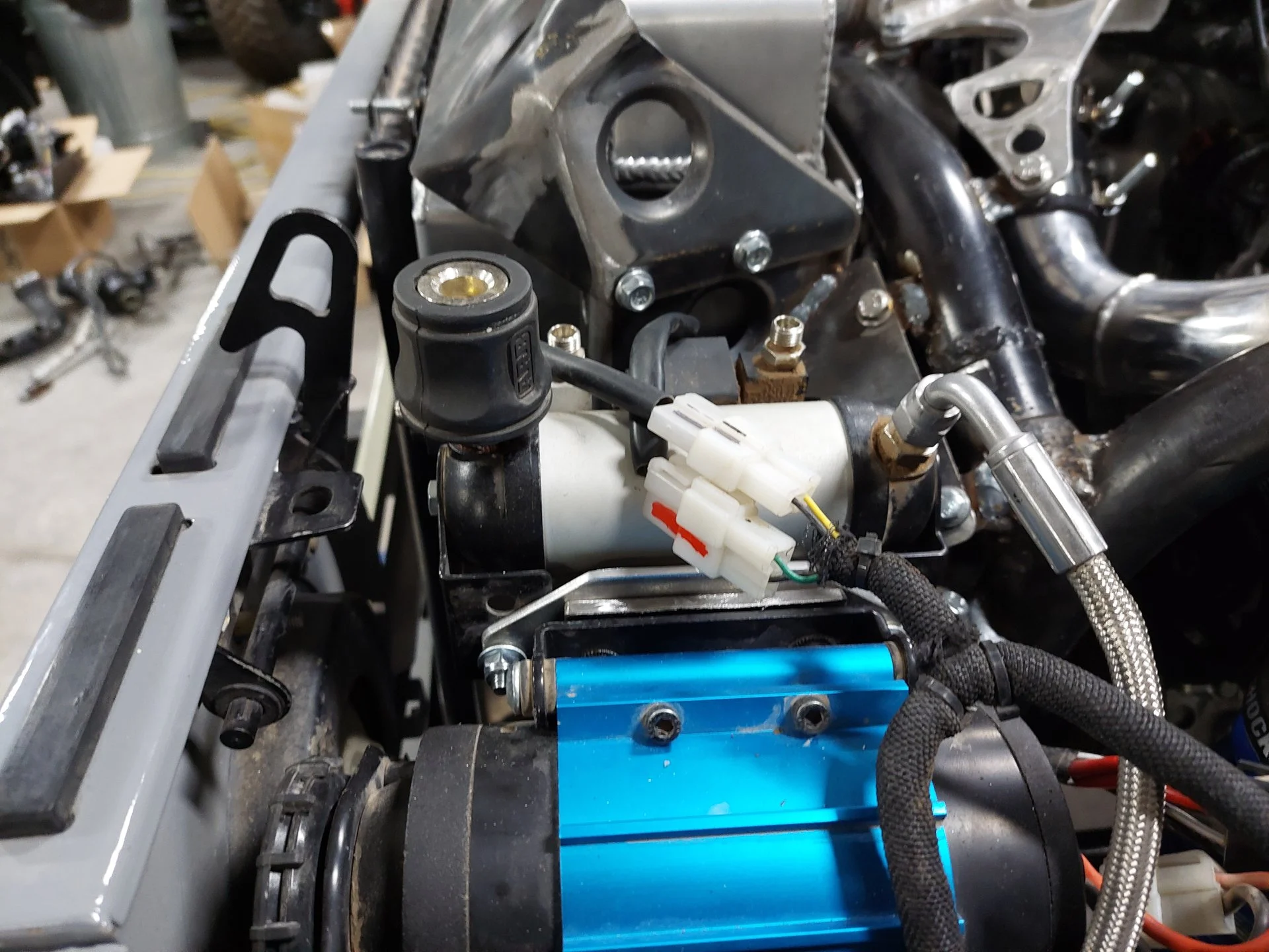

ARB manifold mount.
Fits awesome, everything clears.

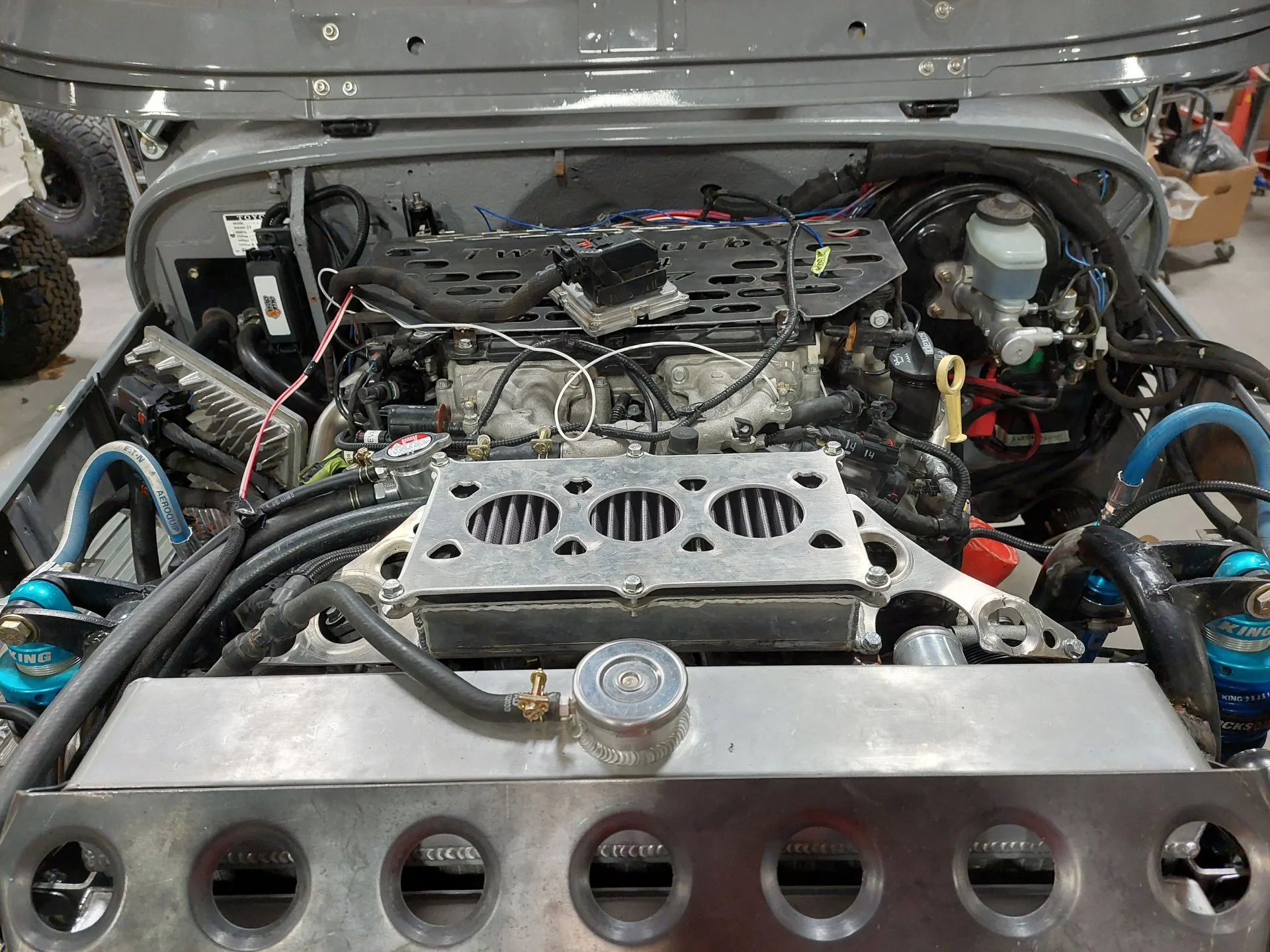

All that is left is the ECM / TCM mount, and P/S resi.
I didn't like the airbox lid so I remade it.
Much better.

MAF Bungs.

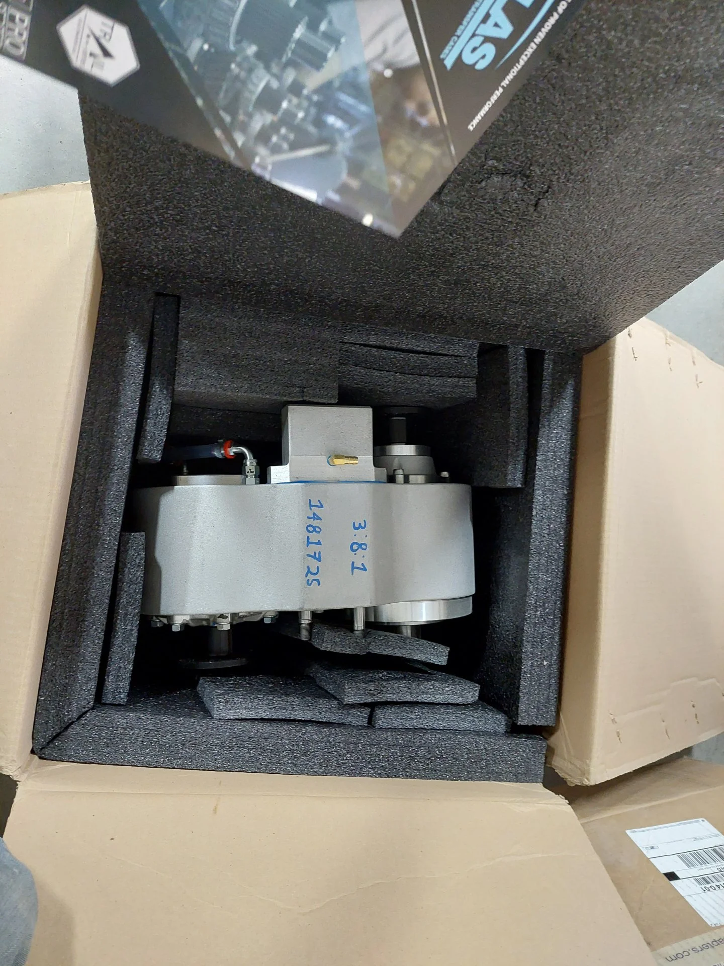

The UPS man was not too happy about the 114lb box

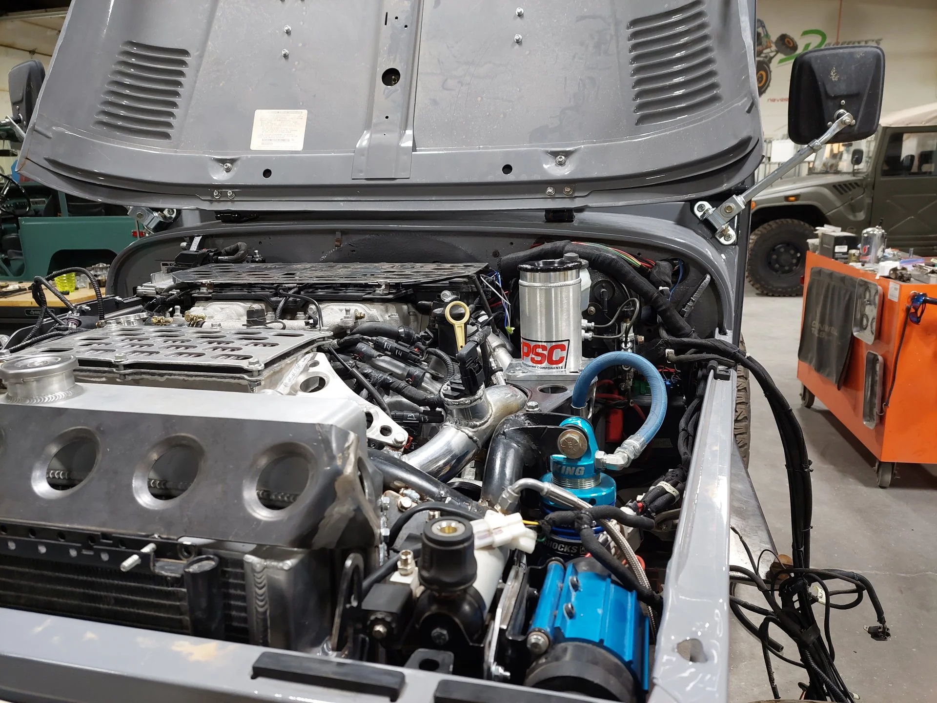

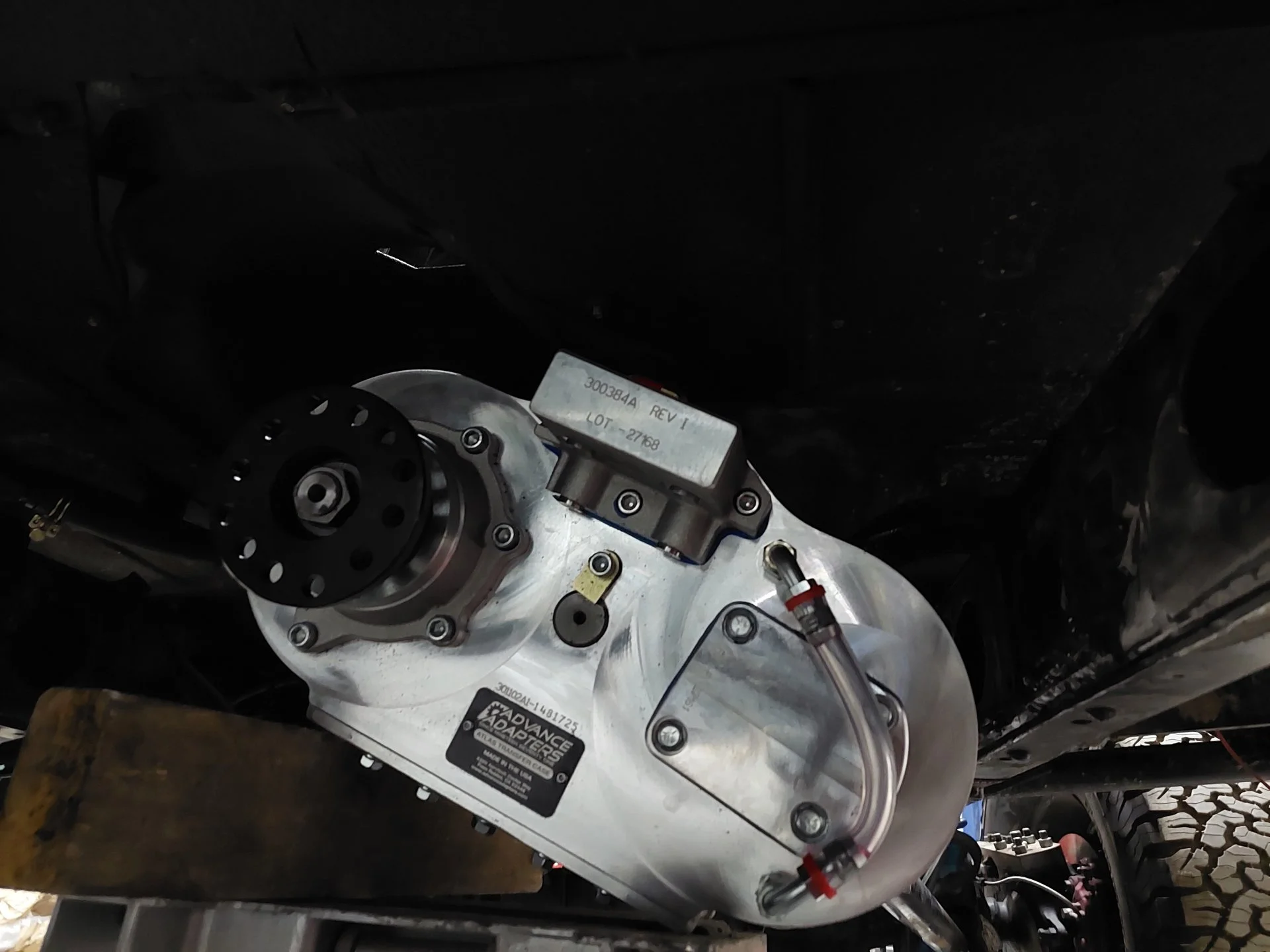

Well, it's been a bit. I went to SAS 6 and had a blast with the Mega Cruiser, and now I'm back working to get my cruiser done for next year.

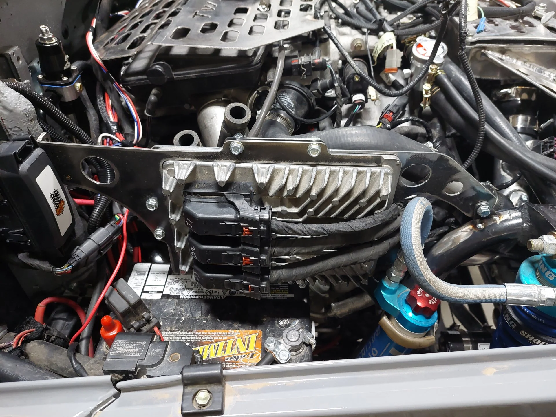

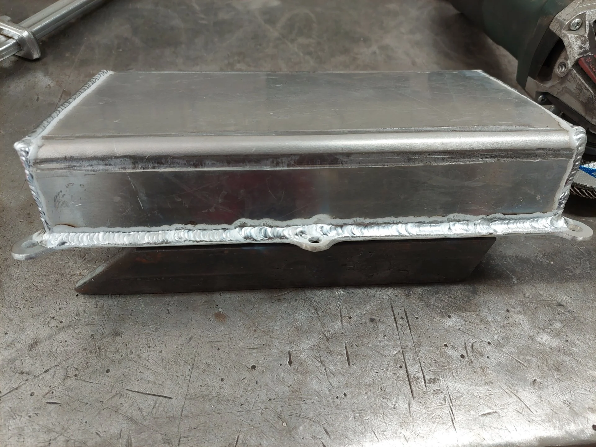

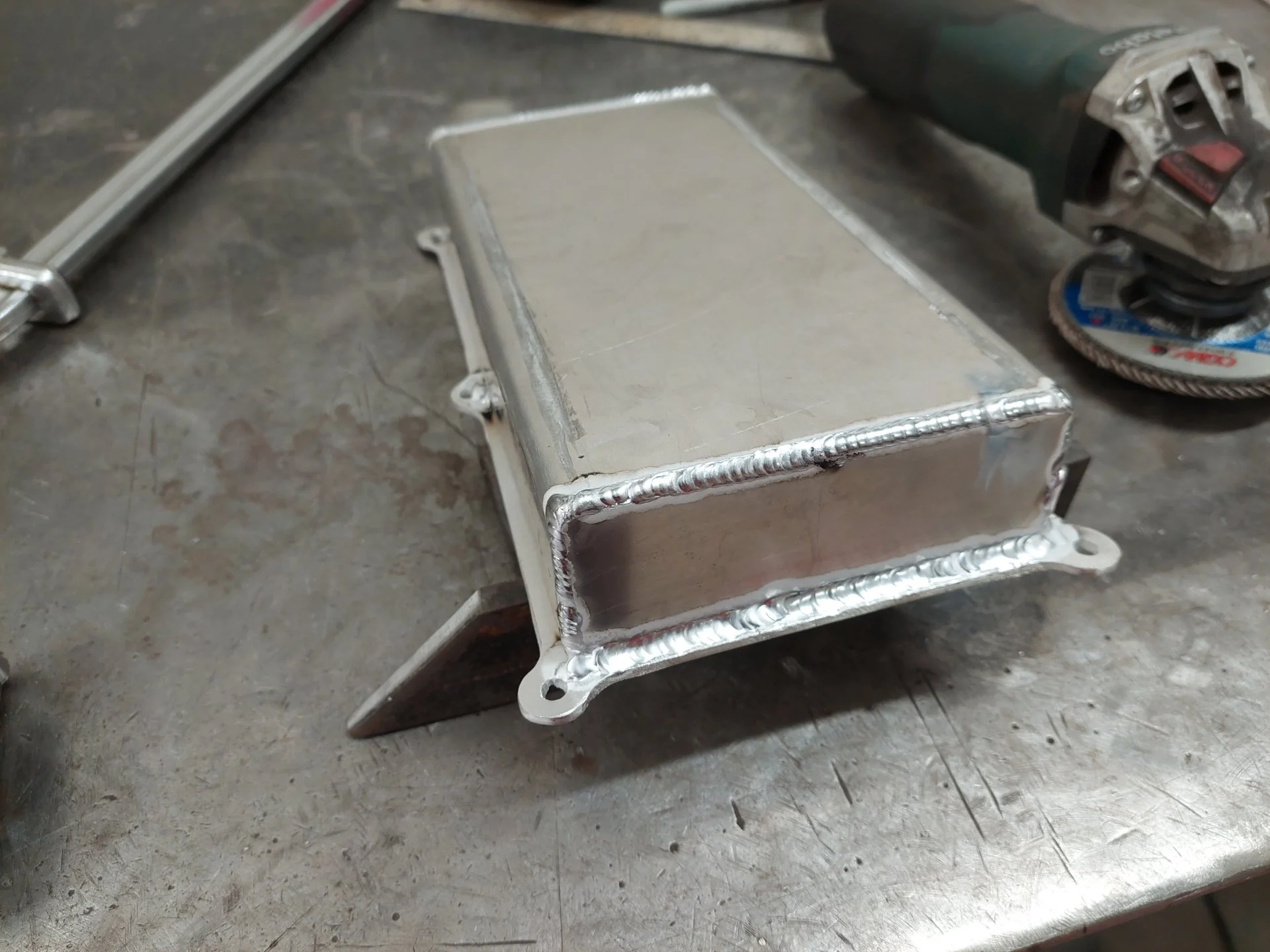

ECM Mount
TCM mount

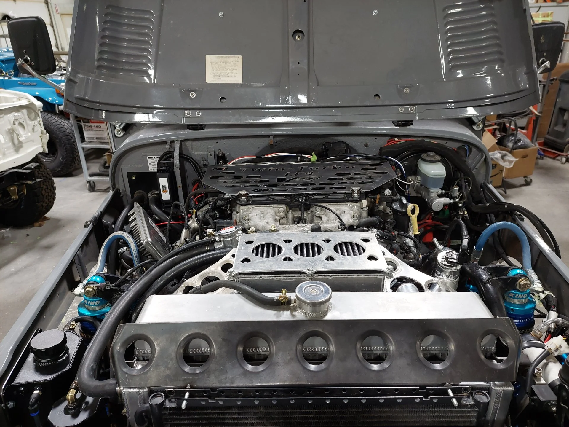

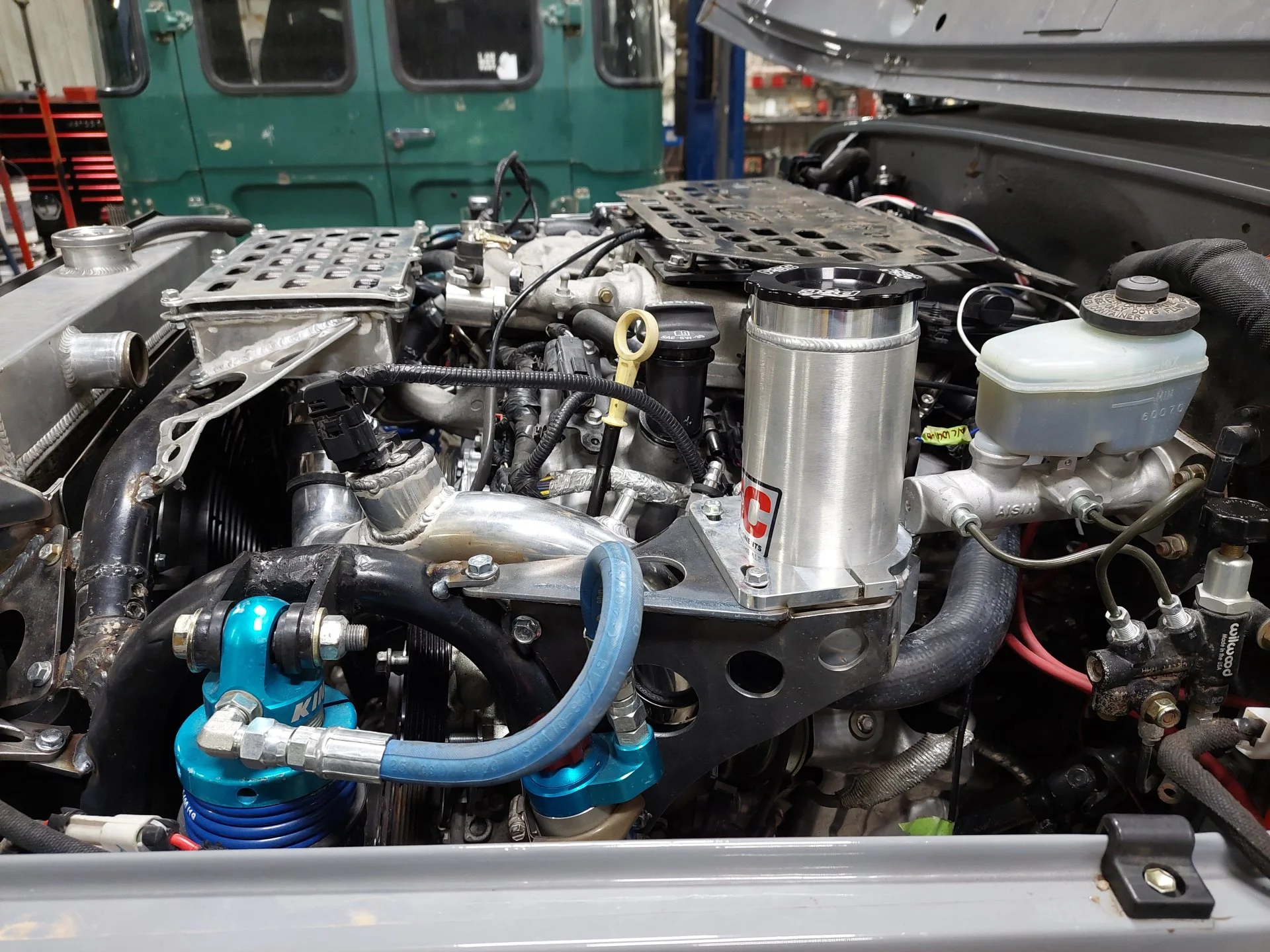

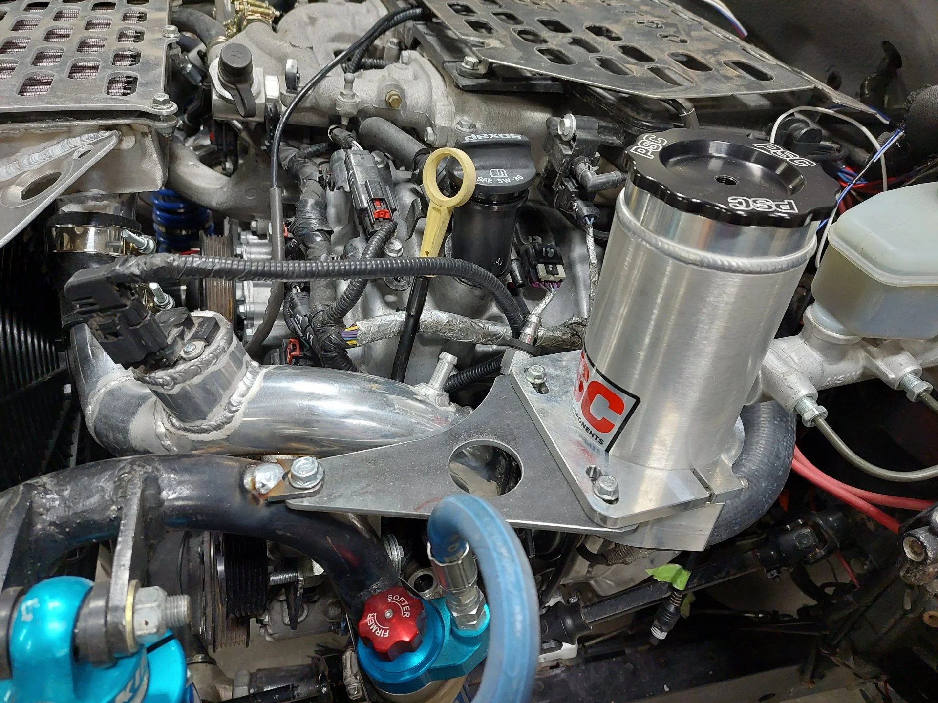

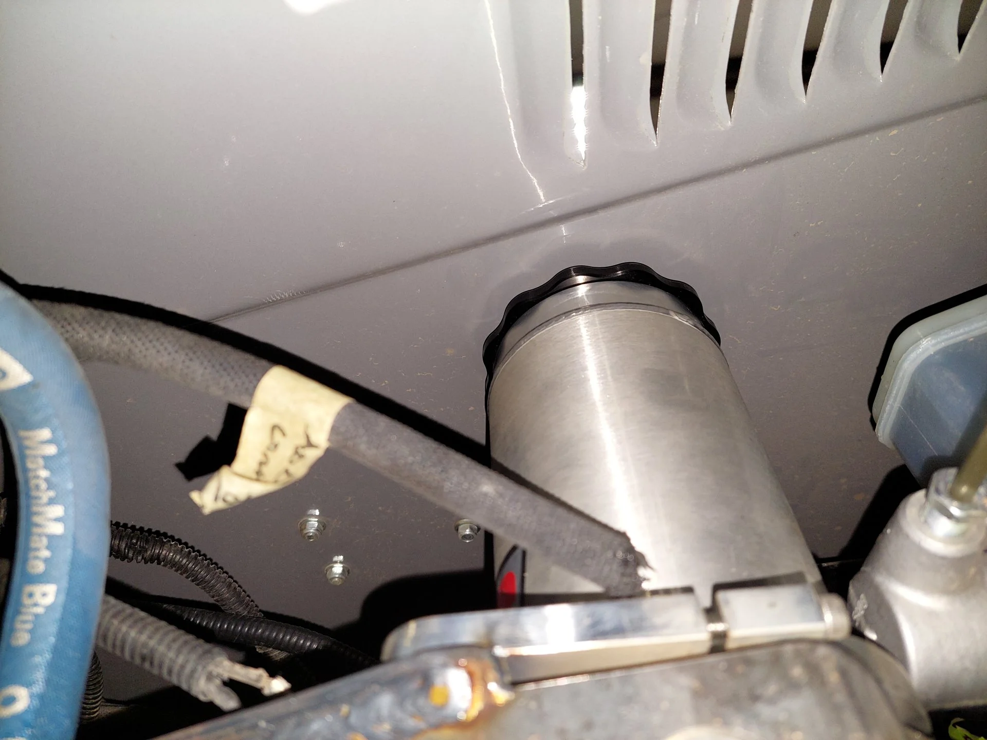

P/S reservoir mount. It's a tight fit for sure.
Barely clears the hood.

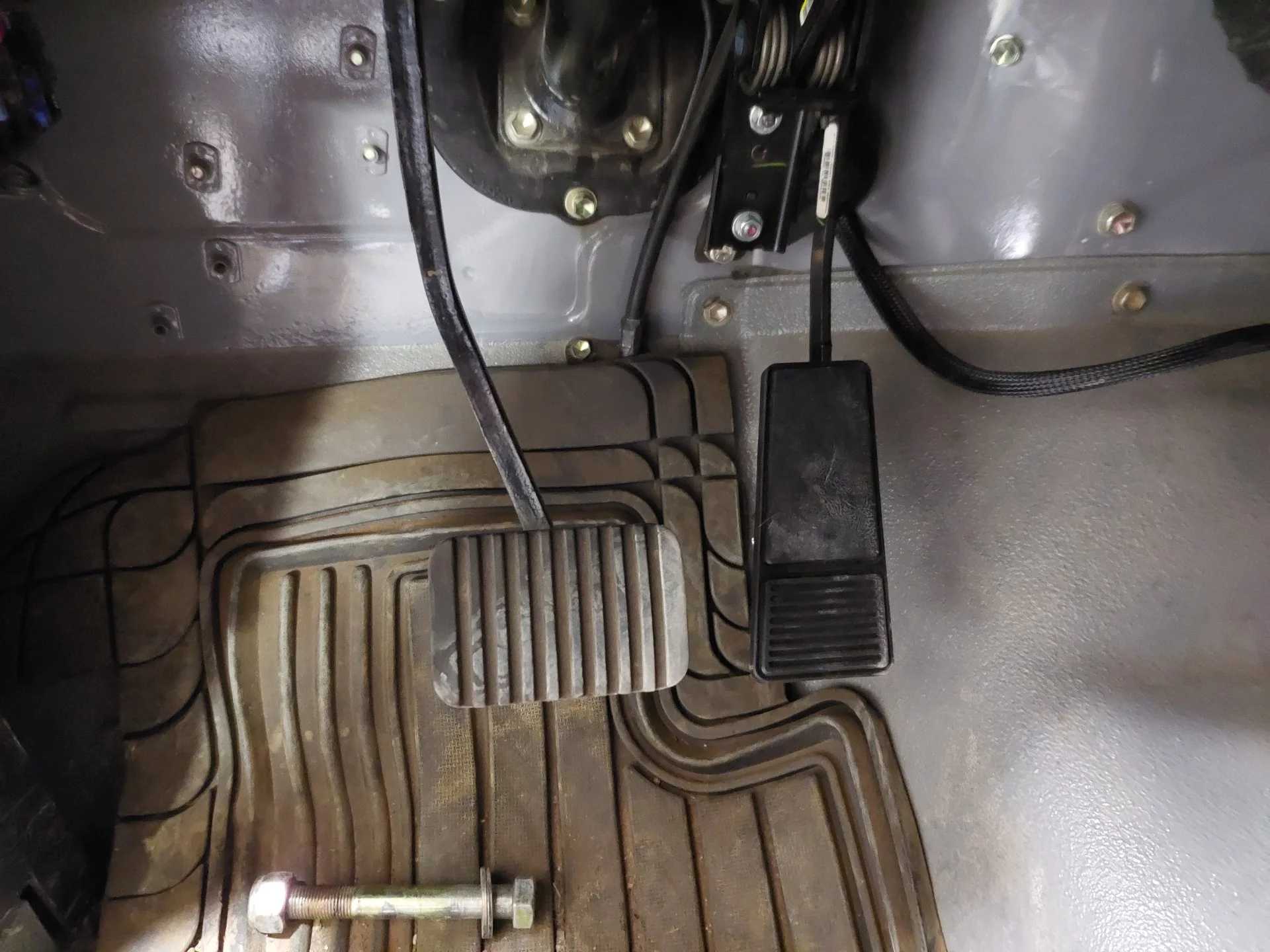

Throttle pedal mounted.

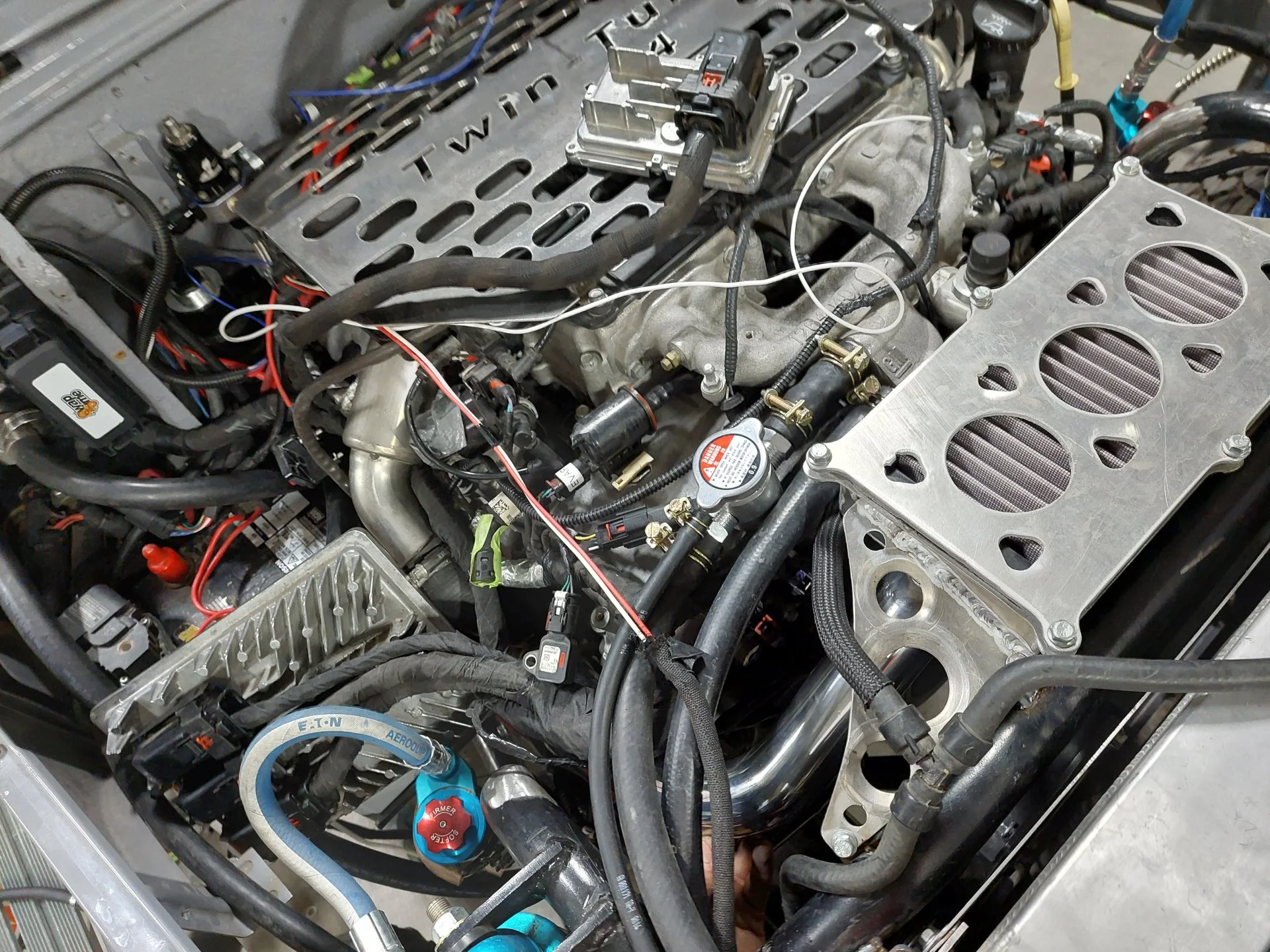

I've gotten a ton more wiring completed, and everything is hooked up to run, but still waiting on parts to convert the 8l90 to 4x4, and then the atlas should mate right up.

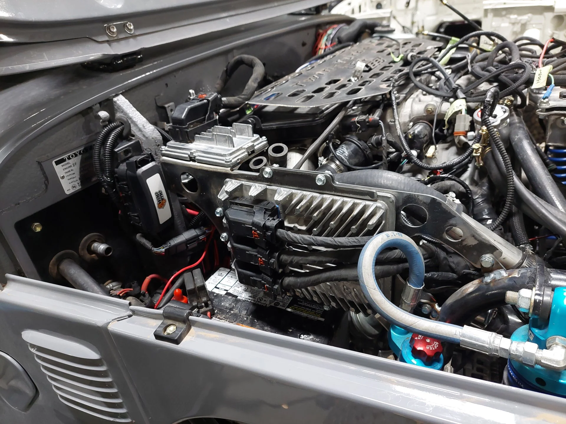

ECM Mount
TCM mount

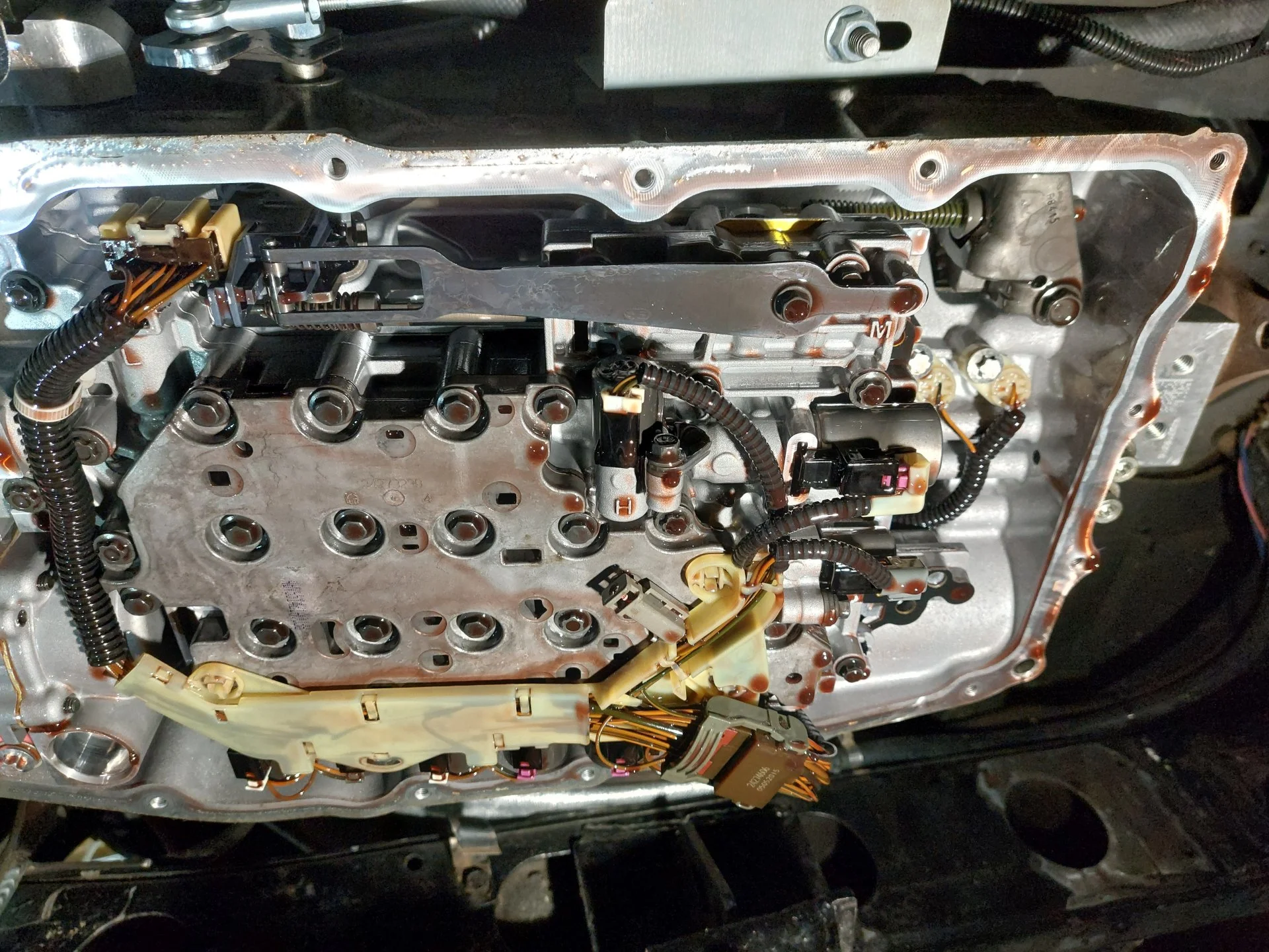

A quick sanity check.

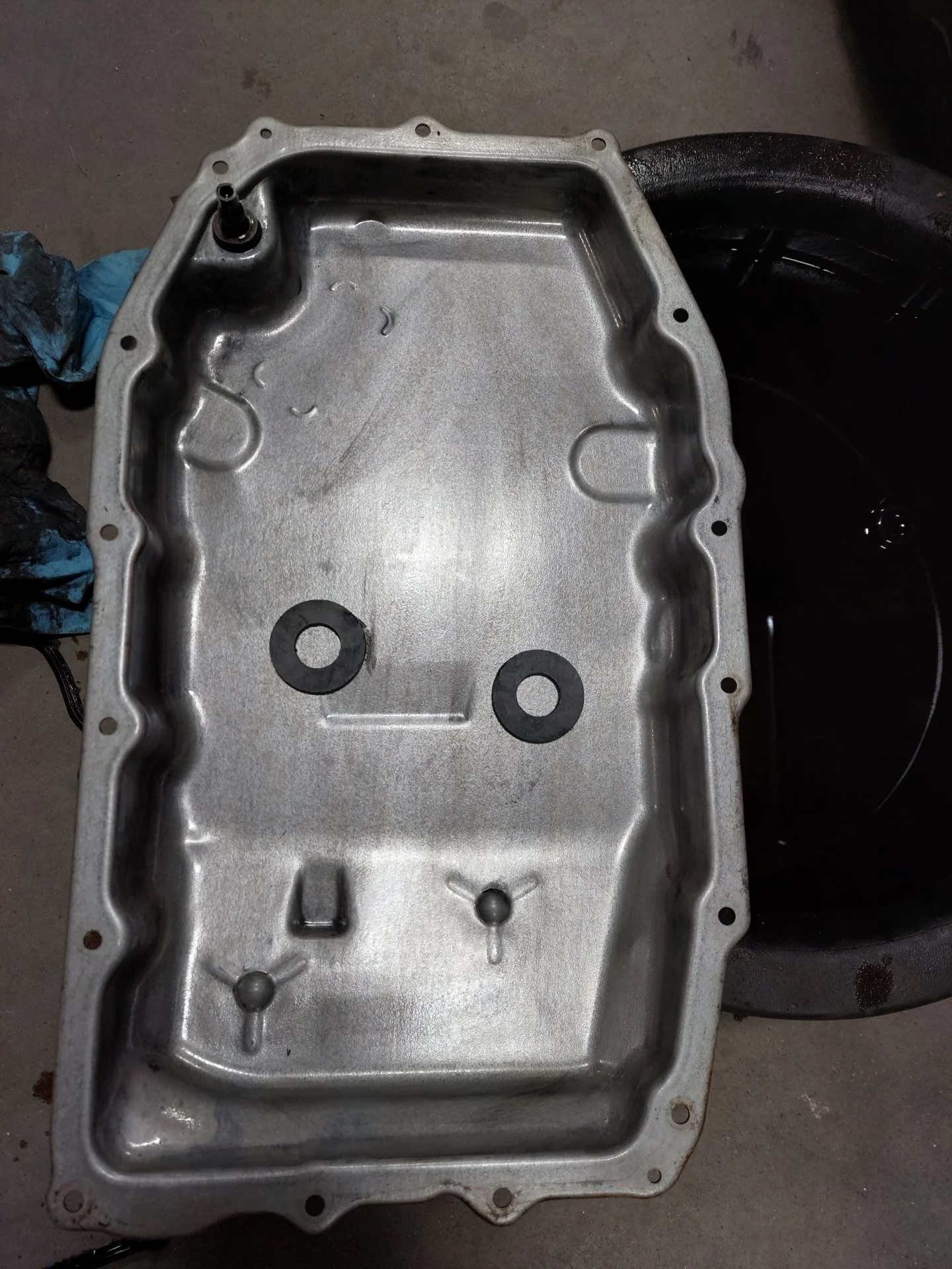

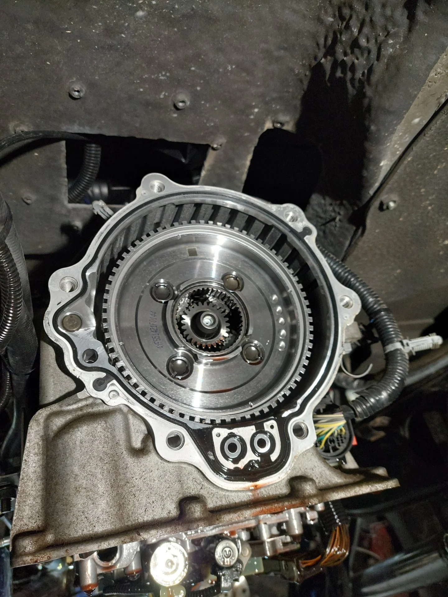

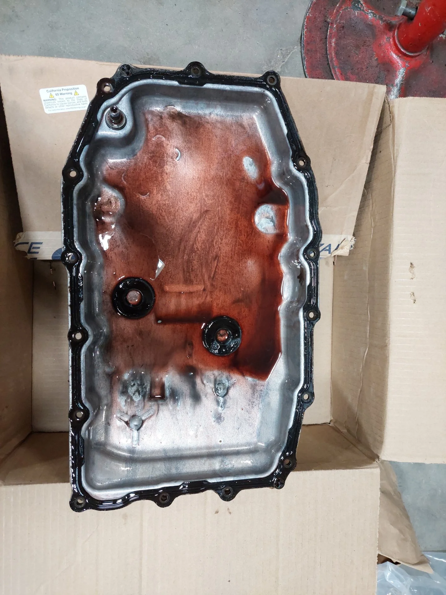

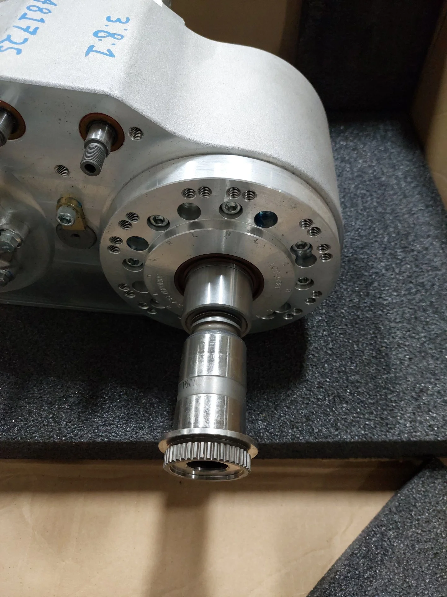

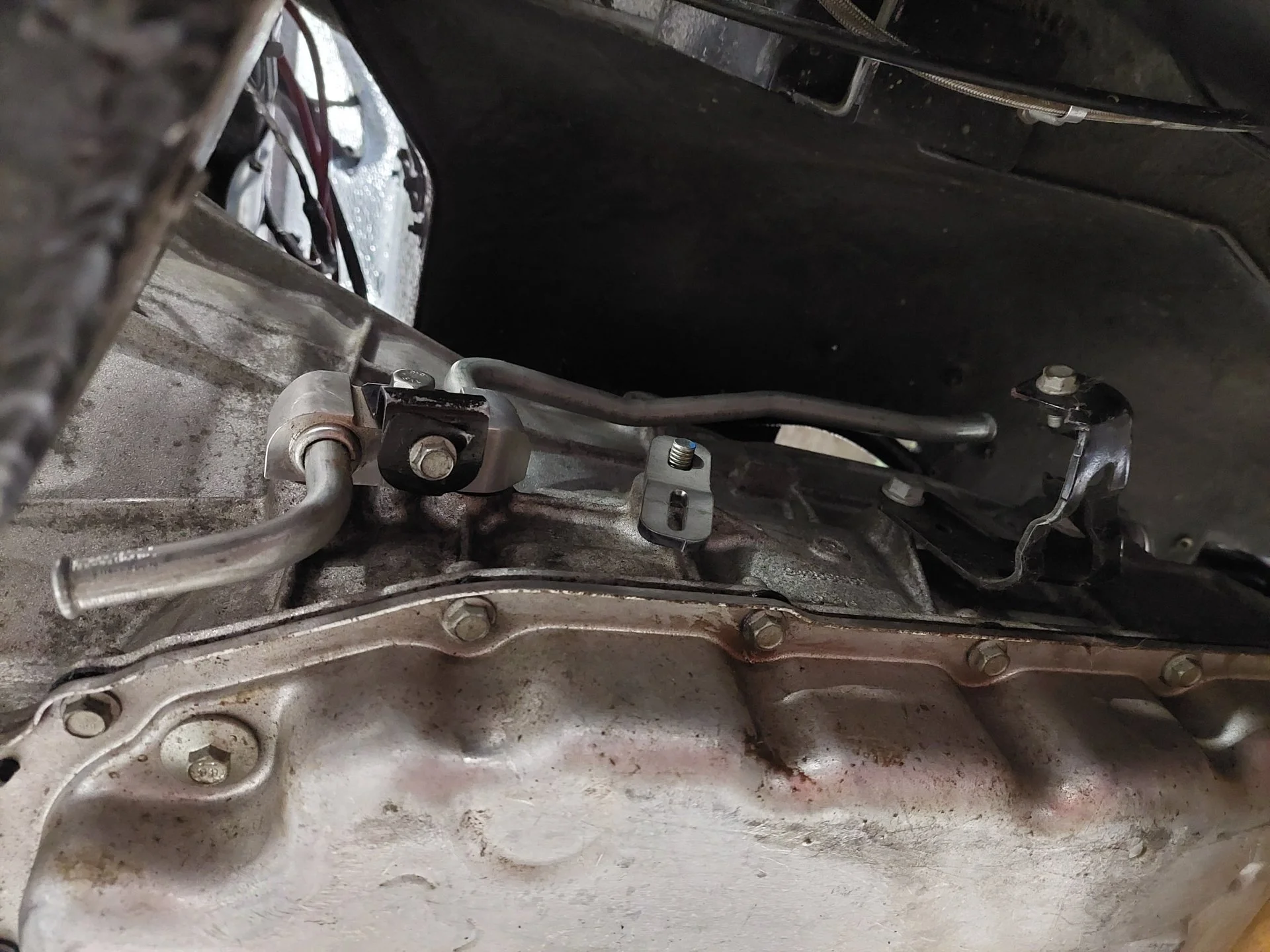

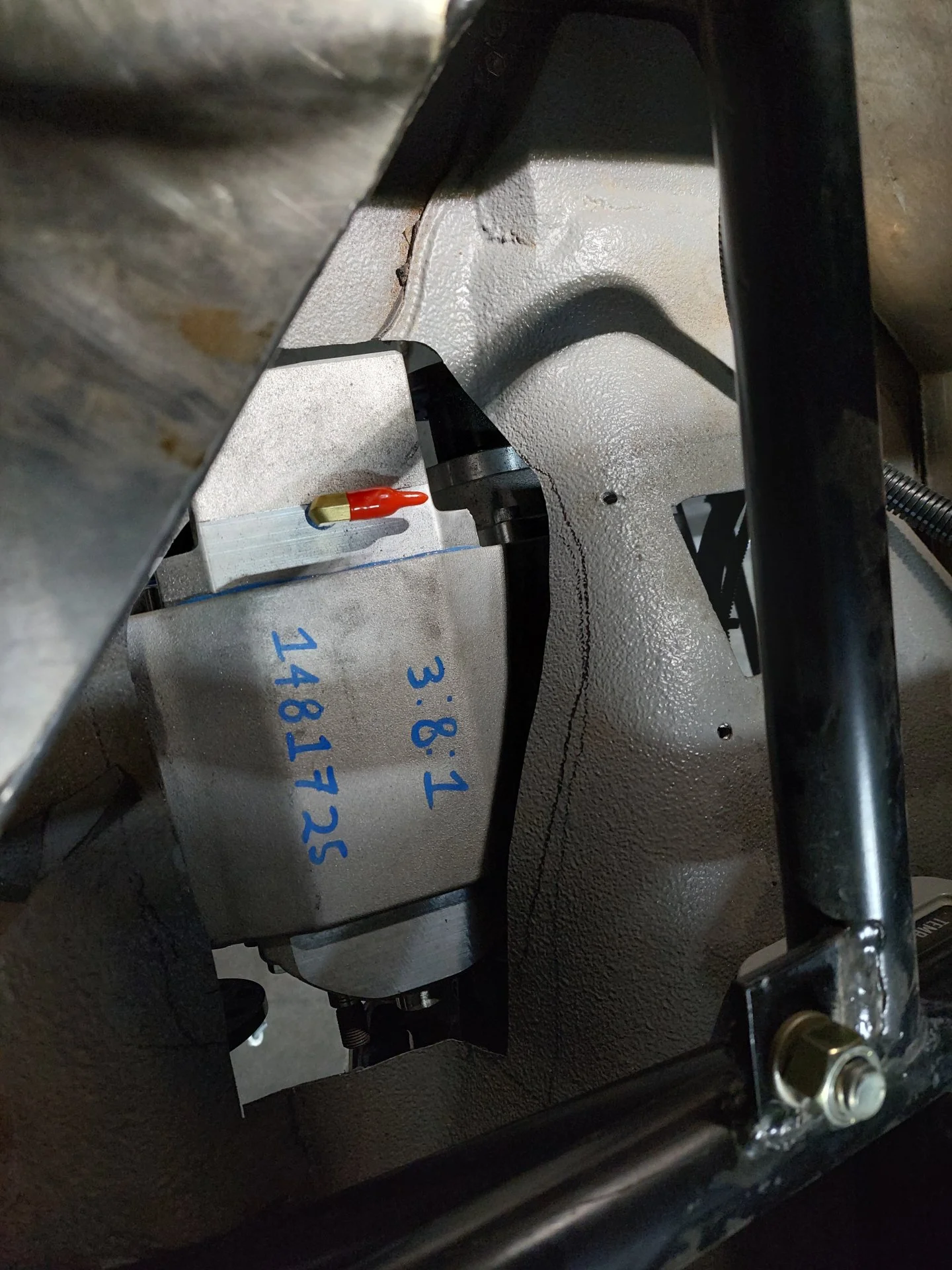

A quick 4X4 tailhousing swap for the 8l90.
Pan off.
Some random wizardry in there.
Old tailhousing off.
A quick pan wipedown.

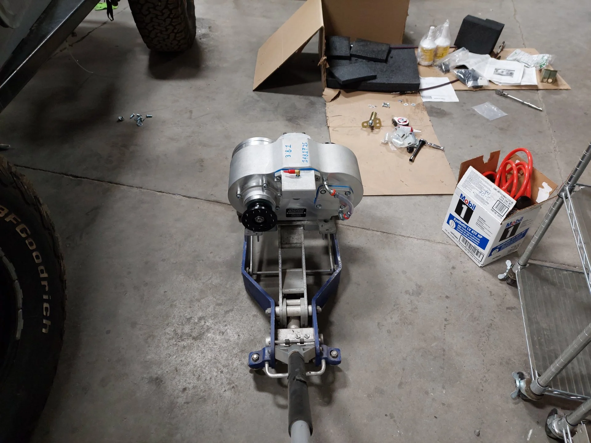

Lorge boi
Mated up.

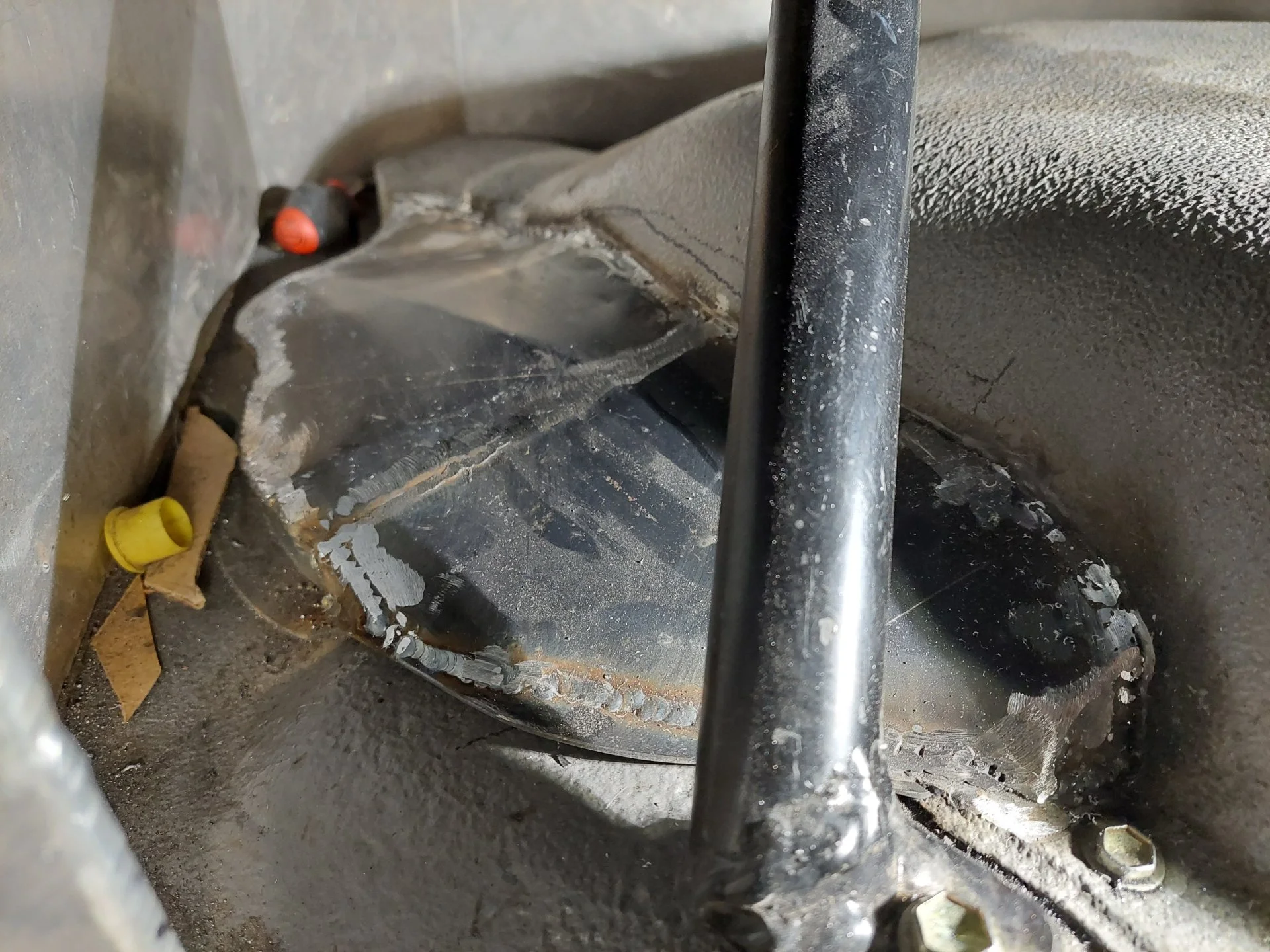

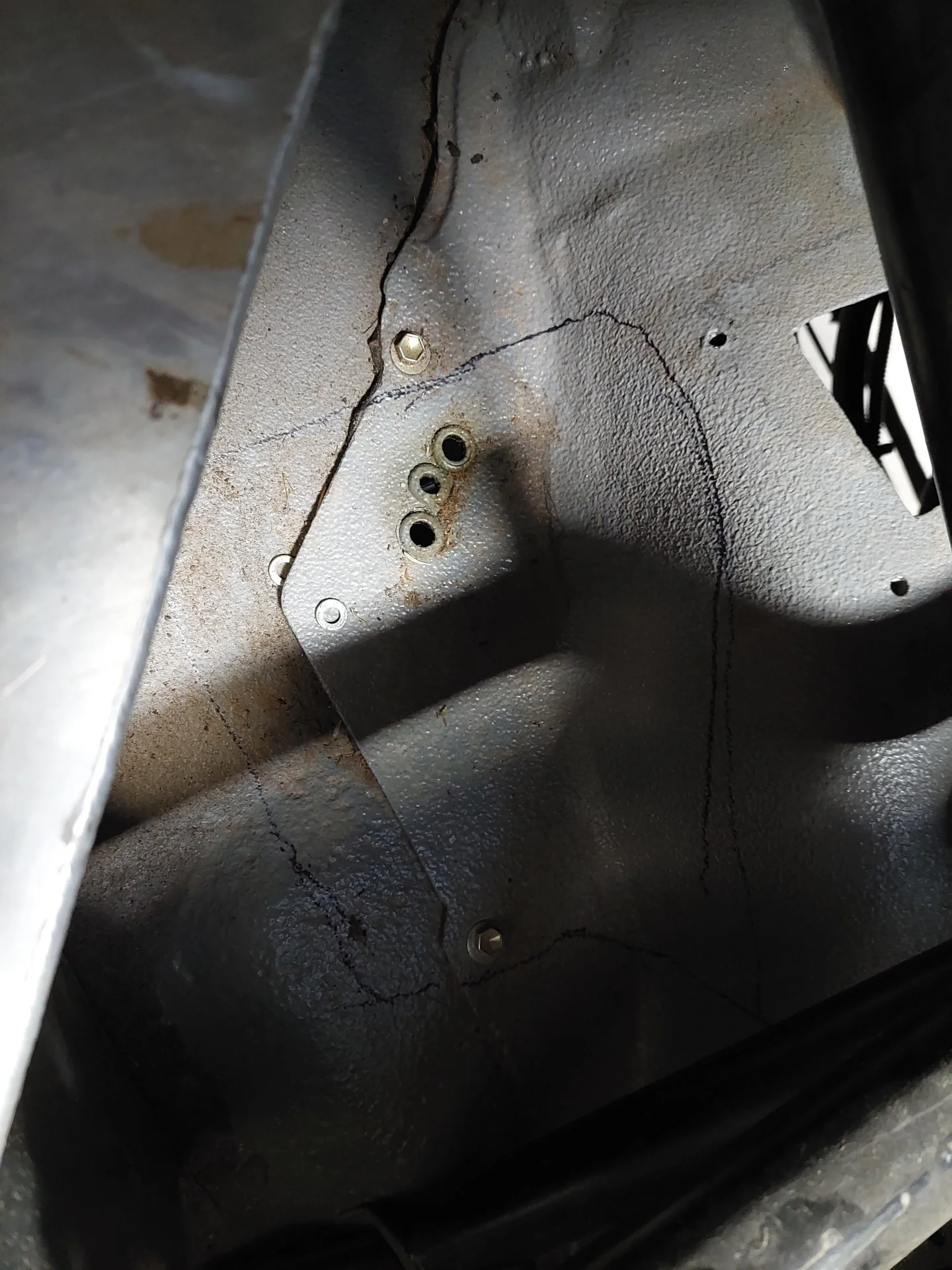

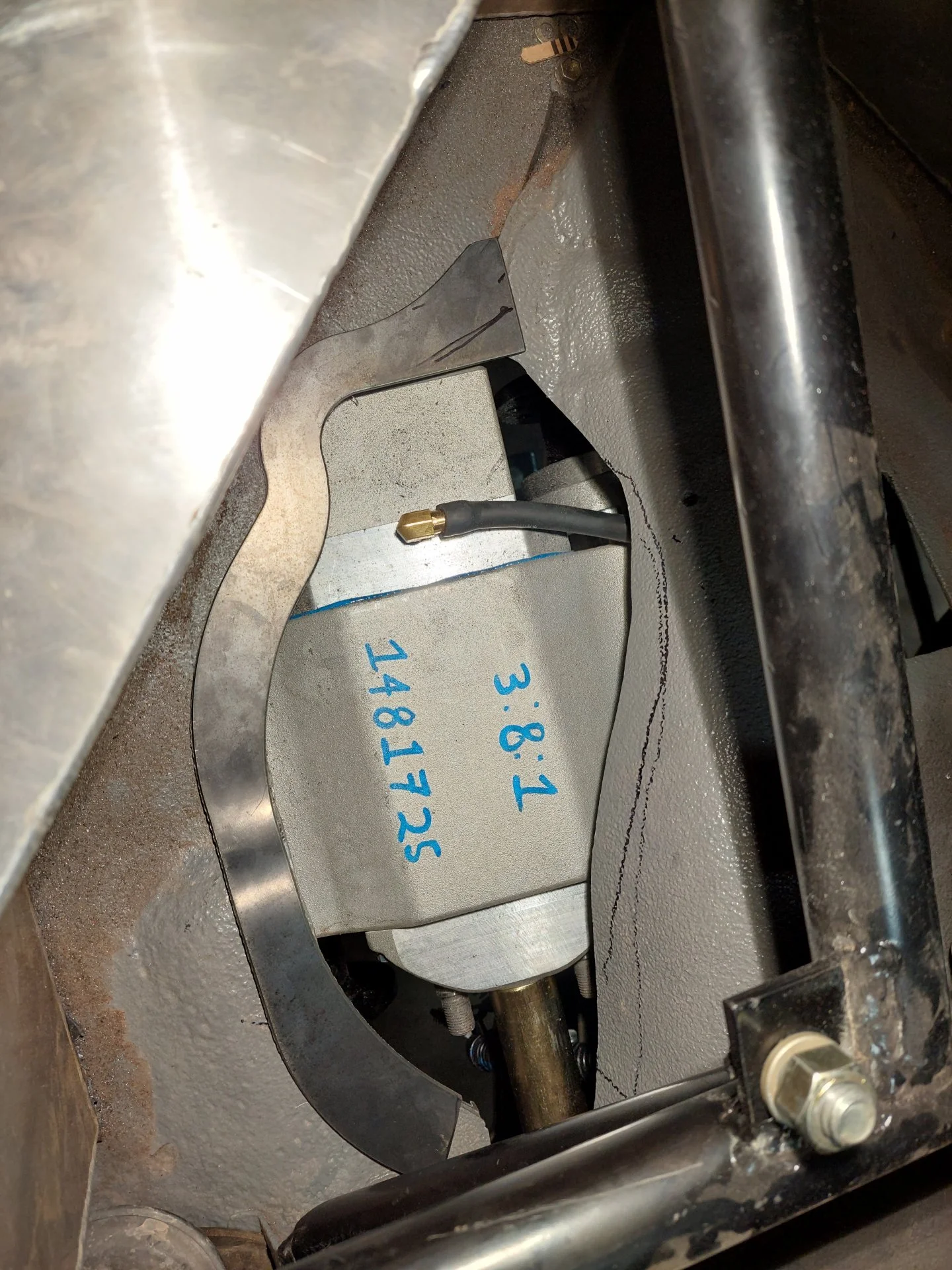

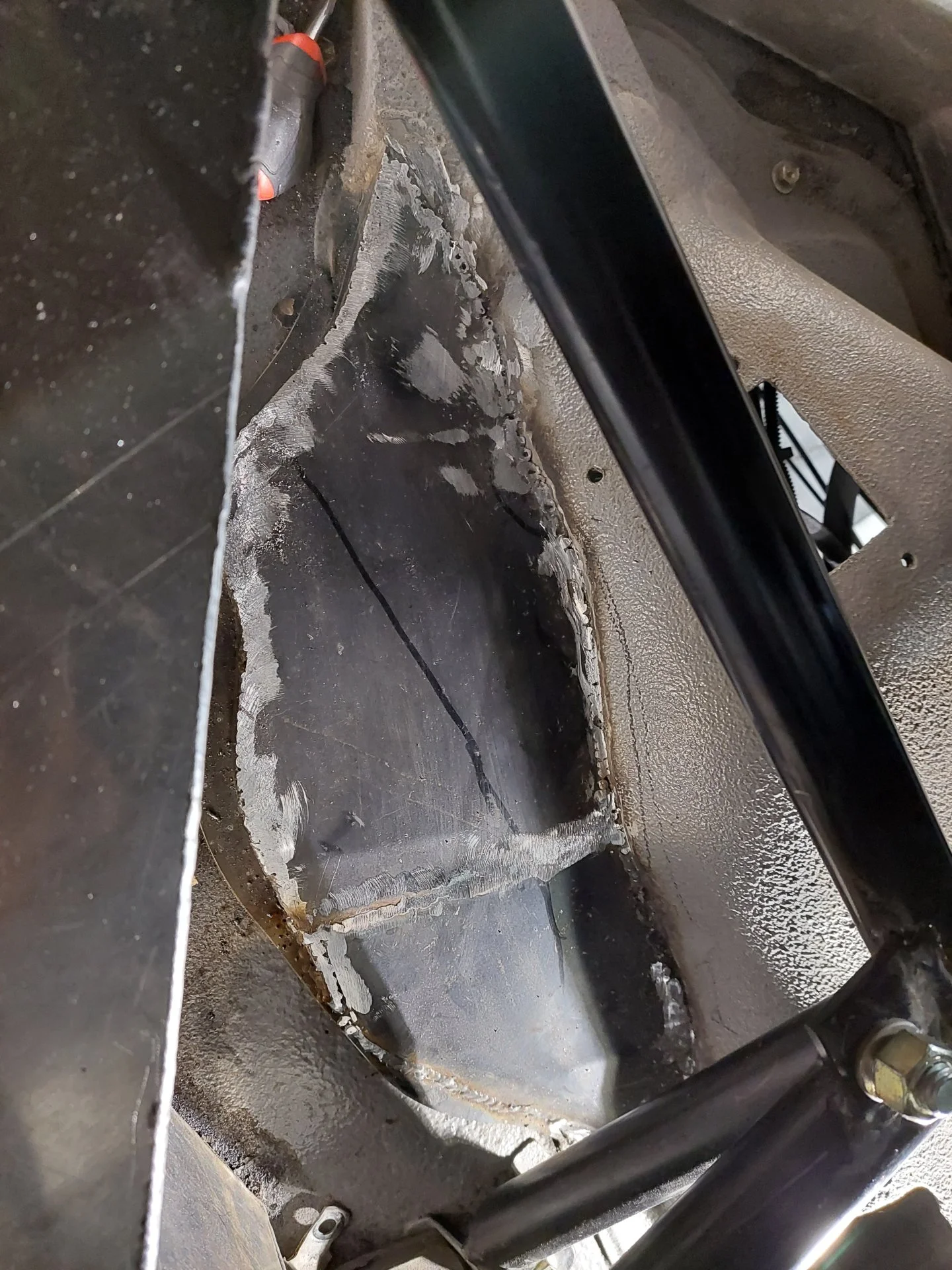

The floor just fell out, I swear!
Hump time.
Sheet metal is always fun, especially working around seat mounts.
Not the prettiest, but it's all hetting seam sealed and raptor lined again.
Not too non-oem looking, not like that matters much on this anyways.

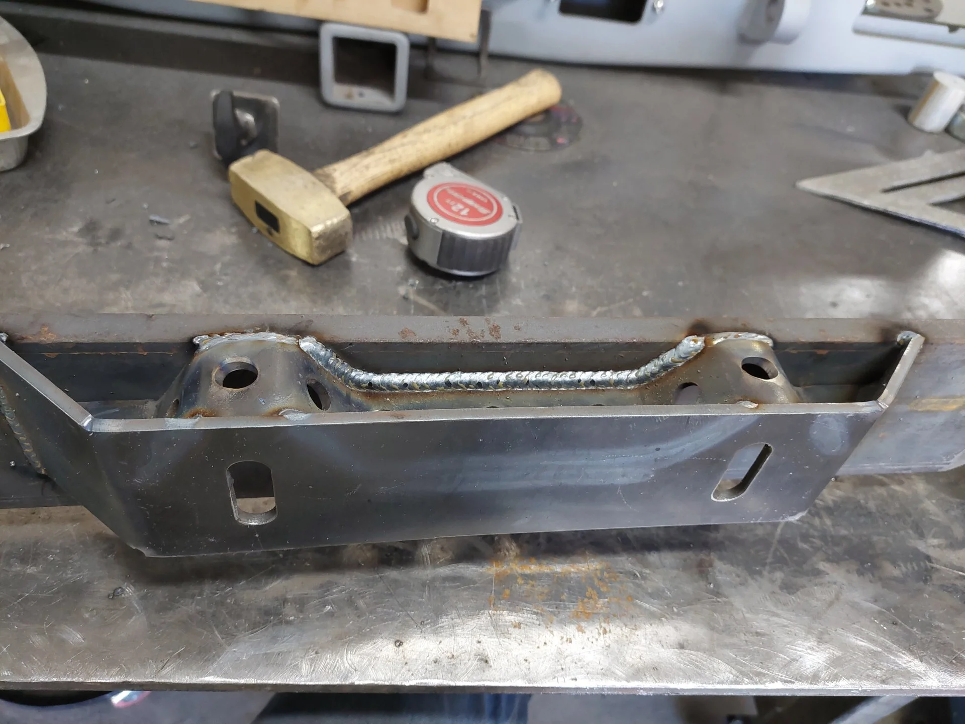

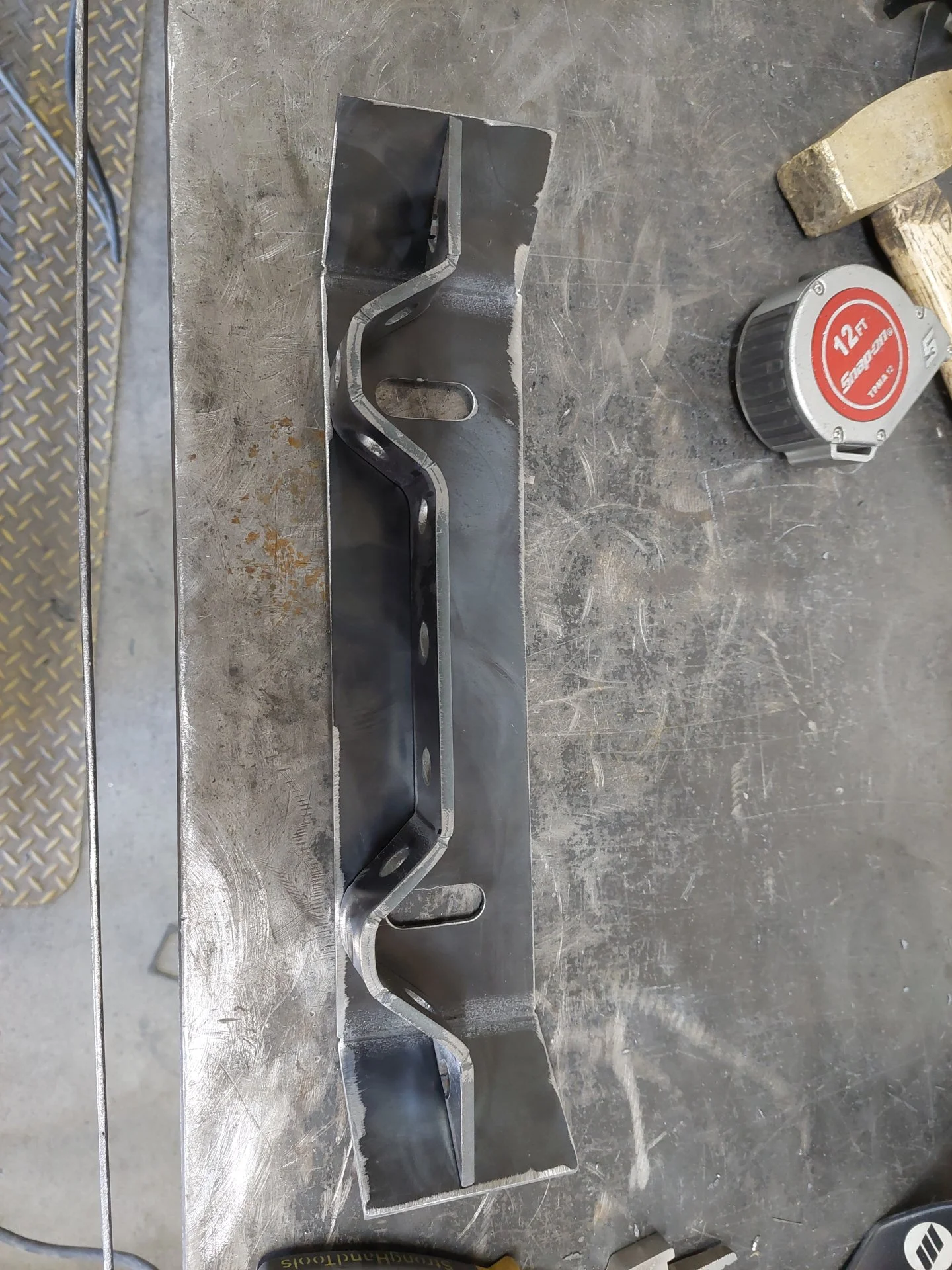

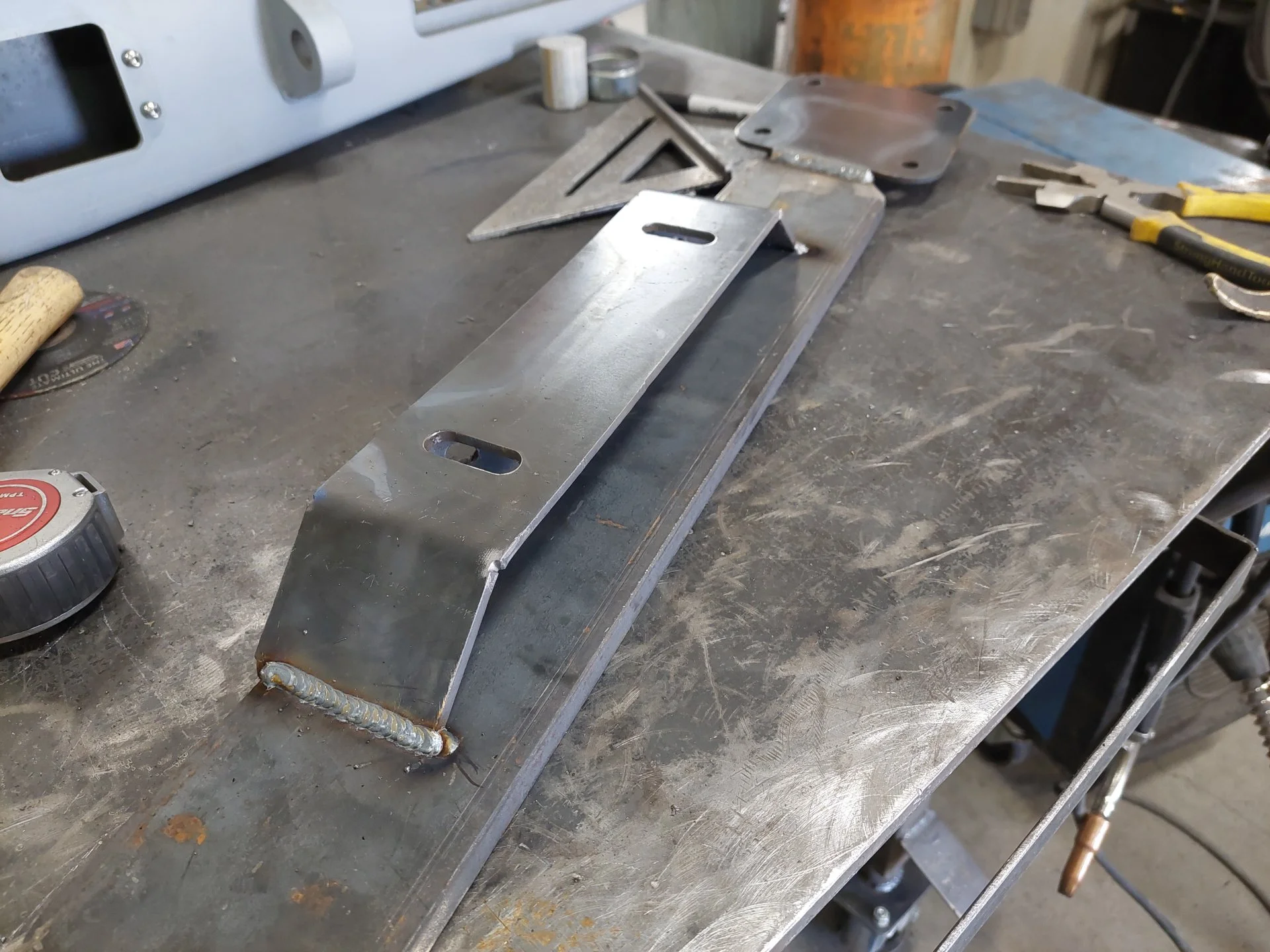

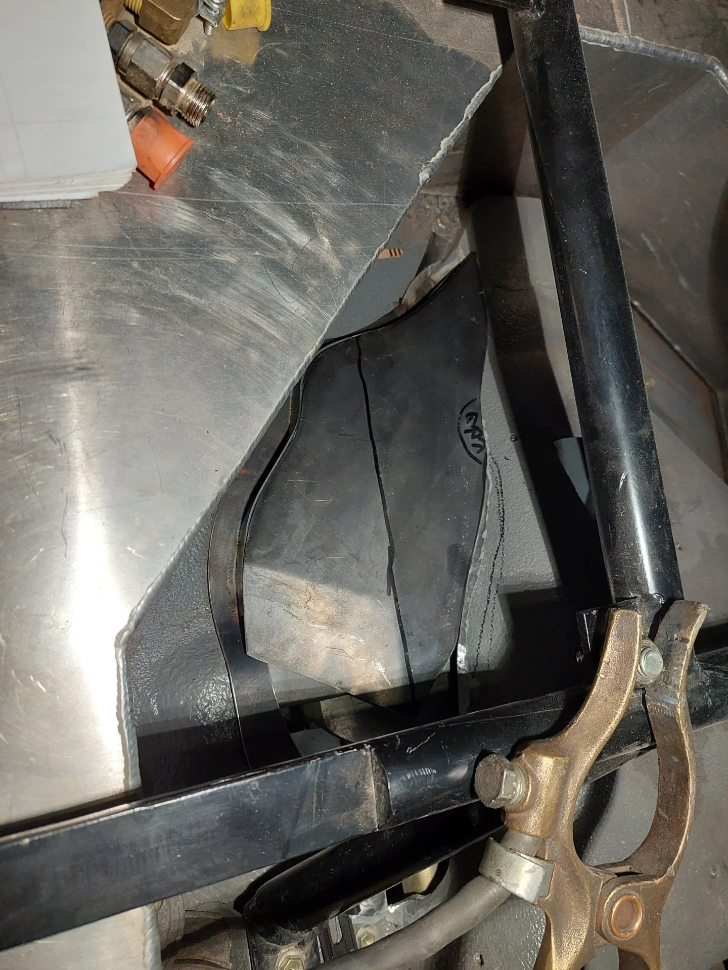

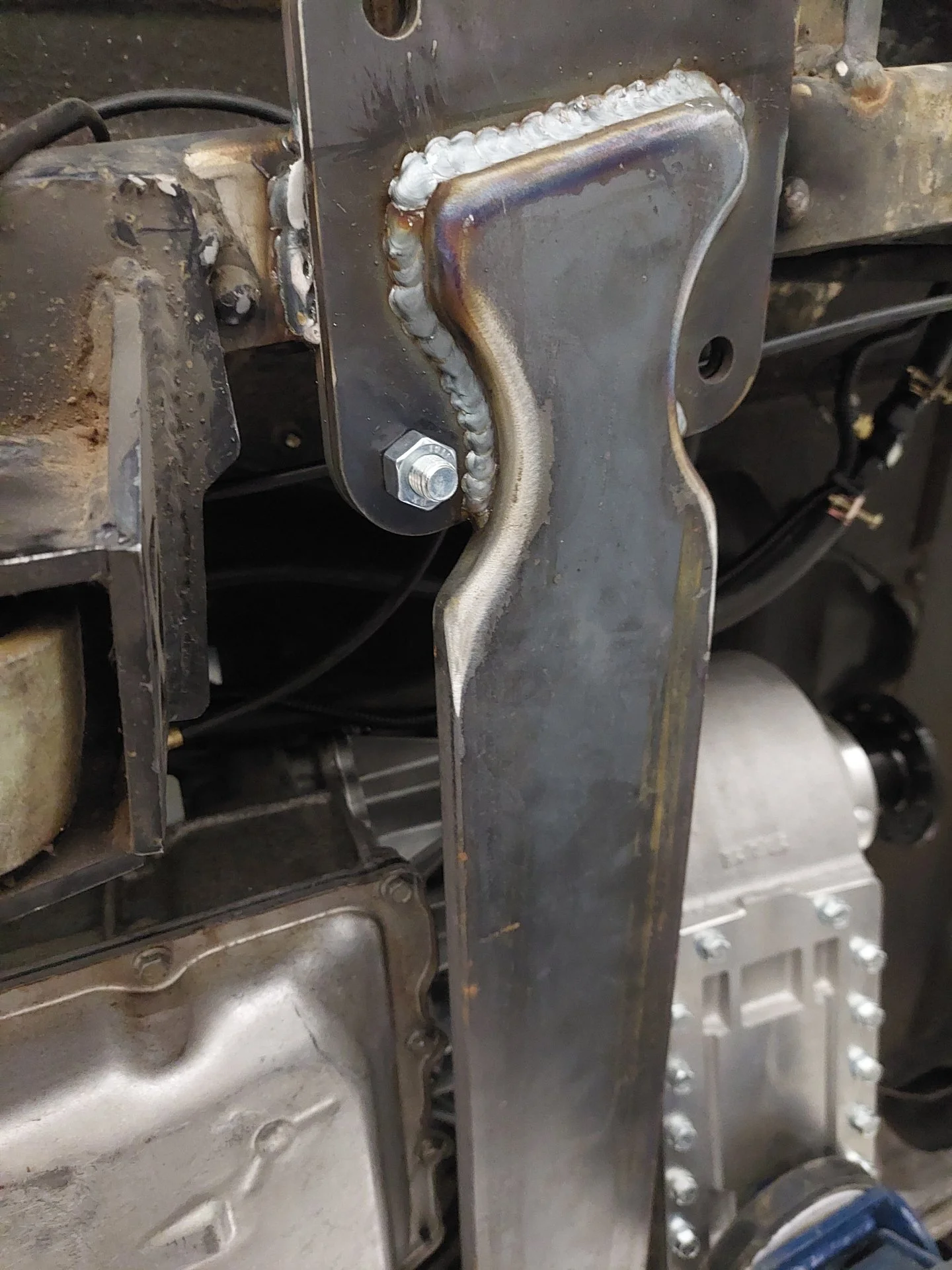

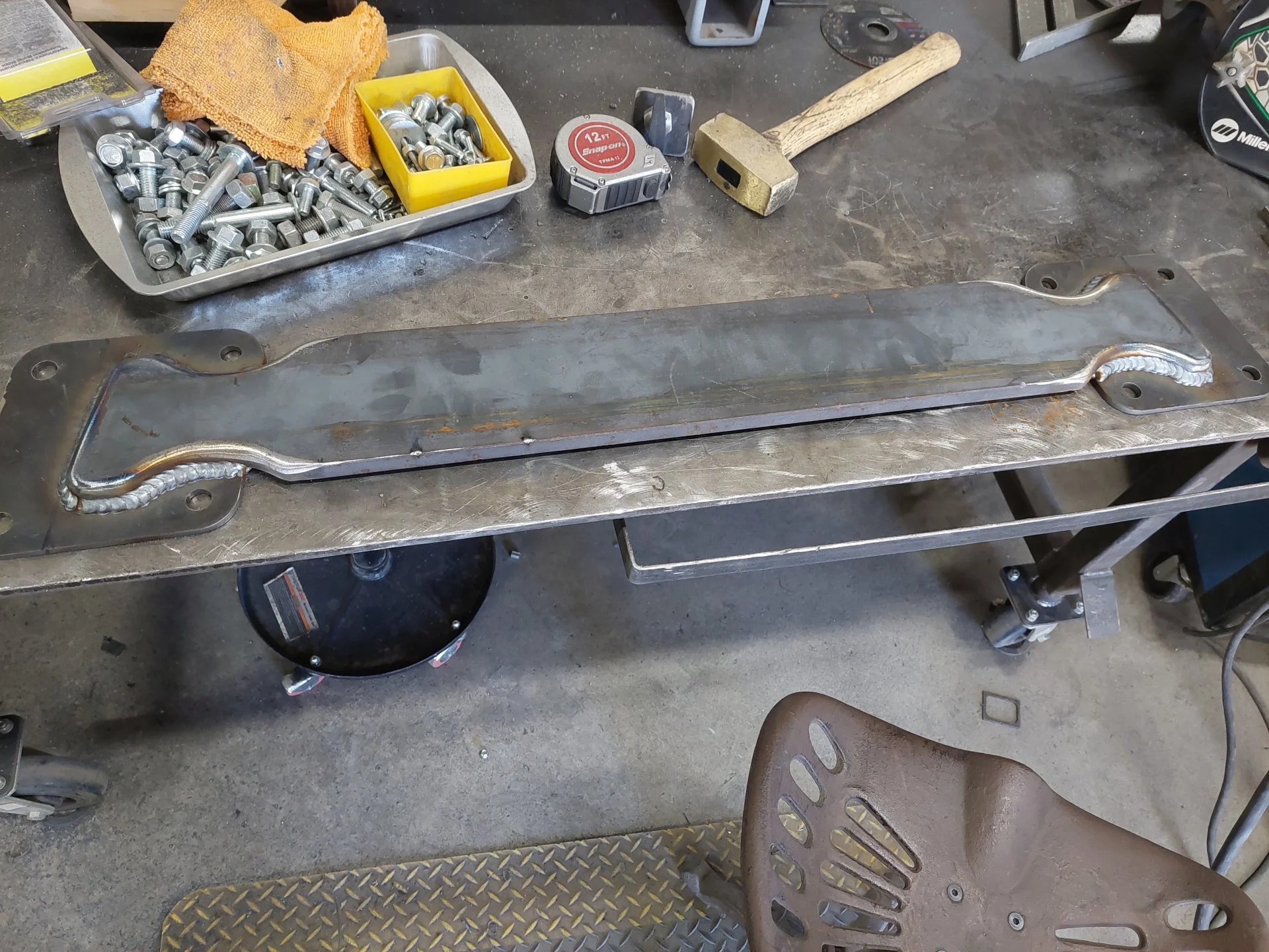

Crossmember time. 🎵 I like em thick, I like em chunkyyy 🎵

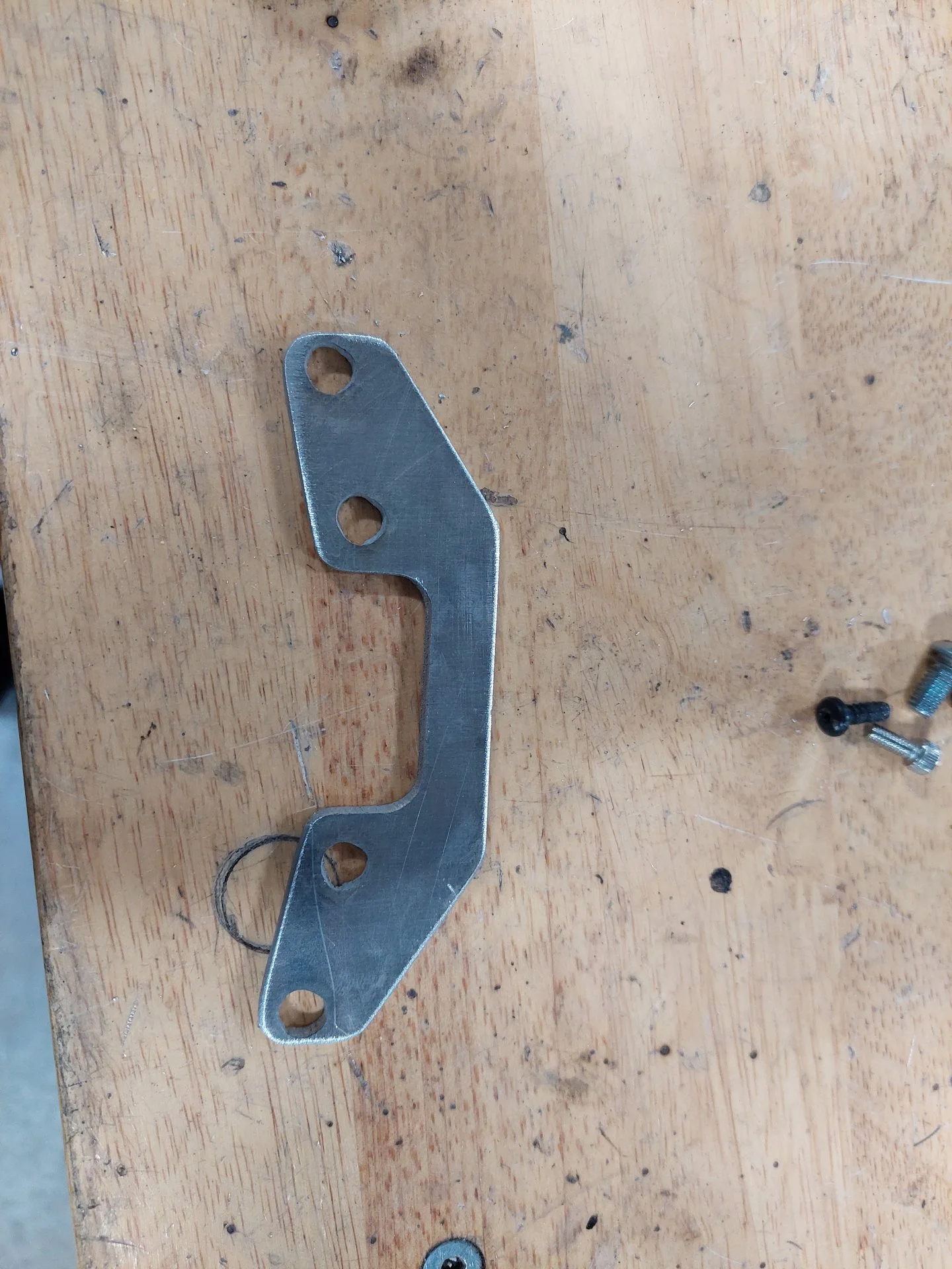

8l90 tailhousing mount.
A fun fold later.
A quick test fit.
Welded up.
I don't think this is going to bend any time soon.

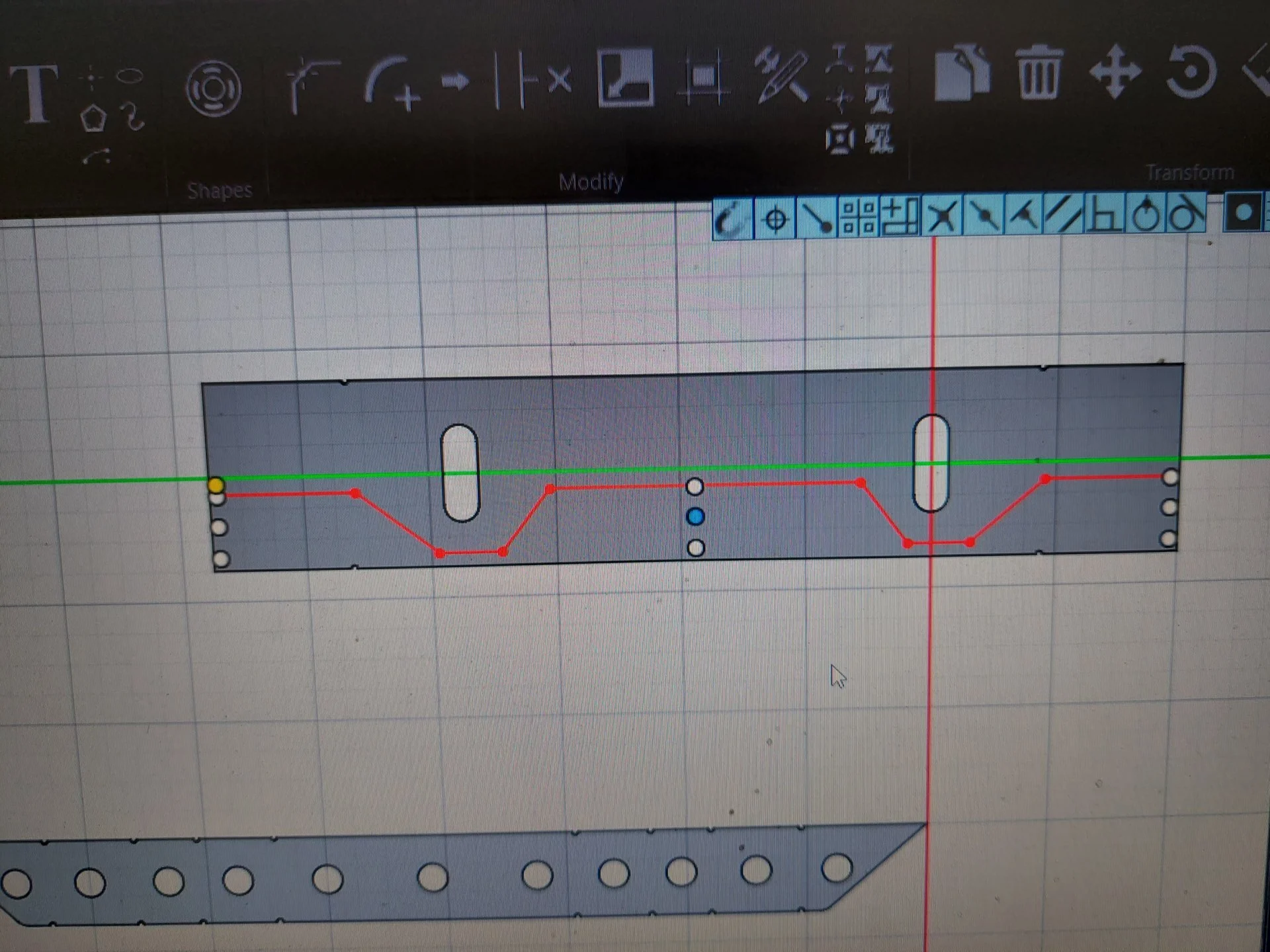

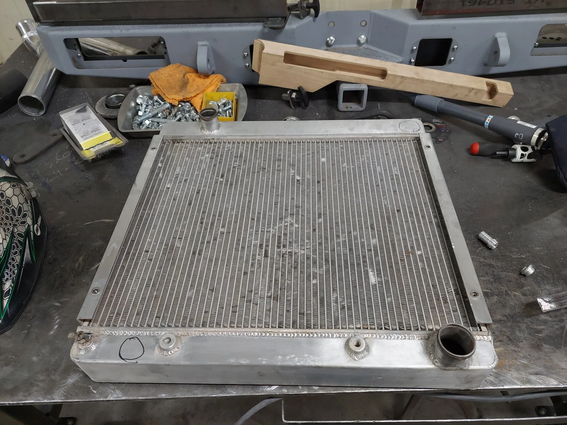

Anyways, radiator time.

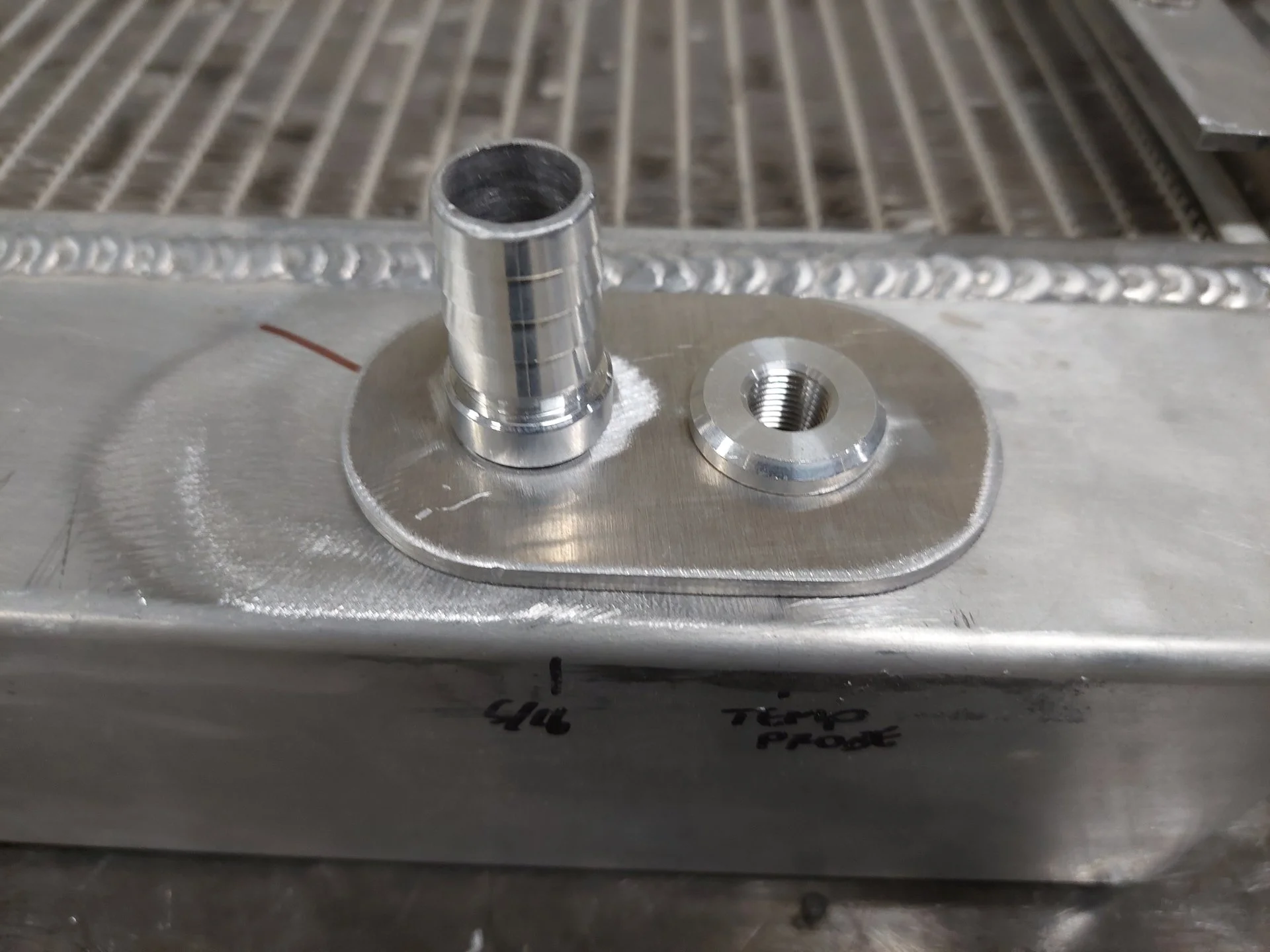

Had to switch sides for both inlet and outlet, added in a temp sensor bung, and a 5/8 hose barb for the oil cooler outlet.
Everything drawn out on where to hack.
Cover plate #1
Cover plate #2
All done!
