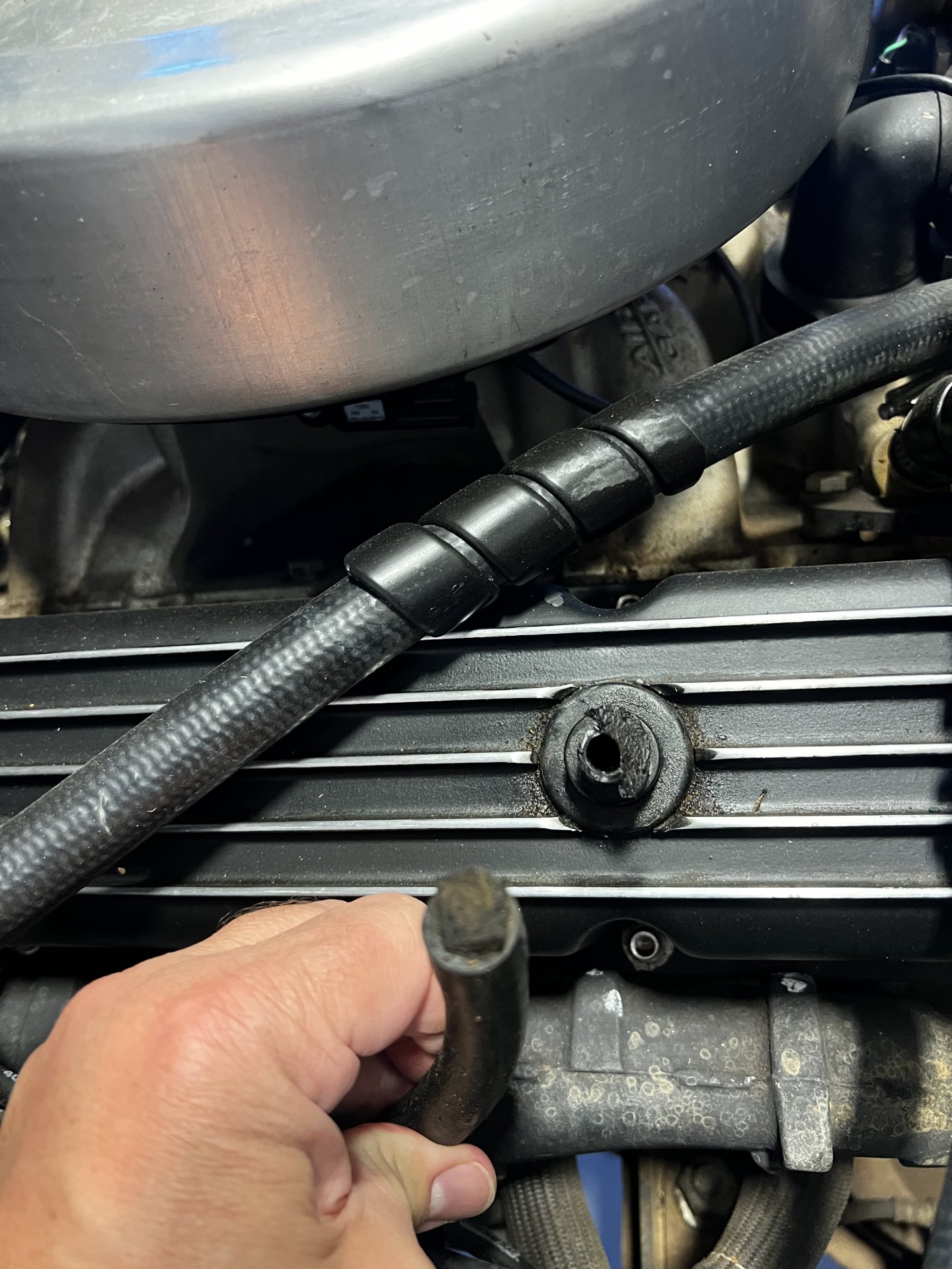

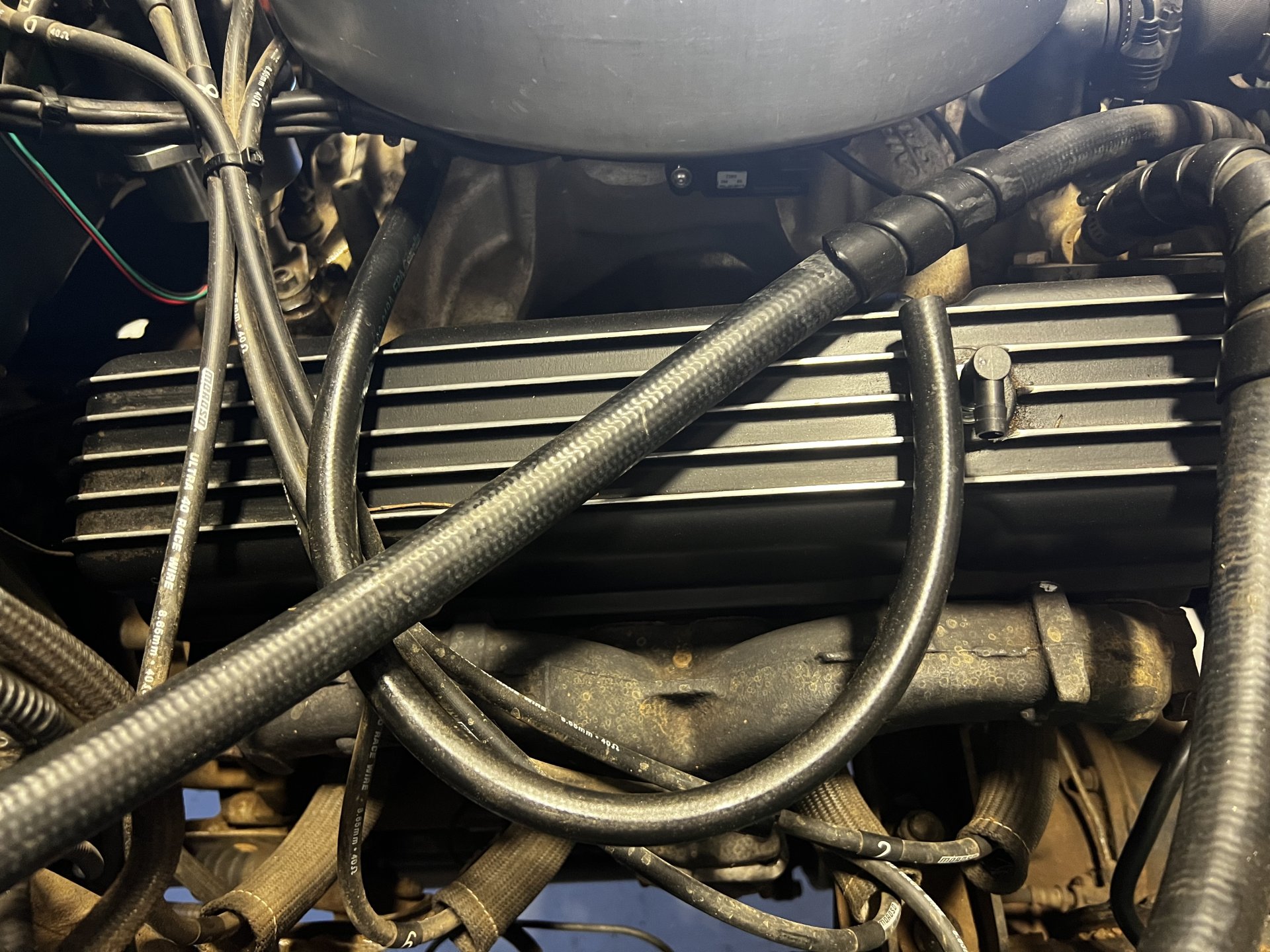

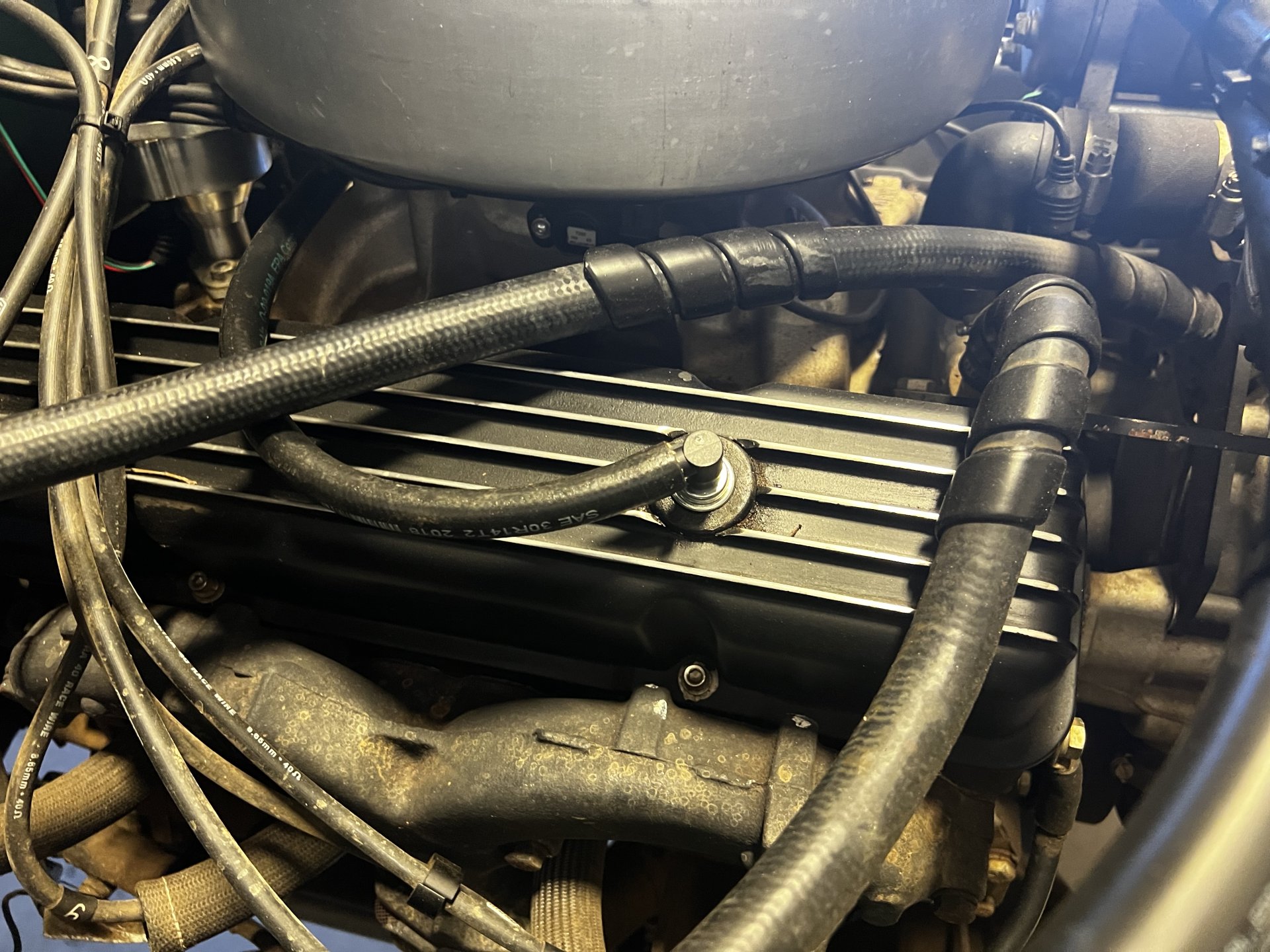

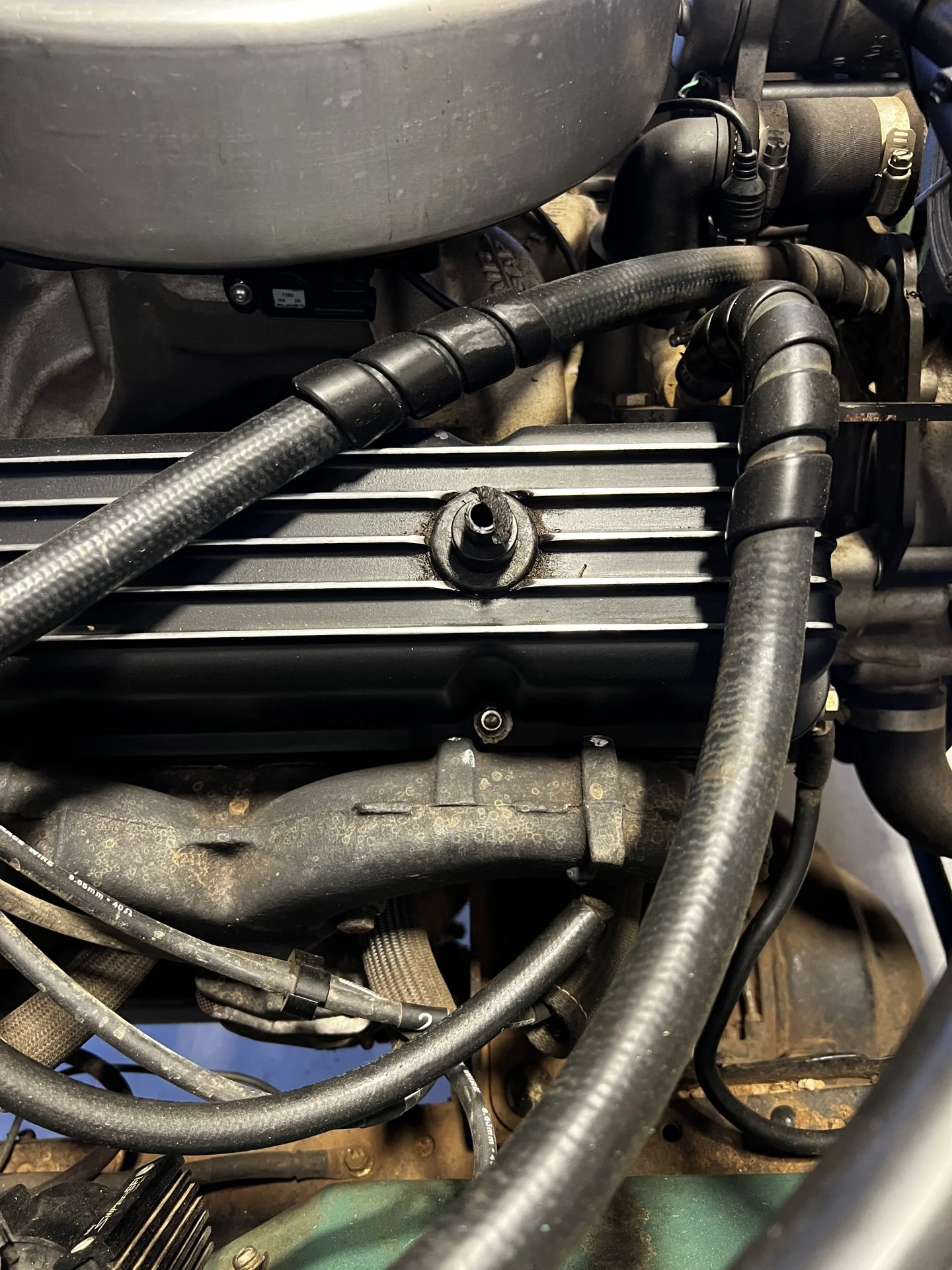

The truck seems to have suffered for a lack of PM. Don’t have time this week for a baseline, and out of town next week, but just as an example: it arrived with the PCV cracked in half (clearly the PO), and the hose was a wee bit too long (likely the PO, but possible before that.)
Fixed that, put a 1/2 gal of 50/50 anti-freeze in it, fired it up and took it for a spin.

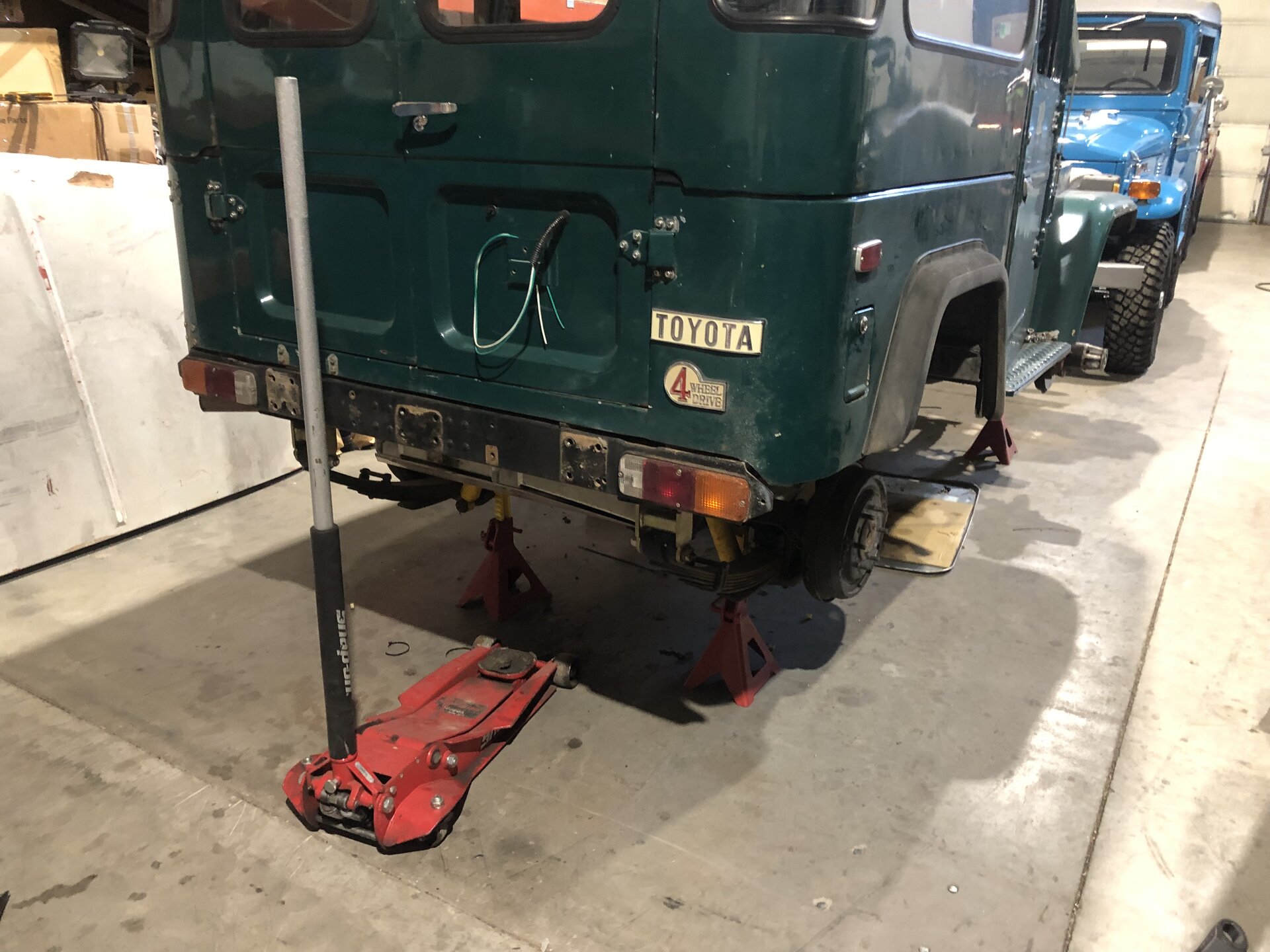

  • Rebuilt the rear brakes, new shoes, drums, one slave cylinder was leaking
