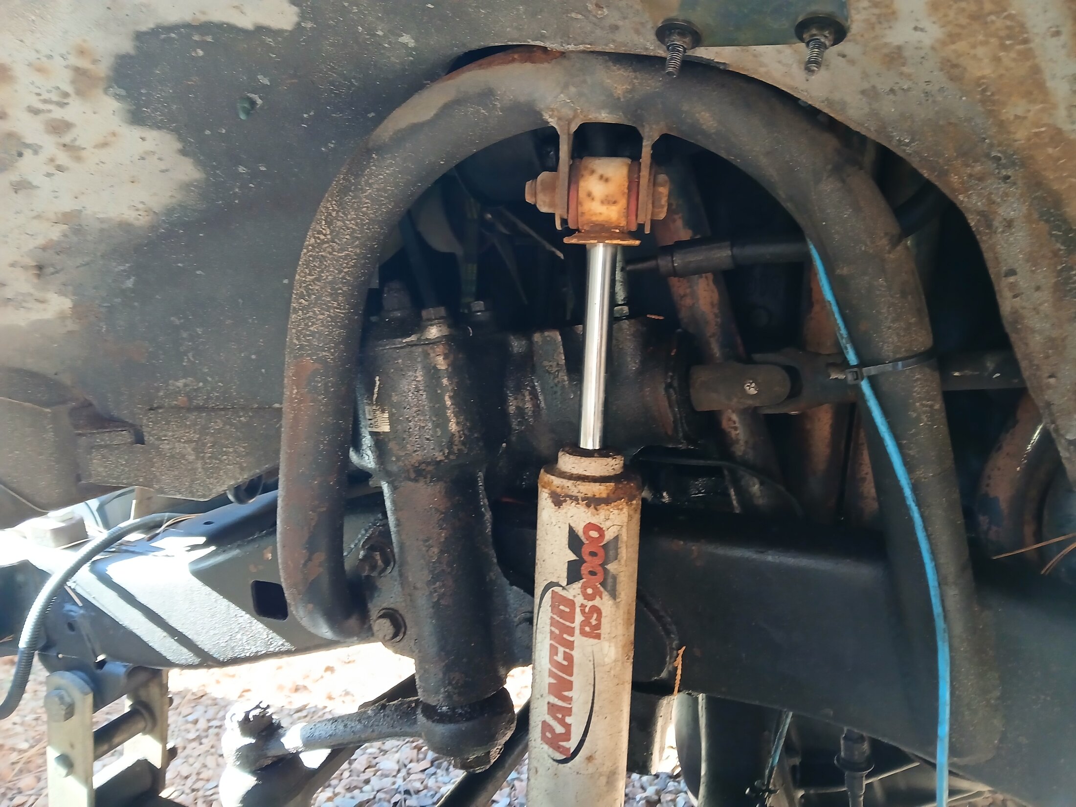

My only quibble is the Saginaw box being cleaner. I think the placement of the 60/80 box is much less invasive. The sag box requires cutting (structural ) the crossmember and a mounting plate. Th lc box only requires a mounting plate and similar mounting holes. I suppose the fender sport needs to be modified, but it’s minor compared to the hole in the xmember.
My 80 box has no trouble turning my 35’s in the rocks. If I was seriously considering bigger tires, I’d look into porting the box and add hydro assist. I’m sure the Saginaw is even more powerful if you’ll go to larger tires in the future. Everything has its place.
Not necessarily. Saginaw box with a forward-facing Pitman is pretty clean...
That's a scout box, which is a type of sag box with a longer shaft.
@TreadingLight , Scout, fj60, and fj80 steering is more common than you think. Imo, It's a less evasive and simpler install. I'm not sure how well it will work with soa. You can search scout or fj60 steering for more info.
Typically, when folks refer to sag steering, they're thinking a sag box box out frt that requires cutting a hole in the frt crossmember. Been there and had to replace the crossmember and repair the PO's frame hack.
Here's another Scout box.
