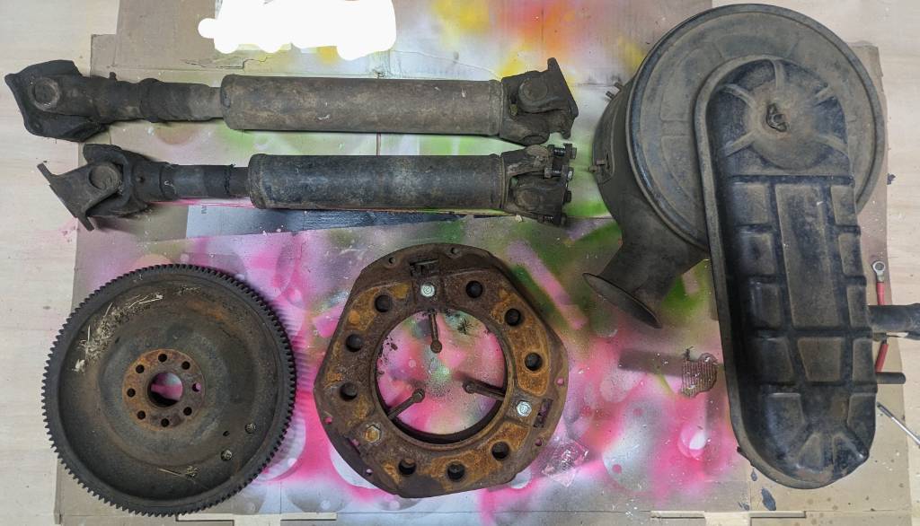

Driveshafts, flywheel, clutch parts, and a sweet factory air cleaner. Am I missing any ducting for the intake?

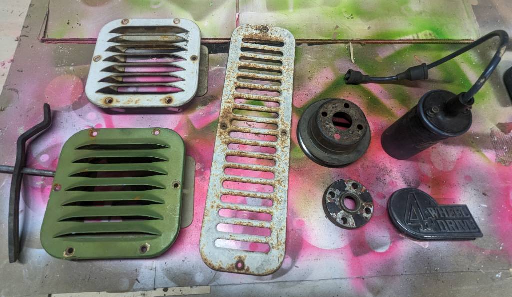

Two different color side vents, cowl vent, fan pulley, ignition coil, and a 4wd emblem.

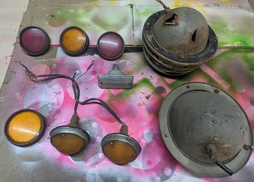

Red and amber reflectors, a pair of amber marker lights, reverse light, and two headlights, one with some strange damage. I am missing the front and rear turn signals, dome light, and license plate light.

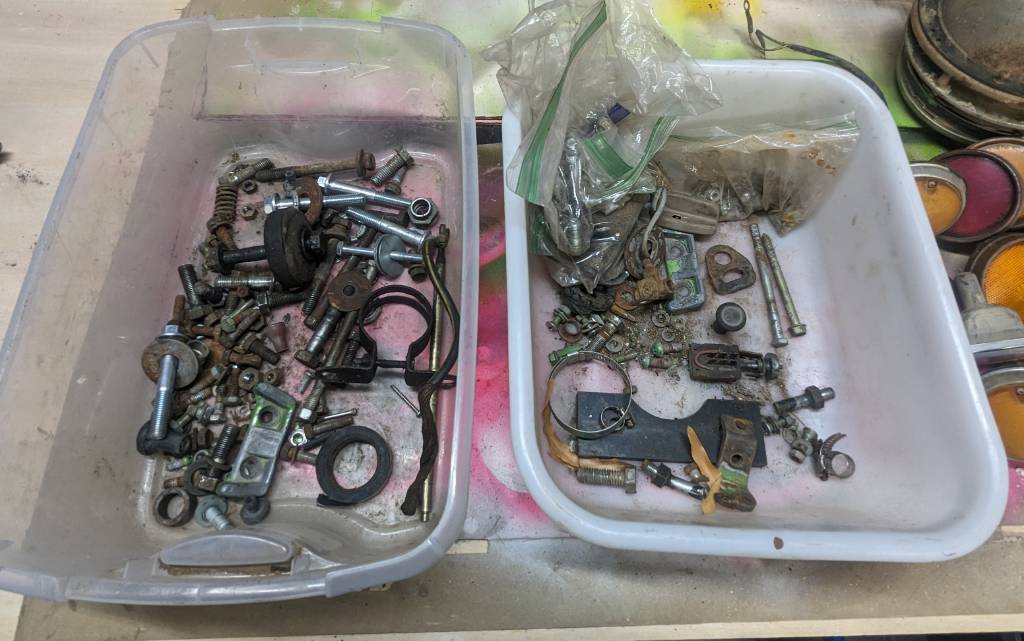

Two bins of miscellaneous hardware and brackets. Also a headlight switch sans knob and a wiper knob sans switch. I am missing a lot of switches and pulls.

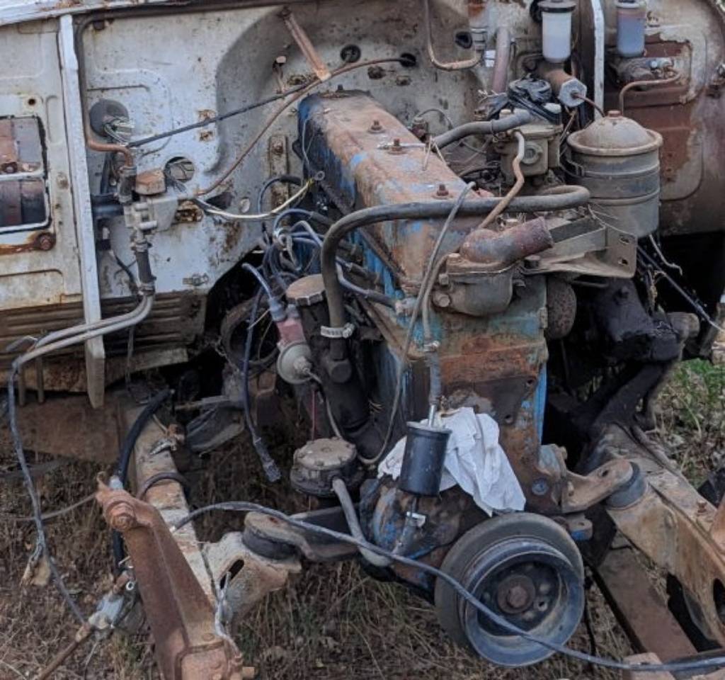

I do have an engine, tcase, and 3 speed. There is a protective paper towel in place of a water pump. I hope no squirrels decide to take up residence in the block. There is a protective cap made of electrical tape over the carb. Most of the brake lines have been cut. The wiring is a disaster. I am missing the washer tank and coolant overflow tank.

no other ducting for the air cleaner
These are this way because someone painted them two different colors previously, and that’s how light works.
This is standard equipment with any used 40, and there’s a lineal relationship between how full the buckets you get are and how many other 40’s you own with other buckets. The more you already own, the fuller the buckets will already be.
But you will always be missing at least one knob.
