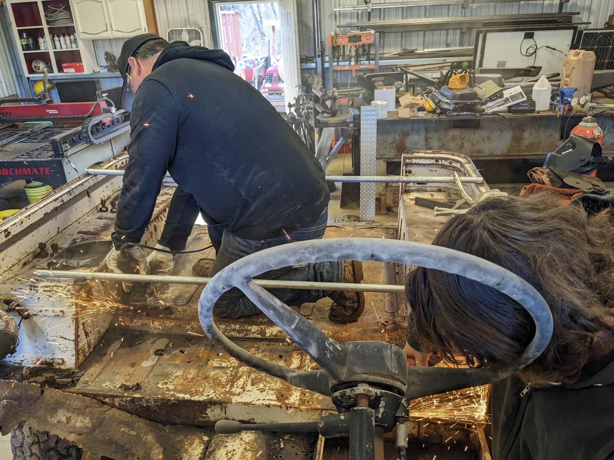

Back at it, our luck didn't hold out when I looked at the floor under the tank and the driver seat.
It appears my fuel tank was structural.
Ventilation holes
So we went to town chopping out a lot of rusty floor.
In the end we patched one rust spot but removed a lot more metal than we added.
