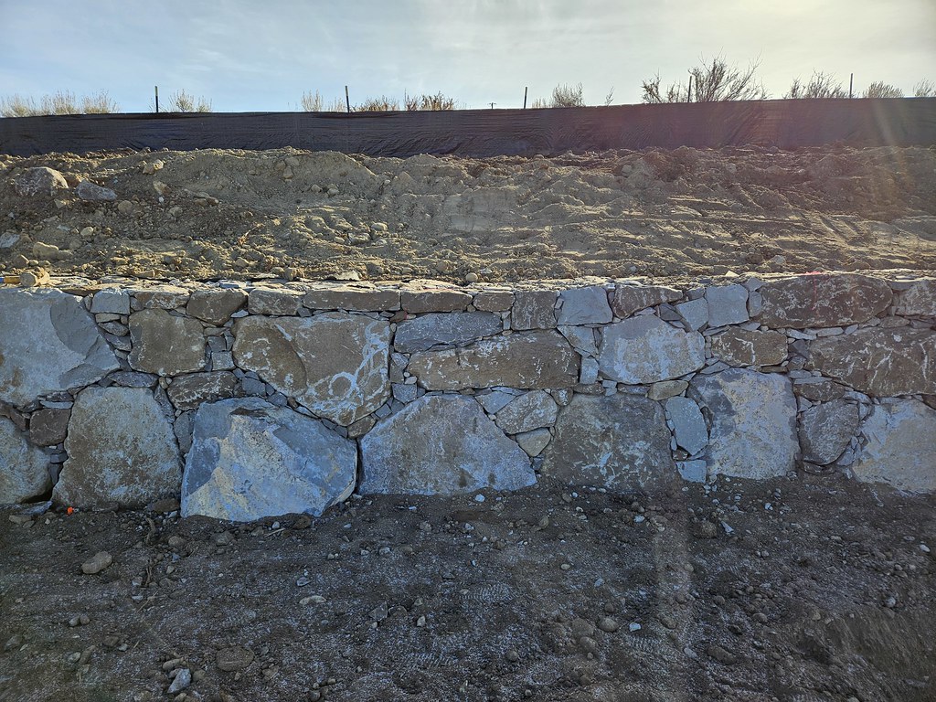

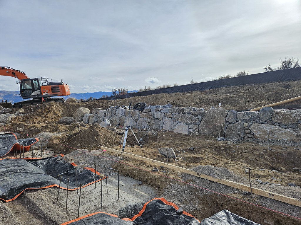

Grading/excavation sub got started on the rear retaining wall too. Nice to see they placed fabric and perforated pipes behind the walls, without me having to ask. Pretty much all rock came from on site, which saved a bit too. Crazy how much large rock costs, and not including transport fees..
Love the native rock use for the retaining wall, that looks great!

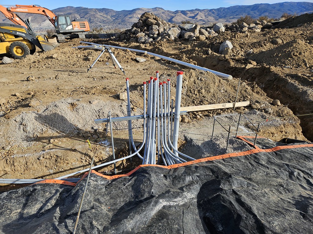

Weekly update... It was mostly the electrician on site this week. Spent quite a bit of time walking the site with him and going over outlet placement and shop equipment. He likes to run a lot of conduit under the slab, which is fine with me. He is doing two large electric troughs on either side of the shop to access the conduit, which will also make future wire additions or changes very easy.
First level of the rock wall is done. Turned out incredibly well. I told them it didn't have to be perfect, but that is probably the nicest rock wall I have seen. I'm guessing the 24 packs of beer I drop off every Friday afternoon are starting to pay off. Too bad the wall will mostly be hidden behind the shop. It was neat watching the guys make it. They would drop the really large boulders in place with the big ex, then use chains and the mini ex to place the rest. Lots of sledgehammer work to shape them just right too. It was crazy, the did it with no eye, ear, or respiratory protection. Not even gloves.

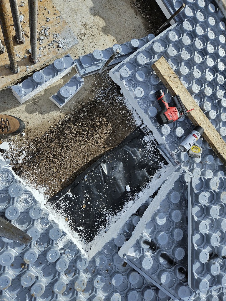

Cut out some foamboard for the mini footings for the lift. Probably no point removing the dirt (there is concrete from the footings under the exposed vapor barrier) since the slab will be 6", the foamboard is 2", and the pex channels are 2", so that gives me a 10" slab in that area, where Rotary only requires 4.5". Most important part is that the plumber will see NOT to run pex in these areas.

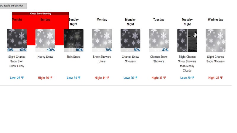

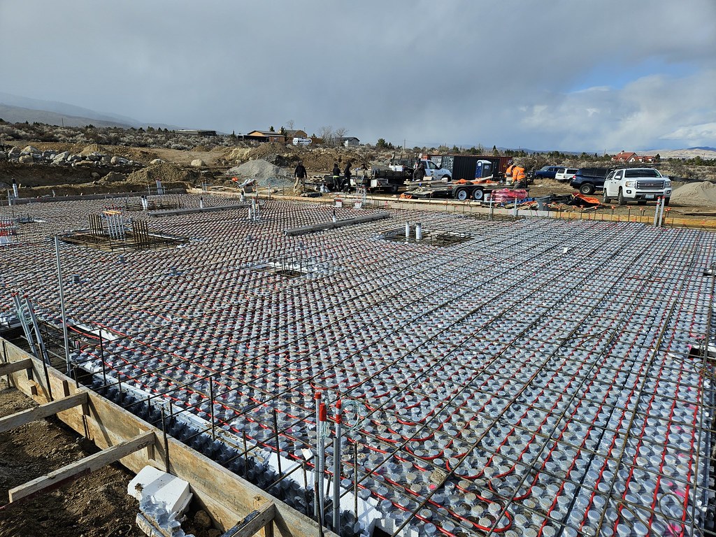

Well everything is more or less ready for concrete...except the weather. It was 70* last weekend and into the start of this week, but now the forecast is calling for 18" of snow on site. We were not quite ready to pour when it was nice. Probably missed the "window" by just 1-2 days. Concrete sub got everything covered again with the blankets, and we'll see what happens at the end of next week.
The pex manifolds seem to be holding the 100psi they were charged to so no rebar punctures. A boom pump will be used for the pour, so that should minimize additional foot traffic (and puncture risk). The pictures don't show them, but the rebar mat was elevated about 2" on chairs. The plumbers said the foamboard with the pex channels made their job quite a bit easier. It also kept the pex out of harm's way for the concrete crew during rebar installation.

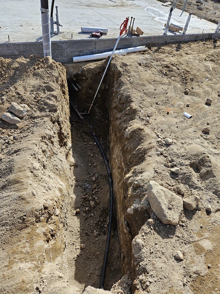

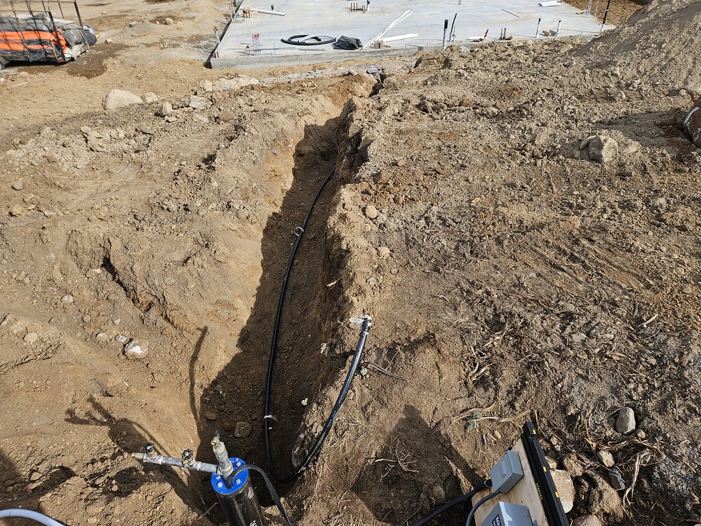

I had the excavation crew grub out a 3/4 acre corner for an animal pasture. I still need to move some rocks but at least the area is fairly level. They also dug the water line from the well. Our well flows at 12gpm but I want to irrigate the pasture with some big 1.5" sprinklers that suck up 50gpm each so we will have to place a 5000 gallon underground water tank. I was going to use a transfer pump from the tank directly to the pasture (with a second connection for a fire hose) and then still run traditional pressure tanks in the shop for domestic water, but after talking with the pump and well guy, he said they like to run domestic water from the tank too with the transfer pump, which will eliminate the need for the pressure tanks. Since the pressure tanks were almost $2k each (had 4 planned), and the transfer pump is $6k, I will actually save money there.
We finalized the power supply with the local utility company and can get away with a pole mounted transformer (50kva) right at the property line, then do the secondary run underground to the shop (about 90') and the house (about 230'). They said voltage drop to the house should not be an issue. This is going to be a lot cheaper than the 900' underground run and pad mounted transformer we originally had planned.
