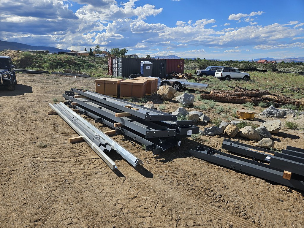

It's been a long 3 month wait, but progress again. The building kit was supposed to be delivered at the end of April, but was delayed until today. Kind of a bummer since I rushed everyone to have the slab ready to go by spring, but at least it should be fully cured by now.

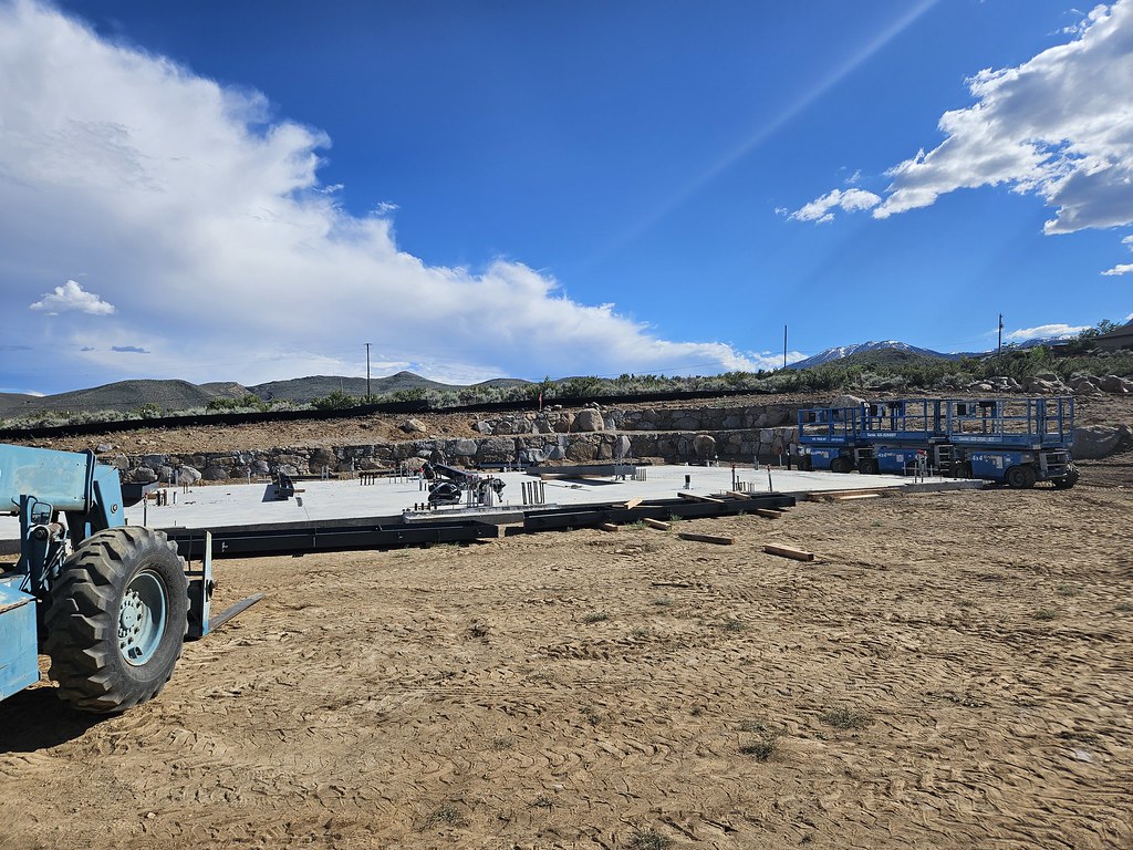

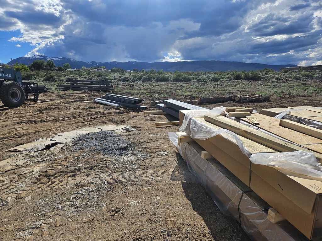

4 semi loads so far. Lots of steel. Final semi is inbound tomorrow with all of the metal panels.

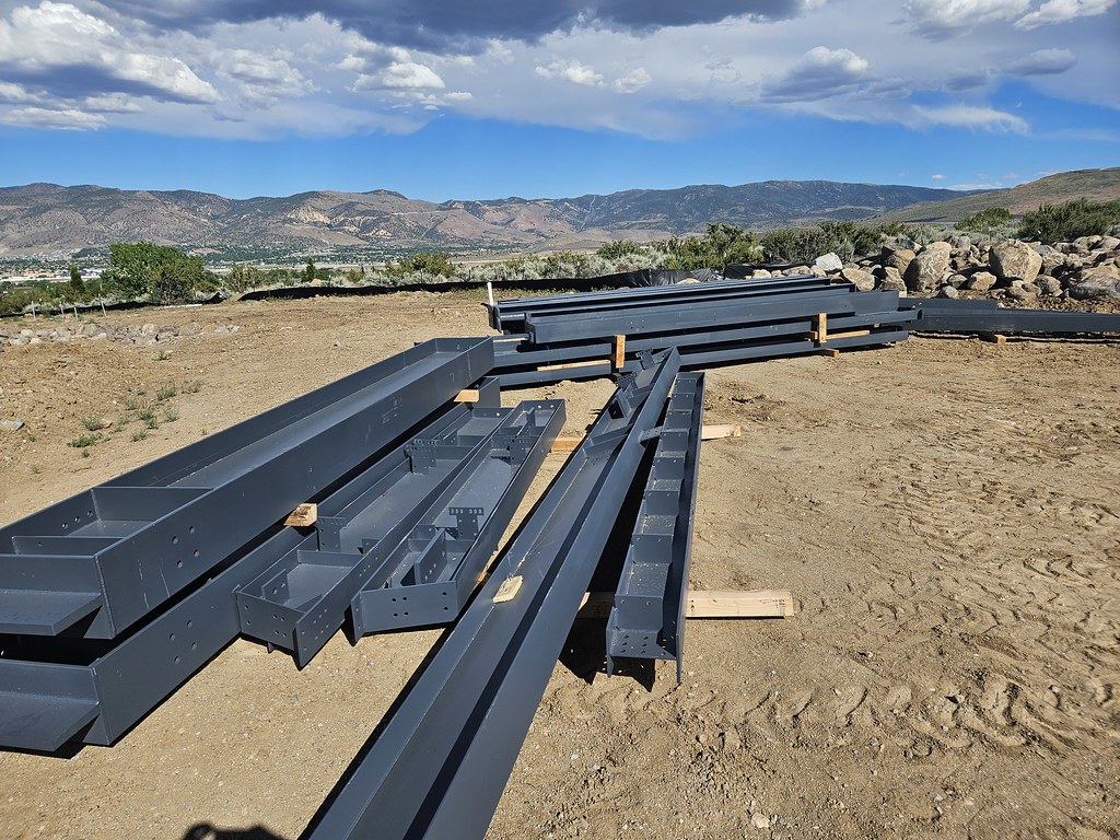

Beams and columns scattered throughout the property. Good thing we cleared the pasture space as it is currently providing storage for steel and wood.
Those are some pretty hefty beams. The footprint provides a bit of scale.
I'll post an update weekly but we should have it fully framed by July, then wood framing for the living quarters a few weeks later. Plan is still to have it move in ready by the end of the year.

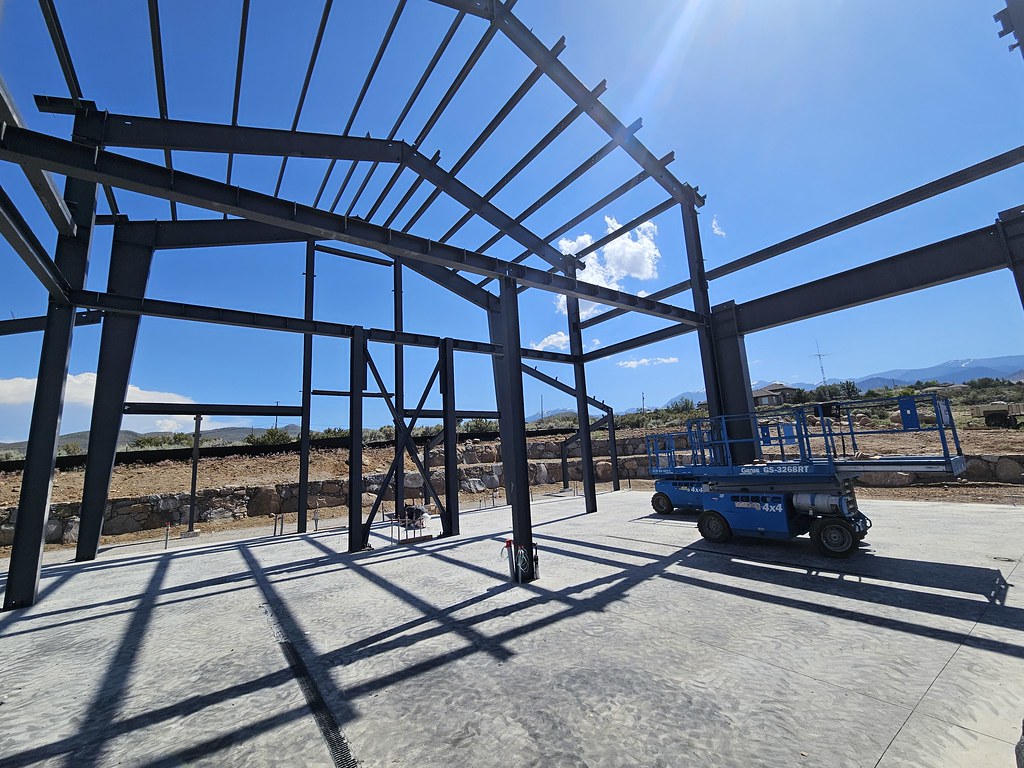

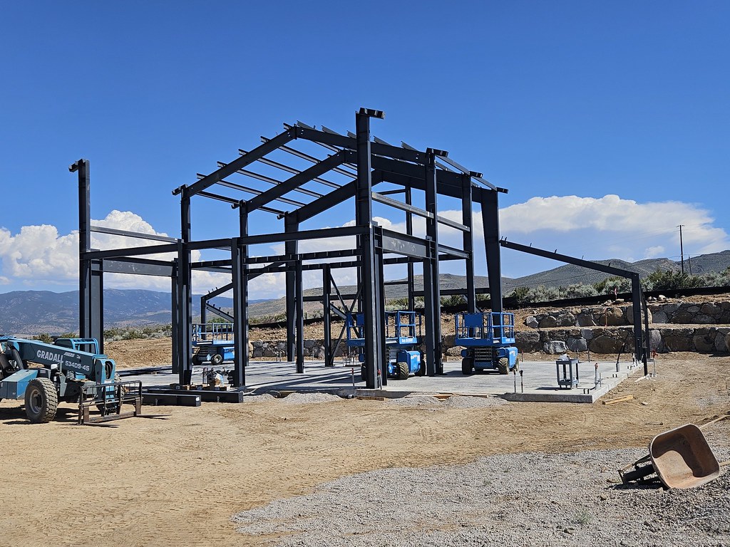

Day 1 of erection on Monday.

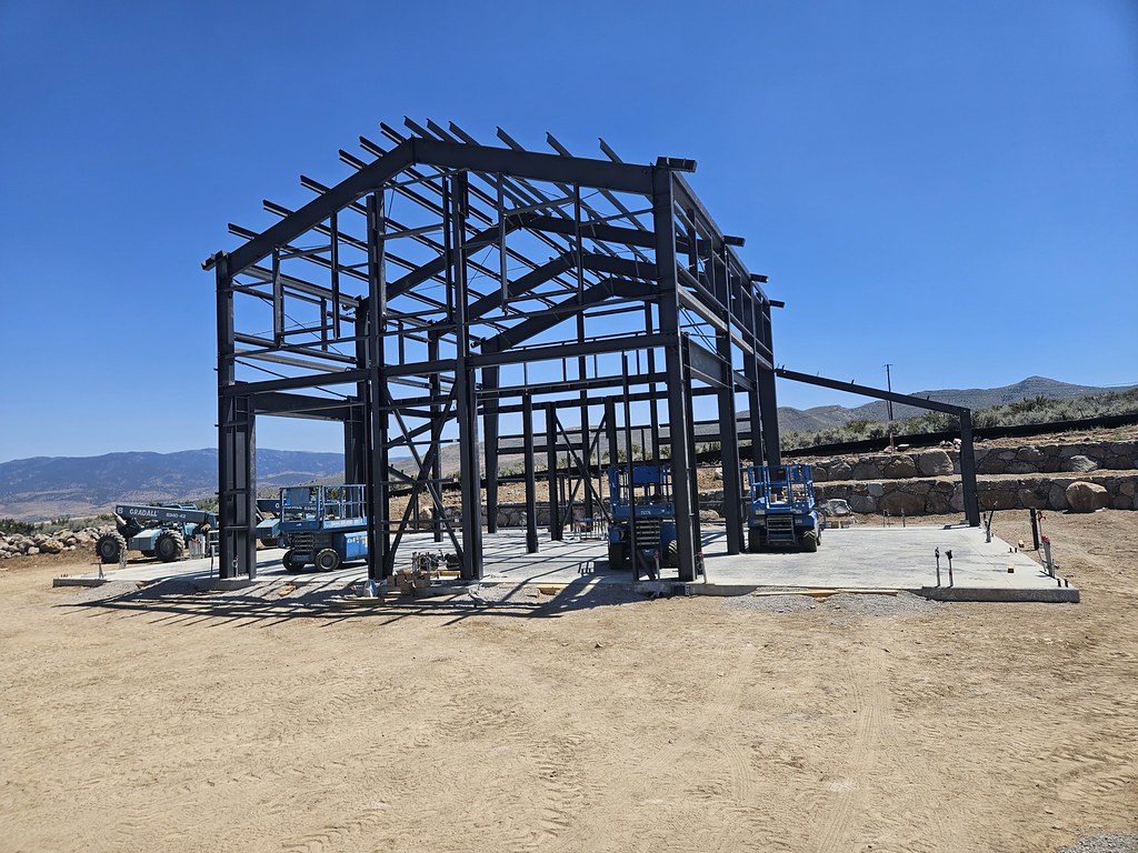

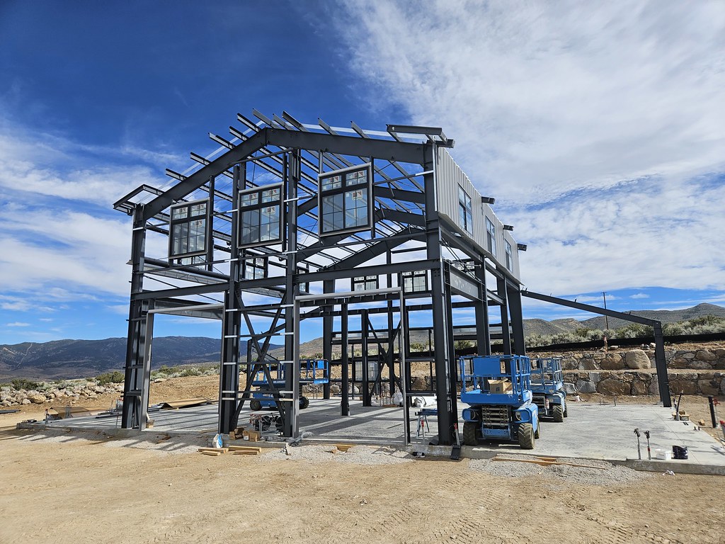

Day 4 of erection today. Pretty good for a 4 man crew over 4 days. I wish I could have taken some time off of work to watch them. I did not fully comprehend the scale of this thing until the first beams when up. Bigger than I had imagined.

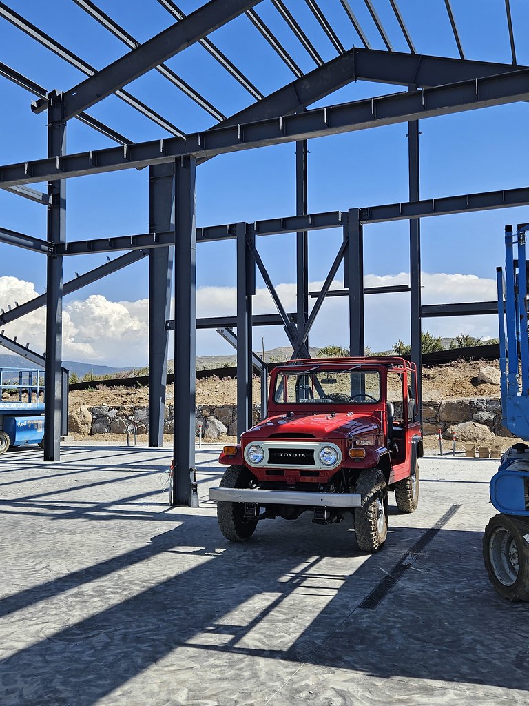

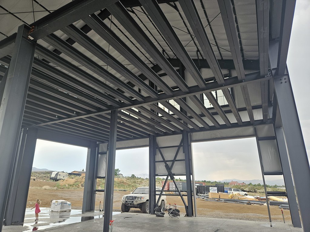

FJ40 checking out its new home. It will be nice to have all of the cruisers inside and under the same roof!

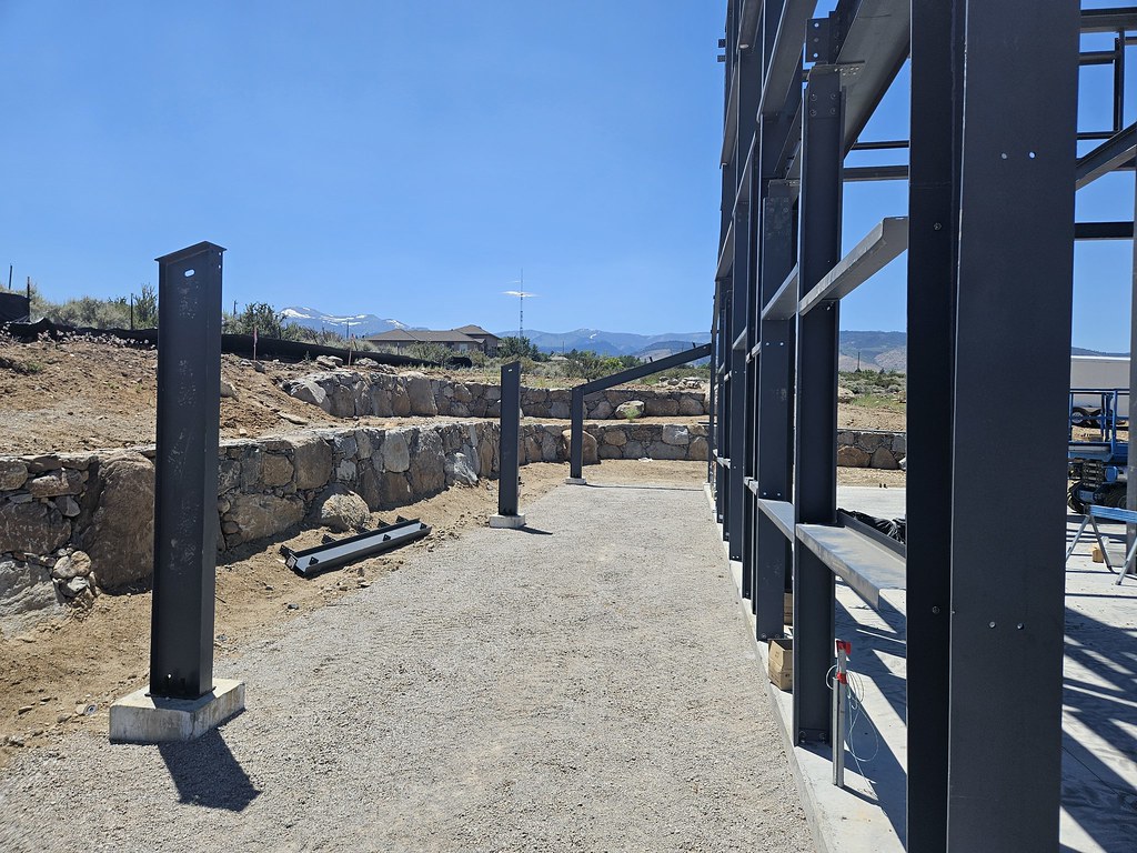

Purlins, girts, and x braces going in, along with some framed window openings. The erector crew wants to start skinning and insulating the center section next week, then do the lean to's after.
Full length back porch is going to be nice. 10' under the low point and 10' deep. Almost ready for concrete. So far we are at 190 yds of concrete. Crazy how expensive that stuff is. Next week will be interesting to see the sheet metal go on. Hopefully we chose wisely on our colors.

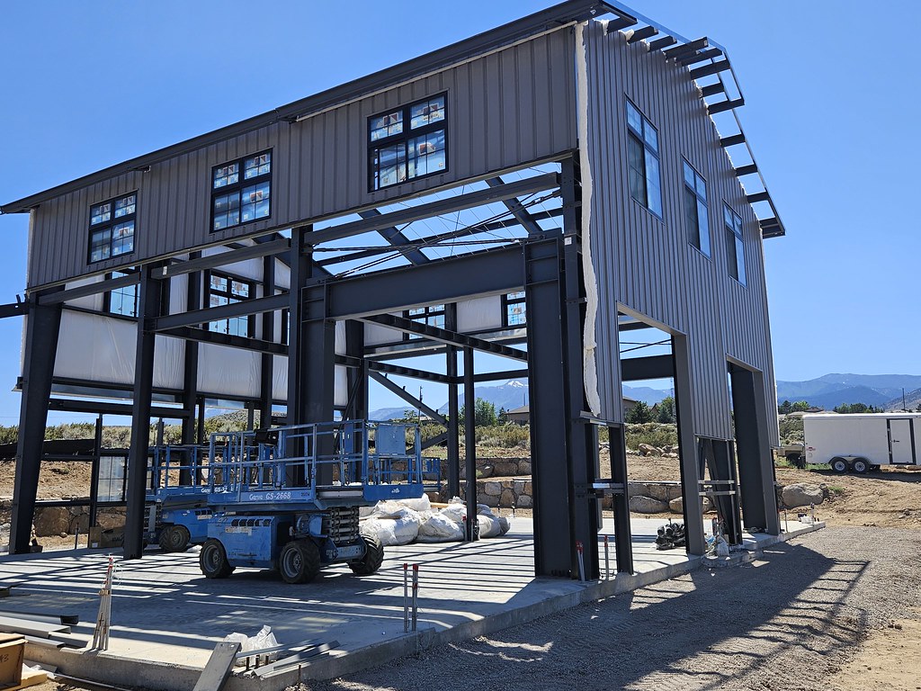

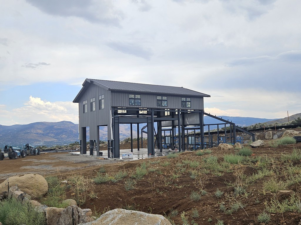

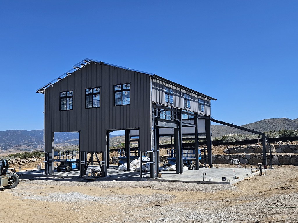

It doesn't look a whole lot different, but the roof is on, along with most of the center section trim. There is a lot going on with the trim, which is taking some time. I dropped by on Friday (they usually work 4 10s) and they were still there, trying to finish the center section trim before the framers start next week. The roof is dark bronze, and the siding is slate grey. The lighting in this photo doesn't show it well, but there is a decent amount of contrast between the two.
The framers wanted to get in before the lean too's were erected for easy access, and to avoid two different crews working in a confined space. The area above the mezzanine will be where we live for the next 2-3 years. It's 1600 Sf, with 3 bedrooms and 2 full baths. It will be somewhat tight, but still comfortable for our family of 4.

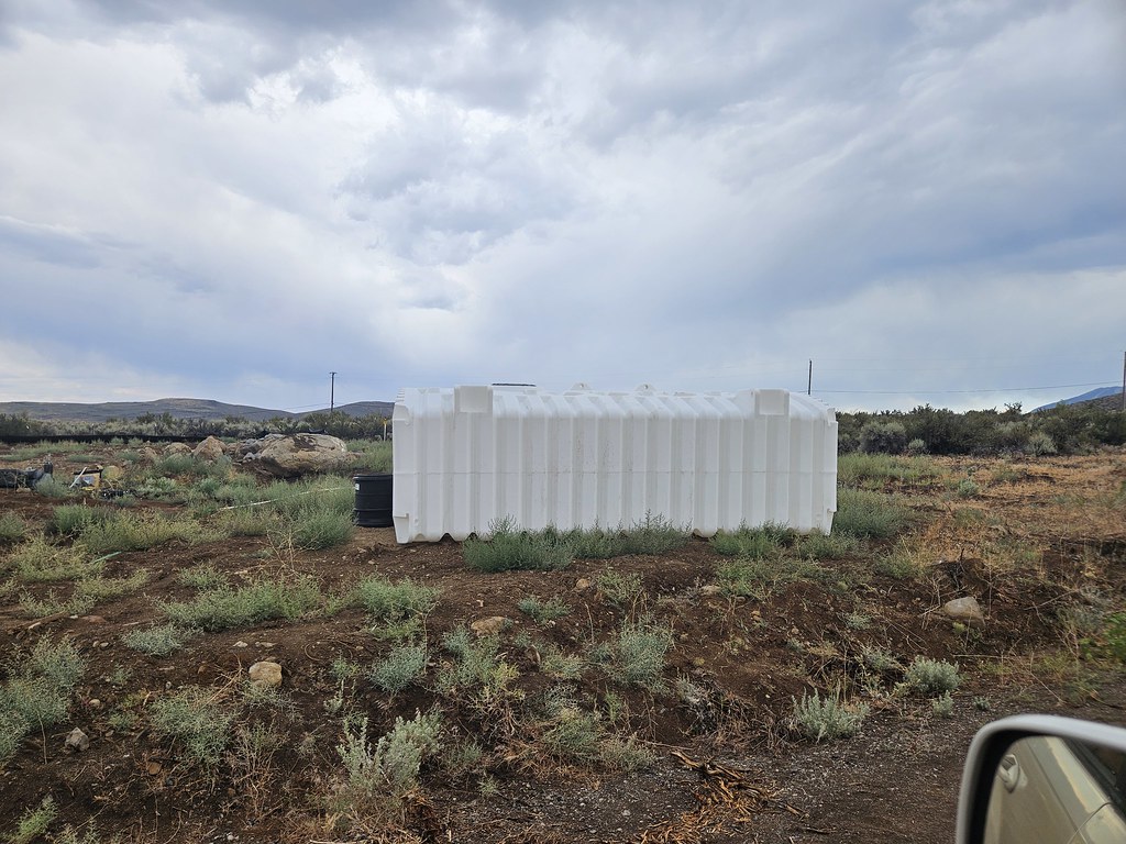

5000g water tank. This thing is the size of two Landcruisers. That is going to be a big hole in the ground.
Coming along nicely. So you have to truck water in? I assume a well would be prohibitively deep in that location?
We did drill a well, down to 600'. It produces about 12-13 gpm, which is fine for domestic use, but we also want to irrigate a 1 acre pasture. Best way to do that is with big impact sprinklers, but they use over 100 gpm each.
The well pump will fill the large tank, which will have 2 outlets. One outlet to a small variable speed pump to supply the workshop and future house, and the other feeding a large pump for irrigation.
Added bonus is that this system could be used for fire suppression. Wildfires are definitely a concern in our area.
