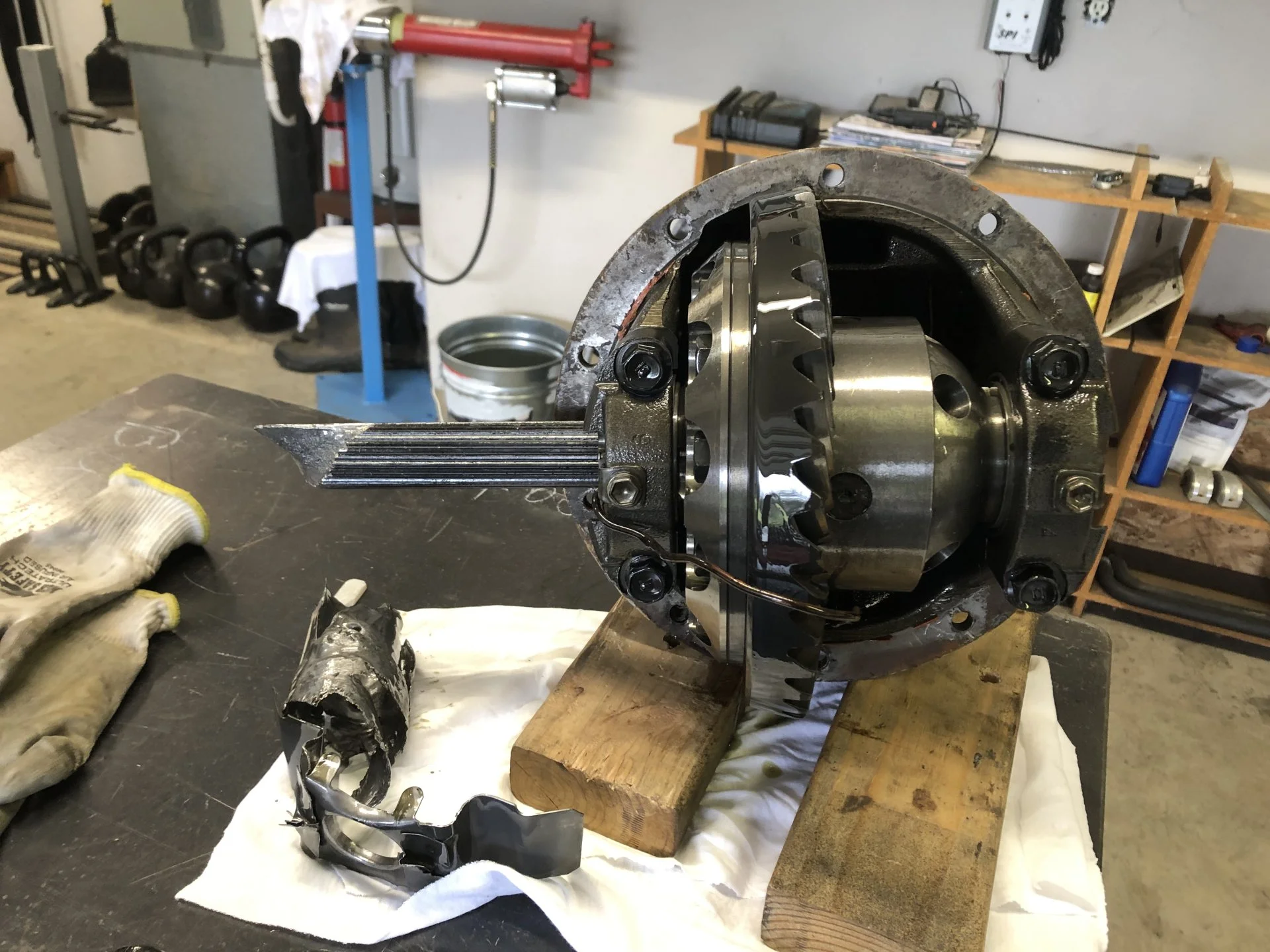

The splined end that remained in the ARB carrier wouldn’t come out with a magnet and I knew it was too long to allow me to remove the third member and I wanted to avoid chopping a hole in the axle house like others have had to do when a shaft brakes in an oem locker.
After some thinking and looking into the axle housing from the drivers end I decided to try and snake a 1/4” dia steel rod past the carrier center pin in order to drive the axle piece from the carrier on the passenger side. I’m happy to report that this approach did work.
With the chunk of axle laying in the housing the job became a simple matter of removing the third member for inspection and housing clean out and then reassembly.
