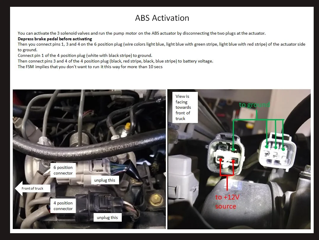

We will need to pull codes first to see if a wheel speed sensor was damaged during the first caliper replacement. Otherwise the ABS light illuminates and disables the system after 10 feet or so of rolling forward. So we can't even do that. We could however manually cycle to pump, I believe I've seen a post showing how to jump it to make it cycle for bleeding purposes.

If you need to activate the ABS system while bleeding here you go.
A screenshot of a computerAI-generated content may be incorrect.
