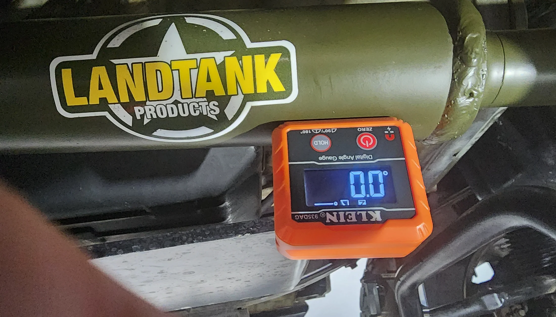

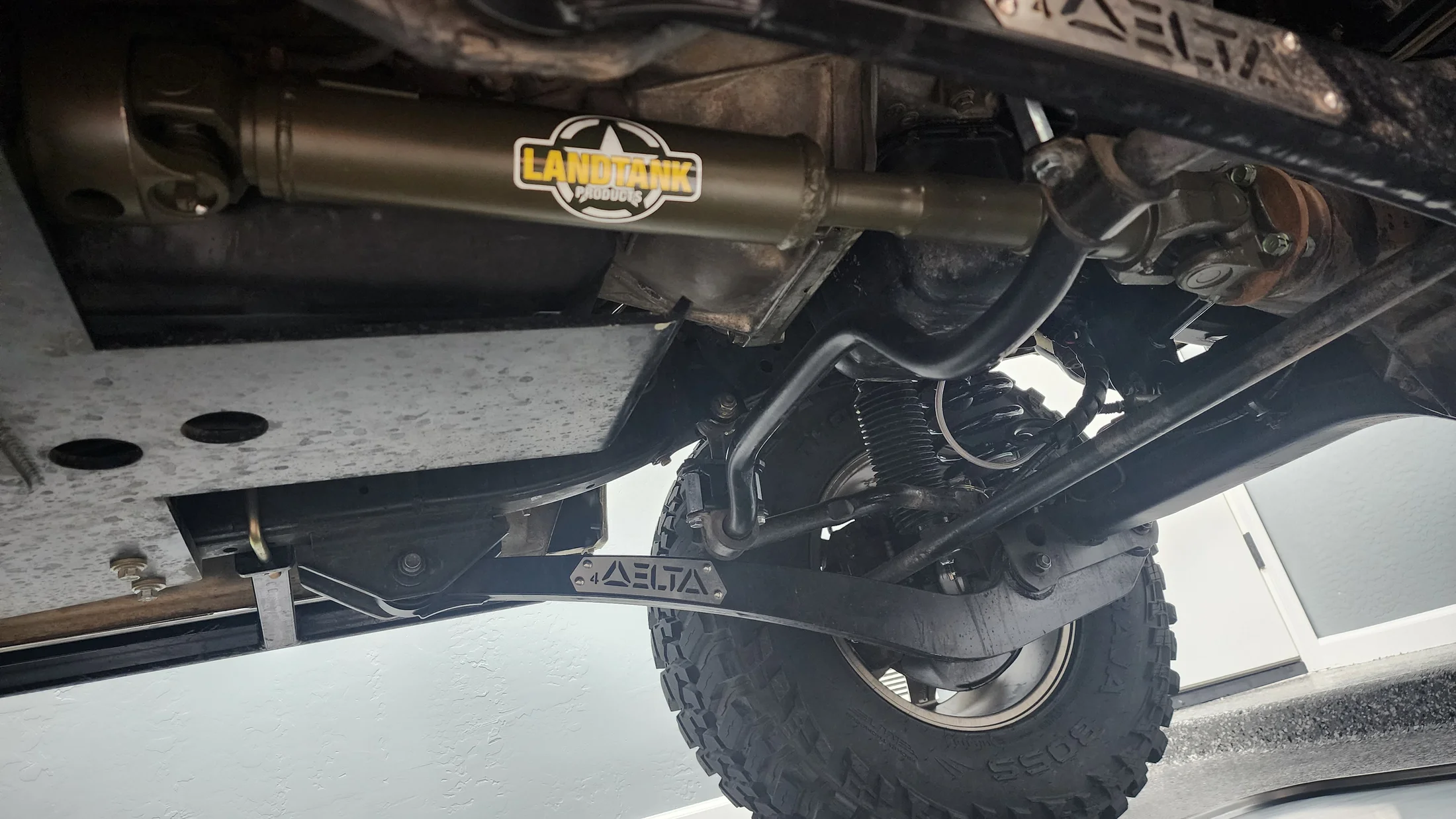

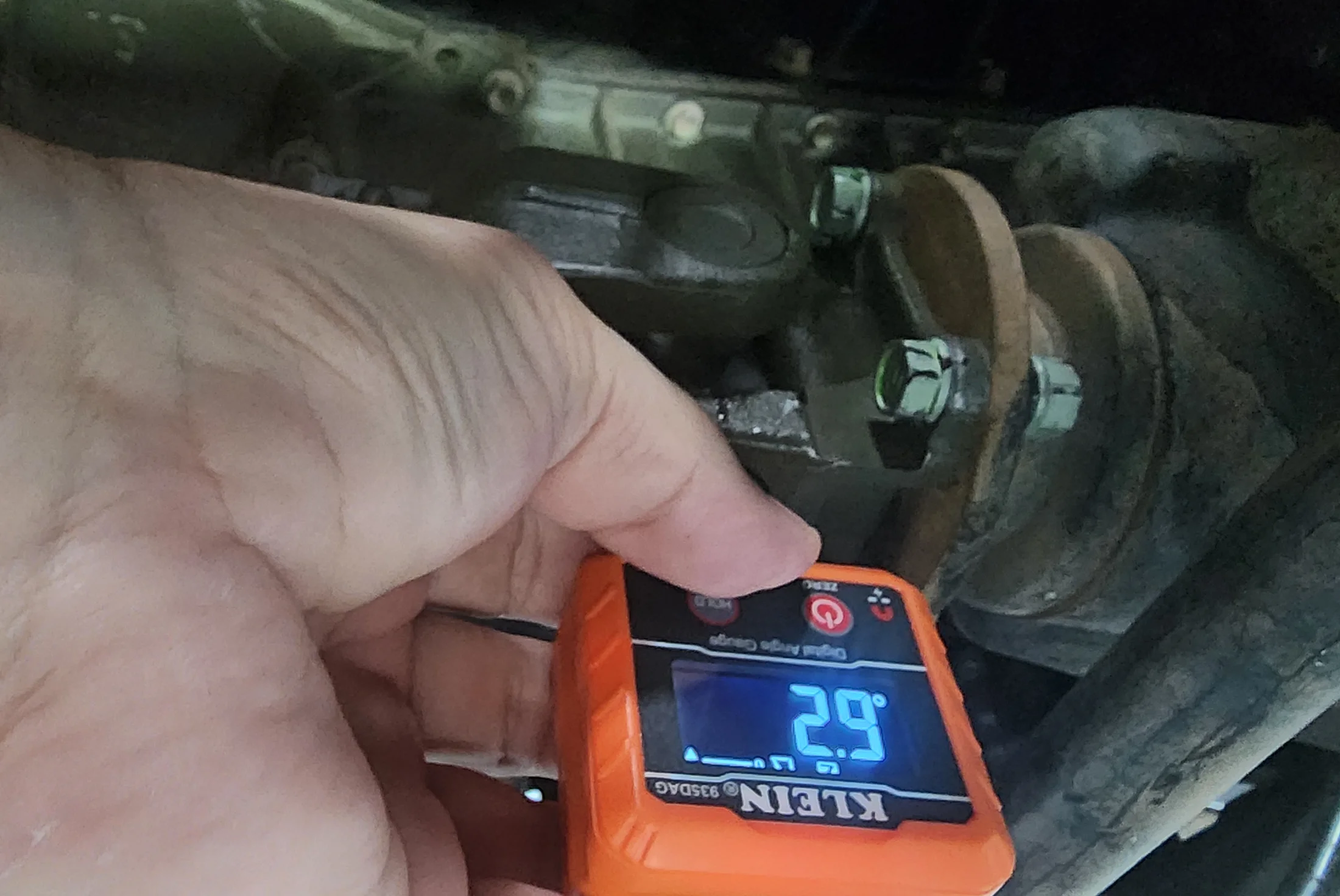

After lifting I had a drivline vibration on decel. So, went to Mr. Landtank and ordered a front DC shaft. Installed the shaft and now the growl is ever present and tad louder. So, below are the specs and what I am running into. For a short read, I have a 2.9 degree difference between the shaft and the face of the u-joint (see pics below).

To boil all that down>>> The front pinion needs to point staight at connecting (lower) shaft of DC shaft assembly. I image you do have quite the growl at 2.9* off. I was only 1.5* and I had a critical speed issue at 68-75. Under that was OK and over that was...better, but not what anyone would call good.
You need to figure out which way that 2.9* degrees is off. Does the pinion need to rotate up (closer to the engine) or down (away from the engine)?
If the pinion needs to move up you need to get closer to the stock radius arm offset. And conversly if the pinion needs to be lowered to bring it into alignment with the DC shaft you need taller lift arms.
Based on my expireance with this issue, I went from Delta 4 arms to Delta 2 arms to fix my miss-aligment.
My 4” caster plates aligns for a DC shaft within a 1/2 a degree. The plates rotate the axle 7 degrees.
I’d put the stock arms back in and take those measurements again.
If the reading is around 7 degrees the arms are the problem.
If the reading is greater than 7 and around 9 or less than 7 and around 5 you have an axle problem.
