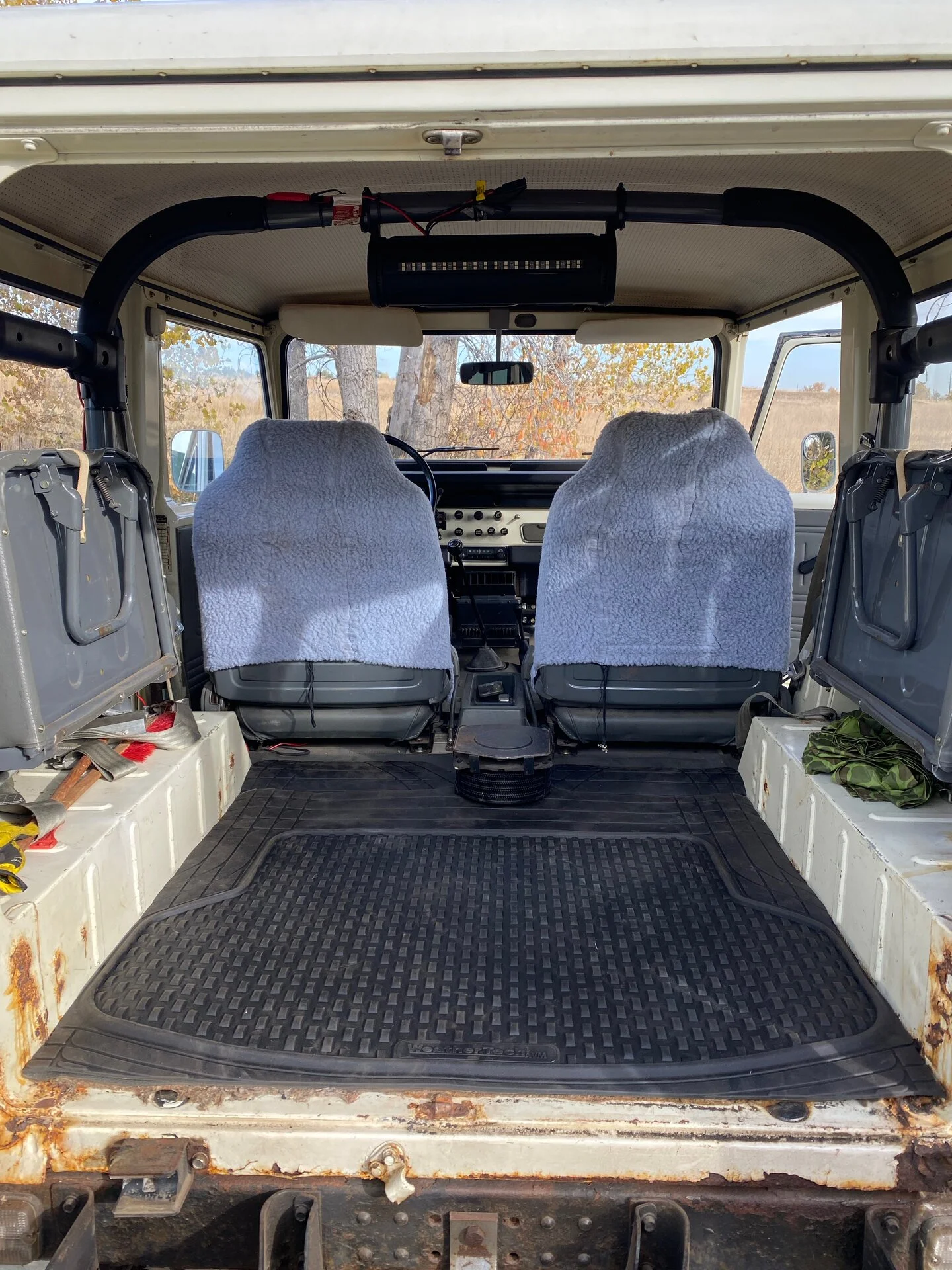

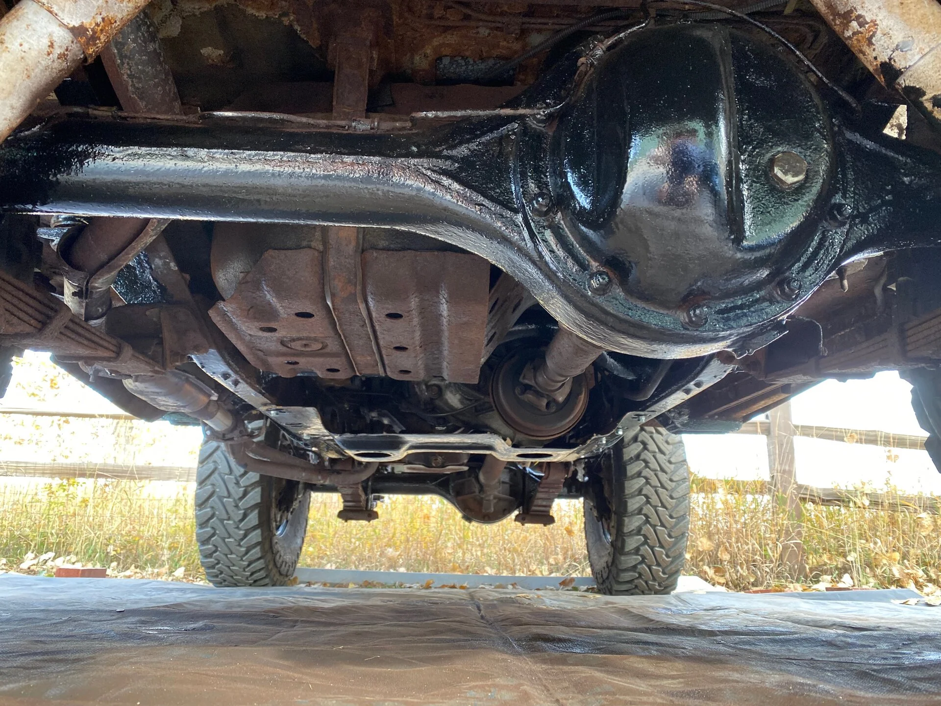

I applied POR15 to a little more of the frame and the axles, as well as giving it the WeatherTech treatment on the inside (Semi-Universal Trim-to-Fit Cargo/Trunk Mat | WeatherTech - https://www.weathertech.com/trim-to-fit-cargo-mat/ and Trim-to-Fit Semi-Universal Car Floor Mat | WeatherTech - https://www.weathertech.com/trim-to-fit-floor-mat/). Next I am contemplating dealing with the loose drag link and idler arm, before I have a lift kit installed.

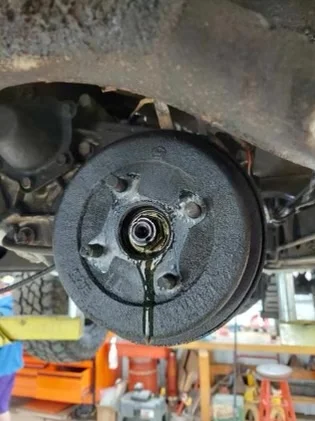

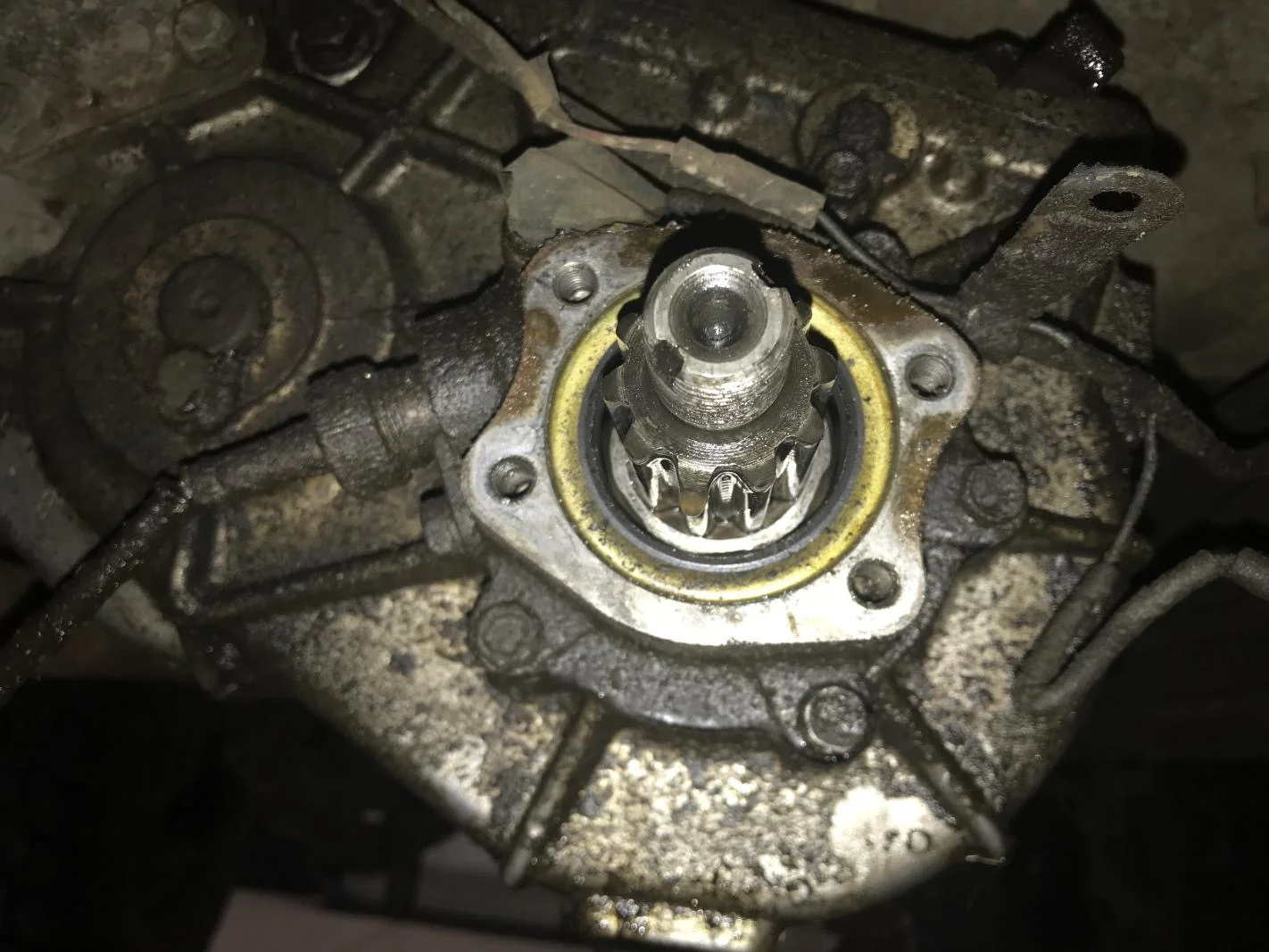

The speedo housing sits behind your Ebrake. 1st pic is the “indicator” that the seal is compromised.
2nd pic shows the housing and the speedo cable. Note the seal. A dual seal housing is machined to accept 2/dual seal(s).

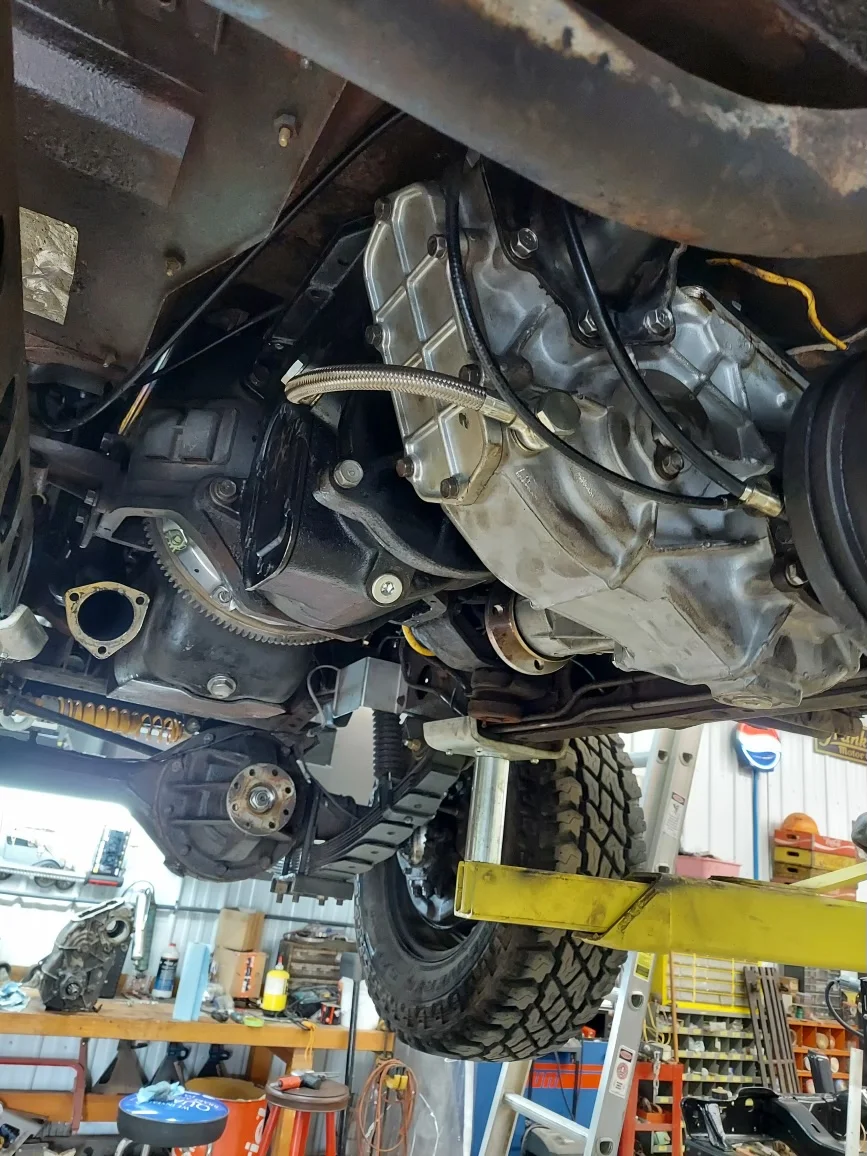

3rd pic. Note the stainless hose connected to the TCase and transmission. “Insurance policy”. This one came from @shipmag. “When your Transfer Case seal fails, oil is transferred to the transmission causing the oil to drain from the transfer case and overfill the transmission.
Edit: 4th pic is a side by side comparison of the stock and modified housings. You can see the deeper seat in the housing on the right (dual seal).
The Speedo housing houses the seal before the parking brake. This is area commonly leaks. You can get a dual seal housing where, if I understand correctly, the Speedo housing has been modified to fit a dual seal which should eliminate leaking from your parking break.

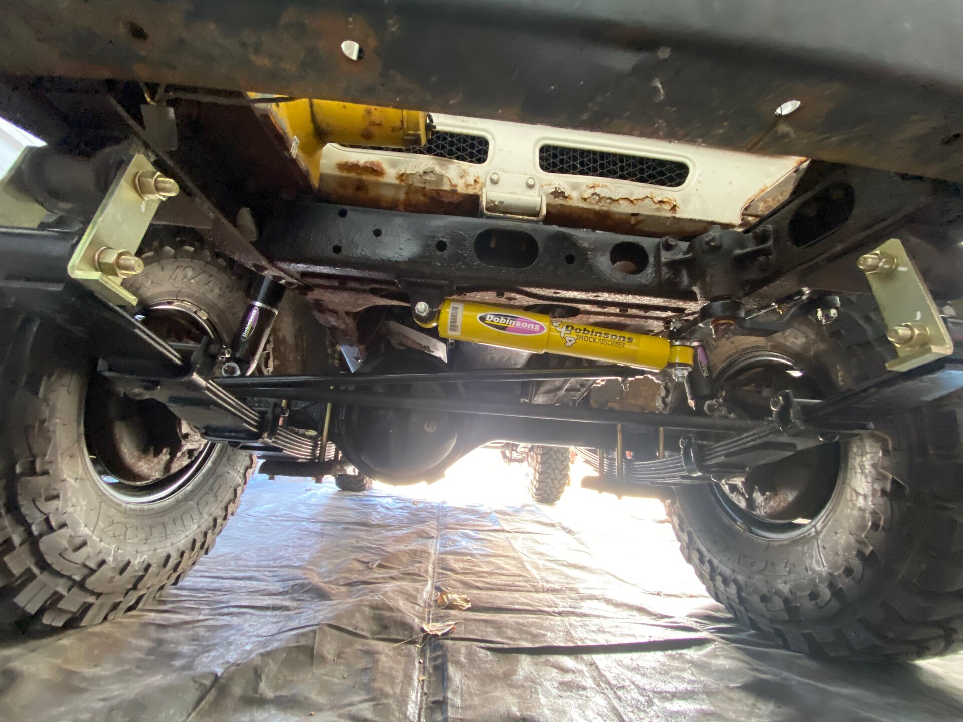

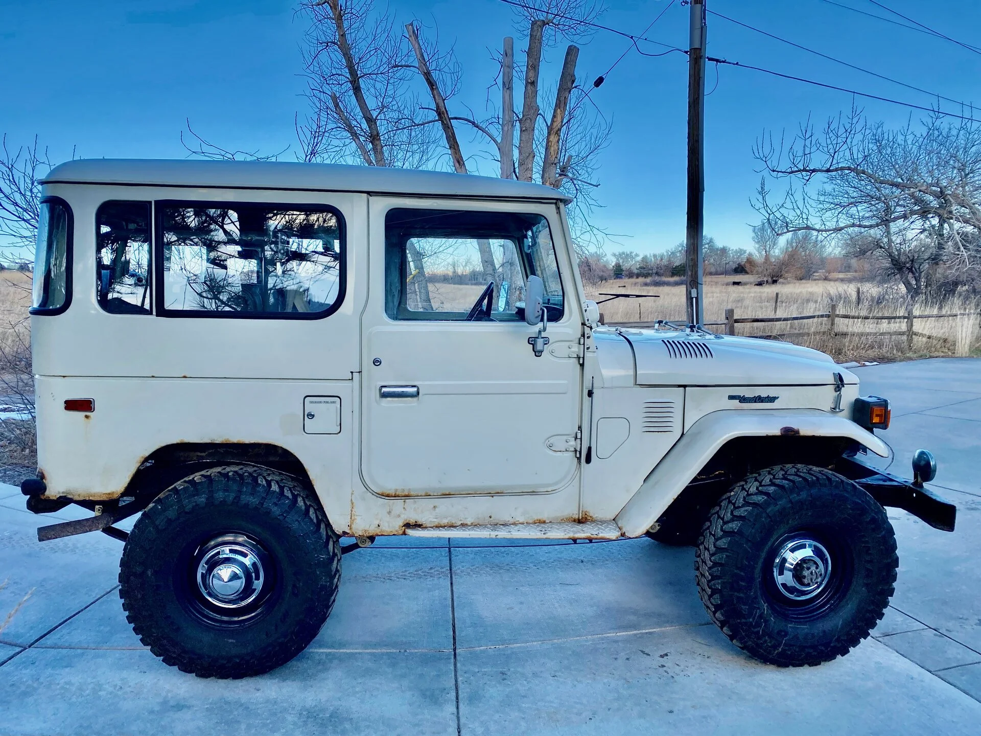

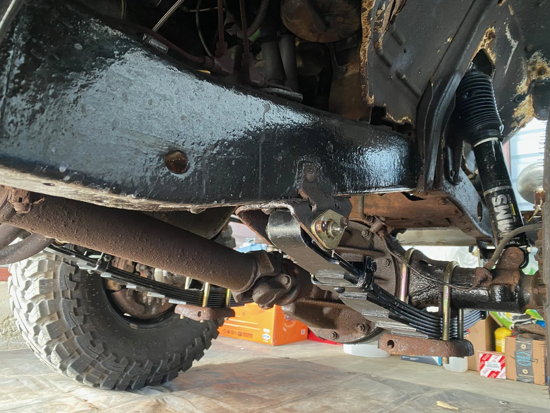

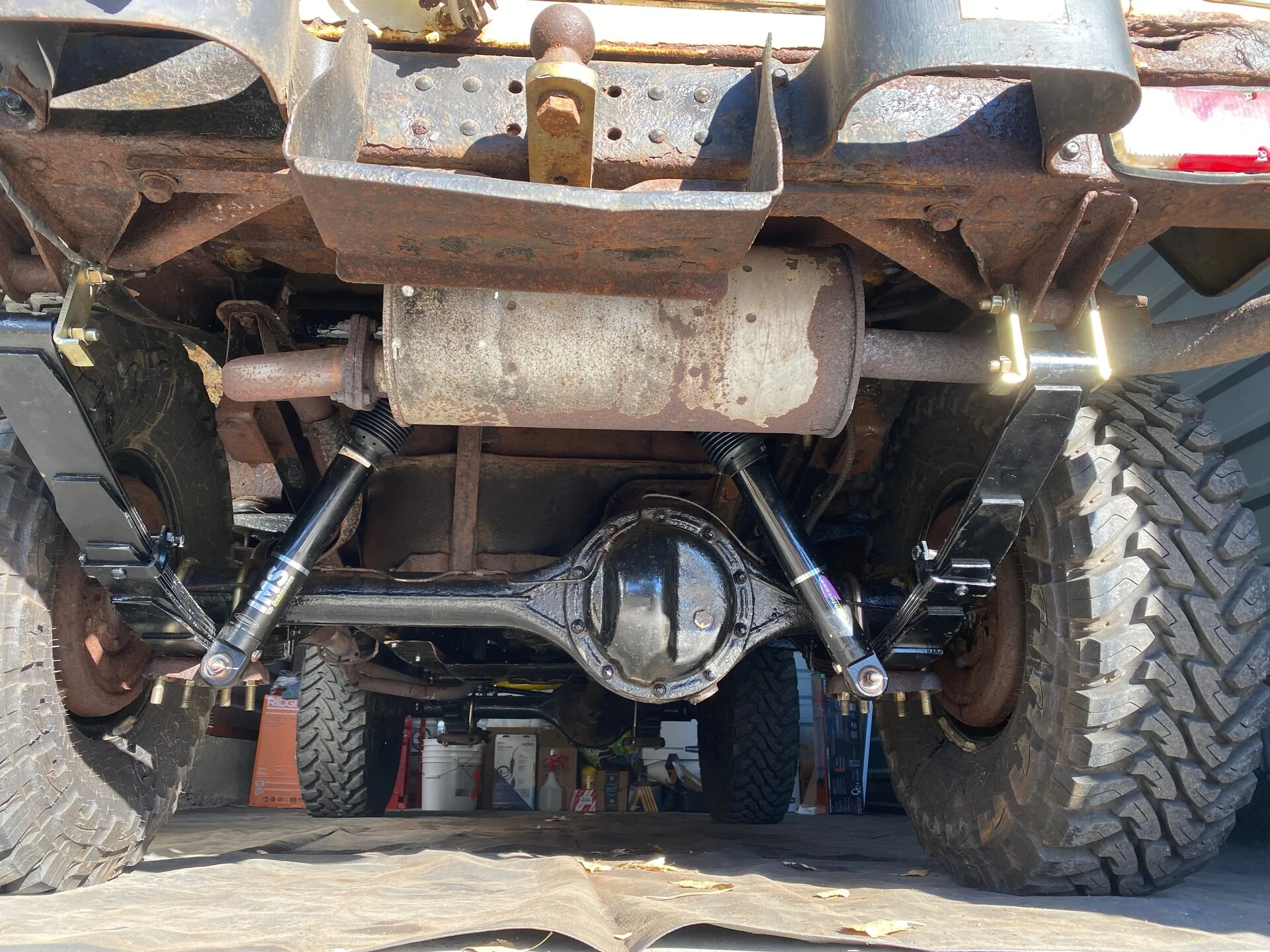

Had a Dobinsons 4x4 Full 2.0" IMS Suspension Kit installed and replaced the steering components. Also had to replace the brake master cylinder in the process. I'm feeling much better with the new tires, suspension, and steering. Back to dealing with rust!
