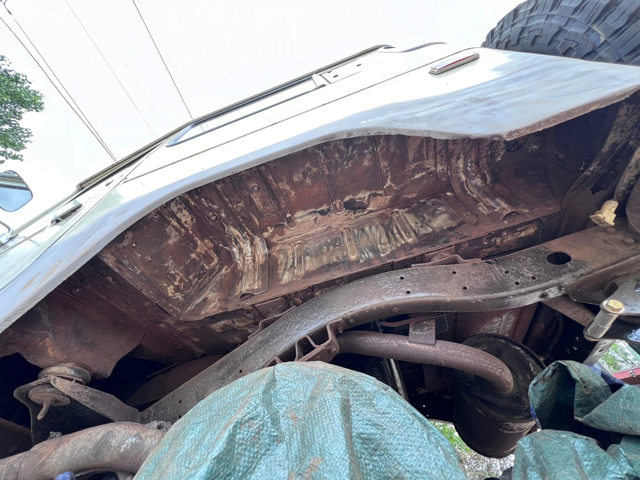

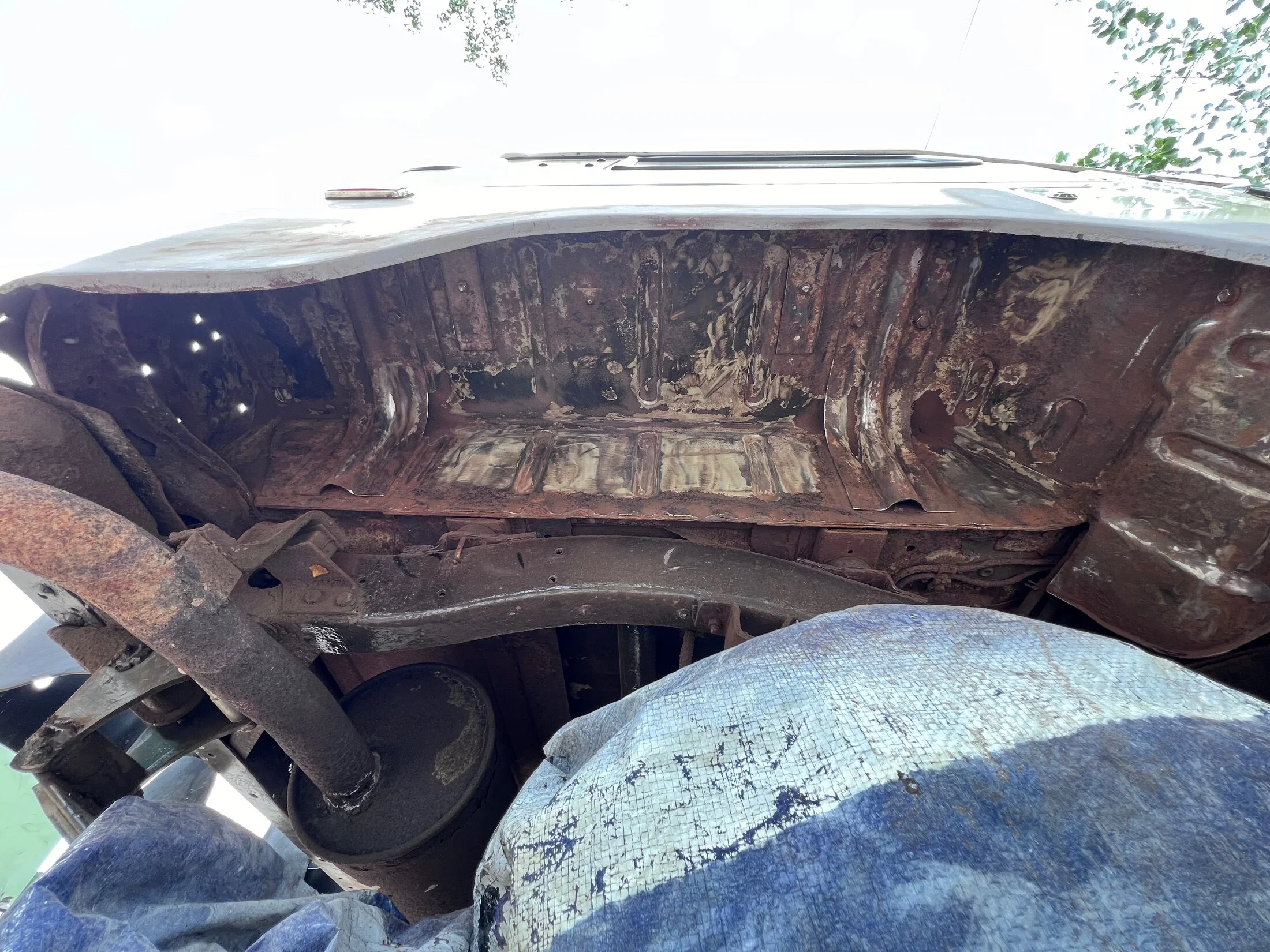

@43bruiser Yes, I was careful to make sure that my stitch welds were cool by not making successive welds in the same area and I used an air compressor to cool them between welds. It took me a while to dial in my settings. I started with .030" wire, but had more success with .023 wire. My biggest challenge was where I had gaps between the body and patch that I wasn't able to bridge with a weld. Also the body was thin in a few spots where I just blew through. I would recommend you take time to make sure your patch and body fit together as closely as possible all along the seam. The results will look better and your welding will go smoother.

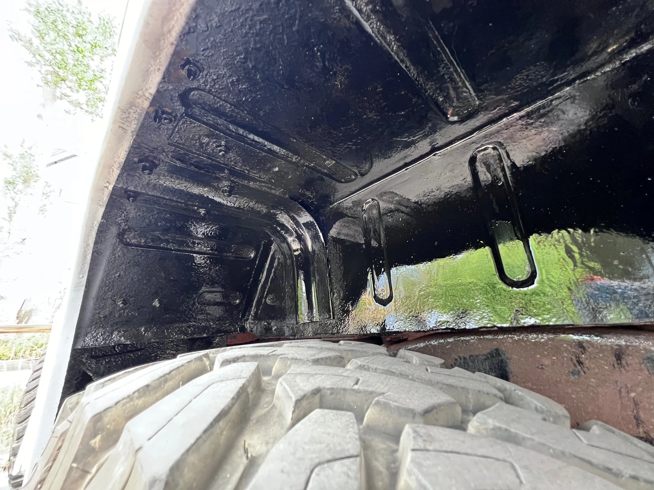

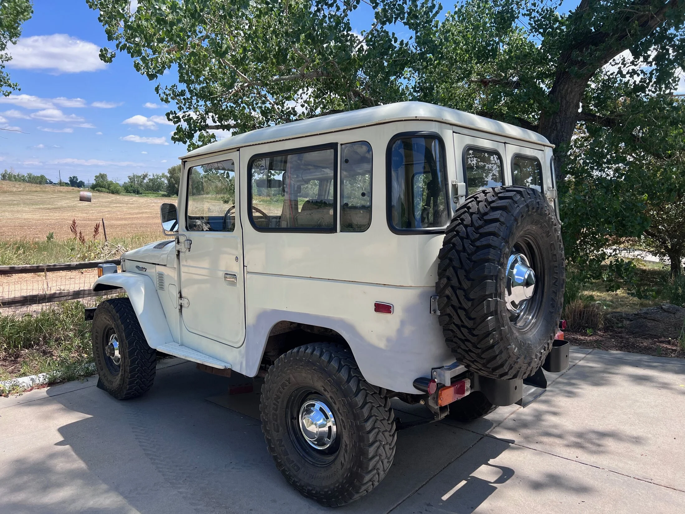

Once I have the rear tire wells cleaned out and apply a couple coats of POR15, I’ll feel like it’s a major milestone. Body rust largely dealt with and much of the undercarriage coated with POR15.
All the parts (emblems, reflectors, and tire carrier) back where they belong. Ground the rust and debris from the rear tire wells in preparation for the POR15 treatment.

@BrownWolf terrific! It looks great and those issues are way behind you now. 👏 👏 👏
