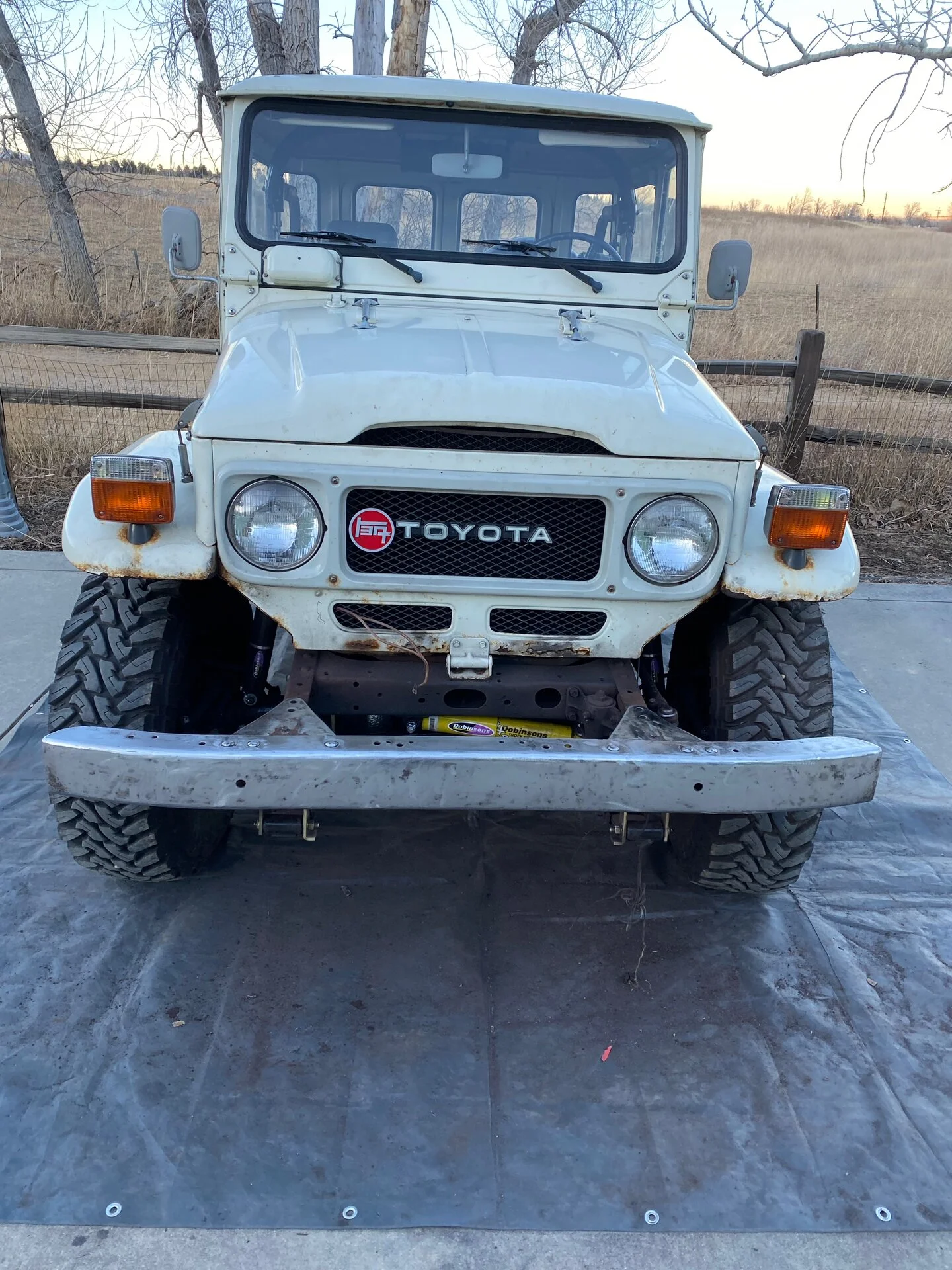

Finished with the front and rear bumpers. Removed all the parts from them, ground off the rust, then primed and painted them. Unfortunately, I sheared off all save one of the bolts on the rear bumper taking the bumperettes and step off. Thank goodness I had one from which to get the correct replacement bolts, as well as the tap necessary for when I drilled out the seven other sheared off bolts.

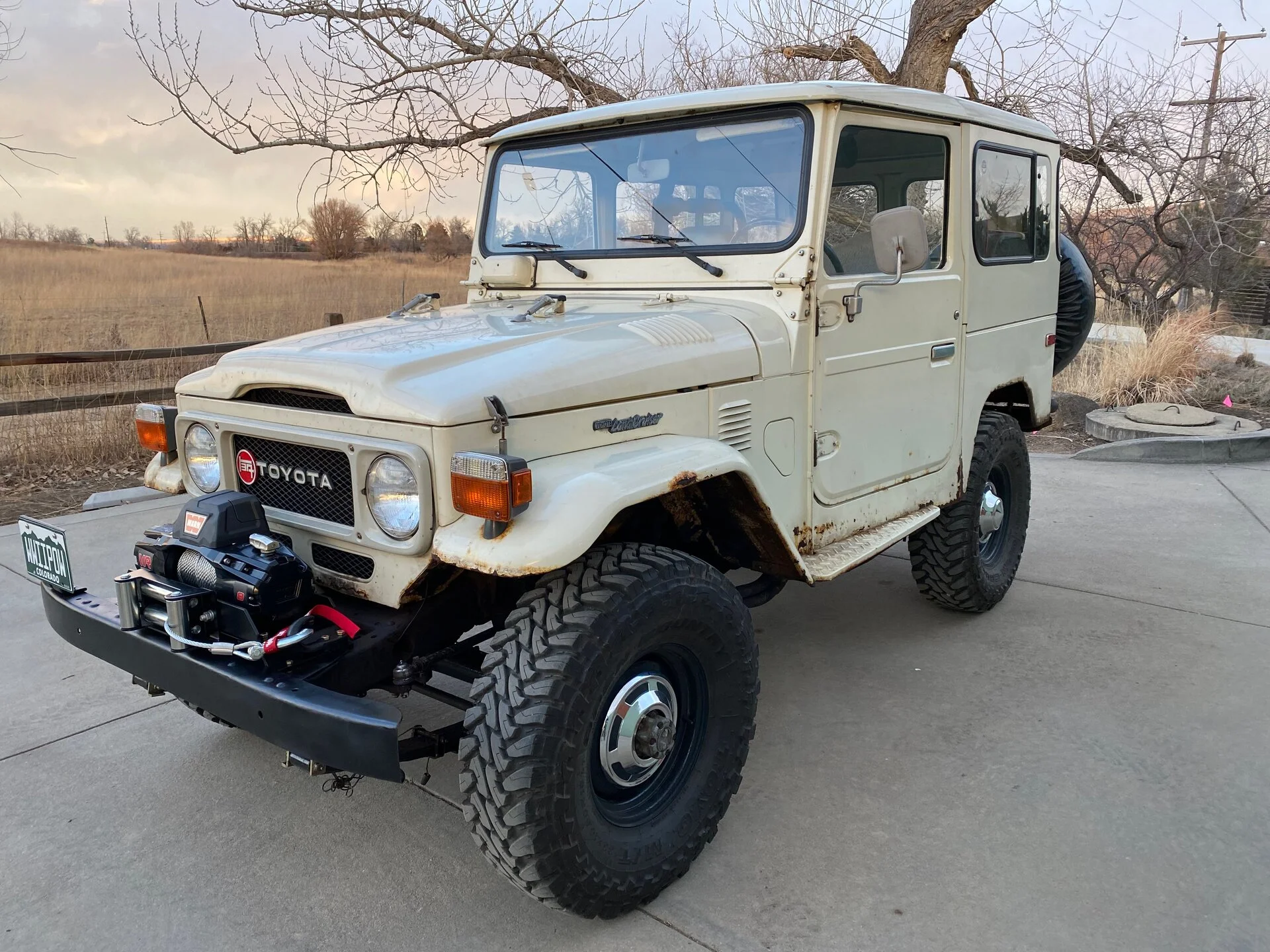

To replace the old baby winch my brother-in-law installed god only knows when, I ordered a Warn Style Planetary Winch Mounting Bracket Kit for 1958-1984 4x-Series Toyota Land Cruisers - BTB Products - Land Cruiser Restoration and Parts - https://btbprod.com/product/fj40-fj43-fj45-bj40-bj42-bj43-hj47-winch-mounting-bracket-kit-for-warn-style-planetary-winch-1958-1959-1960-1961-1962-1963-1964-1965-1966-1967-1968-1969-1970-1971-1972-1973-1974-1975/ and a VR EVO 8 Winch - 103250 - https://www.warn.com/vr-evo-8-103250. I got a good deal on the VR EV0 8 Warn winch as they were having an end-of-the-year $150 rebate program on top of the already marked down price listed on their website. I can't wait to install them once they show up.

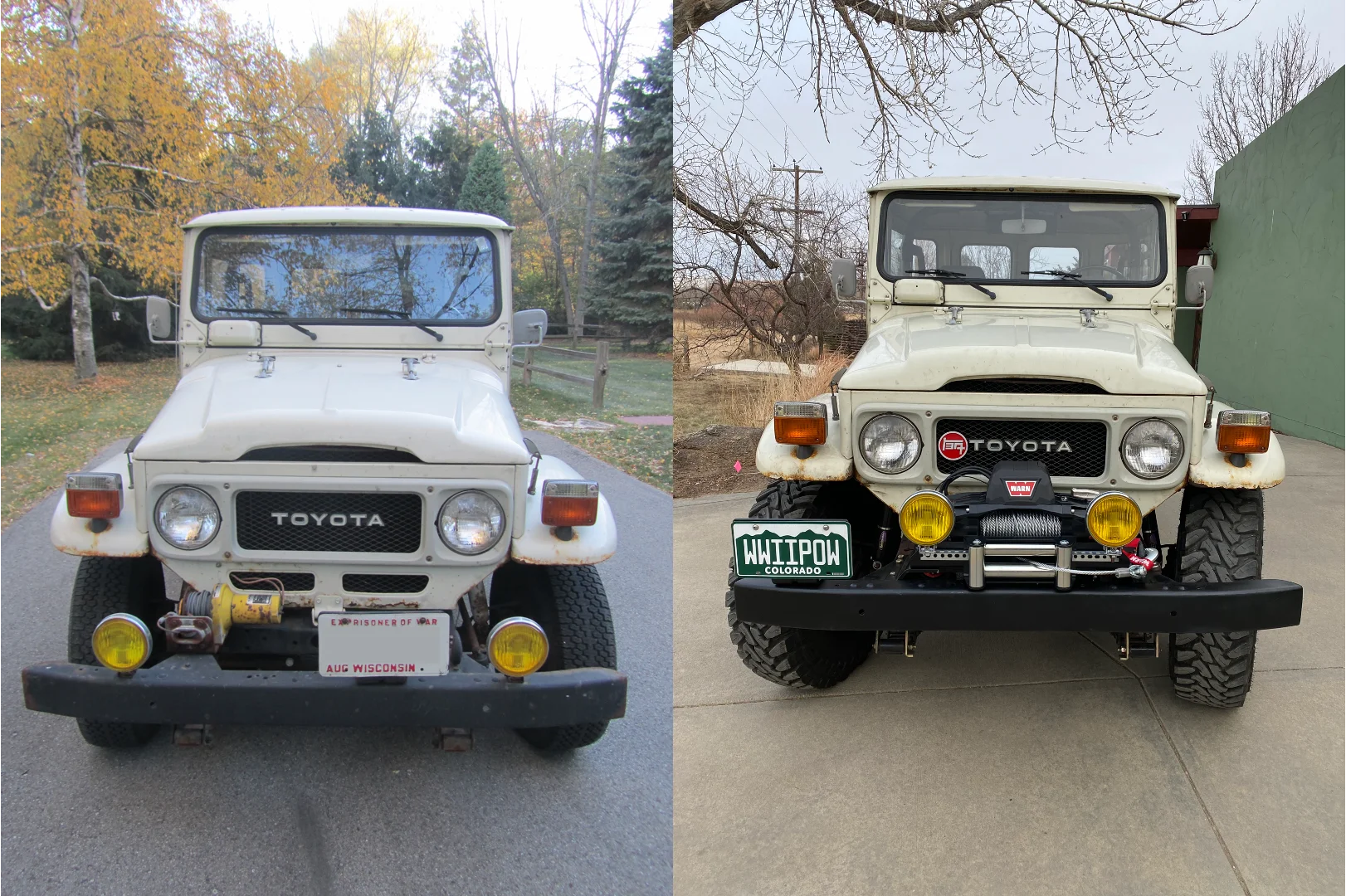

Relocated the license plate to make room for the new winch. Photos are in reverse chronological order.
New Year's Resolution - Finish POR15 treatment of the undercarriage and maybe, just maybe get started on the body!
The winch and mounting plate arrived. Very straightforward to install. I just need to get a couple of longer bolts to accommodate the tow hook.

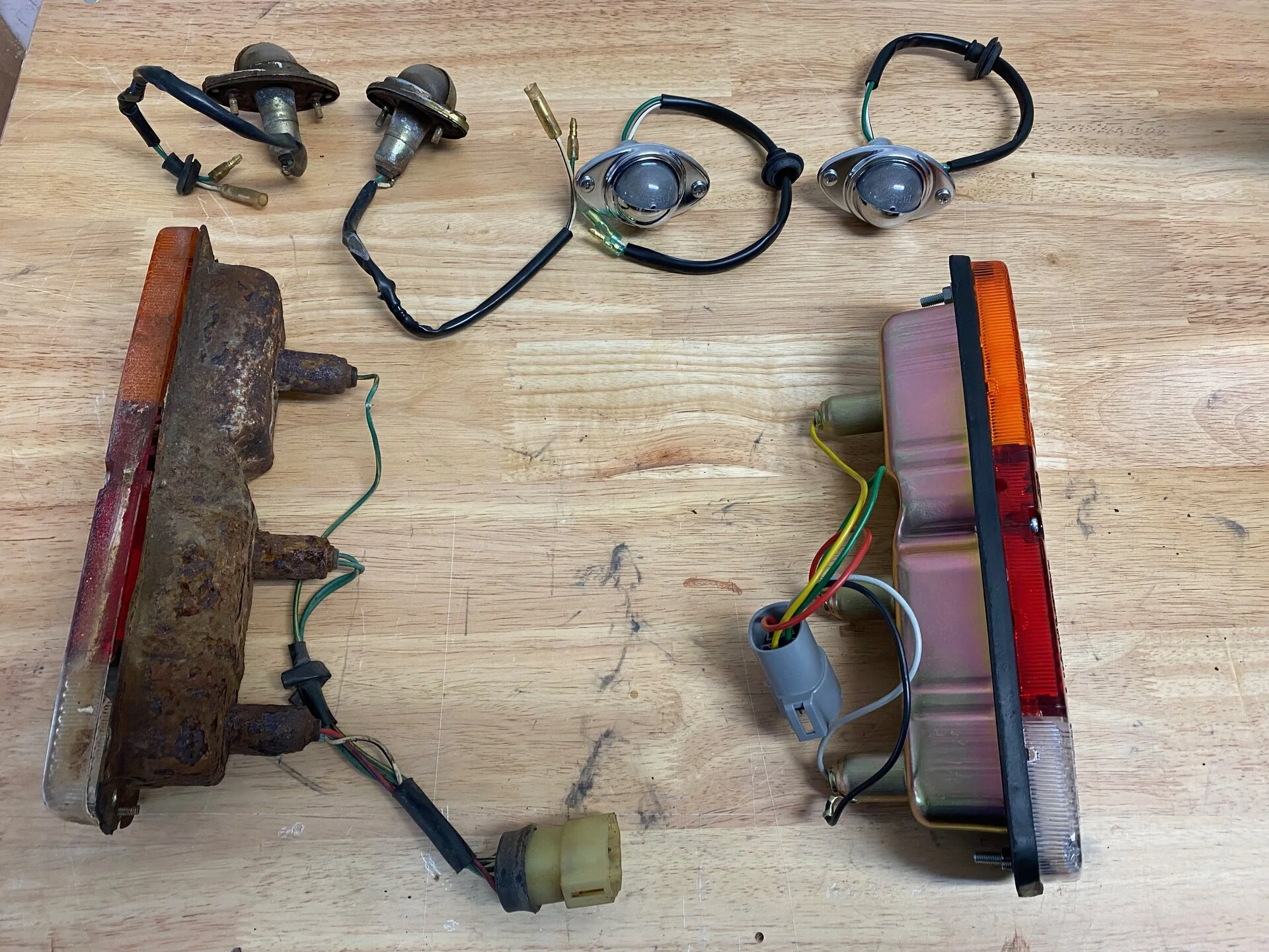

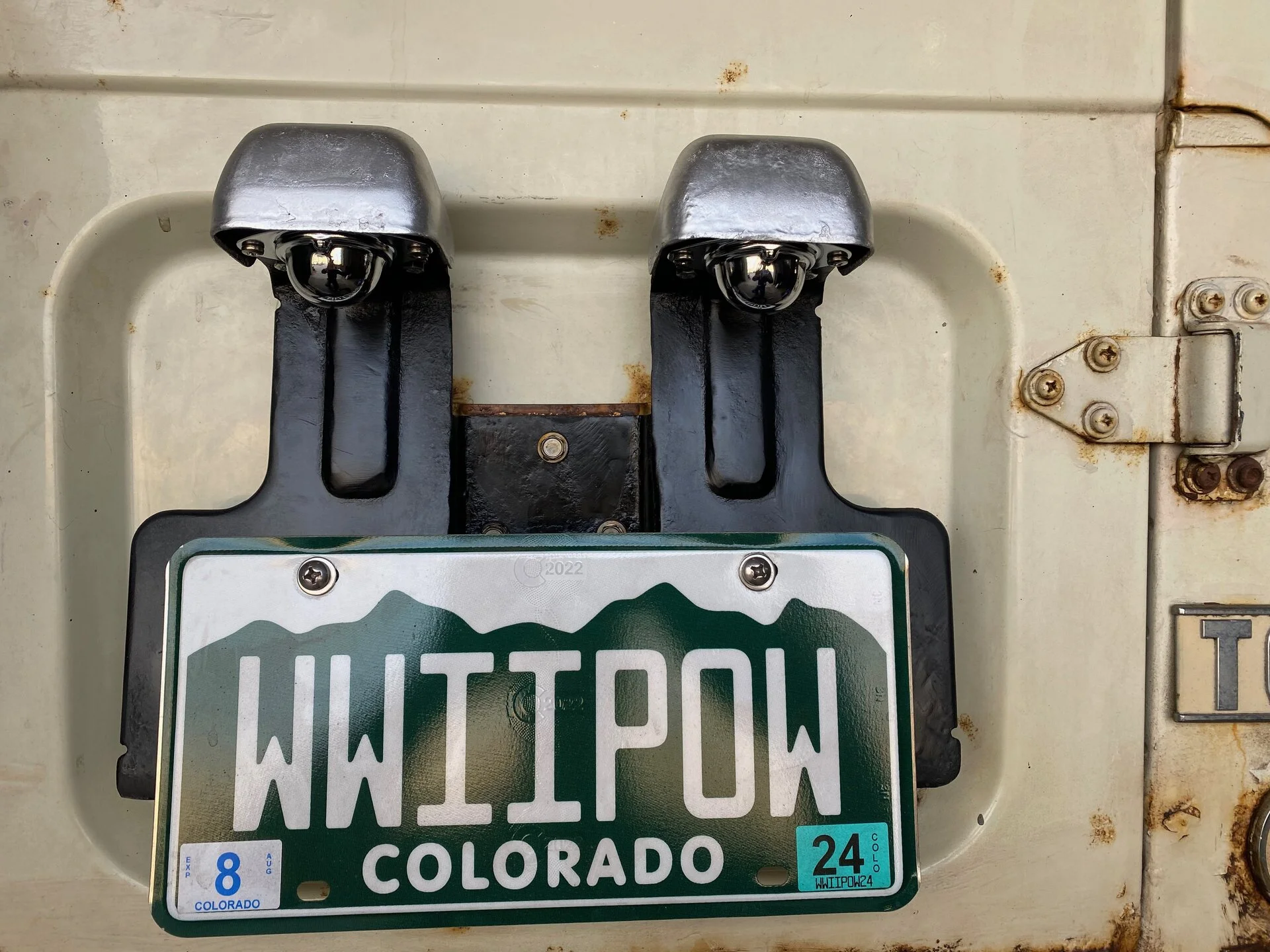

I also received taillight assemblies (they were hard to find, finally found them on amazon) and license plate lights. They both definitely needed replacing! Good thing I read the reviews on the taillight assemblies, as someone commented that the wiring of the connector wasn't correct. Got out the multi-meter and buzzed out the old and new connectors. Rewired the new taillight assemblies using the old connectors, as the new connectors were kind of cheap and rather brittle.
Things are looking good!
I was a little stumped because I was planning to reinstall the amber fog lights on the front bumper. However, when I installed the new winch I had to relocate the license plate to where the fog lights were originally, so now where to put the fog lights? I eventually figured out that I could mount them on either side of winch rollers by attaching a stand-off to where the winch rollers are mounted and then attach the lights to the stand-off.
Here's a before and after picture. It's starting to show a little more attitude!
Actually if your going for the stock location for the front plate…you nailed it !
I couldn't see anywhere else to mount it and still use the original license plate bracket. Unless I attached it directly to the bumper in the middle, but that didn't appeal to me. Glad to have accidentally arrived on the stock location! Thanks!
