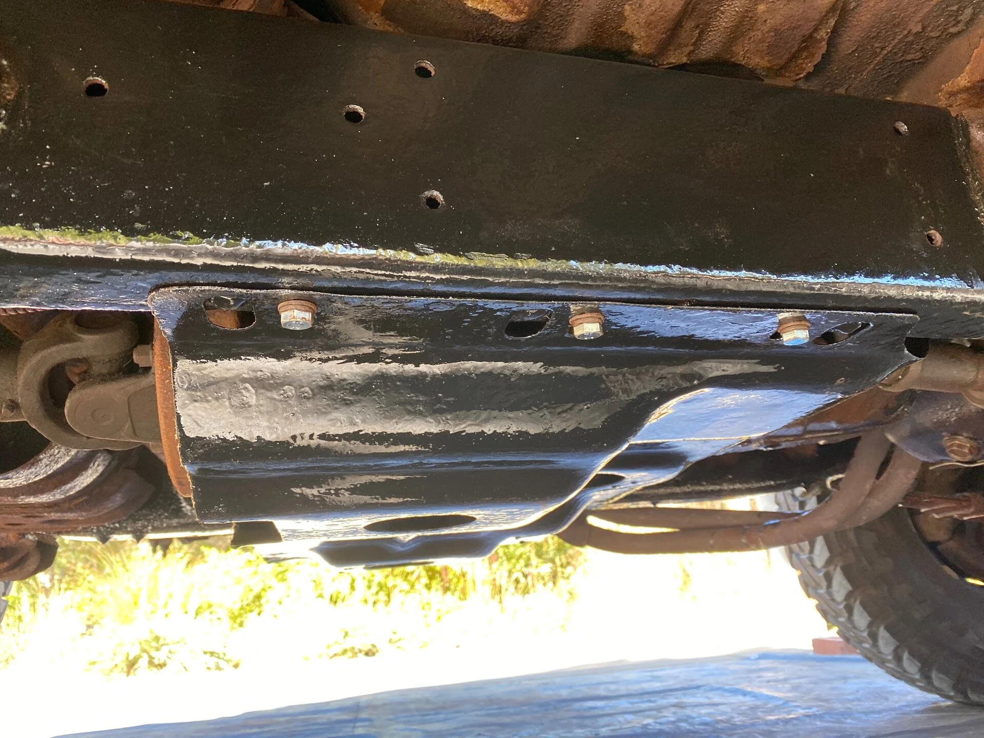

Good to hear that the POR15 treatment has significant longevity. I appreciate you sharing that with me. Did you lift the body when you did your POR15? I'm doing the best I can short of that, as I don't have the ability to lift the body. Sub-optimal for sure, but the best I can do for now. I may consider it at a later date.
Made a little progress with the POR15, but there is still a long, long way to go...
