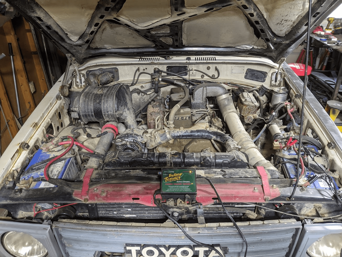

I'm stuck at the first few steps. I don't have space in the engine bay for a windshield washer bottle. As such, I'm considering relocating the batteries to the inside of the truck to gain space in the engine bay, and avoid having to run a snorkel. The air cleaner I've chosen is huge, and a pain to package, but I like the capacity. If I move the batteries to the inside of the truck, it provides an opportunity to clean up the plethora of wiring that i've added through the years, reduce some weight in the front end (not sure how much that matters) and trigger reworking the storage/sleeping system that i've been putting off for a few years.
Relocating the batteries gives me room to fit my windshield washer bottle, eliminate the need to run a snorkel, and give room for future upgrades, such as coilover struts or a second turbo.
Here's where I need some advice. Should I invest the time in relocating the batteries? I feel like it's the right thing to do for future-proofing, but want some more opinions on the matter.
Current engine bay. It seems like there's space for a washer bottle inbeween the PS battery and air cleaner, but the small bottle I ordered is too tall to fit.

The dual batteries have caused me creative positioning in the engine bay too. If you do move them you'll have a lot more room to play with under the hood that will come in handy when you get that second turbo stuffed in there! Would you plan some kind of power bar to put things on to keep things tidy? Some jump posts under the hood for convenience? I'd definitely want some kind of battery box if they are inside the cab, even like a marine kind of box.
Figuring out how to get a snorkel set up (really just want it for the cold air) in my configuration has left me continually head scratching. It looks likely that I'll go through the hood than out the fender but I still don't know. Love your air filter so I'd certainly want to keep that.
For future proofing moving the batteries will also allow space for a bigger radiator if that becomes a need with compounds, AC, and power. It became necessary for me.
To call this ask out, should I invest time in relocating the batteries? It feels like the right thing to do, but I'm asking for some advice to make sure I don't regret doing it later.
I like the idea of the engine battery as close to the starter as practical, I'm currently working on a LiFePO4 Battery for my “house” battery that will weigh about 20 pounds and have the AH capacity of both my current AGM batteries combined that can easily be put inside one of my quarter panel compartments.
She's gonna get prettied up.
I haven't figured it out yet, but I would need to have a power distribution block/bar/post setup for the alternator and starter, as well as the winch. Right now my power needs are spread out on both sides of the engine bay, so if I move the batteries, I'll probably move most of it to one side to keep it cleaner. Referring to the winch contactor, ARB compressor, fan controller, etc.
Through the hood is what I'm thinking too. Might be neat to have it sticking straight up with a canister style pre-filter.

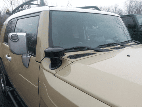

Maybe something like this? No idea. This is called the "River Raider" snorkel for jeeps and FJs. There *might* be enough room to sneak a 3" pipe through the cowl next to the wiper motor. EDIT: What the heck was i thinking. No there's not.
I'm not sure I want to get into a LiFePO4 setup in my cruiser. That's something I want for my camper build, but not for moonshine. Not looking to spend a bunch of money on this is the other factor.
With a big enough cable, i don't think an extra 3' of cable from the starter to the battery is going to make a big difference, but losses over time definitely could, so good point there.
Yup, some kind of prefilter like that has been what I've been thinking too. I'd love to get it in the cowl but I haven't figured out a way in my set up yet. Your filter is further back than mine and pretty much already enclosed so hopefully you can make it work.

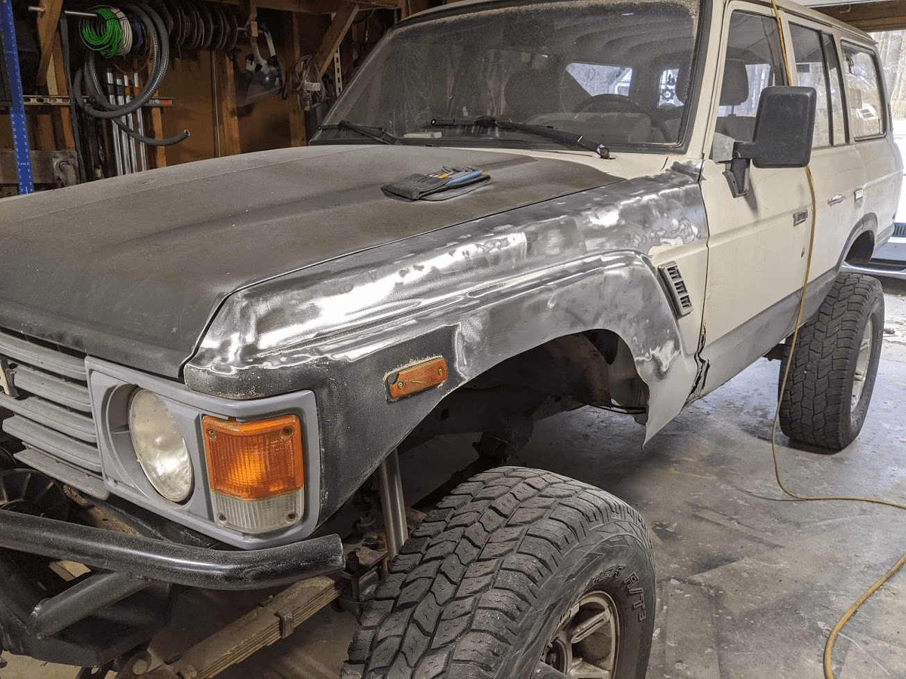

I think I'm going to work over both front fenders before I start the a-pillar work. Started straightening the DS front fender yesterday after stripping it. I've never done body work like this before, straightening bent panels that is, but it's fun so far.
