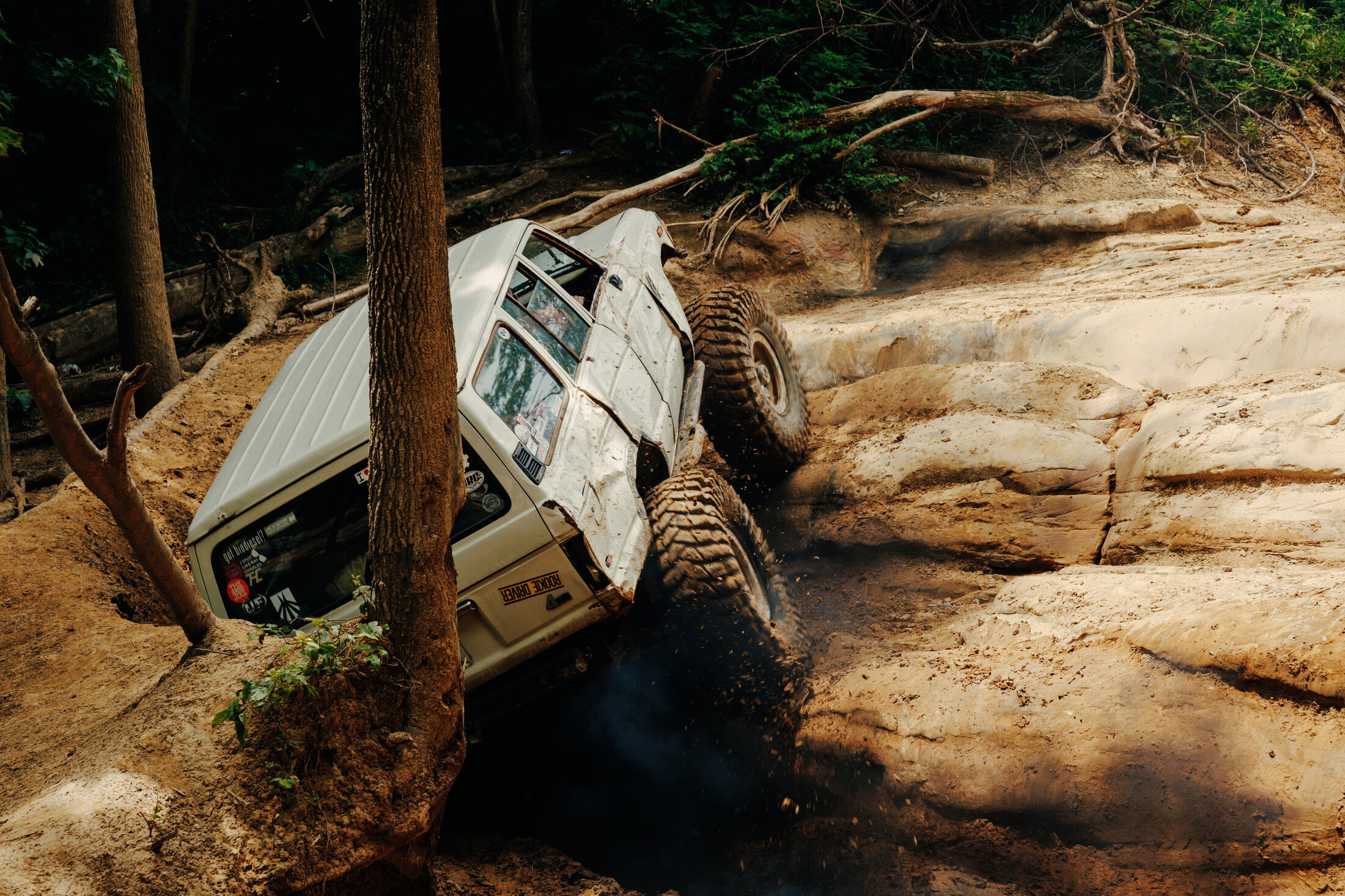

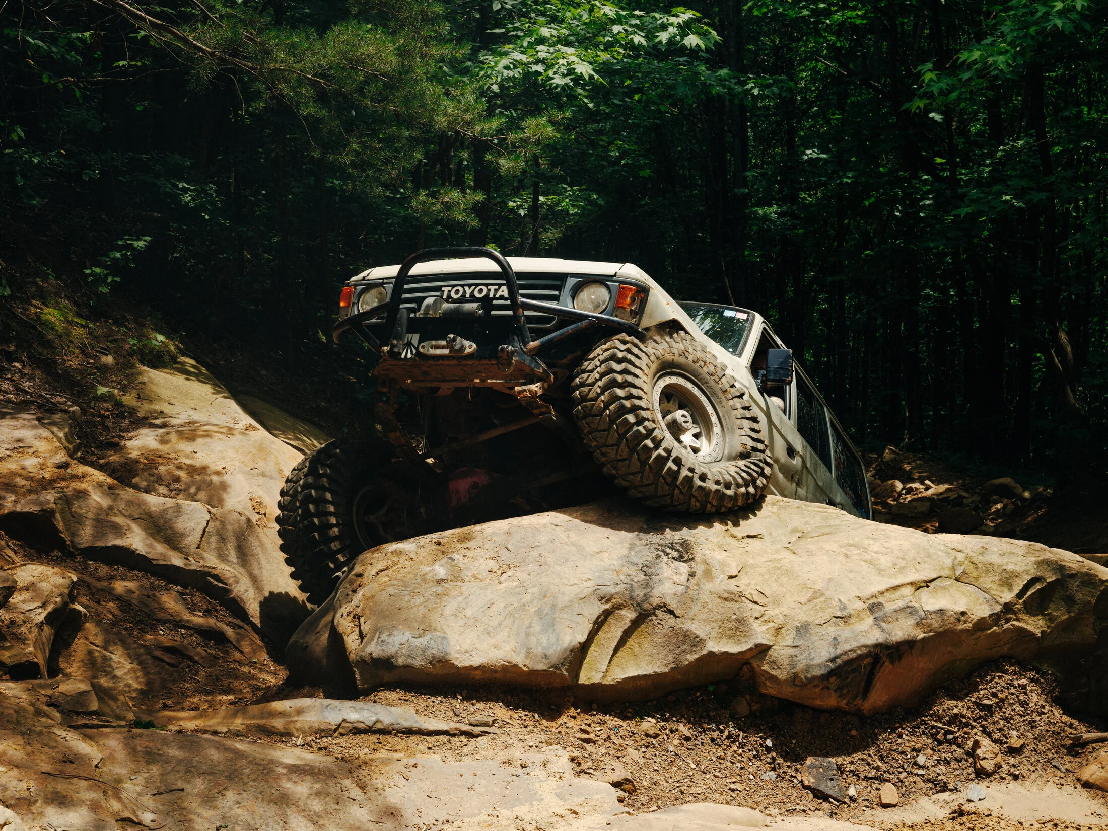

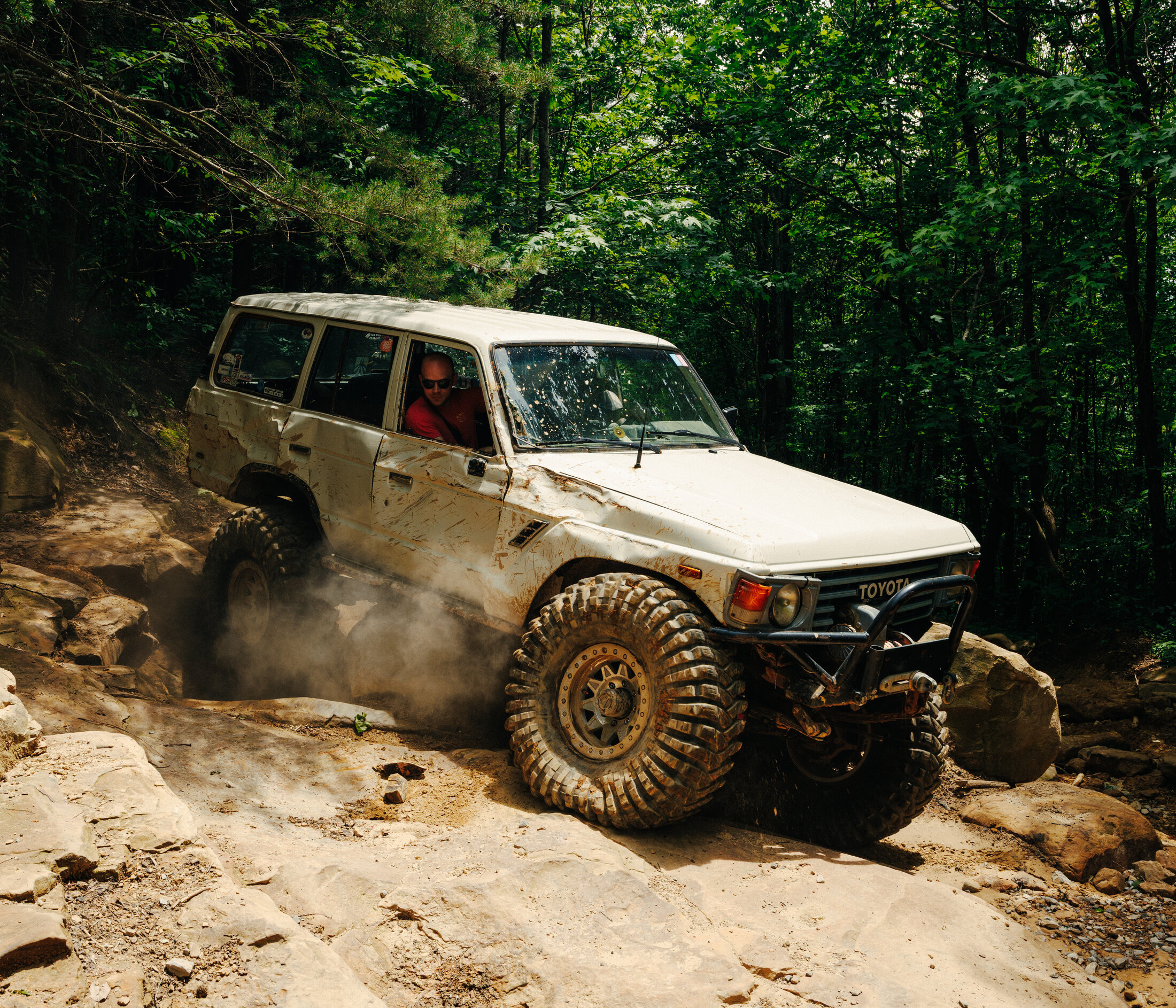

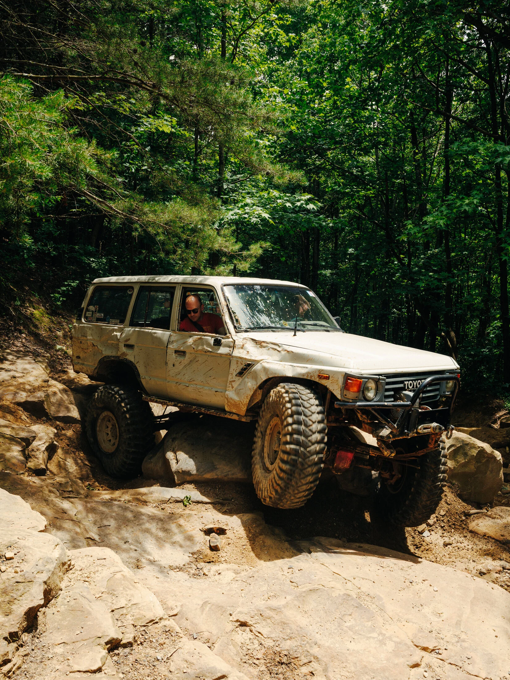

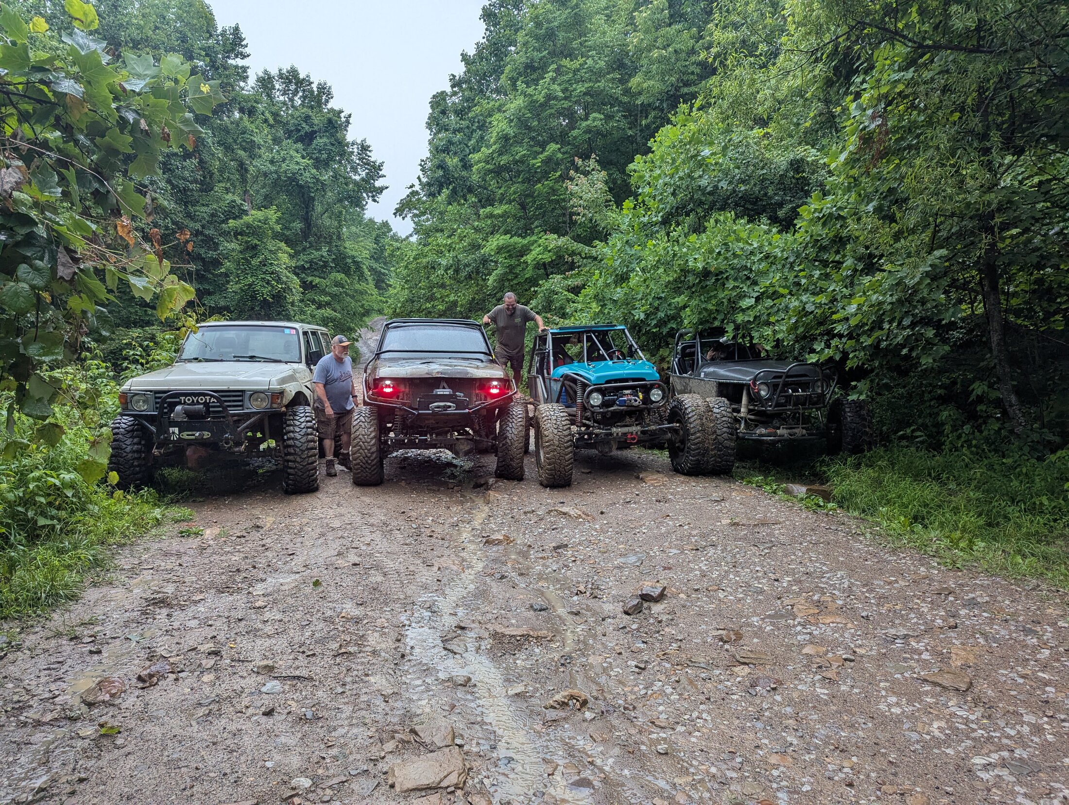

The stickies are incredible. Trail 15 at windrock took us 13 minutes, including a few minutes of ****in around on turtle rock. Did cadillac hill to rail trail too, and even though it was wet (winch fest) , the tires crushed it.
Started at 4 and 5 psi but that was too low. 7 front 8 rear was perfect.
This truck f^cks.

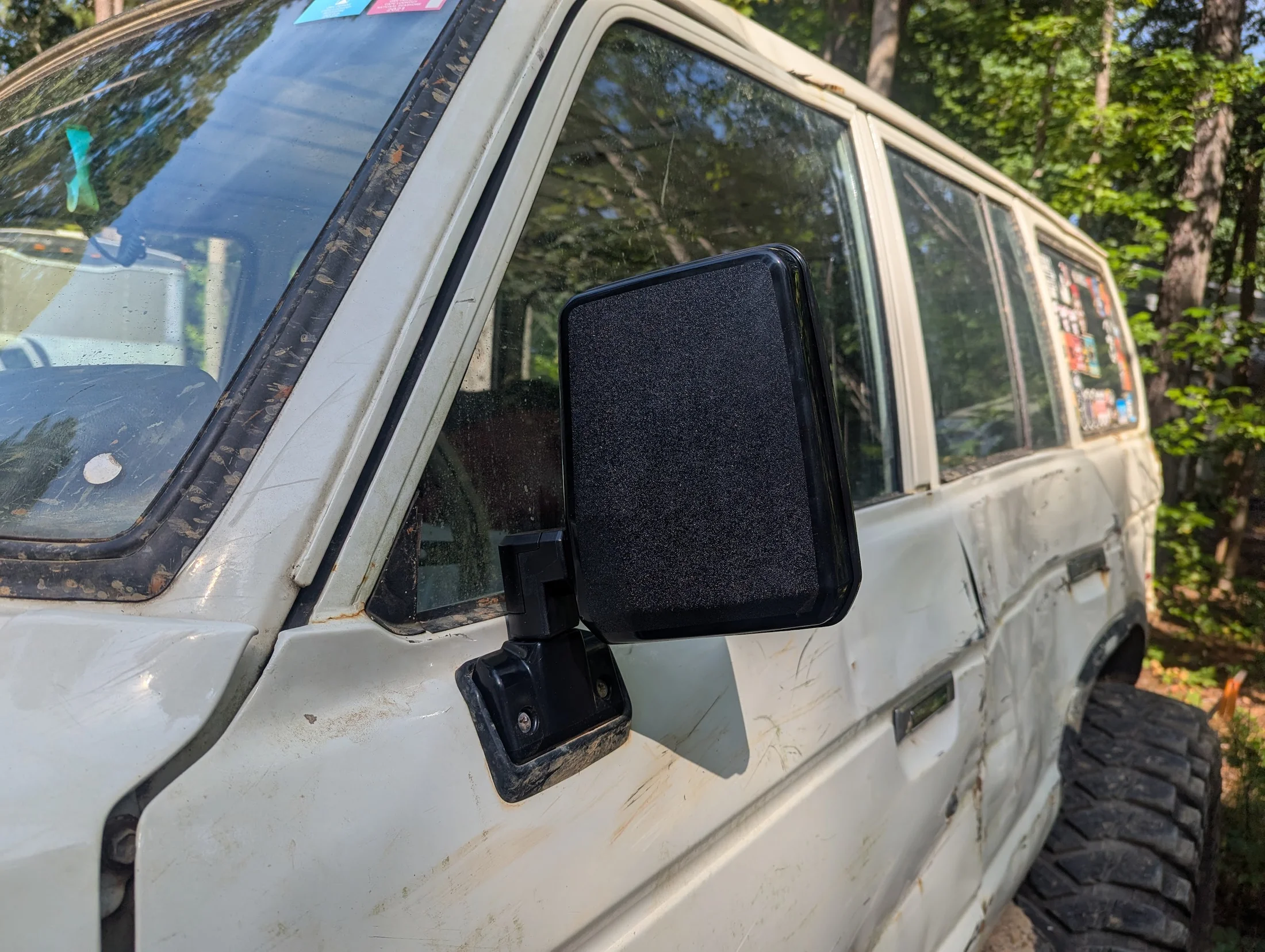

Amazon special cheap ass 70 series side mirrors, while I wait for my @cruisermatt order of OEM ones to ship from Japan.

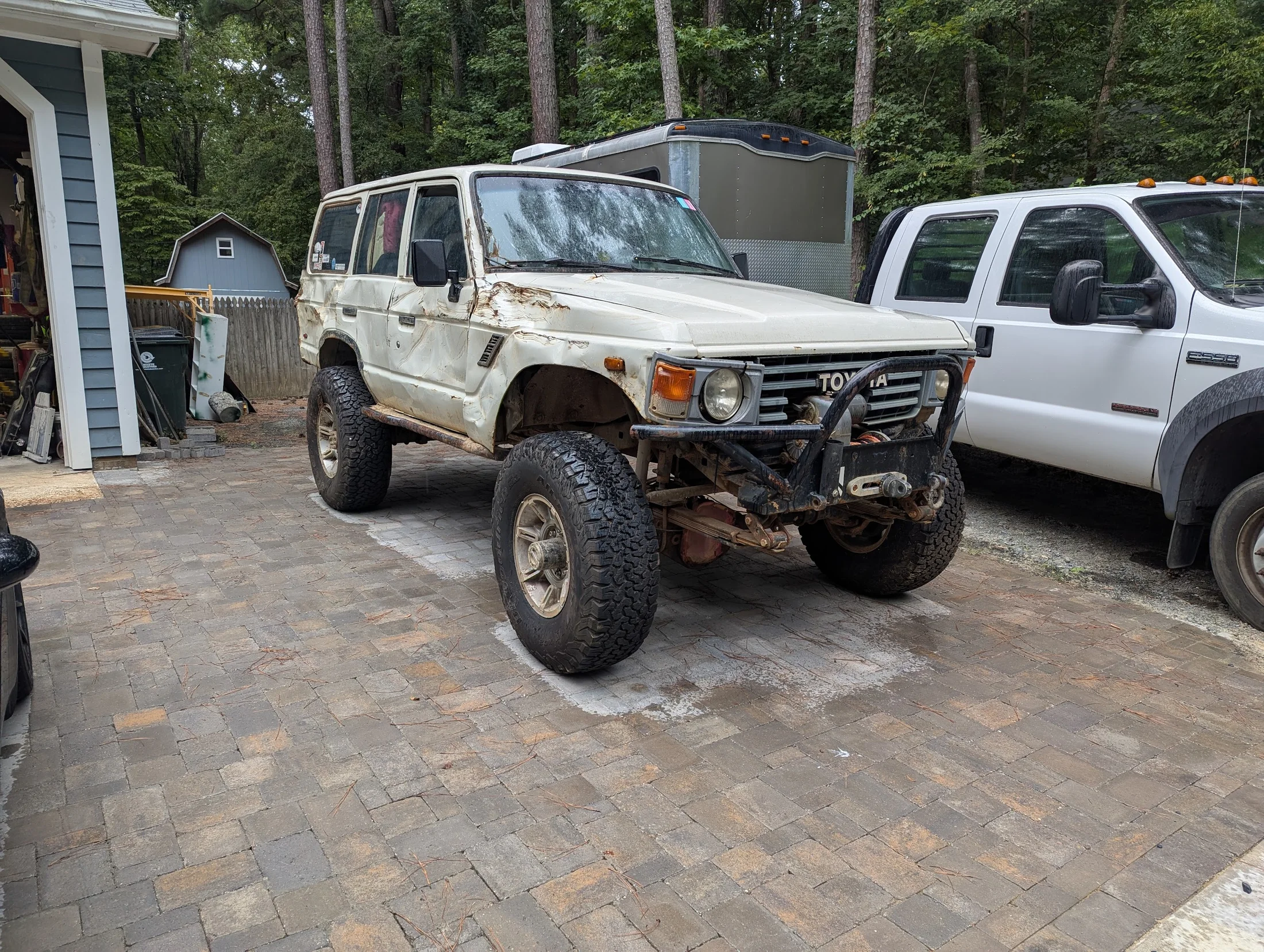

Finally, installed the all terrains for a camping trip this weekend. Gross.
Looks like you need some tube work. But the dents tell a great story. Seems like we both hit the same trees. 3rd set of mirrors and I've replace all my windows 3 times minus the back door fixed glass. Those are tough to break. and suck to replace. oh and on my 3rd 3B and second roof. After braking my 7th birfield I bought long fields.

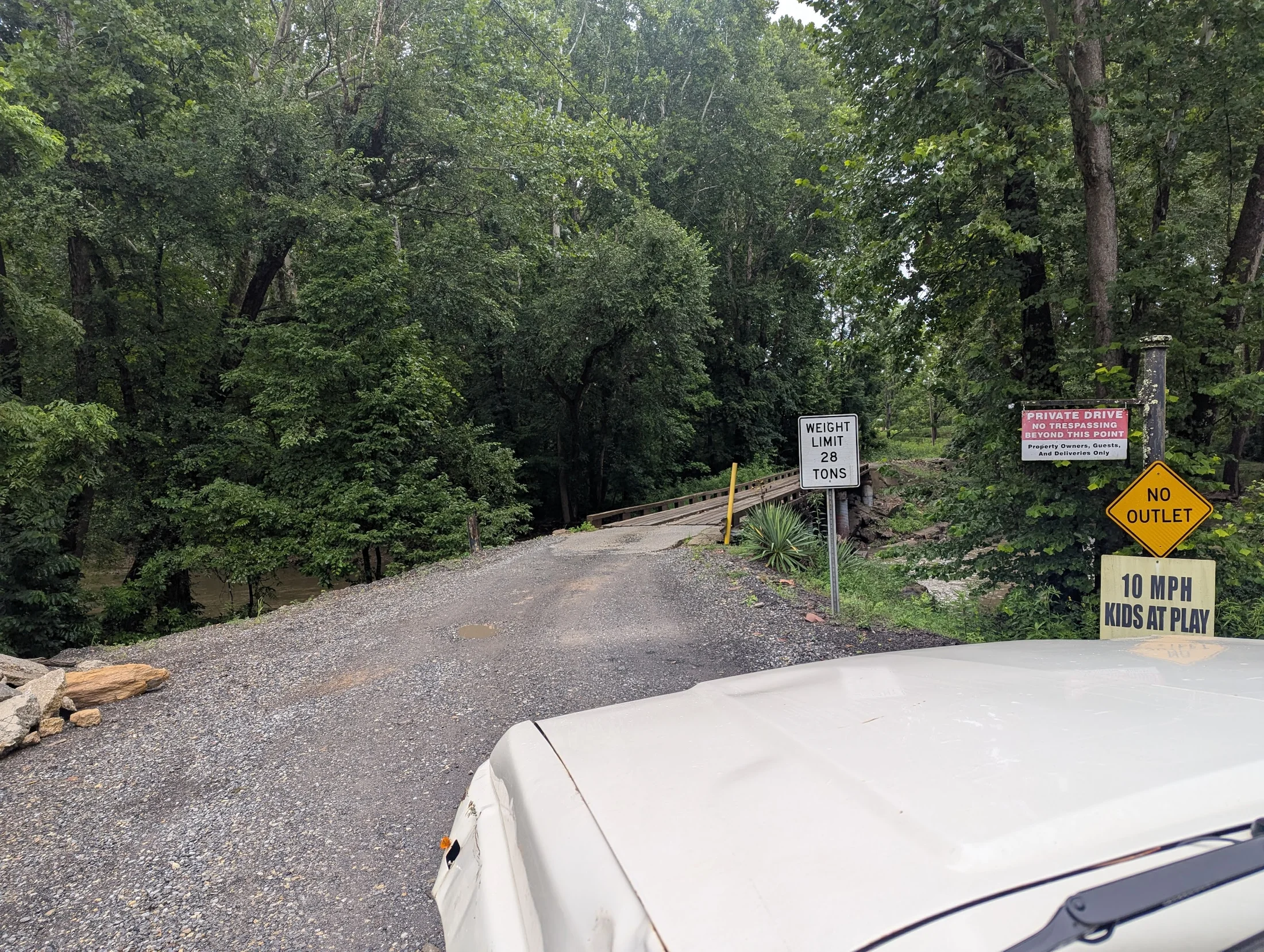

380 mile round trip roadtrip in moonshine this past weekend to a Star City Land Cruisers non-event. Ended up at this cool (sketchy) bridge:
I got stuck in the wet grass going out sunday morning, lol.

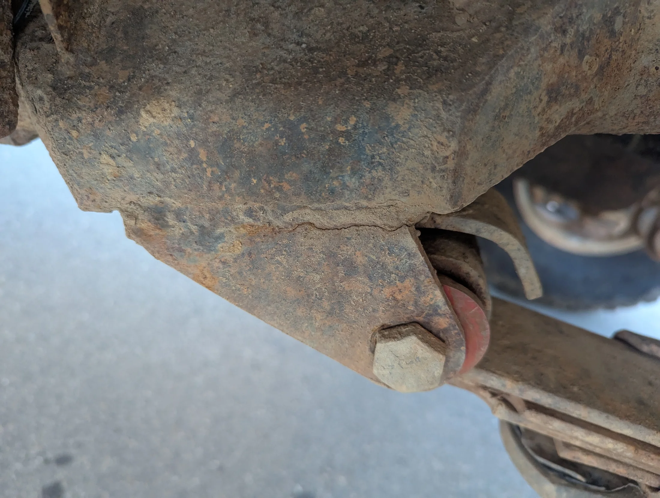

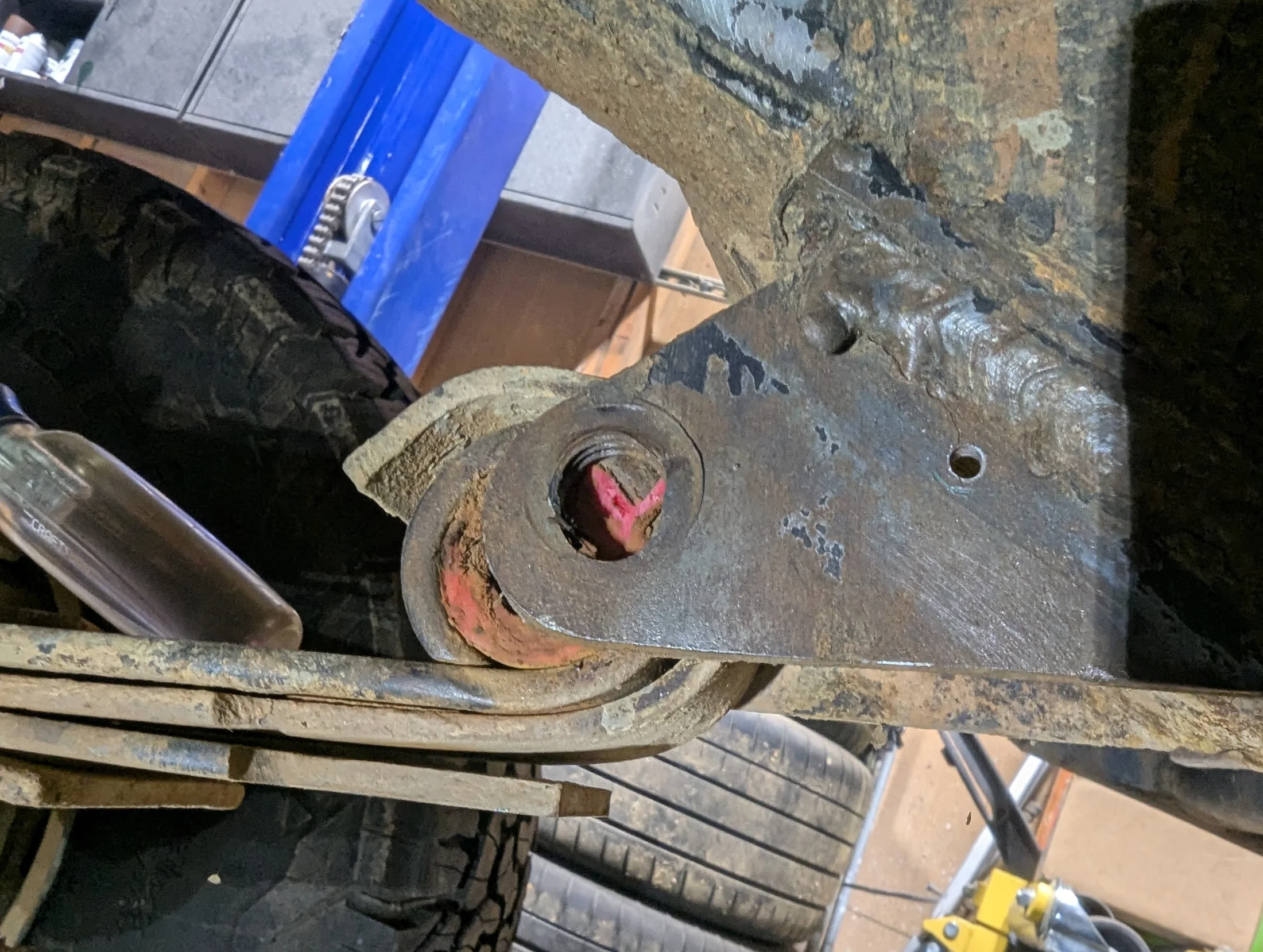

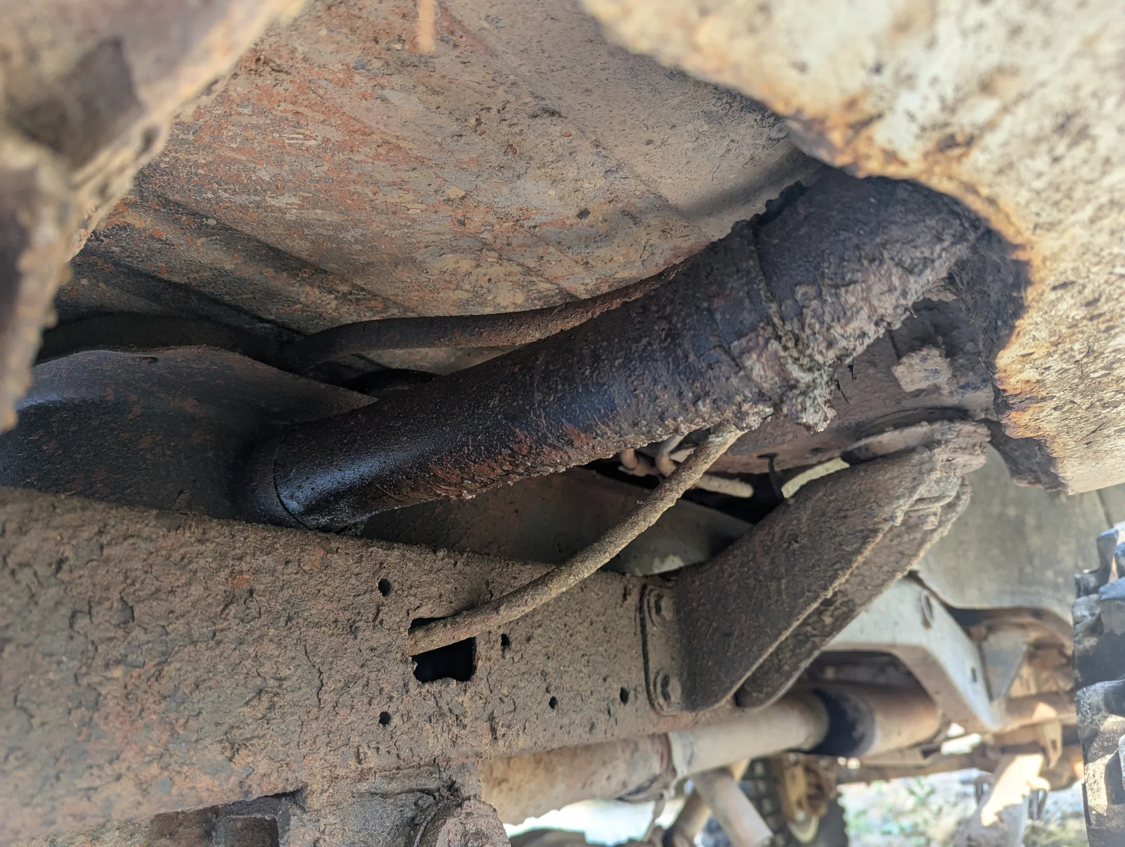

This past Thursday I was walking around the truck to grab something and this caught my eye. Not good.
Last night I dug into it and found that both sides of the front PS spring hanger were cracked like that, and the nut end of the bolt was working itself through the bracket. Also not good.

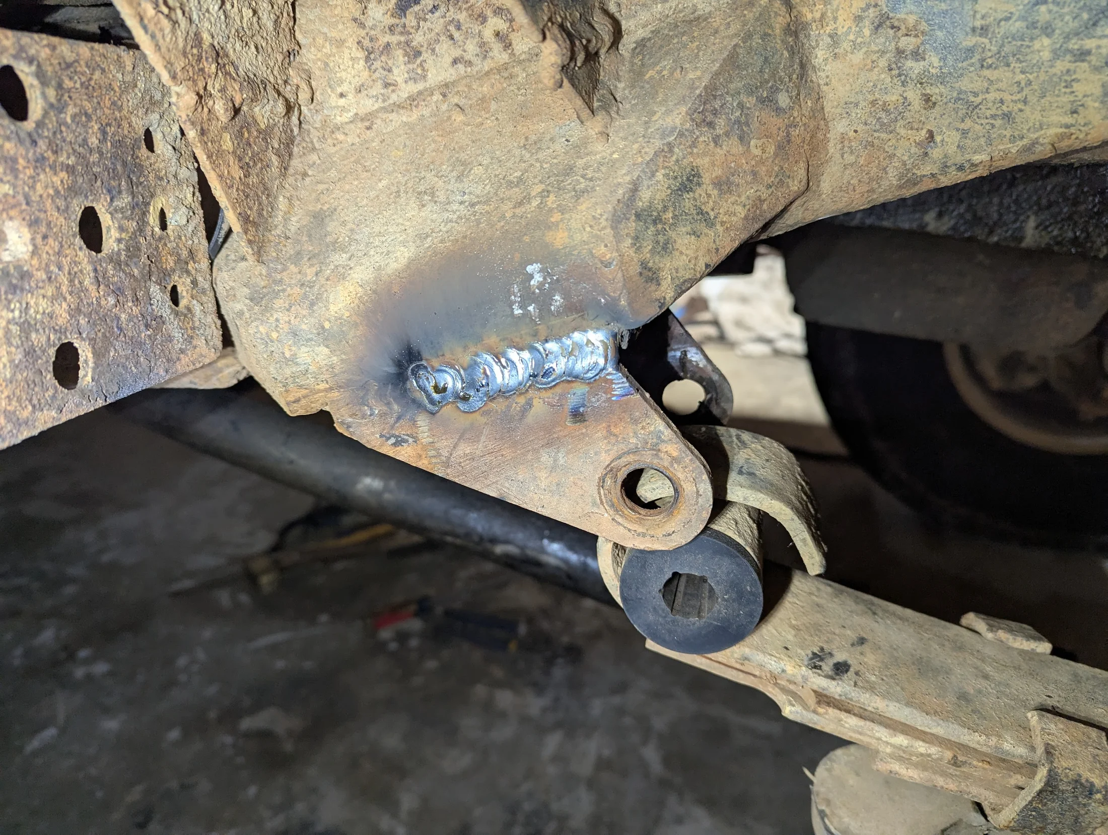

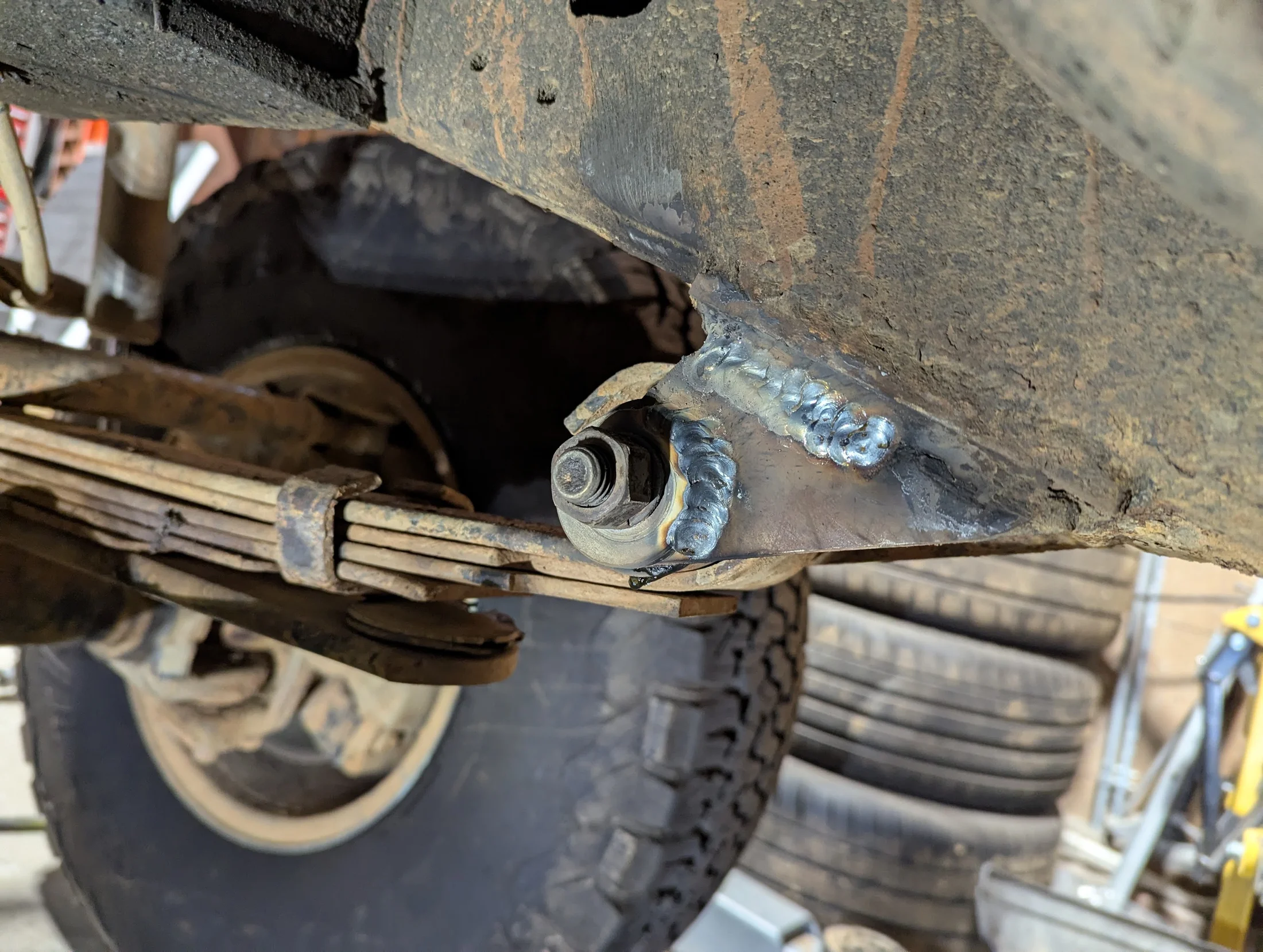

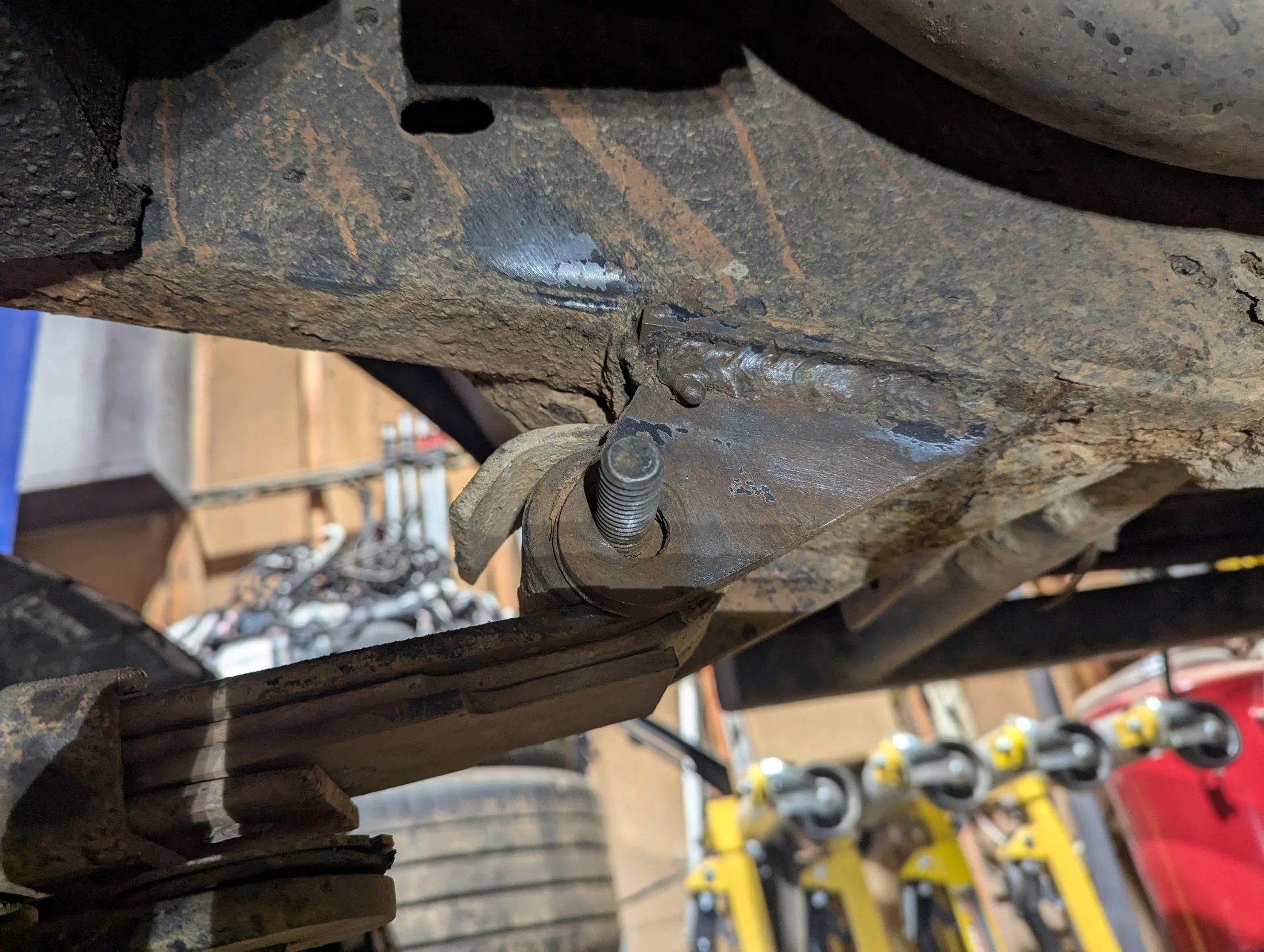

Stop drilled the cracks on both sides and glued them up.
Threw some new bushings and a bushing insert in for good measure:
Nut side, I stacked up two thick washers and glued them in with the bolt pulled into the right place. Fixed.
I put this bracket in when I did the D60 front end 11 years ago, so I'd say it did pretty well considering how much s*** I put this truck through.

Thank goodness you caught that. 10 years of tow truck duty is hard on Moonshine. Great call on the washers, I may have to try and remember that on my junk.
Yeah, "tow truck duty". That's definitely it.
Rob beat me to it. The weld on washers are great. I use them often.

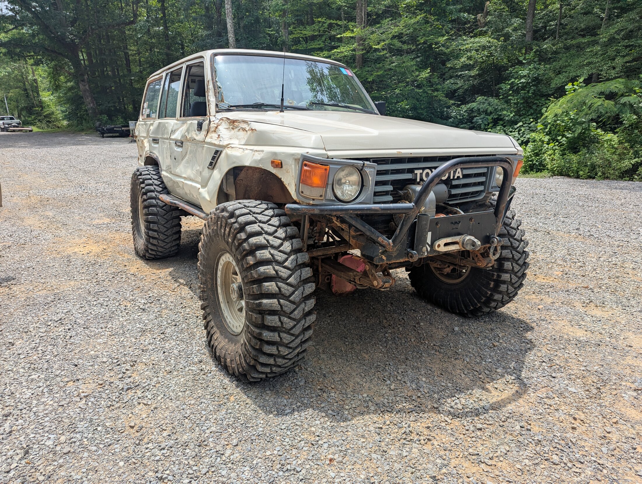

Put the stickies on today for this weekend. I'll sum up the past year next week. Tldr: she just works, not much has changed.
What happened to the right side? Did you get a new scratch?
Yeah man, a deer ran right into me!! Couldn't buff it out. Started buffing, but was worried about burning the paint.
