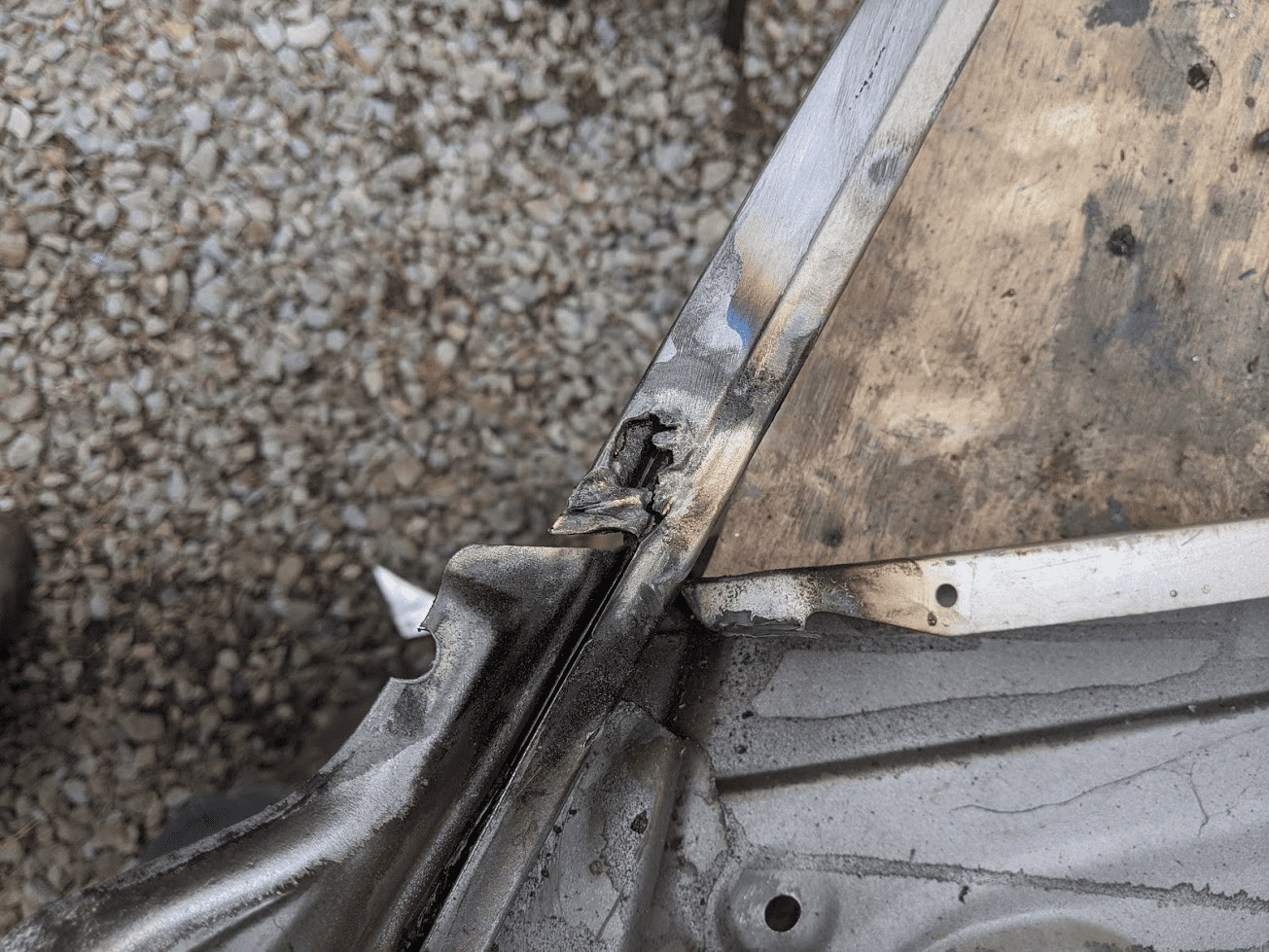

After that, there's two brazed seams, and this little tab on the inside (top, front), that holds the door together:
Of course, when wire-wheeling to find the brazed seams, I uncovered more rot. Has anyone ever seen the damn window frame rot out? :mad:
Melt that bronze out of there (really need an oxy or tig torch for this, hindsight is 20/20) and you have yourself a separated door:
Remember that $200 door that didn't look too bad, that was from a carolina truck? Yikes.

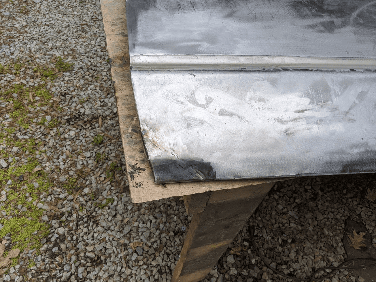

From there, it's cut and patch:
Not quite pro, but it'll do.
This one was tricky to rebuild. Right angle stamped inset with a drain hole in the middle.
Just thoughts: Not telling you not to do it, just some things to consider.
With such a tight housing on the large my estimate is that it will try to do most of the work and your small might not be able to contribute as much as it could, even with the wastegate on the small fixed shut (which would contribute to more restriction and higher egts as rpms build). Egts and high boost will probably be your fight. Head studs are a requirement and head o rings would definitely help keep all that excited boom contained. Hopefully a port job like the link you posted really helps out.
I'm certainly curious what it would actually be like but for me I'd go into it as an experiment and be willing to swap it out if it just cannot be dialed in. I'm thinking a tight wastegate on the small and a pretty loose one on the large. This will hopefully get total boost reasonable but I'm not sure what egts would look like, my gut says they'd be in the higher range. Timing might be tricky too but small adjustments would be better than large ones. I suspect it won't really start to spool much quicker than your current single but the rate and peak of spool could be pretty quick/near instant. It might be a little like turning on a fire hose to water the plants.
Again, not pro, but it'll do.
