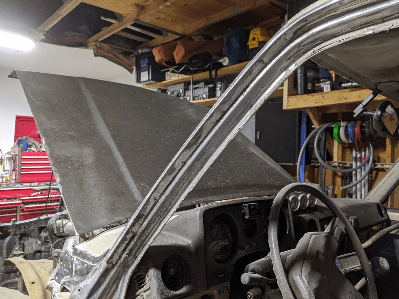

For stripping, while dusty, the paint eater disks/drums are the most effective thing I've used yet. They're pricey, and get eaten up when you run them against an edge, but they work.

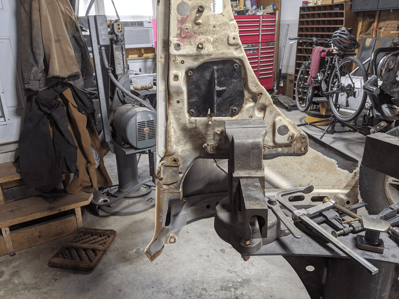

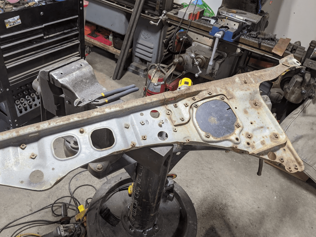

Moving to the front fenders, there is rot along the top edge where the inner structure is spot welded to the outer skin. I considered buying new fenders, but if I were to do that, I'd have to cut them up for tire clearance anyway. Welded a 1/4" round bar around the wheel opening, following again in @boots4 's footsteps, then used my rotabroach set to cut the spot welds and separate the fender. Haven't seen anyone do this in the past, so maybe it helps someone in the future.

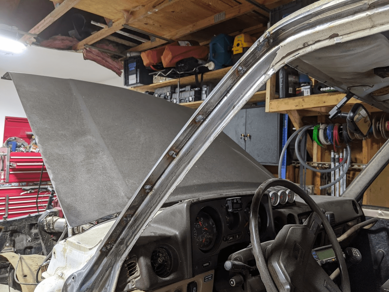

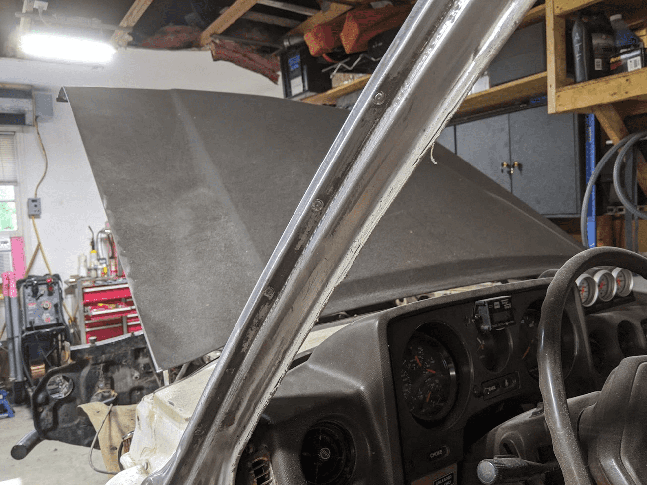

Since I'm not using the factory hood springs, I removed the stiffening plate. Also, it was causing more rot. Hate layered metal that's exposed to the outside. Continued stripping this, and coated everything in naval jelly, so that I can proceed. Needs more work, but we'll get there.

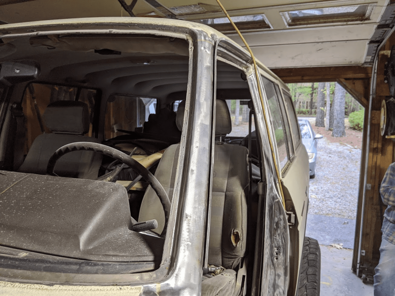

Dang, you are becoming a body man. Good set of skills. Looks like you took out the front window, how was that channel?
Windshield channel is in good shape. Fortunately (or unfortunately) I've broken the windshield enough times in the past 8 years that I've been able to keep the rust at bay there :lol:
Separating that fender doesn't look like it was very hard at all! What size rotabroach? Off to go borrow my dad's :lol:
It wasn't. Smallest rotabroach you've got. My arbor allows me to go down to a 3/8" cutter, but 5/16" would work better. 5/16" is the right size rotabroach cutter for all of the toyota spot welds I've come across.

Once the outer skin is off, you can take off the rearmost structure from the skin with a hammer. This is possible because the welds that secure this to the fender are cut off when you chop the fender like I have.

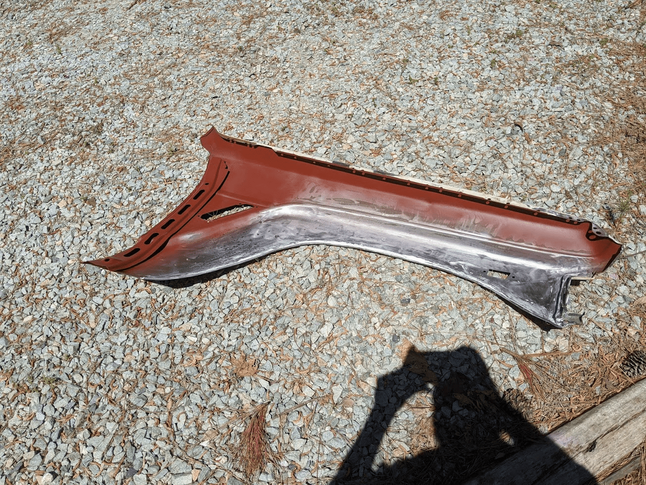

Next, it was on to some rot repair. The top of the fender skins have this little step in them, which was easy to make with some metal stackups and a chisel.
Not awful.
Next up was the inner structure. After the layered portion for the hood spring was removed, there was lots of rot to be corrected.
Pretty tricky section to fill, with lots of curves and compound angles, but I managed to get a patch in there.
Smoothed it out:
After patching, all the metal was stripped and coated in ospho, which was allowed to dry. Spray-bomb primer, then reassemble.
Put it on the truck to confirm alignment, then welded and painted with oil-based enamel. Idea is to prevent rust from starting up in here again. We'll see if it lasts.

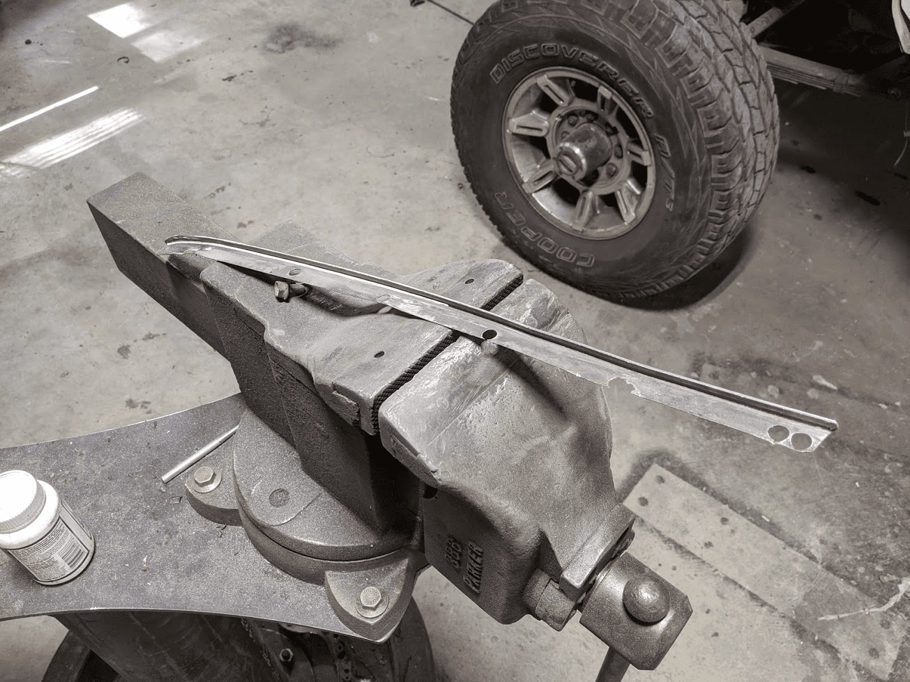

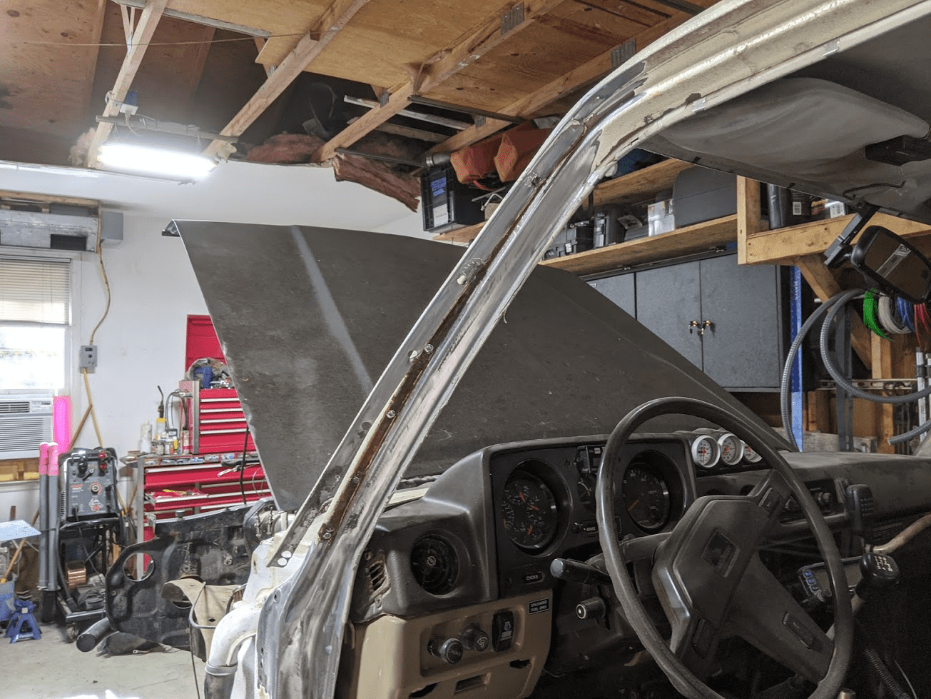

Inbetween drying times for the fender, I addressed the DS A-pillar rain gutter. Removed it from the truck with the rotabroach, then cut the top with the angle grinder to remove just the a-pillar section.
Once removed, you can see how much rust is in here. The rain gutter itself was fairly rotted, but fortunately the a-pillar wasn't too bad. It's kinda neat, you can see where the leak must have been, within 6" of the top of the a-pillar, and how the rust follows that leak down.

Cleaned up the rust, treated with ospho, then welded the rain gutter back together.
Finished out the metal work. I'm pretty happy with the result, so let's hope the other side goes just as well. Still need to seam seal the gutter (obviously) but that'll be done with the rest of the roof paint prep.
I've seen maybe one person have to execute these types of repairs on a FJ60 in the past, so hopefully this is useful to someone in the future. Body work takes a damn long time, lol.

I see a lot of a pillar rust on 60s. Cool to see that seam with the bronze. Where is the leak at you talk about causing the rust?
The rain gutter caulk cracks over time, and left unchecked, lets water inbetween the rain gutter and a-pillar structure, causing rust. The a-pillar raingutter is tough because it's so narrow, you can't easily inspect.
