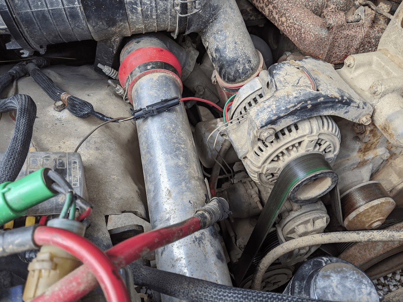

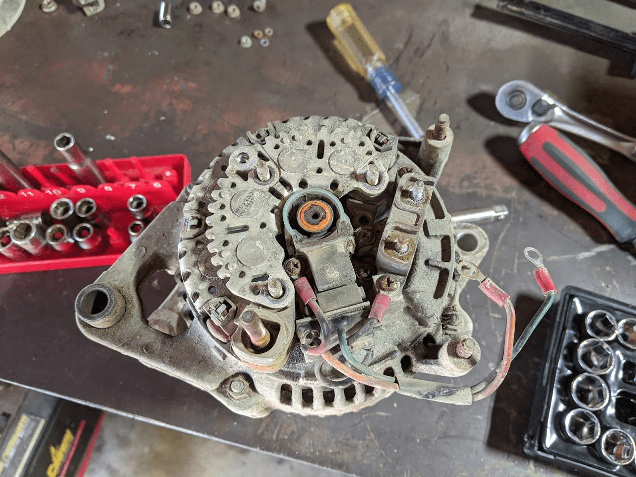

In the meantime, I bought a new-to-me DS front door for $200 for an upcoming rust repair/paint project. On my way back from picking the door up, alternator decided to stop charging. Bummer.

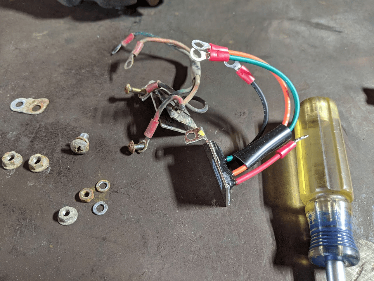

Threw a new $30 internal regulator at it and she's good to go again. Cleaned up some wiring a bit, and sent it.
I love this truck.
Old reg on top. Seems it delaminated from the heatsink and died. Lasted ~5 years. I'm happy with that.
