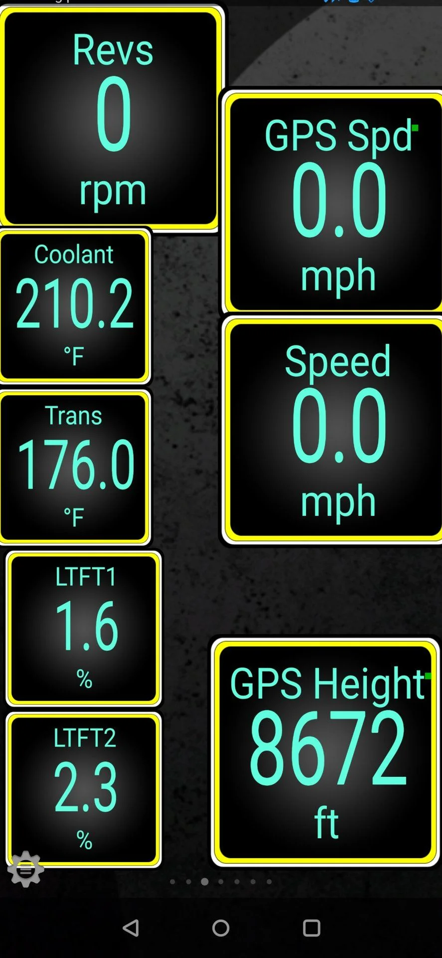

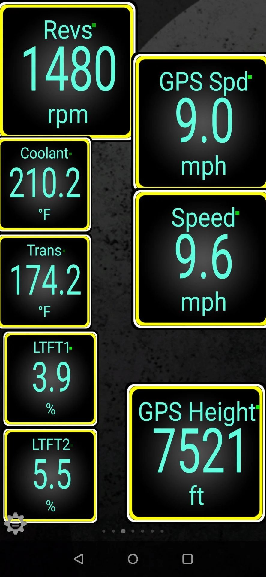

I'm getting fuel smells and long venting (60 sec +) after a big steep slow climb OAT 97F, 1/2 tank of ethanol free 88octane, 7-9k elevation
196K miles 2003
ECT reached 215F
Running new fan clutch at 195K
coolant flush, new water pump and timing belt at 179K
orig radiator, cap and t-stat I believe.
Images of stats.
View attachment 2386866View attachment 2386865
So this is a prime example of engine (ECT) running to hot and fuel boiling. This is great anecdotal evidence and data. Thanks for posting! ;)
Whereas it not a bad idea to replace radiator. I'd be inclined to first clean the fins of radiator, see what outcome is. I'd also replace radiator cap and thermostat with new OEM.
You may also want to reflush using BG Flush & Cool kit. Make sure you drain block drains and examine flush distilled water for color and practicals. This will yield clues of health of radiator. Use compressed at ~10 PSI ,to blow out system before filling with Toyota coolant. That way you'll get most distilled water out. IIRC 03 is Toyota SLL "Pink". Personally I prefer "Red" LL at 50/50 distilled water. But I stick with whatever Toyota OEM recommends for the year.
I've a 90 degree wand for my HP washer. I blast water from inside out, from between fan blades. I pull #1 skid and wash between all radiators. I blow water in from front also. I repeat and repeat and repeat as many times as it take.
LTFT are what engine is doing to correct STFT. Yours are okay. We see LTFT 2.5 to 5.5 often. Closest to zero is goal of ECU. The 5.5 indicates bank 2 running a little lean (hot). ECU is correcting the baseline of STFT to richen the mixture, in your screen shot.
