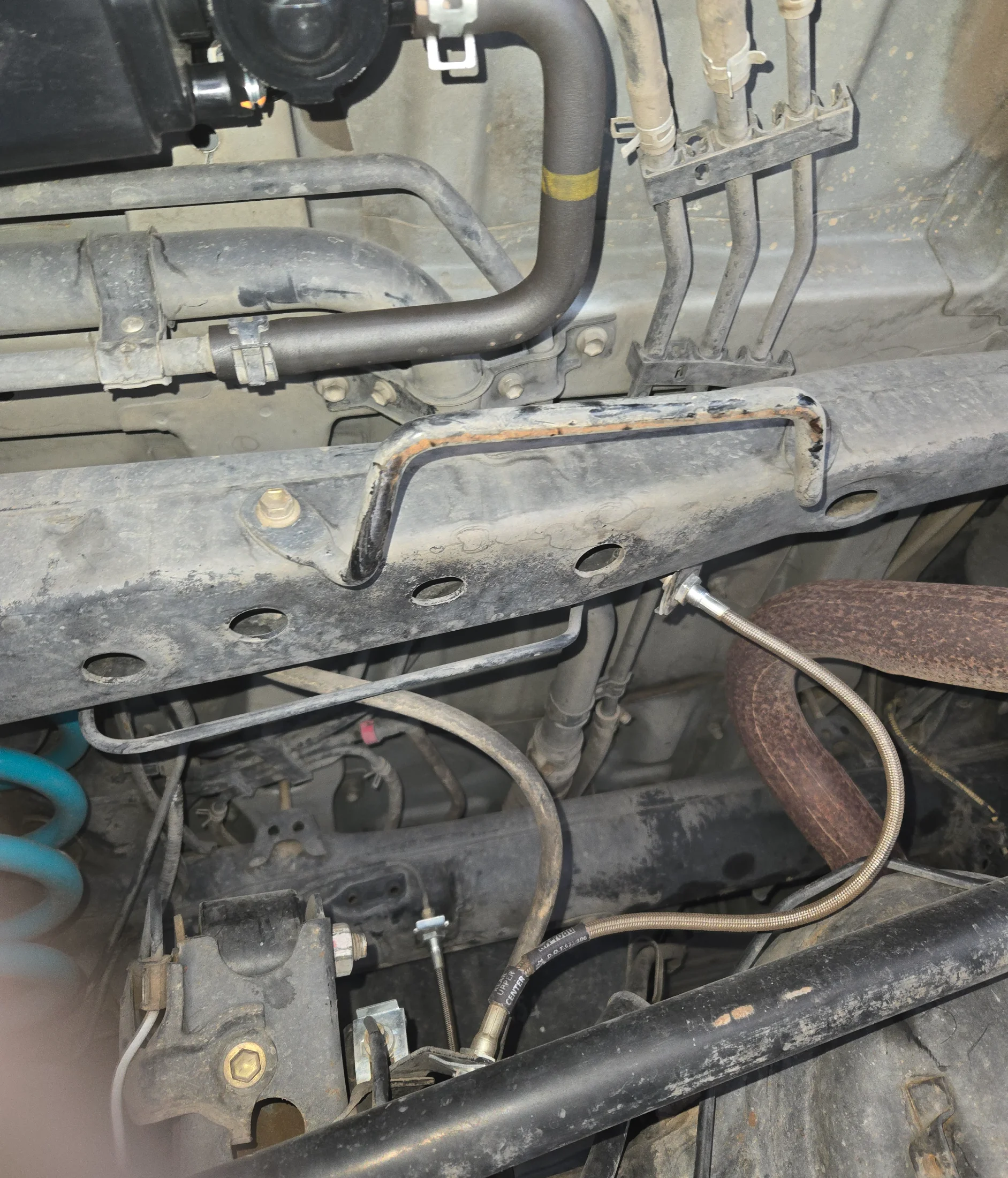

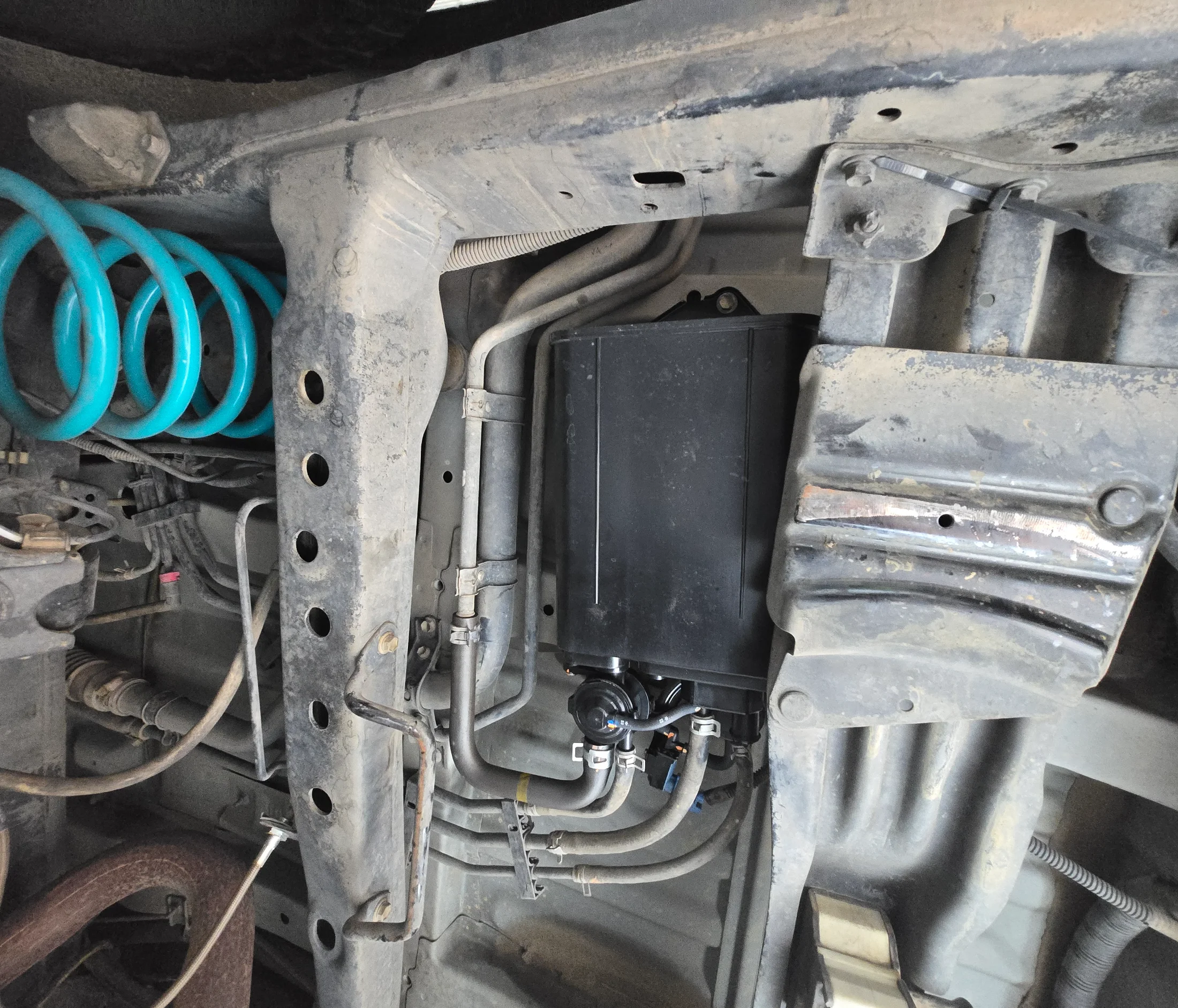

Is the vent valve on the canister? OR it is in another location? Maybe I need to replace it if its not on the canister?

Ok. I'm adding that heat shield tomorrow as well.
