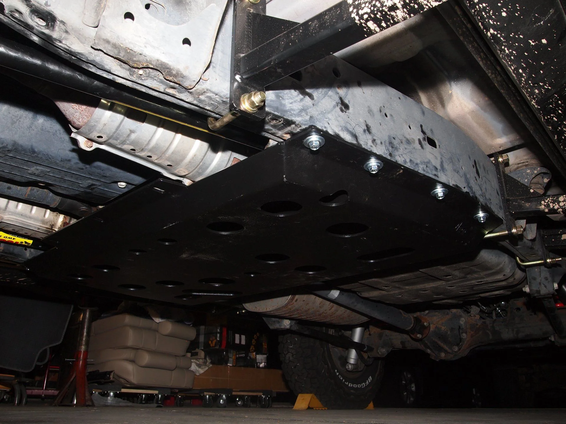

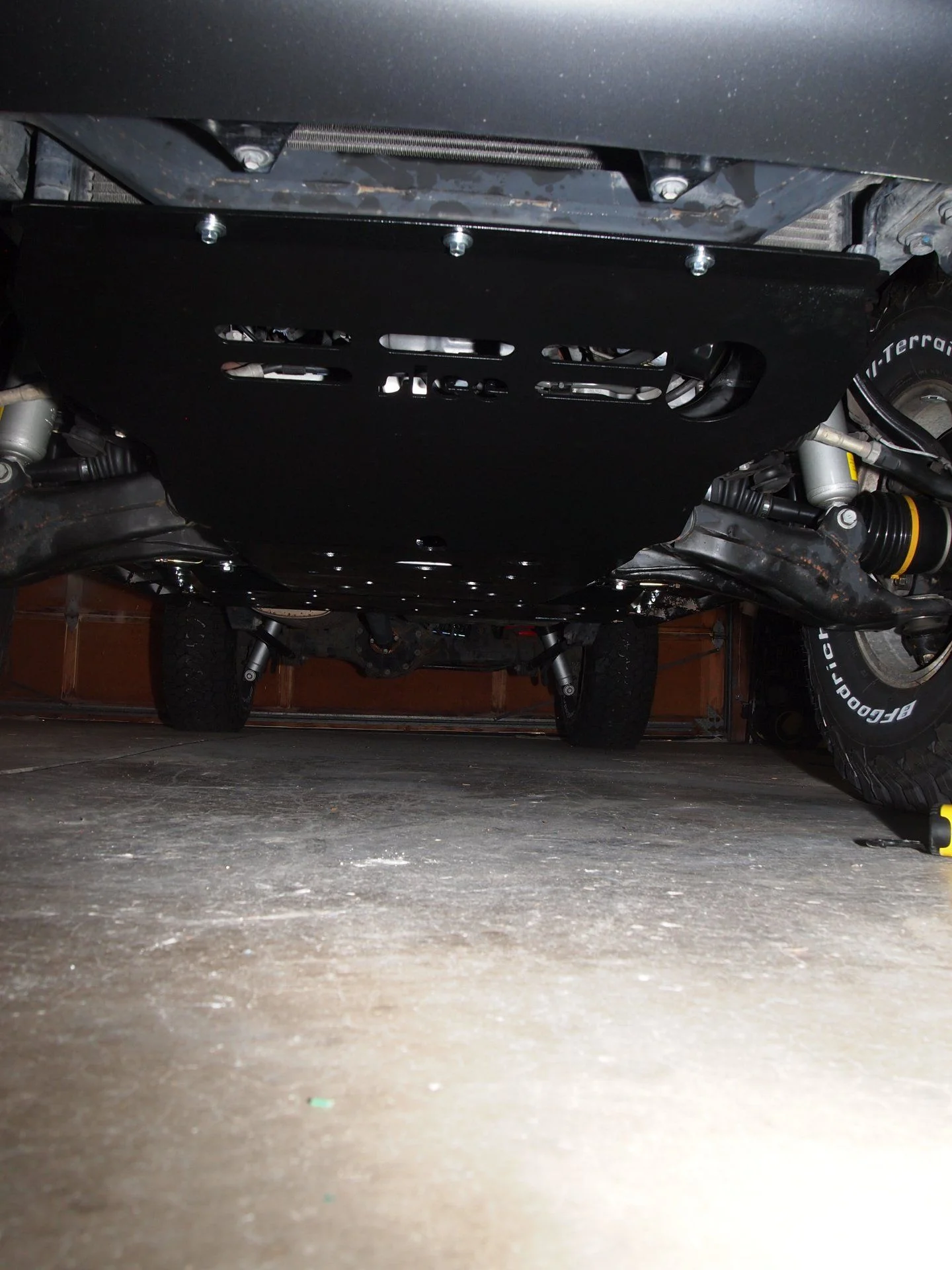

Is your "Dissent Skids" also a bell-pan like the Slee bell pan cover from rear of CAt to fuel tank?
Full Slee skids & bell pan.
