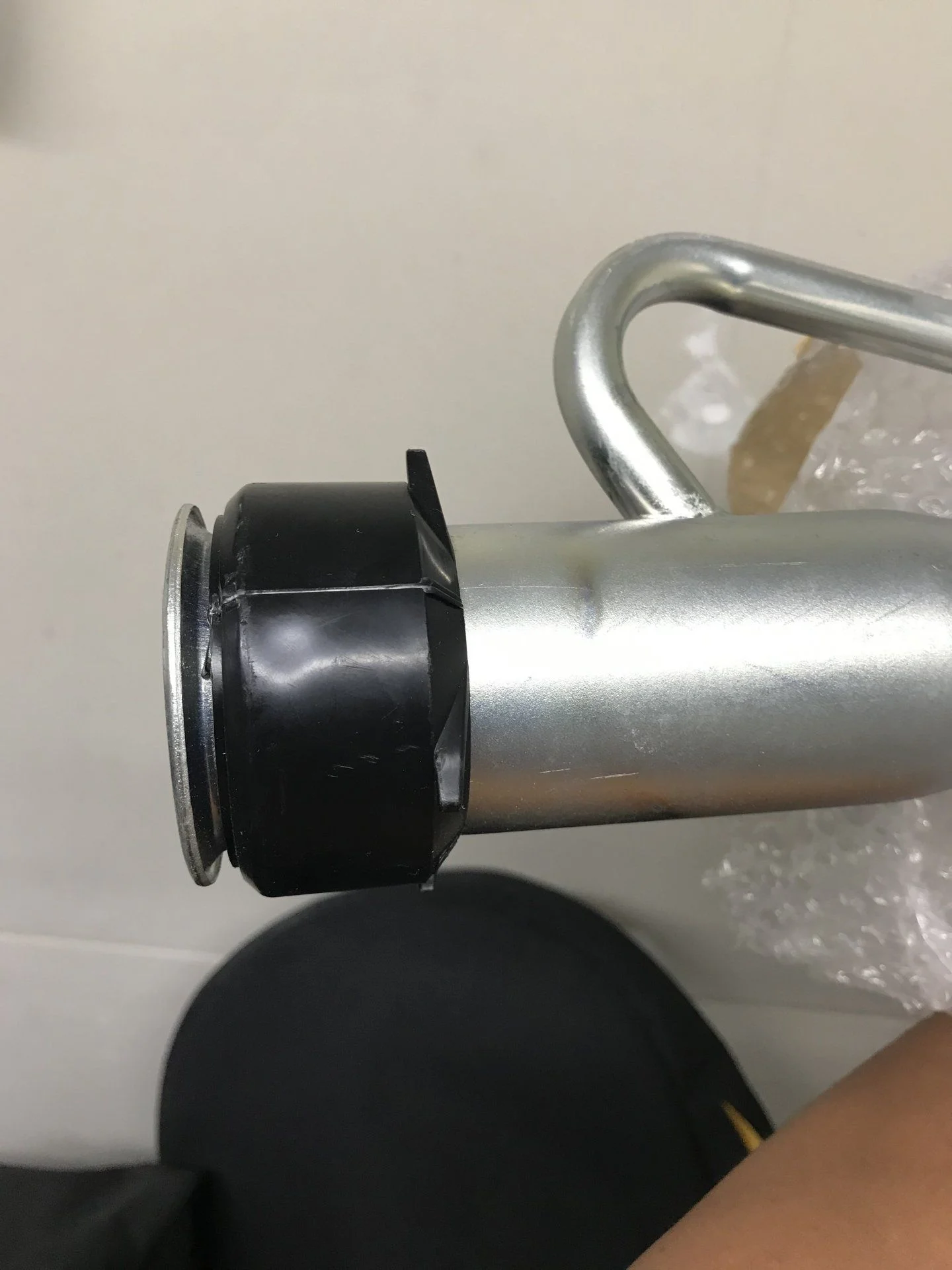

So the glove did not look like this?
Seriously though, do you think you need to replace the filler pipe if it's leaking out of that seam?
Just about haha. The filler neck is not cheap I think it's $300+ and no point in buying a used one. I am planning to pull mine off and inspect it. If it's just leaking then I will use my buddy Mr. JB Weld and if it's got a broken valve inside or something I'll go from there.

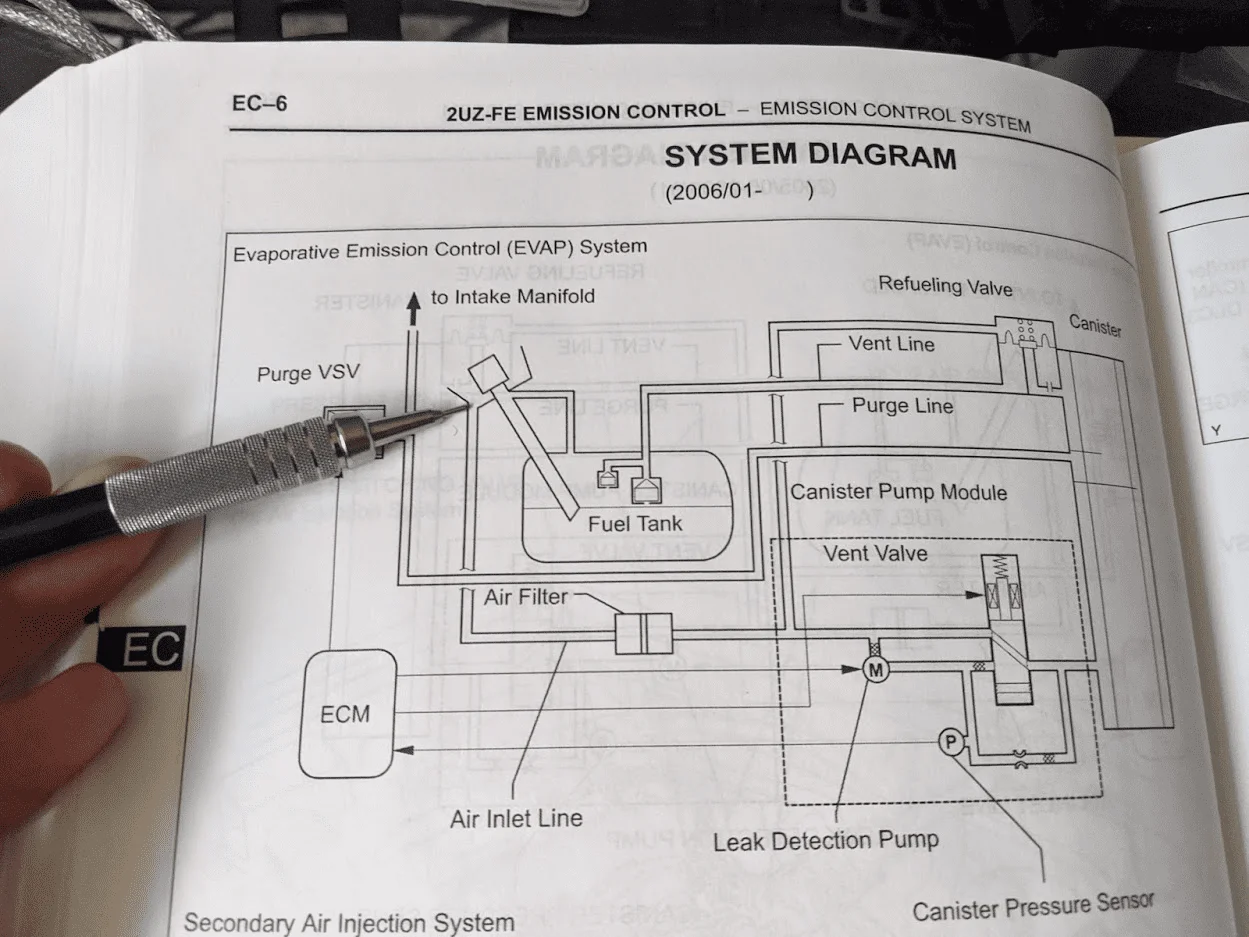

There's some sort of (seemingly large) air inlet that I assume has a check valve in the vent valve near the tank or CC. See pic below. I wonder if that is an air passage in that neck and the leaking you noticed was that inlet check valve letting air out? IE, not necessarily a problem at the filler, but a problem in the vent valve or CC that was allowing air to go out where it should only be coming in?
The manual calls for a test of the EVAP line where you apply 4kPA (just over .5psi) to the tank. It's supposed to hold that pressure for "some time" and suggests the vent line as a potential culprit if it doesn't hold pressure.
Annoyingly, the manual lists different troubleshooting steps for pre and post 01/2006 build dates. Must have been significant changes to the system mid year on the 06 cars.
Full fill inlet- I dont think there is a check valve there. Cut off valve is in the top of the tank.

I isolated my fuel tank by capping off all lines except for the filler neck and it was leaking out of the black plastic ring that is molded into the filler neck as shown below. NOT the fuel cap, the black plastic ring around the outside! This is where it's leaking end of discussion.
I don't care to discuss but I have a brand new filler neck in my hand. There's no way it is leaking through the plastic ring. Carry on...
Hmm why so certain? Your photo is looking directly at a SEAM in the plastic. Have you aged it for 13 years and gave it plenty of use? How does the plastic ring seal against the metal tube? No possible way? I'm looking at one possible way...
Also this neck is not the same as the neck on my 2007 which has two vent tubes, one from the tank and one from the CC.
Not true. At least not on my 2007. On a V8 4Runner there is a check-valve in the top of the tank in the filler hose inlet, but not so on the LC/LX. Not so on mine. Sorry but I removed the tubes and stuck my finger in there, so I know ;)
